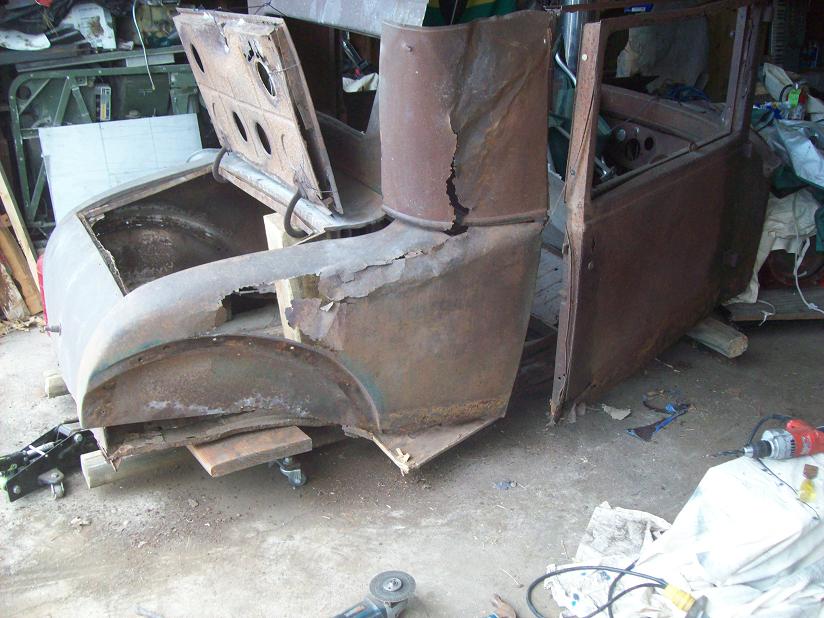

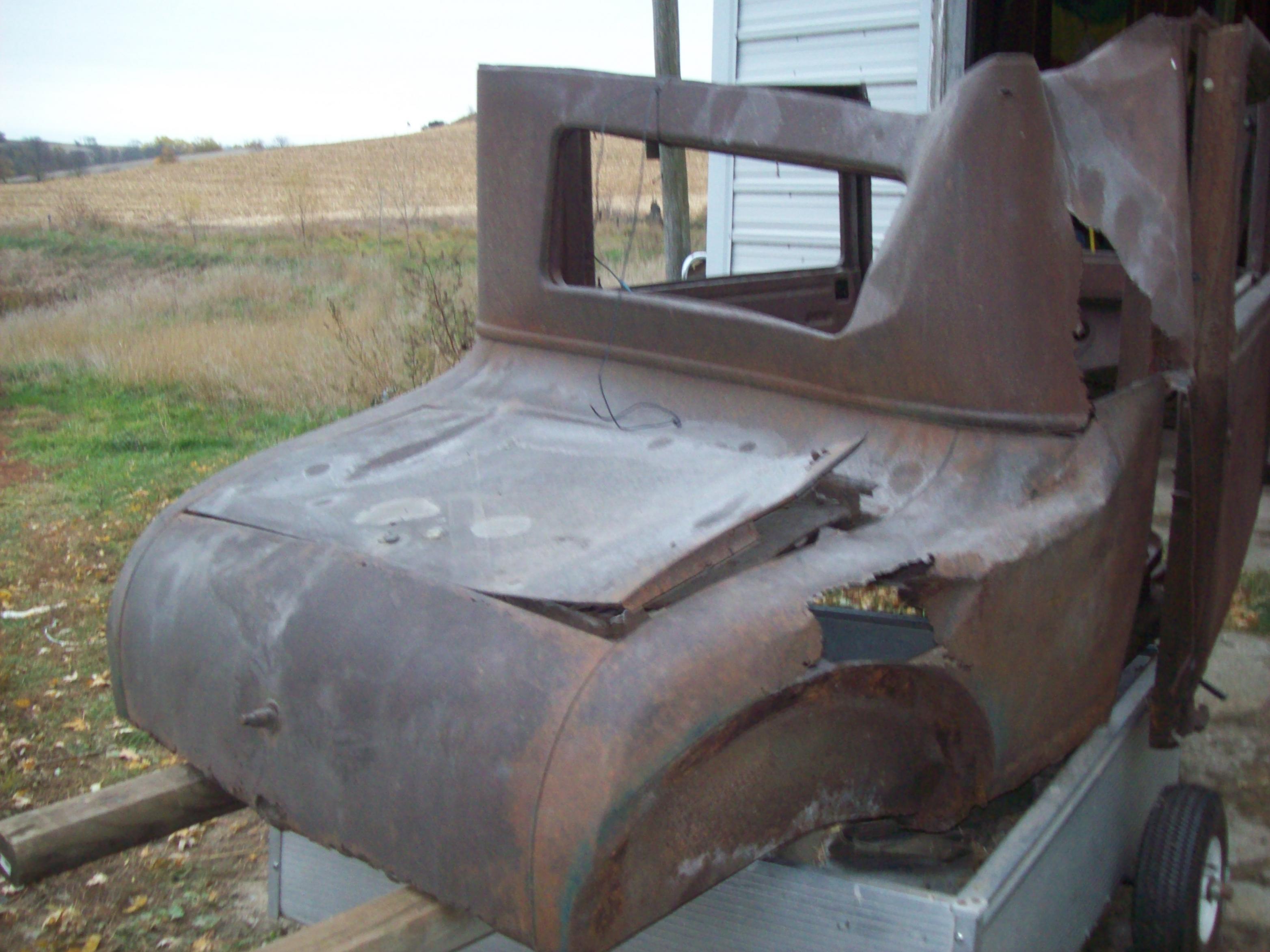

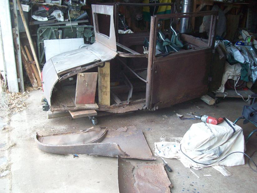

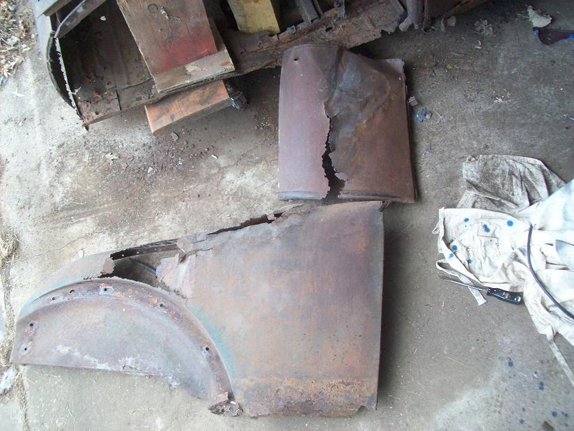

    Got the trashed rear quarter and cab corner removed today so we can repair them:confused: or make replacements, the inner structure is really not in too bad a shape, actually I was suprised any of it was left on this side, but anyway here's some pics,, Tim Jones

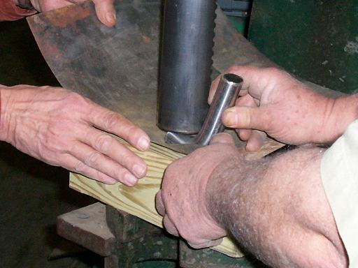

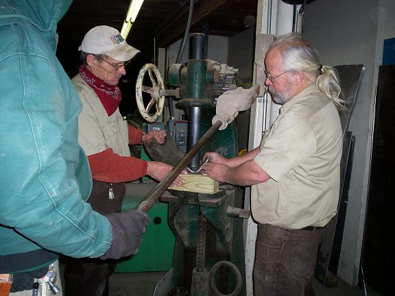

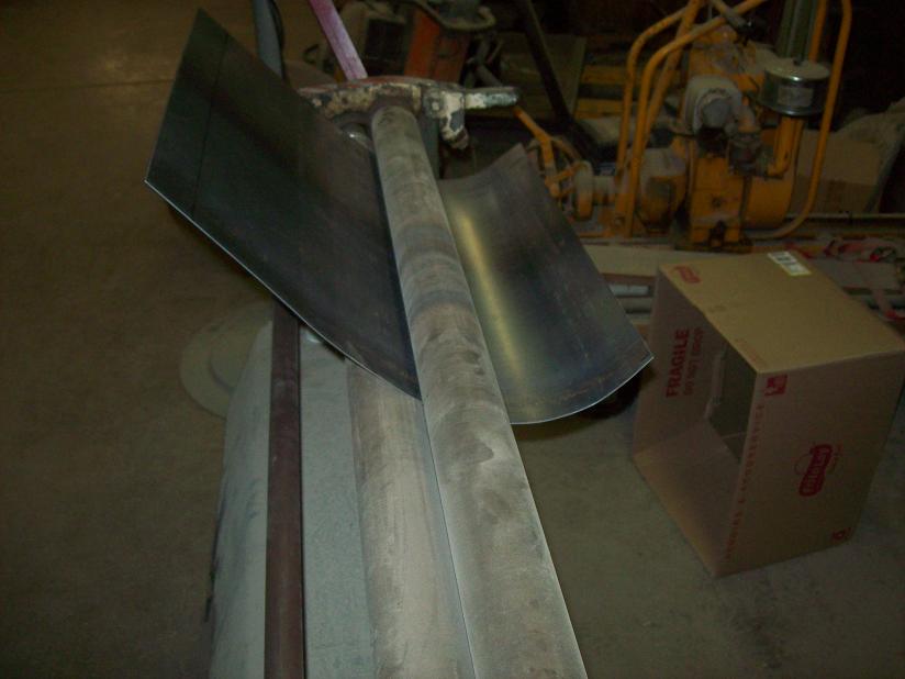

    Since we couldn't find any replacement parts we are having to make or repair what we have, So starting with the cab corner we needed to see if we could duplicate the belt line, I asked my buddy Huck if he had any ideas, (Huck helped me build my dragster tinwork) So he went to work makeing a wooden die to press it out with, we rolled the panel first, , kinda crude work but we are working with what tools we have, didn't come out too bad, but we are going to add a metal plate to one side of the wooden die to sharpen where the upper part of the belt line meets the panel,,,And sorry I thought I shot a pic of the results ,musta forgot , I'll get one thus when I'm back at work,, Tim Jones

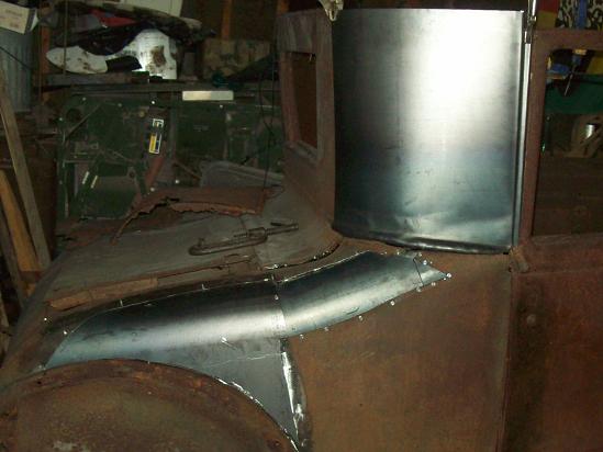

    Got a chance to work on the cab corner, first pic is last weeks try before changeing our beltline die or jig, added a piece of metal to sharpen the top edge , still needs work but close,, bent the door edge also , took it home for a quickie test fit,,,, Tim Jones

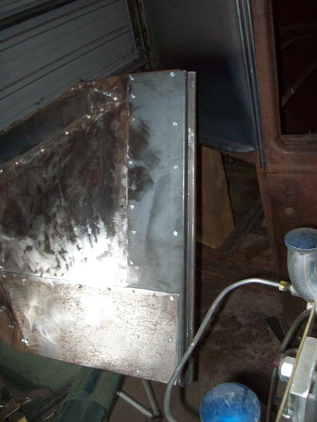

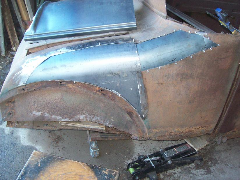

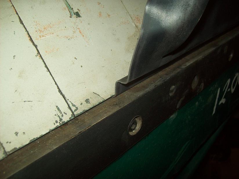

    Got the top of the quarter patched today, now just have to make the front and bottom edges on the brake at work and weld it all up, kinda nice to work with the door open:D,, Tim Jones BTW How's the weather in Idaho Brady?

    Did a little test fitting of the cab corner , Still needs alot of work:eek:, But when I look back at the pics of the start I don't feel too bad:rolleyes:,, Tim Jones

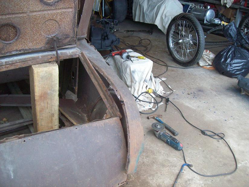

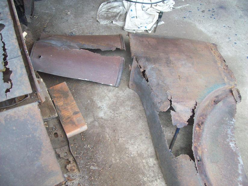

    Got the quarter all pieced together:), Not much of the orignal quarter left, lots of welding and grinding to do, rust doesn't weld very well either :D,, Tim Jones

    I bet its not easy welding to that rusty stuff! Looks better each time I see it Tim keep up the good work! Is it warming up there at all?

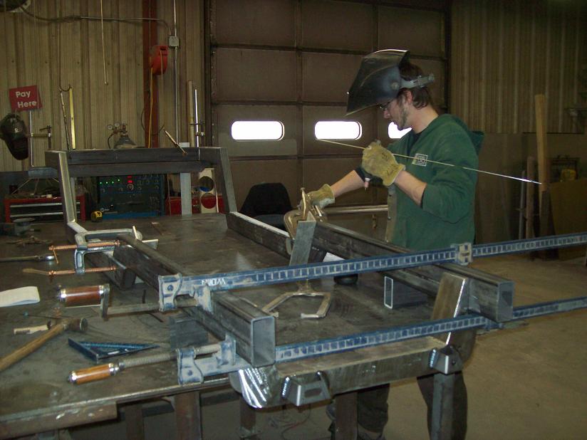

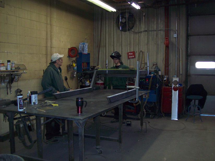

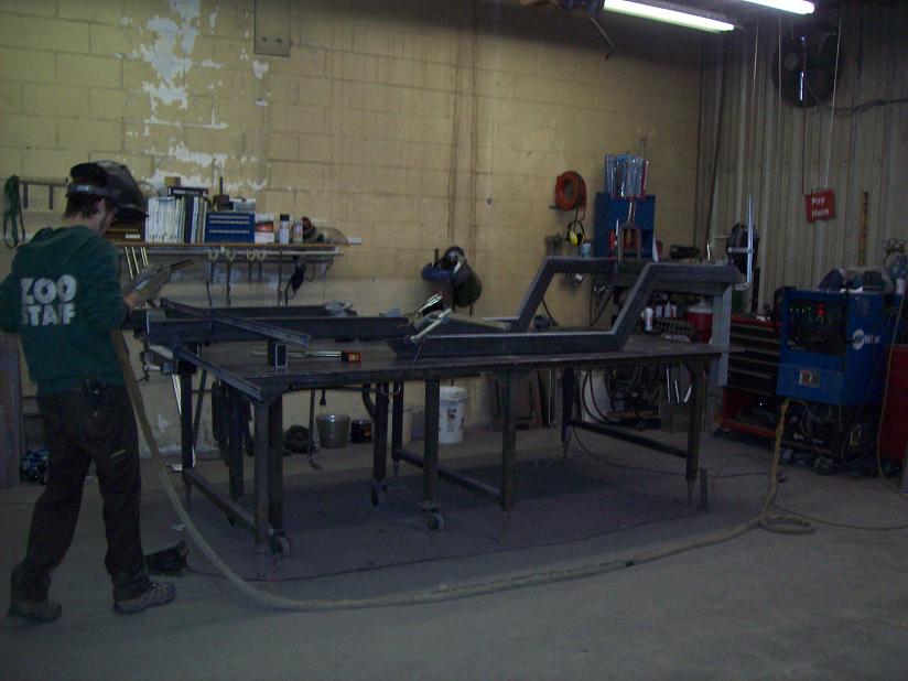

    Garrett got some more work on the frame done sunday, Our buddy Huck gave us a hand getting it all lined up, the weather has broke out here so I should be able to get some more work on the body done over my weekend,,, Tim Jones

    I dunno how I missed this thread.love the photo of you [Tim] and Huck working together just like old times...looks like Bob has the handle in his hands.

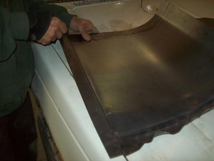

    Stop up any time Rocky:), After takeing a better look at the panel below the deck lid , we decided it would be easier to just make a new one, So after I get the old one off We'll roll another one should be alot easier than the quarter:D, Tim Jones

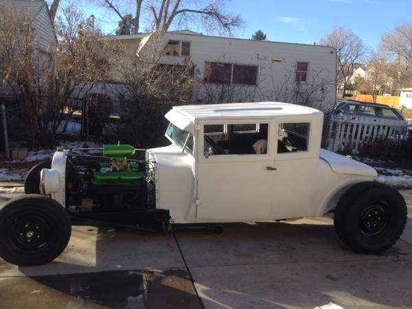

    Here is a 26 Dodge under the deck, not very good. Also the back of a 27 Dodge

    Found a better picture of the 26 Dodge, that my Son and I did a few years ago.

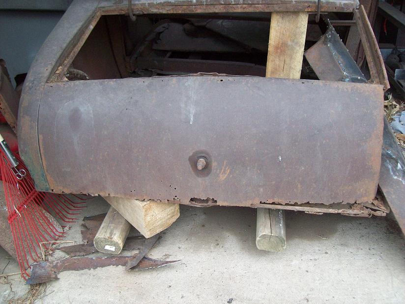

    Thanks for the pics George, Still working on the tail of the car, After getting into it I relized there a slight concave at the center, I'll post some pics when it's a little closer,,Deck lid is junk also so were making another lid for it,,,,,, Tim Jones

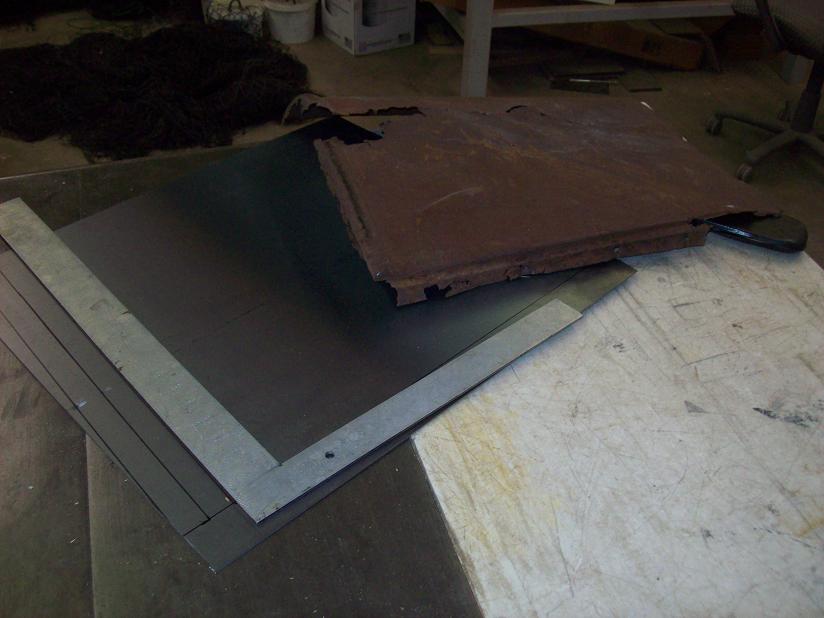

  30. dragsled
    Joined: May 12, 2011
    Posts: 1,975
    dragsled
    from Panama IA
    Haven't posted anything for awhile Still trying to save this body, the more I work on it the more swiss cheese Panels I find, first off , I was never happy with the replacement cab corner , never could get the belt line right,,, so I took it off and got the old one out and added a large patch instead I like it much better now and so does Brady, have the lower tail section cut and fitted just need to weld it together, today Icut out and bent up the new deck lid , still have to bend the curves into it , but here's some pics ,,Tim Jones Hmm? Can't get pics to load, I'll send them to Brady and have him load them
