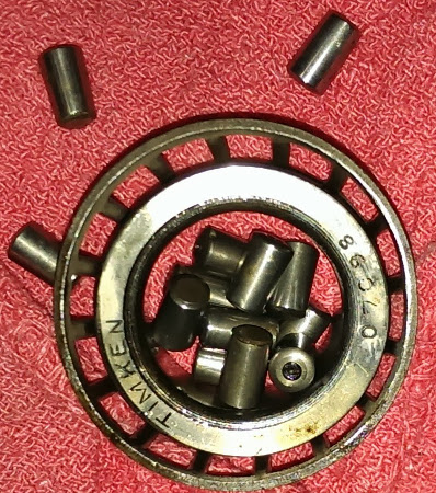

    If you look closely you can see one of the lower Jack Shaft bearings didn't like having the cap that it lived in removed from the trans.
    The other small bearing on the other end of the lower jack shaft it still on the shaft and sorta in one piece but it has some parts of the inner race that are missing. So we ordered a couple of them and new races off the old interwebs. About $20 each not too bad. Those were the only bad bearings in the trans. which is good. The Largest bearing in the trans (the one you can't find anymore) looks good but it's race is beat up. looks like the last guy that rebuilt this trans swapped out the bearing but not the race. It would be ok but we're looking into finding a "new" race for it if we can.

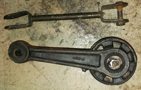

    We also started talking about shock placement.
    These are what we're going to run in the front.
    We're thinking about cutting the front cross member horn that bolted to the fenders off and bolting the small "pivot" to the frame and bending the nose of the long arm to bolt to the front axle. (any other good ideas will also be considered so toss em out if you got em!)
    In the rear we're looking to use these.
    Willie (the guy we got them off of) thought the were 40's dodge bros. But they look very similar to early Model A shocks (or AA). any thoughts?
    Right now we're thinking a plate bolted to the rear axle that the round shock body mounts to then a modified dogbone up to the ends of the rear cross member. Again any Ideas or old photos that show a better way (or vintage way) please let us know.

    We worked on a few parts of the car over the weekend. Hit a couple of bumps, but it was good. A lot of the work was the boring no picture kind. Like pulling bearing races out of the caps for the Warford jack shaft. Here's hint. Use a welder put a bead around the inside of the race.. Flip over cap over and tap a bit. It will save you tons of time... We figured this out on the second cap, several hours into the task :) When we ordered the bearing for this shaft they came with new races. So Jim started to install them. This is what we saw.

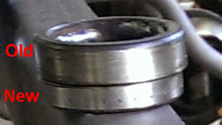

    The "new" races were too small (too thin, and the outer diameter was 1/8" too small). So that put a stop to that. New proper races have been ordered, but we'll have to wait a bit to get them.

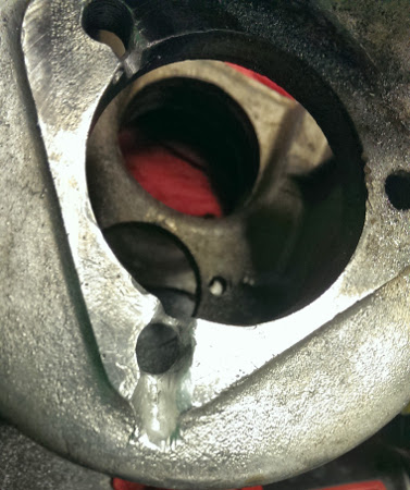

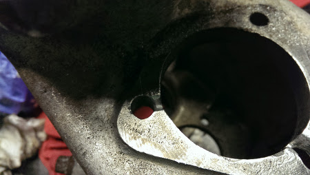

    From there we moved onto the Cracks in the casing.
    On the larger crack we drilled the end of the crack. Then both cracks were veed out.
    The directions for the aluminum brazing rod we had said to use a propane torch. After about 20-30 mins with the torch and no luck (this casing it thick!) we broke out the "real torch" and quickly heated the area up. We had to use a copper panel tool to keep the filler in place until the gaps were full. It's not the prettiest braze but it should do the trick.
    The case was too hot to finish grinding off the excess or re-drilling and taping the holes. So I gave one side a quick p*** on the wire wheel. We wanted to see if it cleaned up well enough to go under the car a nice bright aluminum or if it was too stained and needed to be painted black.
    Looks like it will be nice bright aluminum too me!

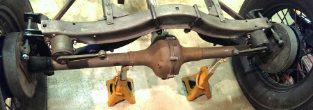

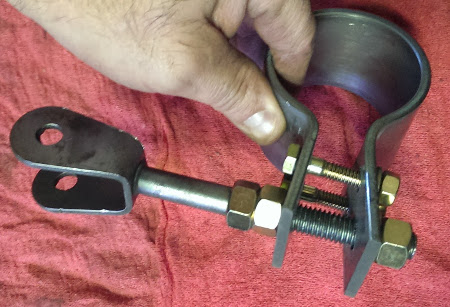

    Hello HAMB! We had a fairly productive weekend.

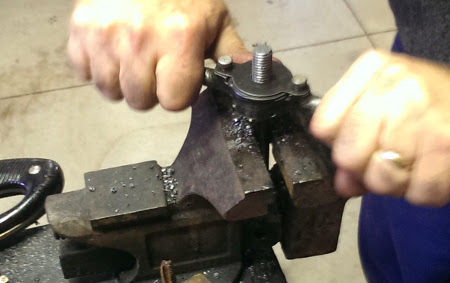

    When last we spoke we were talking about ways to connect the rear shock arms to the axle. Well after much measuring and head scratching The only thing we could come up with (that would fit without redoing everything in the rear end) was the Axle tube Clampy-Thingys that I posted in my poorly drawn sketch.

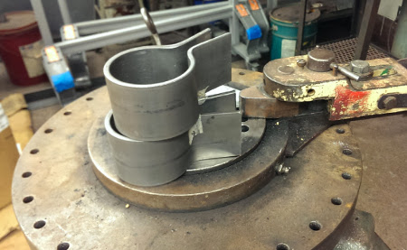

    So Saturday we recruited the help of our friend Caleb and we set to work on the Clamps. We went on a field-trip to the local high school's machine shop to use their heavy duty bender. Making tight bends in 3/16 x 2" steel isn't easy to do at home. Well to make a long story short we had to make a die that was slightly smaller in diameter then the axle tubes are. Good thing Caleb use to be a machinist. He was able to make the die we needed (after we made some other tooling to be able to turn the die on the lathe... Short of it. It took longer then anyone planned)
    But he was able to pull it off and we could get to work Bending stuff. Thanks Caleb!!!
    After a few minutes bending we had a pair of rear axle clamps....

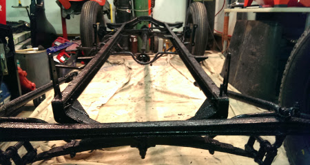

    Caleb really came to help paint the Frame... but didn't get to. He and Jim did get the frame cleaned / de-greased before we went off to make the clamps. And while Caleb and I finished the clamps Jim treated the whole frame with Ready Prep and rinsed it thoroughly. It was still wet when we returned (oh and Late!). At this point we called it a night and let the car Dry till the next afternoon.
    Here it is all nice and dry and ready to be worked with.
    Since we don't want to have to paint this thing again we Started by Wiping everything down with lacquer thinner.
    Jim's grandson was there to give us a hand.
    After that we started by painting the whole thing with Por15.
    Again we had help!
    In the end It looked good. But Por15 doesn't stand up well to UV. So we hit the whole thing with a coat of Bed liner.
    After one coat We still had about half a can left so... We gave her another coat!
    She looks Good!

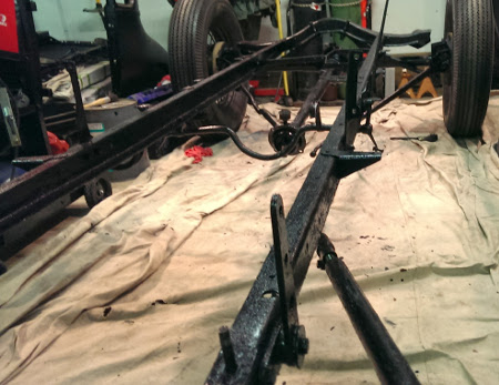

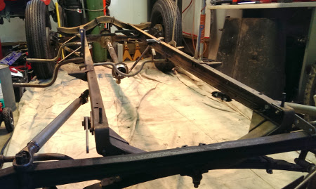

    We created some linkage to go from the axle to the Shock's lever arm. These started as the original dog bones for these shocks. We cut one end off and threaded the 1/2" rod to 1/2" by 13 tpi.
    While Jim was threading the rods I started drilling the bolt holes in the Axle clamps. We're running two 3/8" grade 8 bolts to supply most of the clamping force. The 1/2" rod will act as a backup.
    With all the holes drilled and Ros threaded we had to show you what we were thinking.
    We had to spread the gap open and give it a couple love taps with BARH (Big Rubber Hammer)to get the clamp on the axle. Everything else went together smoothly.
    Now that both are installed we'll need to spend a couple minutes with the angle grinder to clean up some of the edges. Then give them both a few coats of paint.

    At the risk of being named a pessimist, will the mounting not be a bit rigid, with only one pivot point on the mounting? It appears to me that the axle and the shocker arm will have slightly different places to go, during their respective journeys. A pivot, on the clamp, would eliminate this problem.
    Am I right or am I just a 'gl*** half empty' guy.

    Going by the good work you are doing overall it seems that the shock mounts could use a little extra engineering to match the rest of your work...

    I can see what these gentleman are talking about....and I have to agree, the single pivot link arm design may put extra stress on the threaded stationary end causing bending or breakage. I think the shock arm/axle mount link arm needs a second pivot where it connects to the axle clamp.
