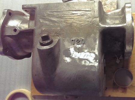

    So over the weekend we bundled up and headed into the shop. We were hoping to ***emble the aux trans and move forward. But on closed inspection we found a couple hairline cracks. So we did the right thing and Veed them out.
    After the aluminum was clean we broke out the torch and filled it back in.
    The cracks were very small and didn't look like they would have compromised the case strength, but we didn't want it to leak or change issues in the future.
    After all the torch work the case was too hot to do anything with (and we couldn't feel our toes anymore), and we need to spend some time de-goose turding the patches. The forecast looks better for this coming weekend so hopefully we'll get the case cleaned up. We're toying with the Idea of sealing the inside of the case with a coat of gas tank liner. As we were shocked by how much oil weeped out of the Aluminum as we heated it to repair things. Any body have any thoughts on this?

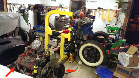

    Also I think I might have spotted something Odd in the Shop... What in the heck is Jim Doing now? :eek:
    Maybe Jim will get to more of that in a little bit, if we can get him to post again. :rolleyes:
    CBB
  7. xrw urabus
    Joined: May 26, 2010
    Posts: 49
    xrw urabus
    from ohio
    That looks like a flathead 8ba in front of a Model T? I hope it is used to help a good koz.
    Figure that one out!
    See, I can post.
    Jim

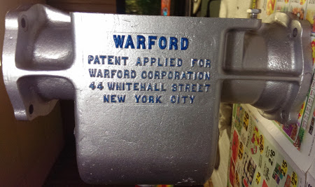

    It's been quiet here for a few weeks. That's because it's been COLD here. We also have had somethings that have come up (look for a new thread on that soon).
    But we've been moving forward with getting the Aux Trans cleaned up. At last time we looked there were goose turds hanging on the sides of the trans. After a goodly bit of filing the turds were gone.
    The brazing process had pulled a lot of trapped oil out of the aluminum and on to the surface of the Trans. This then burnt and discolored the casing in many places. So the next step was a short trip through the bead blast cabinet. A few tough spots were cleaned up with a rotatory tool and stainless wire wheel.
    Then the whole thing was cleaned with denatured Alcohol, till the coffee filters came up clean. Then the mating surfaces were masked off in prep for a couple of coats of paint.

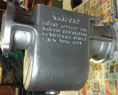

    Three coats of VHT engine paint (cast aluminum color) were applied to the casing.
    Well that looks right pretty and even...but it's missing something.
    A little Ford Blue will make that look better.
    Perfect!
    With the Casing dressed nice and ready for the ball we're hoping that we can get the Aux Trans re***embled and back in the car this weekend (that means the Engine and Drive shaft Too) With all the seals in place. That will be one big step closer to hearing her run for the first time...in 30+ years (ever for us).
    Once we get to that point we can get that Flathead ready to slip into the frame :eek:.... What can't sort out what's going on from the posts above?... Post a comment let us know what you think.
    CBB

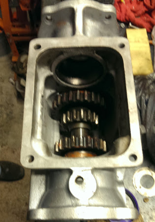

    Clayton... the gaskets or "shims" that were on this trans if you rubber the grease stains off I think you would find Corn Flakes or Rice Crispy's on them. They were just some homemade heavy paper/light card gaskets.
    We used cork this time... but it maybe to thick. There is ever so slightly a bit of end to end play in the jack shaft. So I may swap the cork out for some gray rubber gasket material we have in the shop.
    So the last time we tried to put the Aux trans back together you'll remember that I put the Jack shaft in backwards...:(
    That meant that it was Jim's turn to put it together. Took about an hour to make gaskets, cover them in some permatex. Insert the Jack shaft and get everything tight.... Then the upper shaft wouldn't go in correctly. Upon inspection That's right Jim installed the jack shaft backwards too! :eek:
    At this point we were out of time.. (spent most of the day getting the tire on my OT daily fixed after it was eaten by a pothole on the way to the shop).
    So at this point we're hoping that the third time really is a charm. The upside is that now I need to change out those gaskets...

    I put the AUX trans back together last night with the gear shaft in correctly. No gremlins in the shop this time! I put paint marks on the correct side of the shaft and marked the case, just to be sure. I hope I never see that gear out of the case again.:mad:

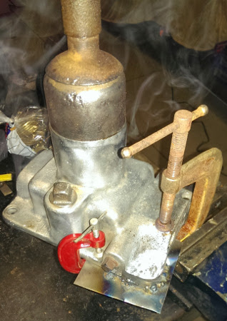

    We were able to get into the Shop one night this week for a few a couple hours.
    With the Aux trans going back together we needed to get the shifter cleaned up and ready to go back on it. One of the ears that bolts holds the shifter ***embly onto the top of the aux trans was broken off when we got it. (insert picture that I forgot to take here..:confused:)
    We've had such good luck with the Aluminum braze that we decided to rebuild the whole ear with it. The Ear are was wire wheeled clean. Then the damaged are ground with the rotary tool This was to make sure all the oxide and oils were removed. The Surface was not ground smooth. We also drilled a couple small insets into the aluminum to help give the filler some places to bit. A little form out of sheet steel to match the other corners was made up. Then we lite up the torch and fill the form.
    The whole thing was left to cool over night. Once it cools we'll start the clean up process and drill the mounting hole back in it.

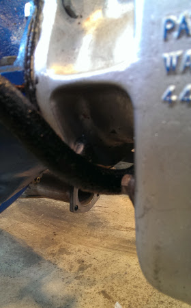

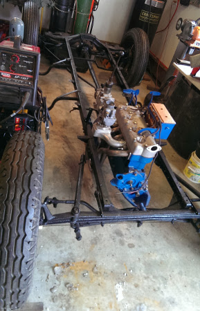

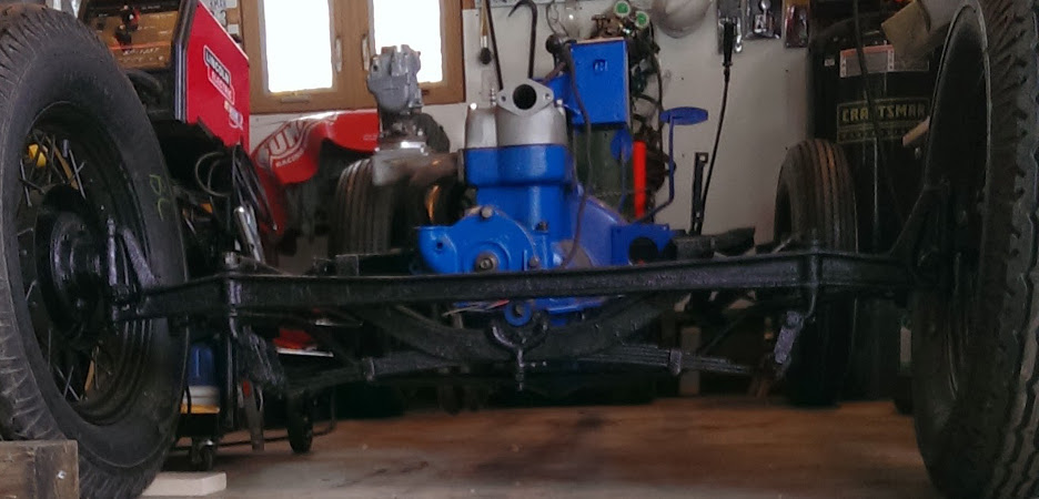

    We had a nice weekend! and we got some work done on the Car. It doesn't look like much but it took some time. With all of the mistakes and redo's we got the Aux Trans back into the Car. Along with it we have the whole drive line sealed up. We still need to pin the Drive shaft (it's drilled just didn't have a pin).
    We have ran into on snag. It seems that we've lowered the car so much that the Engine/Aux Trans keep the Brake rod from moving the full length on a stroke.
    Here's a look at the problem.
    We're thinking about remaking the brake rod with a larger arch to clear everything nicely. But we're open to suggestions if someone else has ran into this issue before.

  18. MrModelT
    Joined: Nov 11, 2008
    Posts: 2,745
    MrModelT
    Nicely done!
    As far as the E-brake rod is, it would hit the Warford anyway...whether you lowered it or not. Lowering the car has no bearing on engine or E-brake rod placemment.
    It won't interfere with the E-brake on position, but it will not allow you to put the lever forward to allow you to engage Model T high when you let the clutch out.
    If you intend to use it like a traditional T....you will have to modify it. I removed my lever all together and use my foot to hold it in neutral at stops.
    I still retained the cross-rod (unmodified) as it controls my Rocky-Mountain brakes...but it serves no other purpose.
    The lever removal also yields more room in the cab and easy egress from the driver side.
    Are you planning to run Rocky-Mountain brakes?
    Also....you might want to think about dipping the center of the front axle to allow access to the crank bushing. If you are running 12v....you will want to use the electric start as little as possible...as it puts real stress on the bendix spring. This is a problem on the "Special" and we will be modifing it's front axle very soon. We will have a "how to" up if you are interested in doing the same.

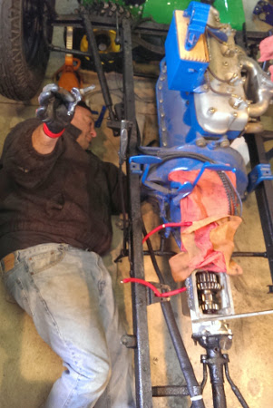

    Wow....we actually did something. I can tell you how it went.
    99 bottles of RTV on the wall.....
    Take the AUX trans apart.
    Clean and use 1/2 tube of RTV sealer.
    Put it back to gather (wrong)
    98 bottles of RTV on the wall.....
    Put it back to gather (correctly)
    Use 1/2 tube of RTV sealer.
    Put it all in the vehicle.
    That pretty much sums it up. RTV all over the trans, work table, us and finally in the vehicle.
    Jim

    Mr Model T. Thanks for the brake lever suggestion it makes sense to me. We are running Rocky Mt. brakes. That will be one of our next adventures as we install them. Also, our hand crank is accessible already without modification of the front axle. Just with the weight of the motor there is 1 1/2 in. above it before the axle would interfere. It is pretty low....for a "T", although it still probably has 1 foot of clearance. My other sports cars that are lowered have 3 or 4 inches of clearance. Low is relative to the vehicle, I guess.

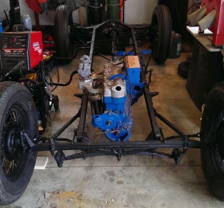

    Mr.ModelT
    This Photo is for you.
    As Jim Said we've got it low enough to clear the crank. As for the Rocky Mountains It's sorta silly to run an aux trans and not have them on the car. I'm Crazy not suicidal! :rolleyes:
    CBB
  22. MrModelT
    Posts: 2,745
    MrModelT
    That is a lot lower then I thought.....the other photos were decieving.
    You do have okay clearence....but you may have interferrence when the frame and body are on rebound. A good bump and it would peg the axle on the way back up.
    That is my only concern.....but you haven't set the body on the frame yet.....so it may sit lower still.
    I agree.....No Rockys and an Warford is a bit insane.....especially if you miss a shift, then you have ZERO brakes.

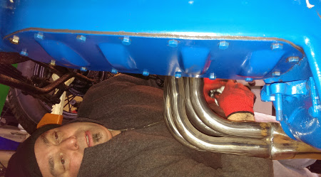

    Hi guys after being quiet for a bit we got back into the shop this weekend.
    We tackled 2 projects that needed doing for awhile. Sealing up the oil pan cover, and converting the starter from 6V to 12V operation.

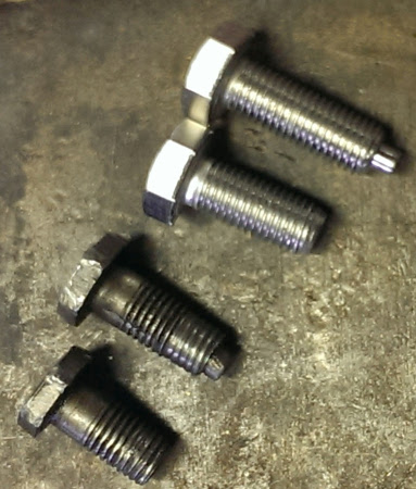

    When replacing the bendix ***emble we figured out that the old bolts were ****** to bad to keep using. (the bottom left 2 bolts) So we replaced them with the two in the top right.
    Jim also started singing 99 tubes of Permitex on the wall as he crawled under the car to seal the oil pan cover up.
    (For the Folks keeping score at home that's tube #4 that we've used thus far on the build.:eek: :D )
    What were The end results?
    1000pts if you correctly identify the parts of the motor that are missing from this photo!
    And proof Jim did some work. (cleaning the left over permitex off the motor)
    That was the weekend's work. If you questions on the starter rewire or comments in general please speak up. We'd love to hear them.

    Bruce, I think he just hexed us!:eek:
    Now we are in trouble.:rolleyes:
  30. sidevalve8ba
    Joined: Jun 16, 2009
    Posts: 2,697
    sidevalve8ba
    Uh-oh! Didn't mean to put a hex on your build. I have really been enjoying this build. My experience with T models is quite limited. It has been a real learning experience. Keep up the good work and I'll see what I can do on this end to undo any possible hex. :eek::D:eek:
    I'll have to save that string trick for future reference. Thanks.
