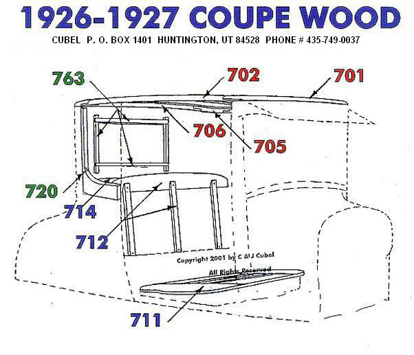

    Nice progress as usual. You are correct there isn't much wood in the '26-'27 "Improved" cars...door sills, tack strips, window surrounding Scripps, floors and seat frames are about it.
    Here is a quick drawing that should show all there is..

    I've figured out what this bit of wood it.
    It is the bar that goes across the car behind the seat. The hook on the top of the seat back slips down in the bit of metal in the middle.
    It also looks like we're missing a bit of steel for the seat back. (this photo is not of this car).
    I don't remember anything that looked like that. But I need to check one more place to be sure. I'm sure we can make a suitable replacement but I'd love to see some better pictures. As such this is the best photo I've found on the Model T forums.
