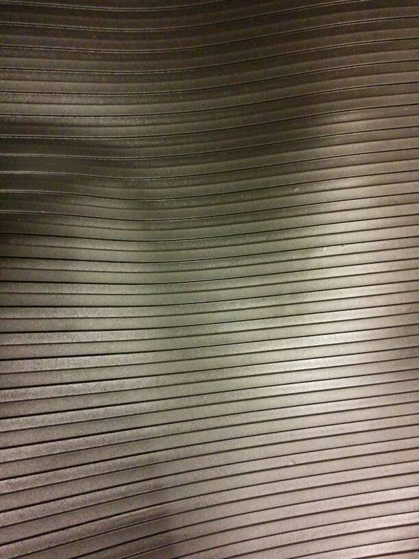

    You could always do what I did in mine...make your own. I went to my local hardware store and bought a 4' or 5' foot section of ribbed vinyl indoor/outdoor matting material for door mats and such.
    Traced out my floors on the back and cut them out. They look great and are durable. I know I have pictures in my albums of it.
  16. firepilot
    Joined: Aug 21, 2008
    Posts: 219
    firepilot
    Love the rag top, and I am stealing that idea MrModelT for the floor mats in my A.
    MrModelT likes this.
  17. MrModelT
    Joined: Nov 11, 2008
    Posts: 2,745
    MrModelT
    Here is what I did...
