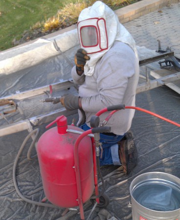

  7. Crazybillybob
    Joined: Nov 8, 2010
    Posts: 316
    Crazybillybob
    from Ohio

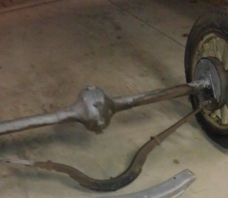

    Taking Full advantage of the nice weekend we managed to complete the Sand blasting of the Frame.
    The Hogshead, The Starter, both of the front wheel hubs, and a couple of parts that we missed from the Engine and pan (generator cover and oil pan inspection plate).
    The Rear Axle was started... but sadly on the second day of blasting, I ran out of Sand, Sunlight and Steam (I was beat) before it was complete.
    Now I see allot of painting in our future. (and a few more hours of blasting before the rear end will be ready for tear down, clean up and rebuilding).

    This weekend Started off with more Sand blasting. The Rear end is done!....

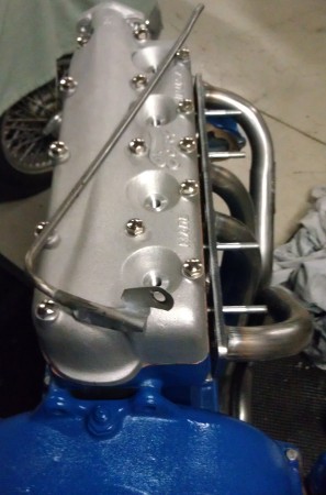

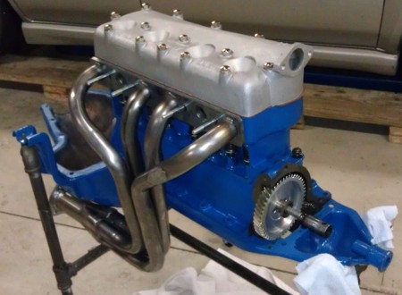

    With the big dirty stuff cleaned up we focused back on the Engine. We got all of the valves adjusted. As well as the Z head installed.
    To install the Head easily we set the engine back in the pan, temporarily. The Trans bands need relined before it get put back in the pan for good.

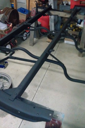

    We played Beat the rain and got the Hogs head Painted a nice Ford blue.
    And the Frame is now a nice black color

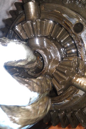

    So it's been a while since the last update. And I wish that I had a much bigger, Flasher update to make up for lost time.... But I don't. Truth is that with the Holidays, Work, and other responsibilities (other folks busted wrecks) We've not had as much in the garage as we had hoped. We are also to the point where lots of things need to be painted now! problem is we live in Ohio, and it's winter here so they tell me. The temps have been crazy warm for winter, but still low for paint. With the garage only heated by "portable" propane heaters, it takes a bit longer. With that said here we go with the real update.

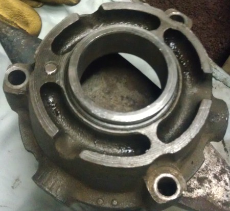

    Once we cleaned all the old gunk off the Diff parts we found a minor issue.
    Can you spot the Problem? If you said the pin that holds the thrust washers is sheared flush your Right! Good thing is this car was not run much like this. All the castings and axles are free of the grooves worn in them you typically see when this happens! Replacement pins have been ordered and will get installed once we get everything ready to re***emble.
    We also started taking steps to get the motor ready to start for the first time! We Relined the Transmission bands.
    The old bands looked like they were in ok shape. But they are cotton and have been submerged in some nasty old oil and water type sludge for more years the we feel is safe. So into the trash they go.
    The new Kevlar bands were riveted to the bands ends first. this leaves a little bubble of material in the middle of the band.
    The bubble gets worked out and the last rivet gets installed.

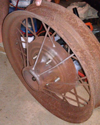

    A while back your remember that we were trying to Sand blast some Model A rims to use on this Project.
    Well after using 150+ Lbs of sand and only getting 1/3 of one wheel sorta gray. We gave up. The Wheels went to a local sand blaster / painter that does heavy equipment. They spent sometime with a BIG sand blast unit and BIG pile of sand. Also they came back nice heavy, industrial sealer primer.. in black of course.
    The Wheels are not perfect but are already for some paint and rubber.

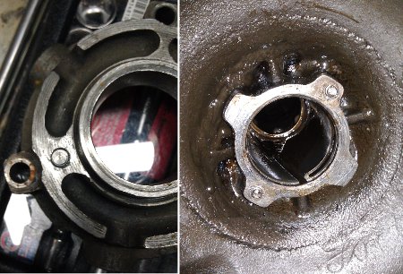

    I got a little done this weekend..And Messed Up A lot!
    The New Thrust washer Pins are installed. Here's a little tip, don't break your tap off when trying to remove the old pin! (it's a mistake that took 2.5 hours of drilling to learn :D )
    So I was on a roll, and wanted to get the Engine ****oned up. So I fixed the few bad rivets we had on the trans bands and got the Hogs head to pan seal all siliconed up and the hogs head bolted down.
    That's about the Time I turned back to the work bench, moved a manual and a rag and found this.
    Yea, That's the inside Oil line....Outside the motor :eek:.
    The Only saving grace is that I only have silicone on one side of the cork gasket and the bolts are not overly tight. So with a little luck and some delicate removal we should be able to save the gasket, once the silicone that's there is dry.
    Needless to say... At this point I gave up for the day:mad::D

  28. 29pu
    Joined: Oct 31, 2008
    Posts: 159
    29pu
    Man that`s not good.Your going to have to take the hogs head, pan and trans off to get that oil tube in.Bummer.Are you going to run an outside oil line also?
  29. Crazybillybob
    Joined: Nov 8, 2010
    Posts: 316
    Crazybillybob
    from Ohio
    I'll have to pull the Hogs head and the Trans off. The Inspection cover is still off the Pan so I think I'll be ok there, with the block on the pan...but we'll see.
    We are running an outside oil line. The One we picked up replaces the Magneto post and a bolt in the timing cover with hollow tubes. Then an 1/8th copper tube joins the two.... Maybe I'll put that on when I'm re***embling everything... That way it will not feel like 3 steps back :)
