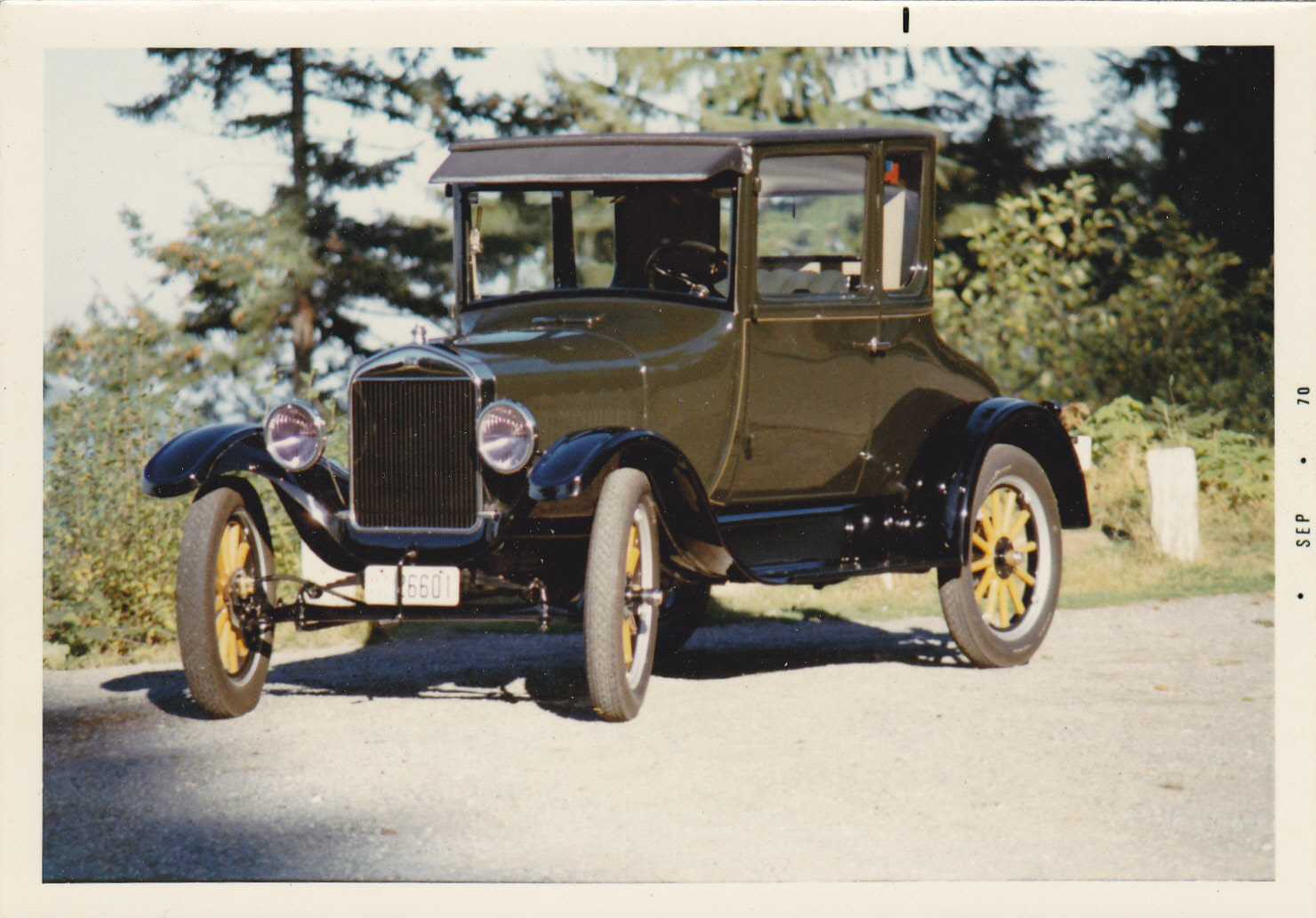

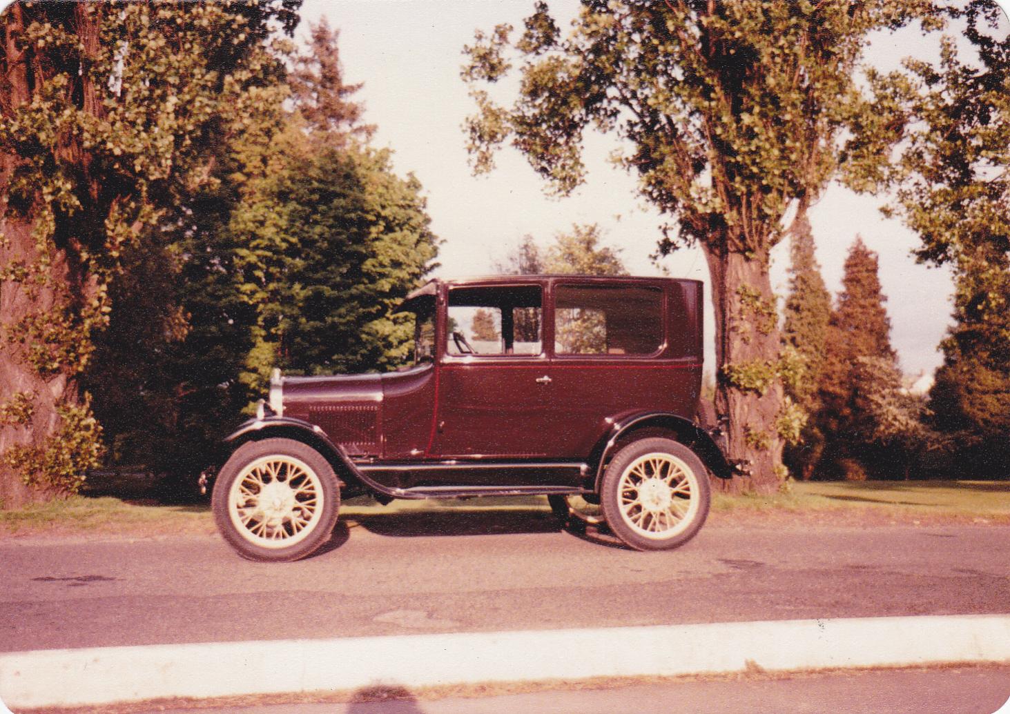

    This is a couple of photo's of my Model Ts that I restored 40 years ago.

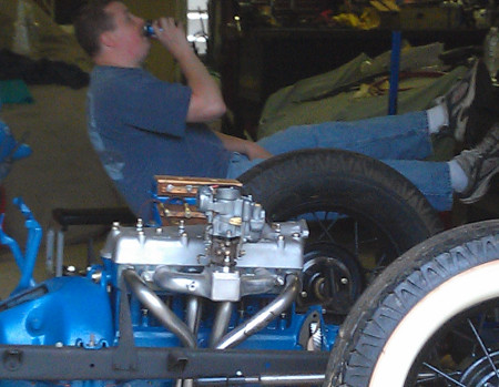

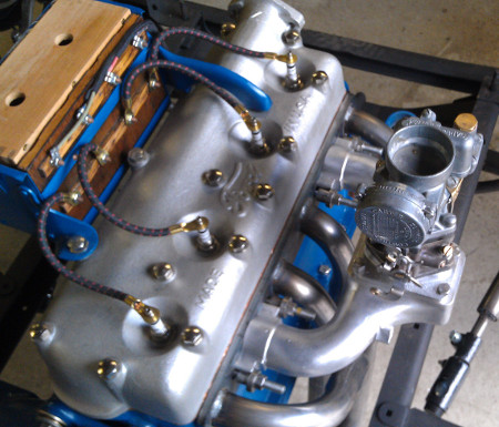

    On the Front of the car the Exhaust, and the intake manifold are getting some love.
    The Exhaust header is a simple mount, because this Red's header is designed to fit a Model T. The Hard part is getting the Aluminum Model A intake to bolt up tight as it's what keeps the header in place. To get this all fitting correctly we had to make up some Spacers. We used sections of the old Tie Rod turned down and Shouldered with a heavy washer on top to accomplish this. The Studs that screw into the Block also had to be modified, as the threaded are on them was not long enough to hold everything tight. That was a simple task with die.
    Everything was Test fitted and looked like this.
    The Model A Intake is designed for a Two barrel Carb. We will be running a one barrel Carb. So the area in green will be removed (think hole saw). We also have a one barrel to two barrel adapter that we will be flipping upside down to finish the fit.
    As normal we got caught up in building and forgot to take pictures of all the steps. So We'll skip Right to the test fit.

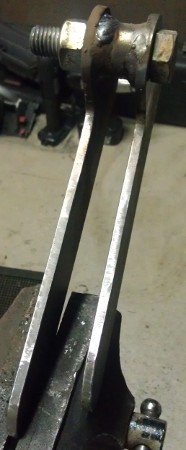

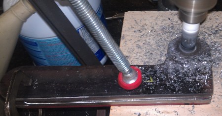

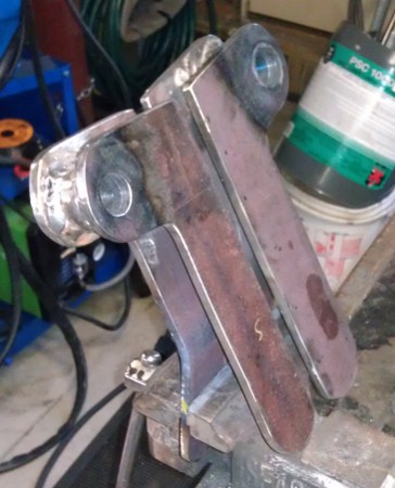

    We've totally restarted the rear spring drop shackles. It now is a more angles design made out of 1/4" plate instead of 3/8" plates.
    The Build was the same. We started by cutting out the shape and drilling the main through hole that the drop will hang from.
    A section of 1/4" walled tube was welded between two of the plates.
    We used the 3/4" bolt seen in the above picture to align the plates and the tube and hold it all tight for welding. The longer plate will be bent to add space for the Spring.
    Bending was accomplished by heating and bending.
    Here are the new drops all bent and ready for some clean up. The Old drop is on the Right to show the difference in the designs. The new ones are each a couple of pounds lighter then the Mk1...
    That's where we're at currently. We've done some quick test fitting and things look Promising but we really will not know for sure till we get all the holes drilled and these babies under the car.

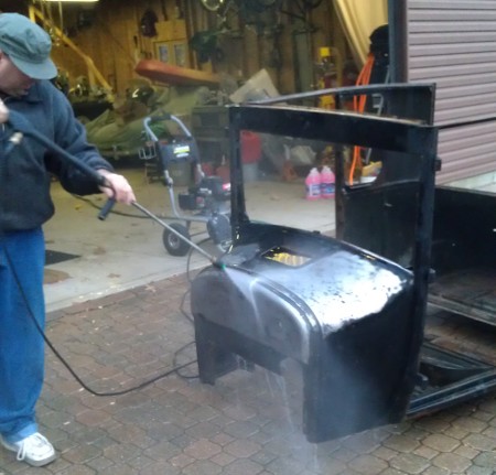

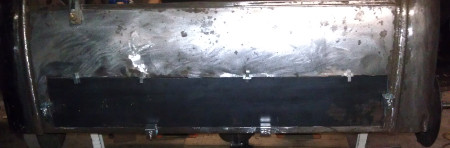

    Like I was saying a few weeks ago Lizzy got her first bath in years (at least the 2 years we've had her, and based on the dust a decade or so longer then that )
    We hosed mud off of most of the bottom. and some of the inner panels. But the old girl looked good after the bath.

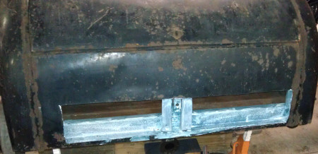

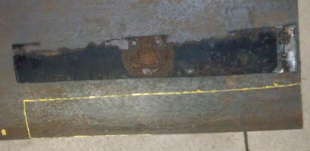

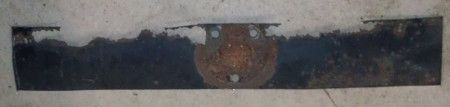

    This Friday I started on the Rust repair. We're also removing the spare tire mount in the process.
    So Step one Layout the where the cuts are to be made.
    Step 2 Cut.
    By the time you see this on the floor...it's too late to turn back :)
    The Hole.
    Some converter applied to the hard to get too areas.
    Then the sanding starts..... Hours later.
    The old paint is gone. Notice the dent in the P***enger side rear fender gets bigger? Well that's because it was filled with mud at some time in the past then painted over....I mean MUD not bondo, or filler, dirt and water. Mud covered in paint:eek:.

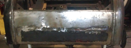

    Now a patch panel is made..(ok it took 2 tries to get it fit right..)
    The rear has a slight crown in it so we ran the patch through the English wheel a couple of time to get it so fit nice.
    Then it was clamped into place
    The next photo may offend any "real" welder out there so if you have small children you may want them to leave the room before you look at it.

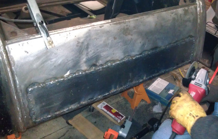

    We welded the patch into place. With much trying and some geese pooping along the way. we also found every thin spot in the old body too :rolleyes:.
    At this point we checked the clock and it was 3:30am.... Time for some sleep.
    On Sunday I got to pay for my welding crimes.... by Grinding. Alot!
    Then I filled pin holes.... And Ground some more.
    So That's where we're at...We know that there are some dents that need worked out of the rear. Some where there when we started some we added but that's why we didn't pop the originals out before hand. All in all I don't think we did too bad for it being the first patch panel either of us have ever made or installed. By the end I could even lay a nice flat bead...If only I had started that way I would have saved the lives of several young flapper wheels :(.
