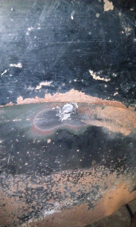

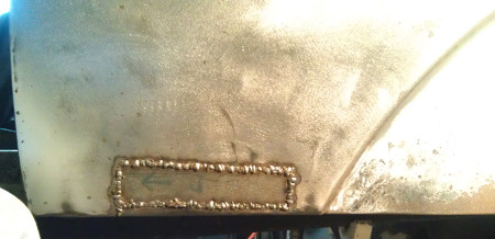

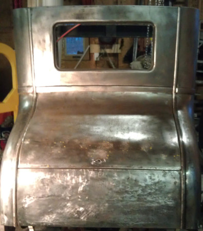

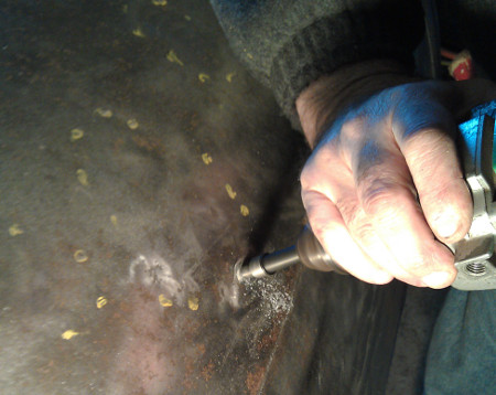

    Mid week update (ok it's the end of the week...but we did the work mid week).
    Since we're not running fenders, or aprons we have all these holes in the body. Model T's leak enough without extra help. So We're going to close them all.
    The Holes
    So first you mix up a big batch of bondo....:eek: not on this old girl...
    We knocked out some sheet metal plugs.
    And welded them into place.
    Found a spot or two of rust here too. About the size of a 50 cent piece it got cut out and a patch welded in place as well.
    I also spent some quality time with some body hammers and dollies on the rear panel. (you remember the one we abused with the welder that last time).
    It doesn't photograph as nice but 80% of the dents are knocked out of the top section. Still need to go back through and smooth out the hammer marks but I'm really happy with it. This was the first time I've ever used a body hammer and dollies. I watched a youtube video and read some articles on it... figured I'd give it a try. A bodyman I'm not, but it's a heck of a lot better then 1 1/5" of bondo :rolleyes: I'm going to try and work out the hammer marks and get it as close as I can but I'm pretty sure there will be some filler in this panel ... I can live with 1/32"-1/16" but no more! If you have some tips or tricks please let me know...I'm guessing here.

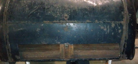

    Over the weekend we got some work done....Not a lot of Photo friendly stuff but here we go.
    I spent several hours sanding down the rear half of the p***enger side of the car. At this point I think 3/7th of the car is sanded down.

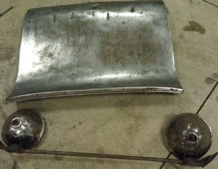

    We also dug all of the ***orted parts out of their hidey holes for inspection and paint prep. We started with a pile like this.
    and after a couple hours and a broken dream
    we have a pile like this
    We also pulled out the sun shade / visor and It looks like someone built part of it out of tin (roof flashing?) at some point in the last 86 years. But We're not 100% sure this is not what it should like then it gets covered in leather / roof covering material. Any thoughts?
    I also spent a few more hours bumping the dents out of the rear panel... but that doesn't photo well.
    We also found a couple more rust holes behind both doors that will need to get cut out and patched. Hopefully our welding has improved and this will not hurt so much :)
    Let us know what you think.

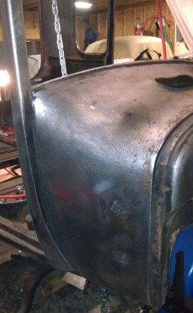

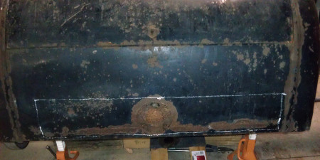

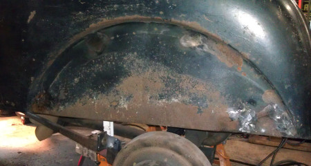

    Here's another lite midweek update.
    Jim Spent some time behind the sander this week. He got the Driver's side rear half cleaned up and ready for a little body work and paint.
    Behind both the doors we found some rust. It had to come out!
    [​IMG] [​IMG]
    SPARKS!!!
    We were left with these.
    So we have more welding in our future. Hopefully the warping will not be as bad this time....:D maybe we should pay the welders a little better :rolleyes:

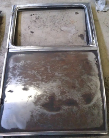

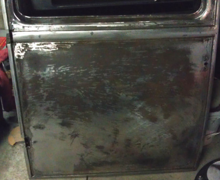

    We both had somethings get in the way over the weekend so there were only a few hours spent in the garage. But we tried to make the most of them.
    Jim Started on the Doors. These were fun because there are several coats of paint on them. Why there the only things with Red paint on them is a mystery.
    But with a little work and the trusty DA Jim was able to get it all off.
    The result at the end.

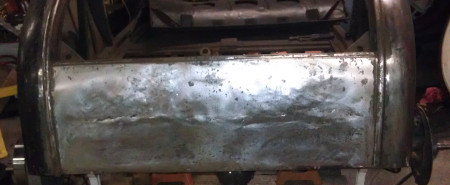

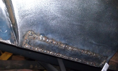

    I worked on the drivers side patch.
    By some miracle I didn't warp the body this time. Tried a new method of lots of little tack welds instead of trying 1/4" welds this time.
    That's where we were at when we ran out of time. Hopefully through the week we'll get a night or two to work on it and get things closer to paint in time !

    Those doors are AMAZING! :eek: Doesn't look like there is a speck of rust anywhere on them! Great find! :D
    Nice work on the body patch...a little bit of grinding and finessing and you won't even be able to find that patch :D

    The brown smears on the doors is really odd. It was way down under the primer and it's 100% smooth doesn't feel like rust. It's like the metal was stained when they put it in the press to form the skins. Even the patterns it forms looks like it's been pressed. We've got one dent in that door that needs bumped out. but I'm not sure we're going to sand all the brown off. My just marine clean, ready prep and paint with por-15, prime and top coat black.
    As for the patch thanks for the complement. Lets hope I don't slip with the grinder :)
    CBB

    Quite possible the stains were caused by "Drawing Oil", which was used for lubrication on stampings and pressings. My guess.
    Impressive work!

    While he was working on all that I ground down the welds on the Driver side body patch.
    I also got the patch welded on the p***enger side.

    I finished up the p***enger side patch.
    And fought some pin holes in the Driverside wheel well.... Pin holes ****!

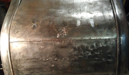

    Here is the consolidated pictorial version of what we have done the last few weeks.

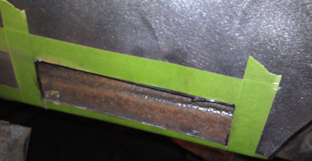

    At one point in the past someone "popped" the trunk lock with a screw driver. and ruined the sheet metal around the lock. We filled this area with new metal. and Re-drilled the lock keyhole. First we used a "roto-broach" to create a nice round hole.
    Then hand filed the bottom Slot of the keyhole.
    After that we wanted to test the fit and alignment of the Trunk lid and rear window frame. Once things were bolted in we found that everything fit well.

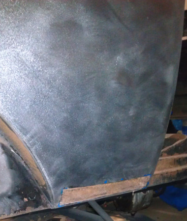

    We set off to fill the low spots in the rear end.
    Bondo was applied.
    Bondo was sanded.
    Bondo Fell right off the Rear!! :eek:
    It blew off when we used the air blow gun to clean the bondo dust off.
    We prepped the area by roughing with 30 Grit sand paper, wiping the dust off, then wiping it down with lacquer thinner. This was the third batch that we mixed from the can. The other two batches were applied on the same panel... They stuck fine. We're guessing that this batch was short hardener and we didn't leave it sit long enough for the temp of the shop. All the bad Bondo was s****ed off the panel. the panel was re-prepped and Bondo was reapplied. We then left it sit for 24 hours....over kill but the shop isn't heated well. We didn't have anymore issues when we started using these procedures.
    I was also able to bump the dents out of the the P***enger door, so we will not need to add any filler here now. Just sand the rest of the door down with 80 Grit and paint.
    As always let us know what you think or if you see anything really wrong!
    CBB
