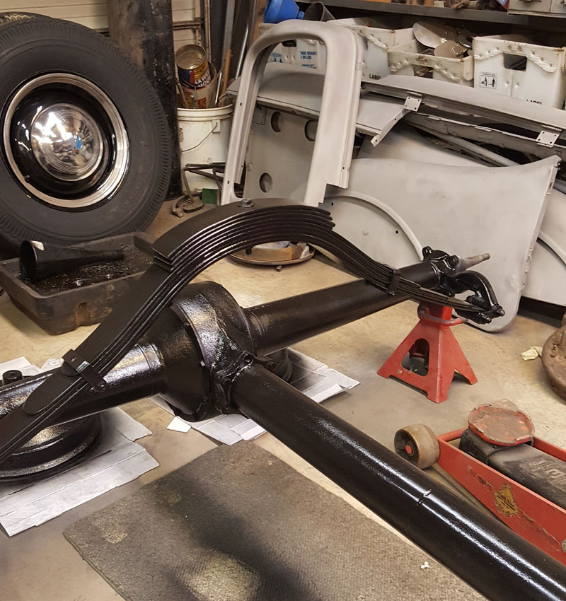

    Ok time for an update. What's this? Freshly blasted ch***is bits.

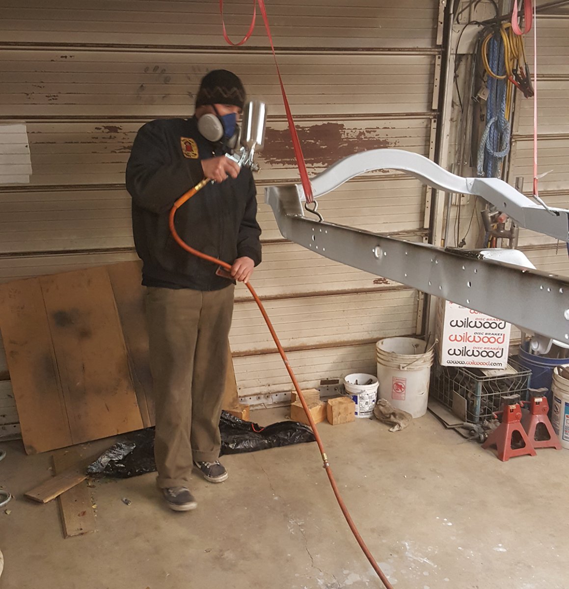

    Etch prime everything.

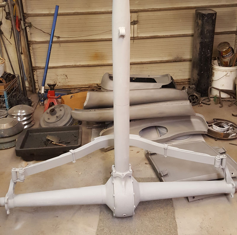

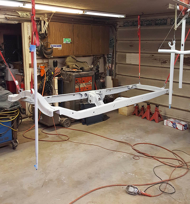

    Prime and paint some more stuff

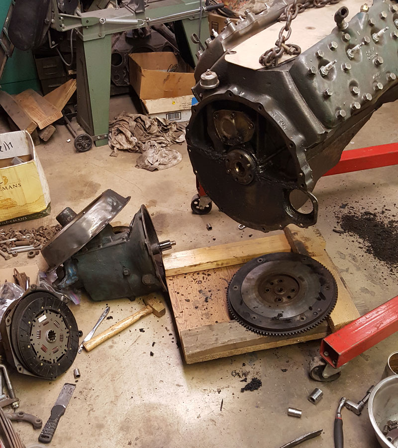

    Time for the block. Guess we should clean this up.

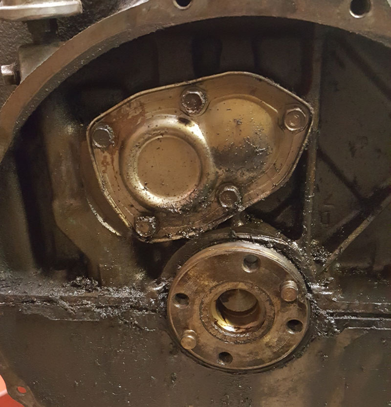

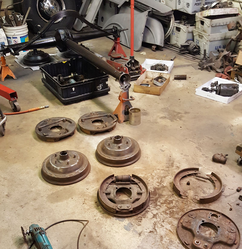

    More cleanup and paint.

    Hot tank the really gross bits:

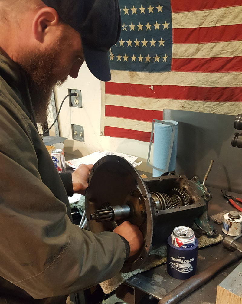

    While were here may as well rebuild the box. Thanks to my pal Pineapple™ and Meteor Motors® for the expert ****** work. And thanks to our Koozie sponsor Ron Barbarino and the Iron Lords™®©.

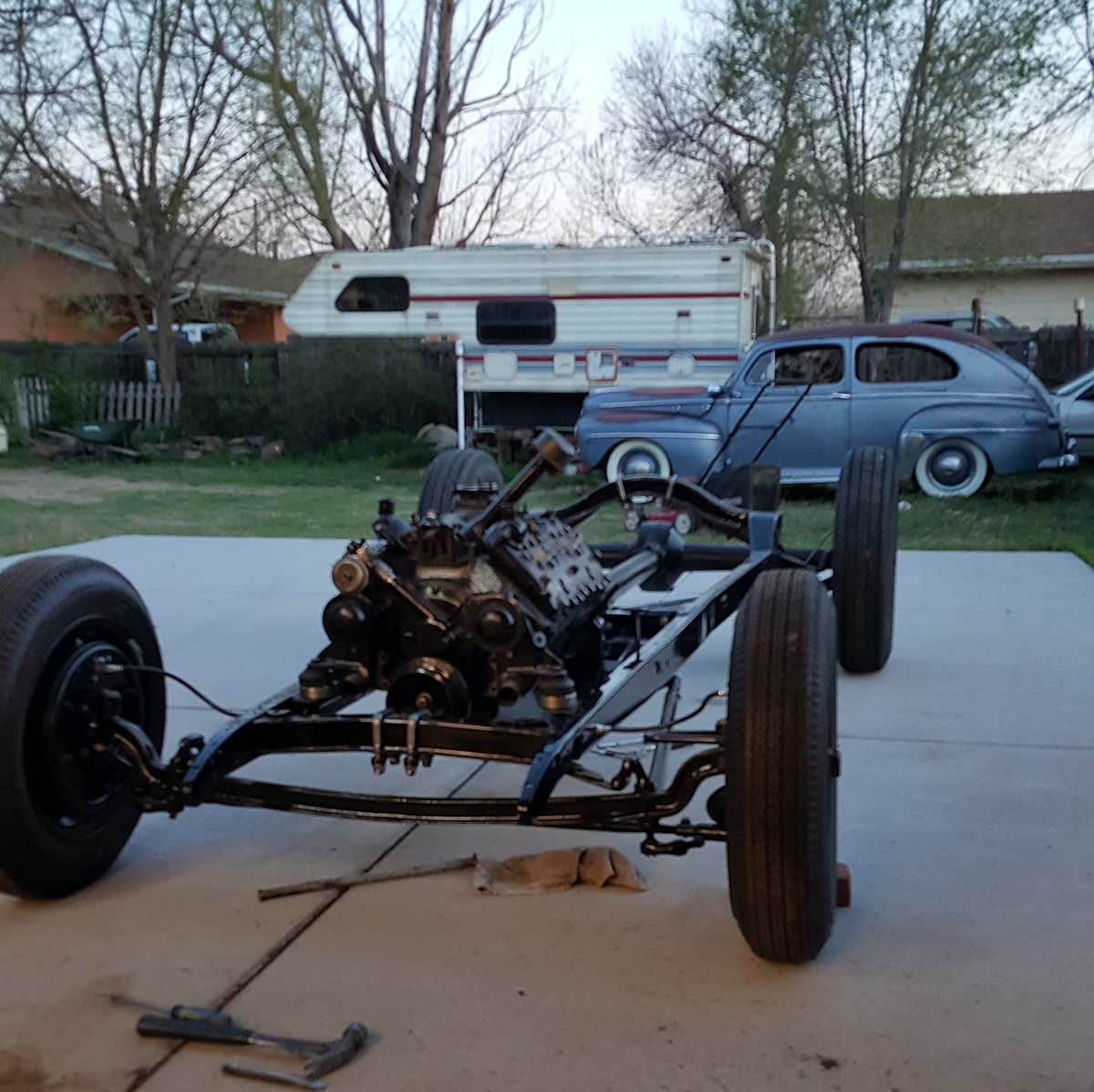

    A little mockabilly action to see how everything looks. Not completely sold on the Edmunds LEGO manifold anymore but we'll see how things shake out.

    Hey time for an update! Thanks Alan haha. Heres 15 years of progress in 10 pics or something.
    20170622_233639_001.jpg 20171023_010146.jpg 20171023_010211.jpg 20171103_200411.jpg 20171104_104209.jpg 20171201_003615.jpg 20171210_162126.jpg 20180102_224900.jpg 20180221_000806.jpg 20180504_200021.jpg
