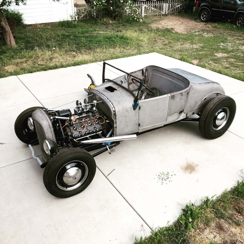

    Somewhere in there I put the shock mounts and headlights back on and rolled it outside for another look. A64174D7-AE22-4584-BCB6-A7FFF1FE7520.jpg
