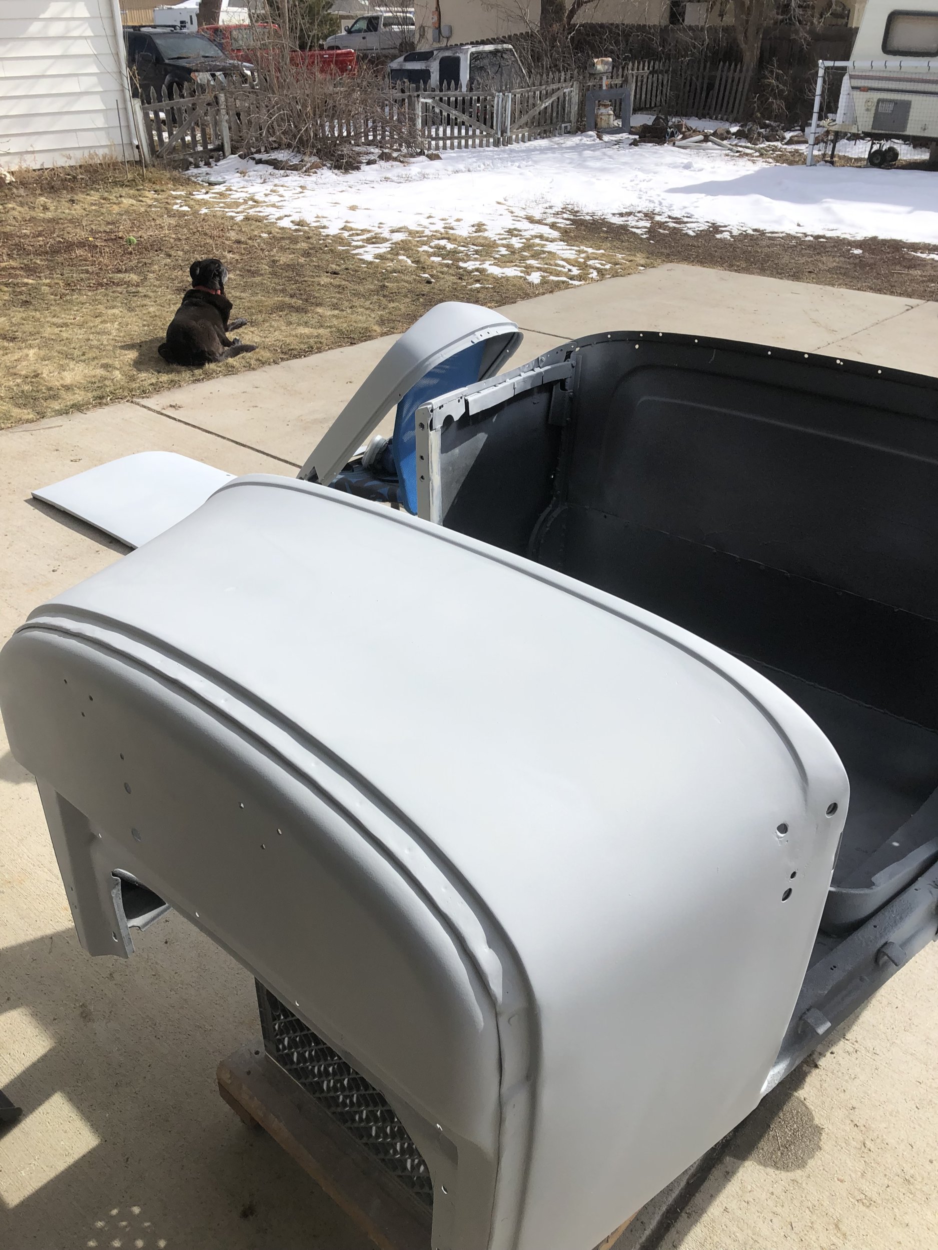

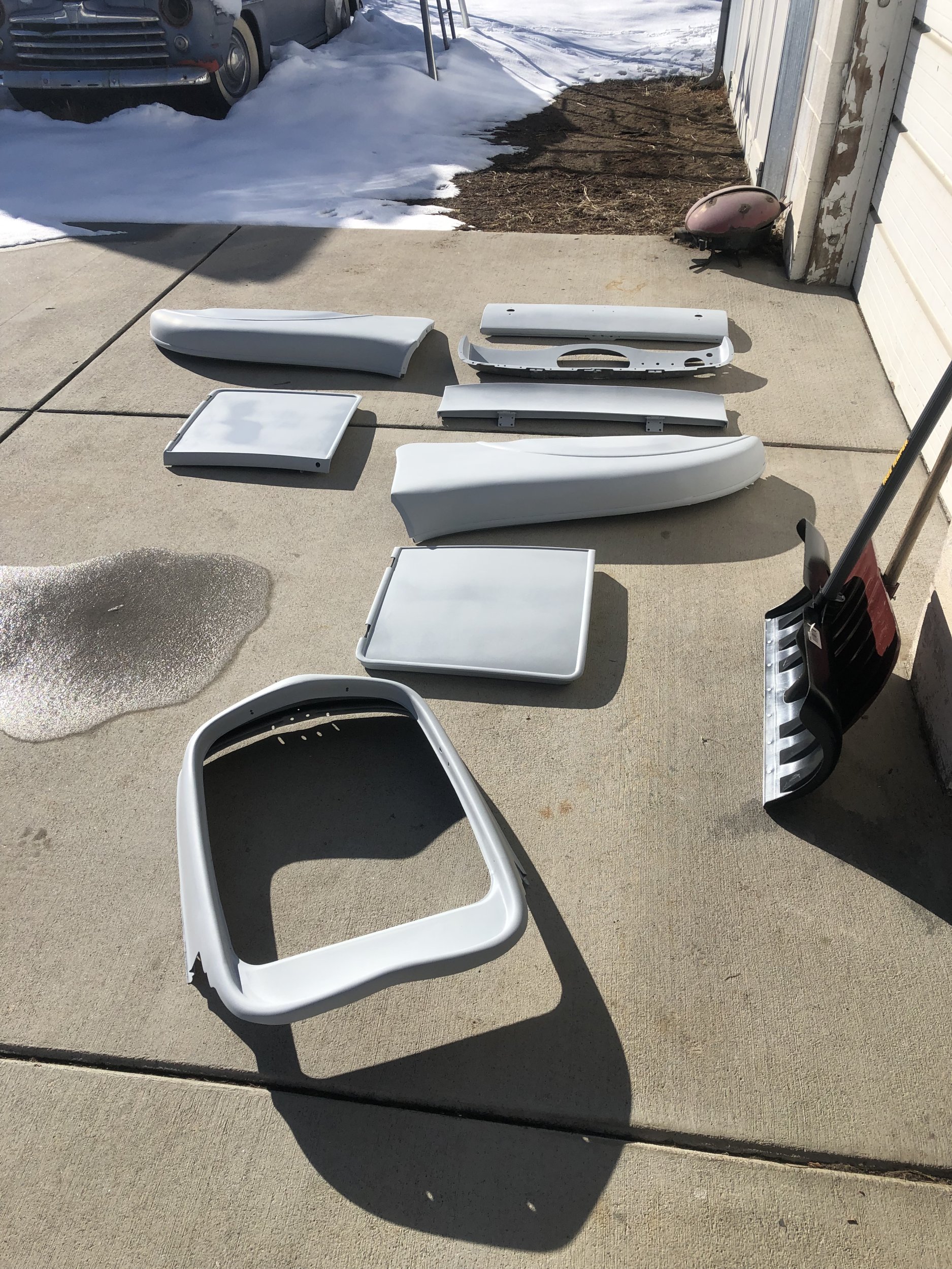

    Hey! Gonna try and catch us up to where this is now. We left off in the fall of 23 when I was doing bodywork. Finally getting everything in primer. 72938121831__6DB32379-D234-45D8-B2D9-78BB75C9D857.jpeg

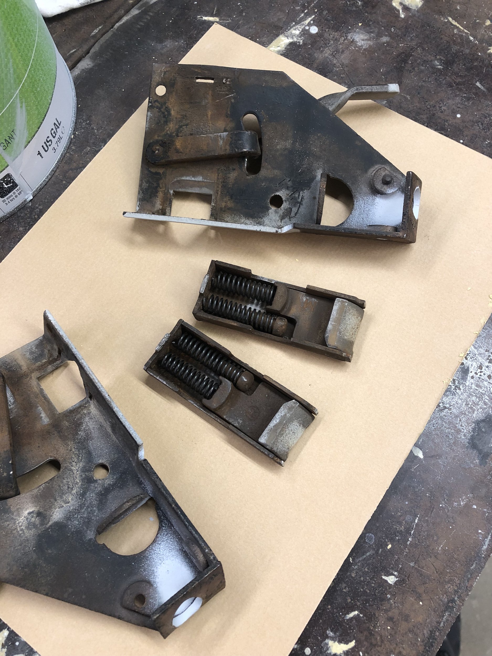

    Had to rebuild my door latches, they were broken and full of sand. Got some help from Bert's Model A parts bin. 73267765757__72F321C5-C75F-4AF8-9A2D-5A2F0AC99253.jpeg

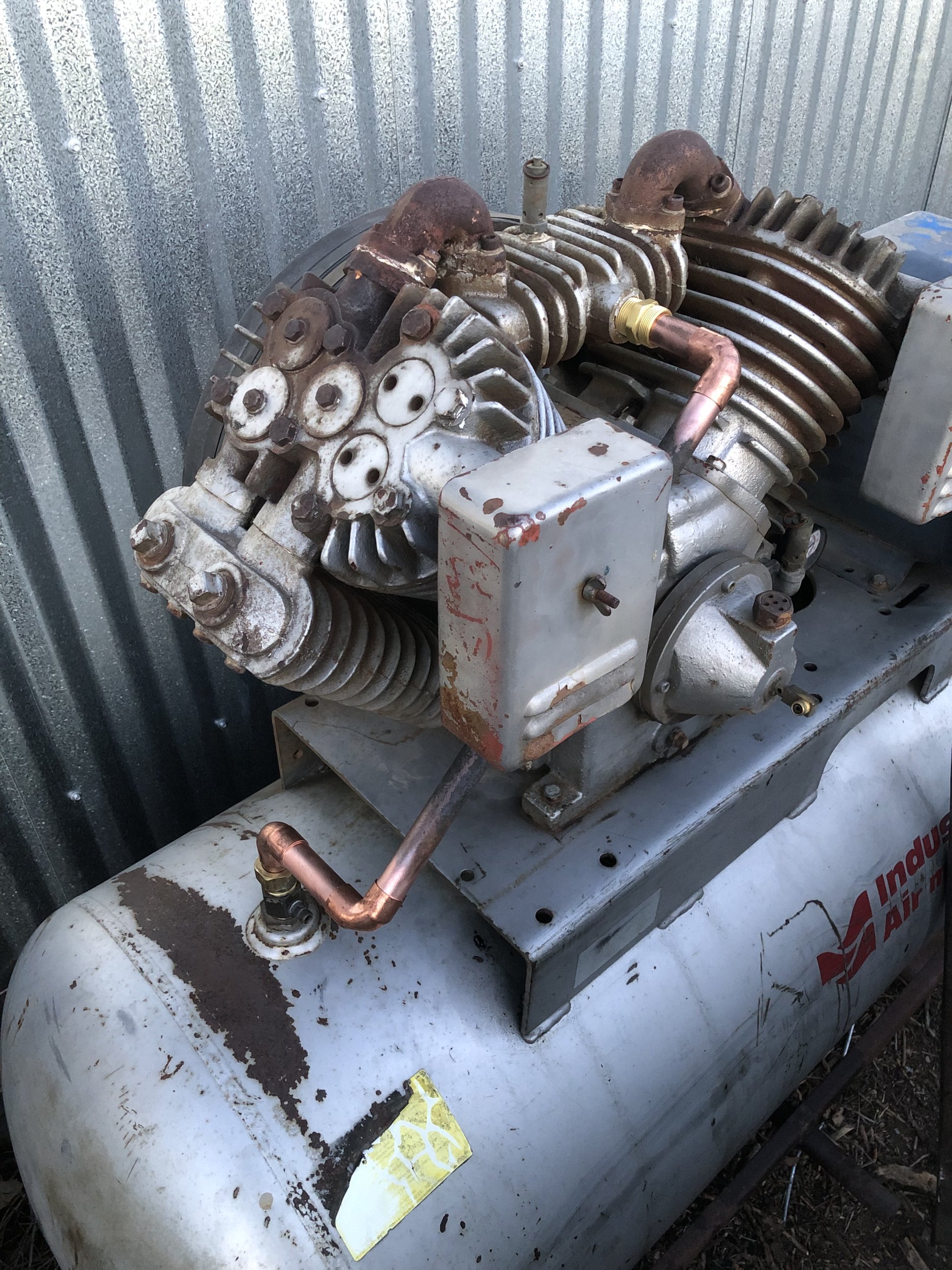

    My old compressor could not keep up with the paint gun so I had to install this vintage monster I got from a buddy. This probably took another couple months to wire and plumb before I could paint. Thanks to @PINEAPPLE and Alan for the help! 73501114505__D931F1DB-779F-4276-9538-9AB84B9A8A53.jpeg

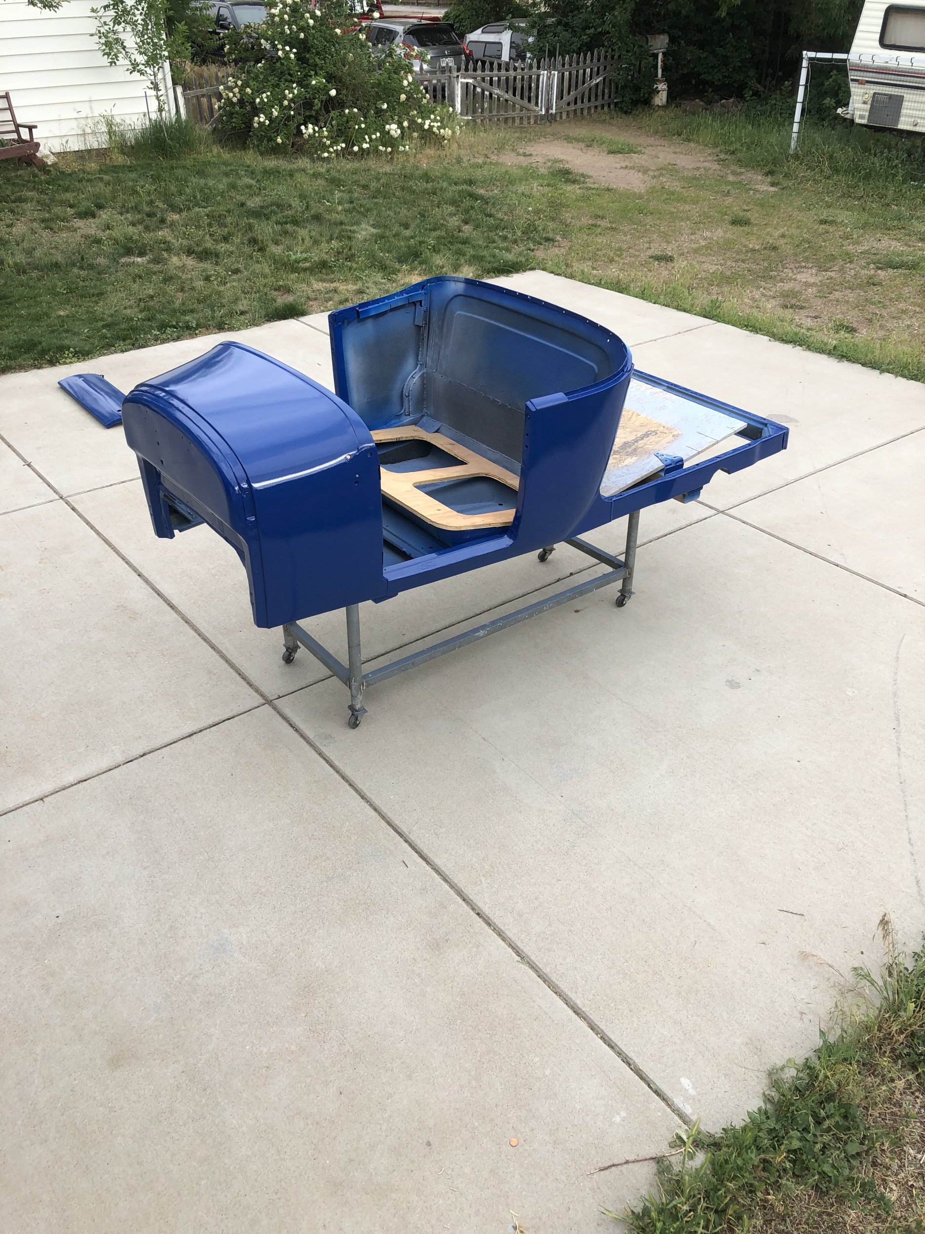

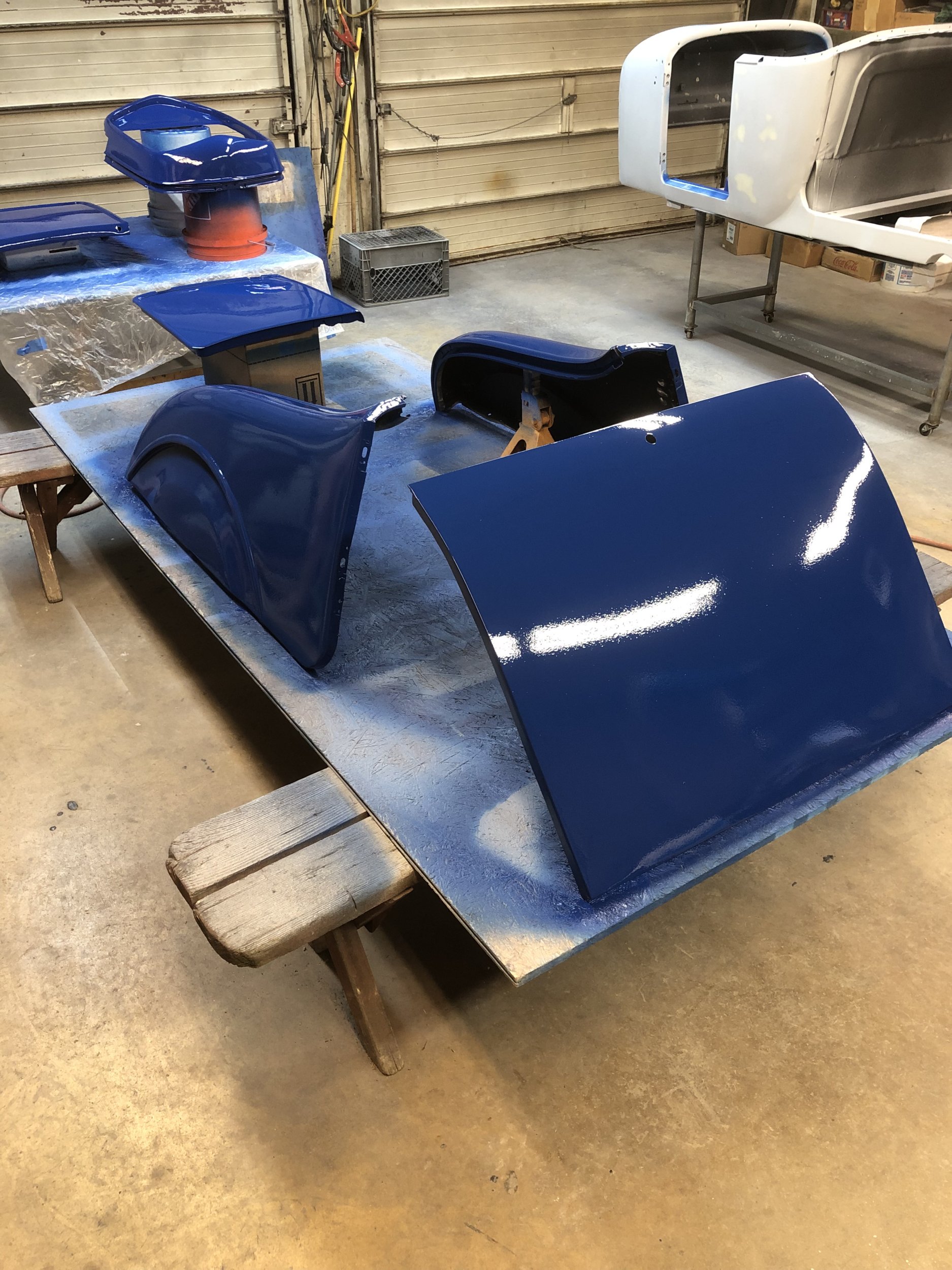

    I am not painter and this was my first time painting anything other than the frame so it was a big couple days to get here after months of sanding filler and primer 73837831651__2C08F8C3-DB8C-46EF-80AB-BE08893BD4C7.jpeg IMG_8196.jpeg

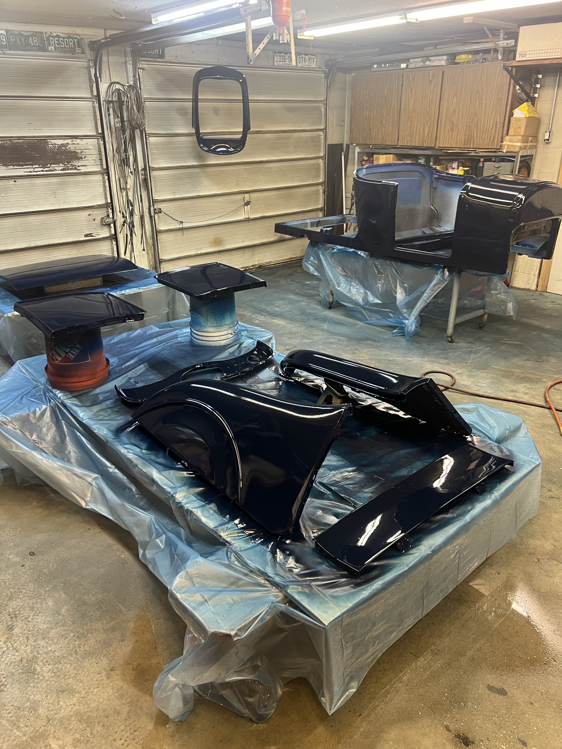

    Sadly, when I got it outside and in the sun, it was pretty clear this was not the color I wanted. I lived with it for a few weeks but ultimately decided I was never going to be really happy with it and I was going to reshoot in a darker color. I spent weeks trying to find a car or paint code I liked and was really coming up empty. Eventually I saw photo of a car at a local show on instagram and a friend of mine was standing next to it. I called him up and got the name of the car owner. He actually still had the old can of paint in his garage and was able to give me a paint code. I sanded everything back down to scuff it up and shot it again. I will never regret this choice. IMG_8990.jpeg
  14. h.i.
    Joined: Jan 29, 2007
    Posts: 489
    h.i.
    from denver

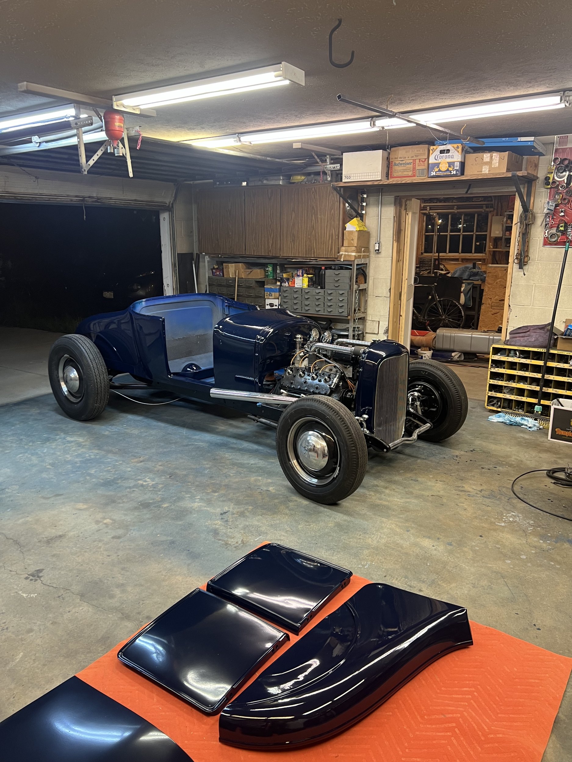

    Good from far, far from good. Let's get it back together! IMG_8993.jpeg IMG_8994.jpeg

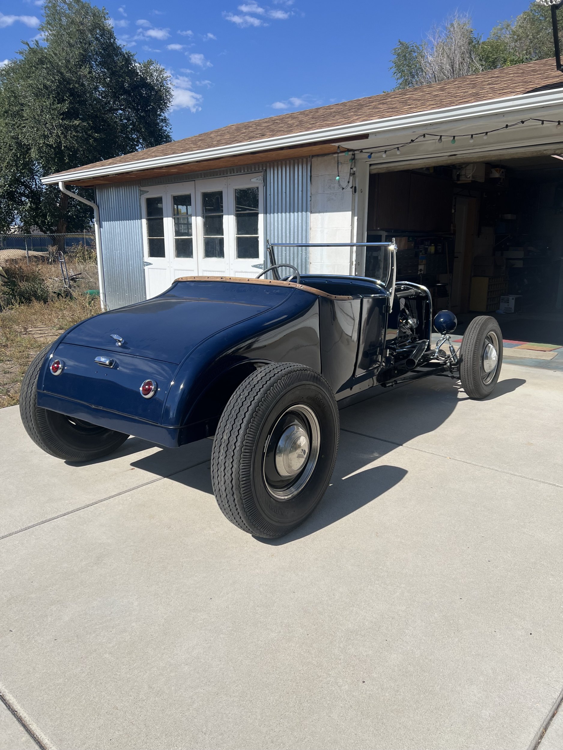

  16. h.i.
    Posts: 489
    h.i.
    from denver

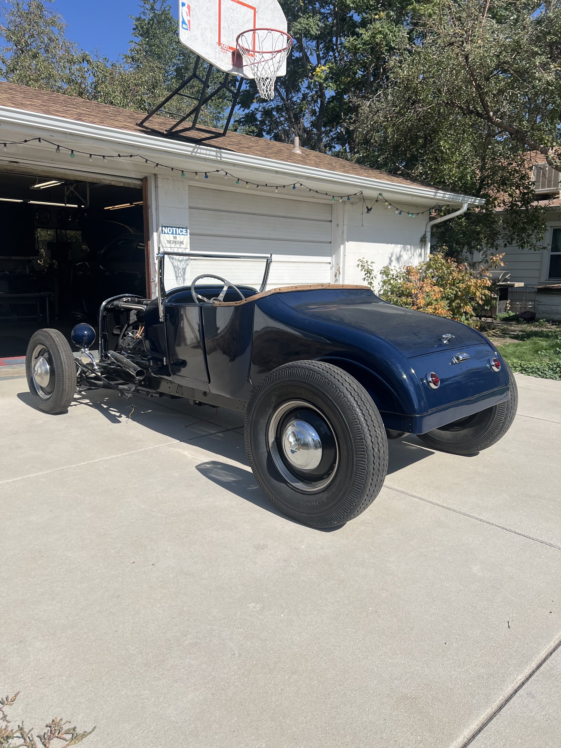

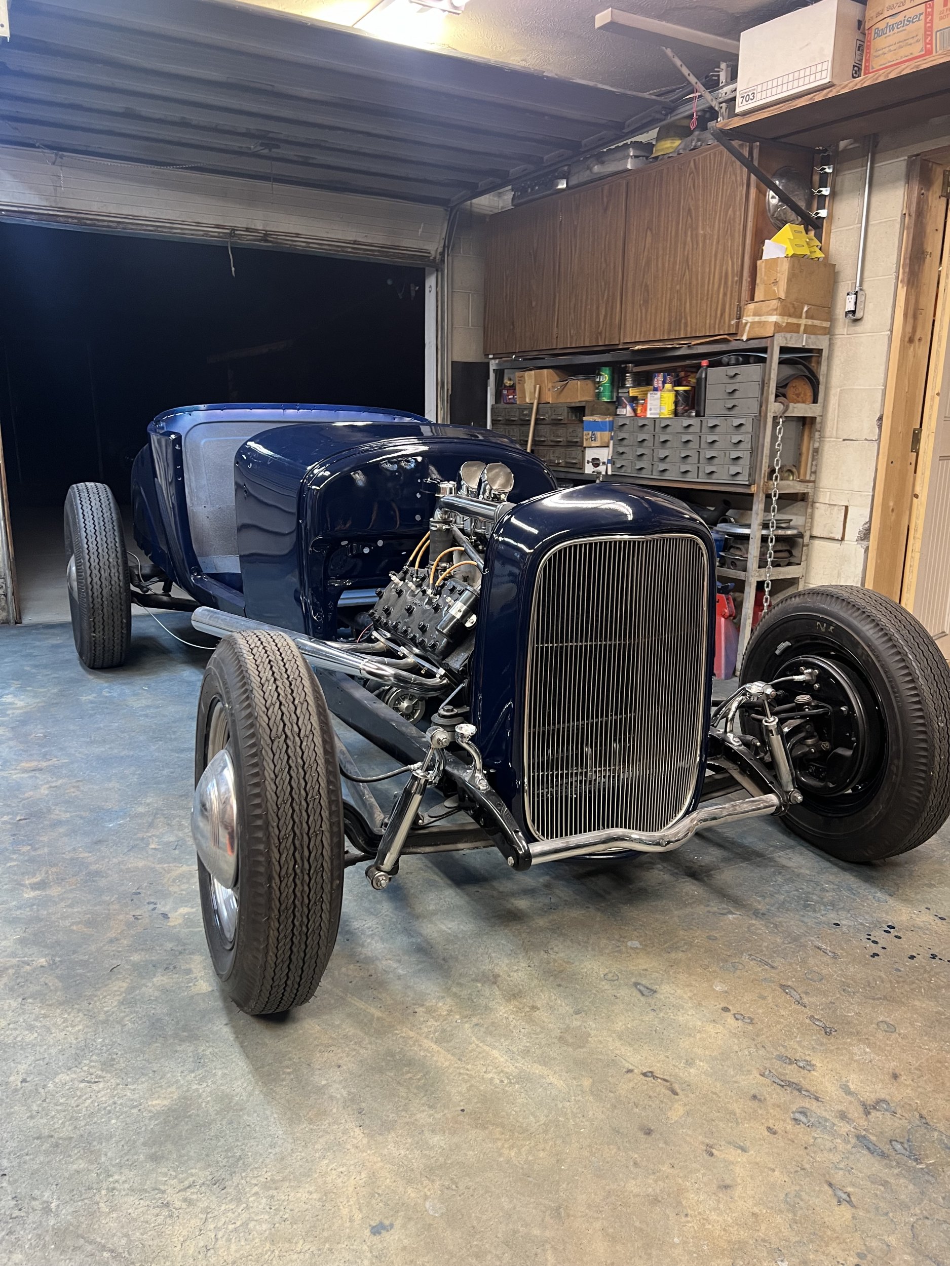

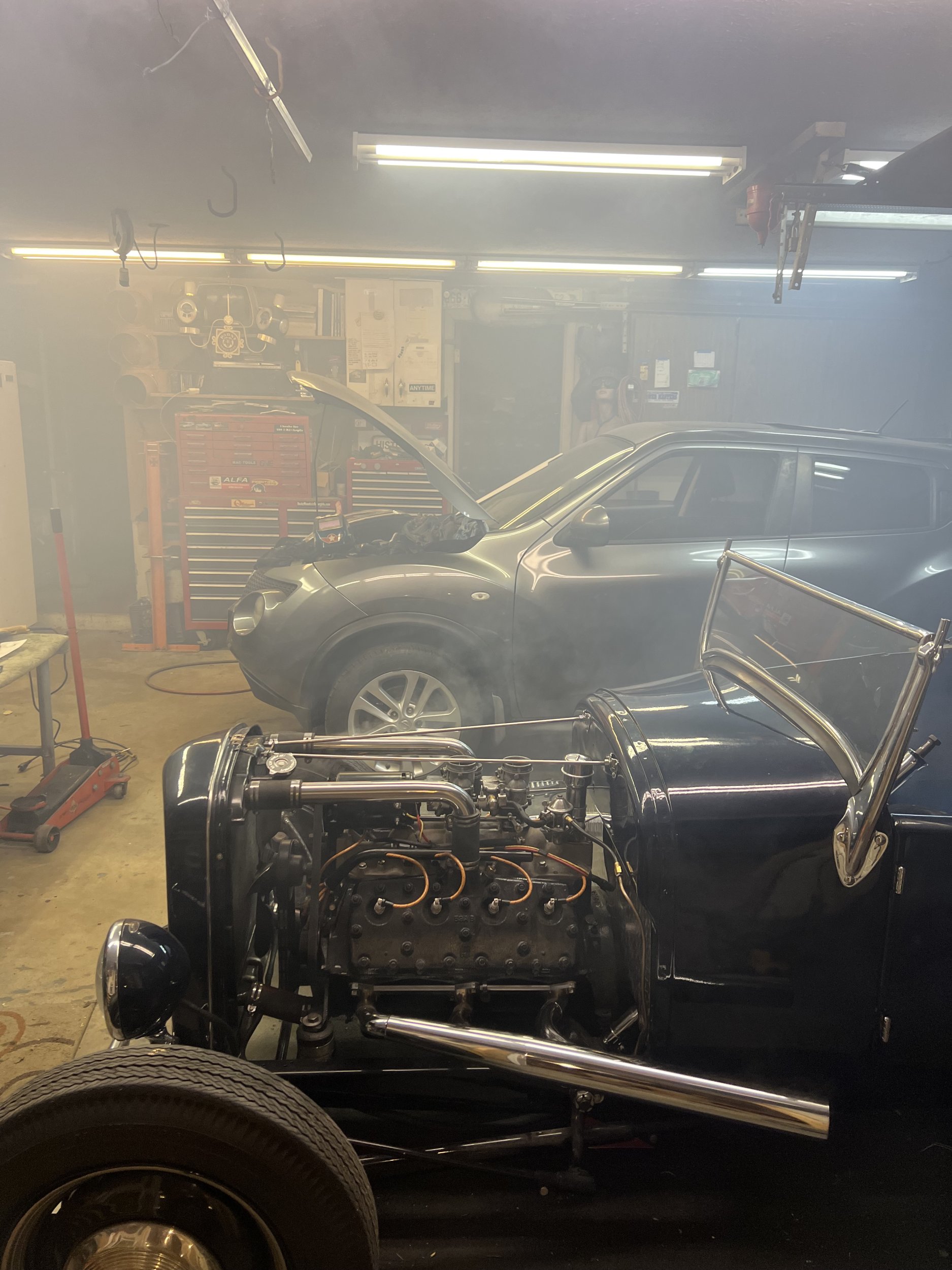

    So that gets us caught up to December 2024. Got everything wired, plumbed and ready to fire it and start tuning for a first drive. The universe had other plans. IMG_9447.jpeg
