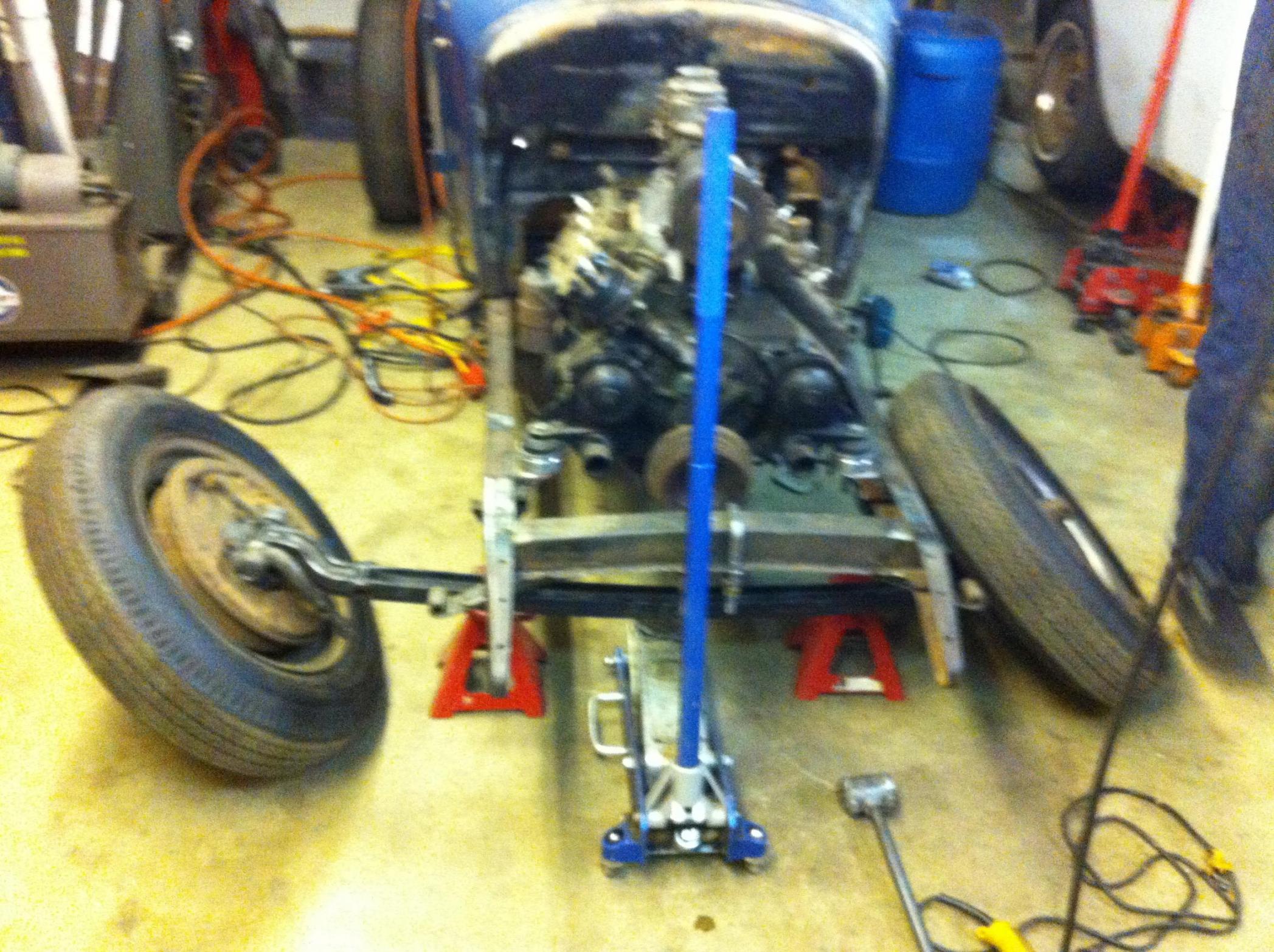

    Time for an update. This one is a big step. I'm really glad to have this mostly done. Still have to finish weld the mounts to the frame, but the bones are mounted.

    Okey dokey. Snow day update. We got the steering worked out and need to do some machining on the pitman arm. Gathered up some parts and made a plan. Got the shock mounts installed and figured out headlight placement. Still need to add the headlight stands, but it's looking really good.
