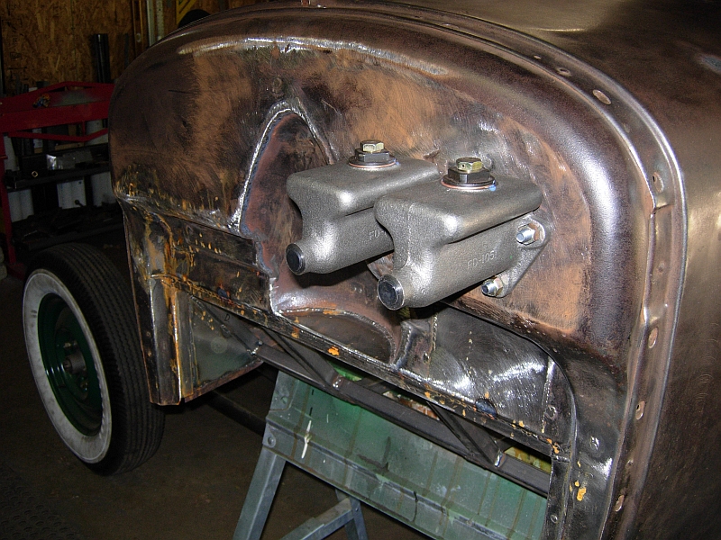

  20. marx
    Joined: Oct 8, 2005
    Posts: 475
    marx
    Update time again! Took a bit of a break there to get some yard work done, but the pull of the garage cannot be ignored.
    Borrowed an Ansen pedal assembly from Titus, so I could make a set of my own. Borrowed (also from titus) a pair of 40 Ford masters, and made an assembly to fit them nice and snug on the firewall. Way more fun than ordering a new set, and saved me some money in the process. Money better spent on some go-fast goodies.
    I think they worked out perfect for the space I've got, and the dual Fords look plenty cool sitting out there!

  21. titus
    Joined: Dec 6, 2003
    Posts: 5,182
    titus
    Perfect!
    you chrome plating bill is gonna be expensive, 2 master cylinders, the whole front end, valve covers, headers, man!

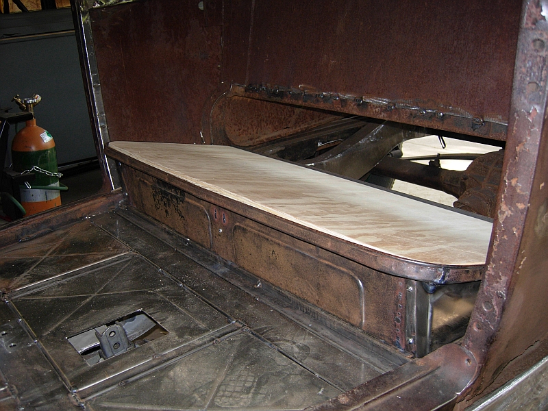

  30. marx
    Joined: Oct 8, 2005
    Posts: 475
    marx
    Been stressing over this seat-pan all damned winter. Trying to get it sitting just right; what to do to finish up the sides of it so it looks clean and as stock looking as possible; and getting it nice and solid wouldn't hurt either. I've mocked it up and started side panels at least 3 times already. Always hated it, and then just moved on to another thing to think about it for a while.
    I pulled it apart again and attacked it from the beginning on sunday, and I think I finally got it worked out! Sorry if this is too many pics of a fairly mundane part of the build. Seat-pans aren't real exciting, I know...
