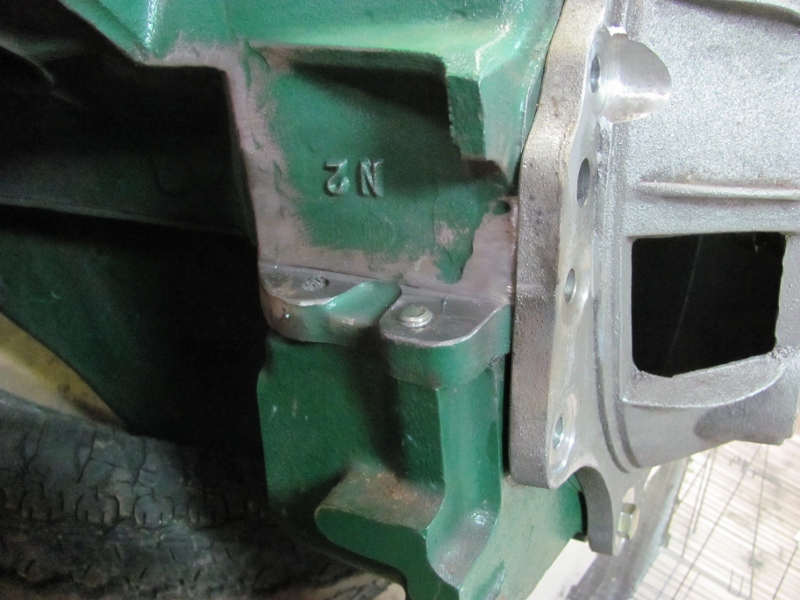

    ***embling the clutch it became obvious that my standard GM pilot bushing was not going to work on the crankshaft on this particular olds. The opening was considerably larger. Made a call to ***us in search of a solution. A couple measurements later his machinist friend turned me a nice little steel adapter. Fit perfectly, and tapped in nice and snug. Now if I ever need to replace my bearing I can just pop in another standard GM piece.

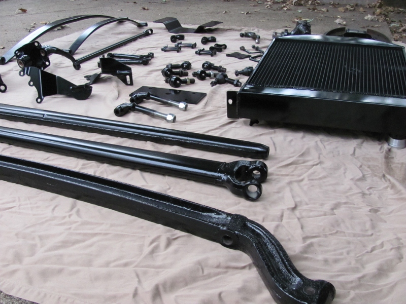

    Frame back from paint, and suspension parts fresh from powder coating. Re-***embly can begin!

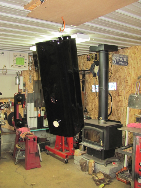

    Ebay fuel tank painted. Fleet Farm tractor and implement black.

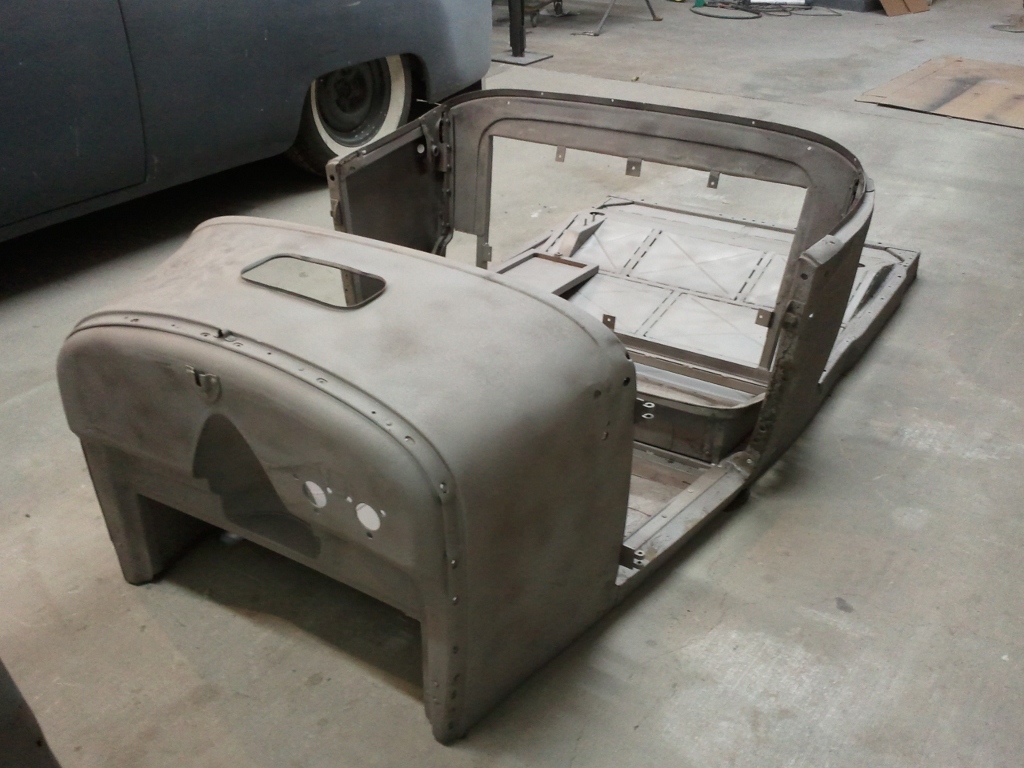

    Got the body up to the media blaster this past weekend. Picked it up and ran it over to Bob Fulmer's body shop today to get it sealed up. If there is anything prettier than cleanly blasted steel: then I've never seen it.
