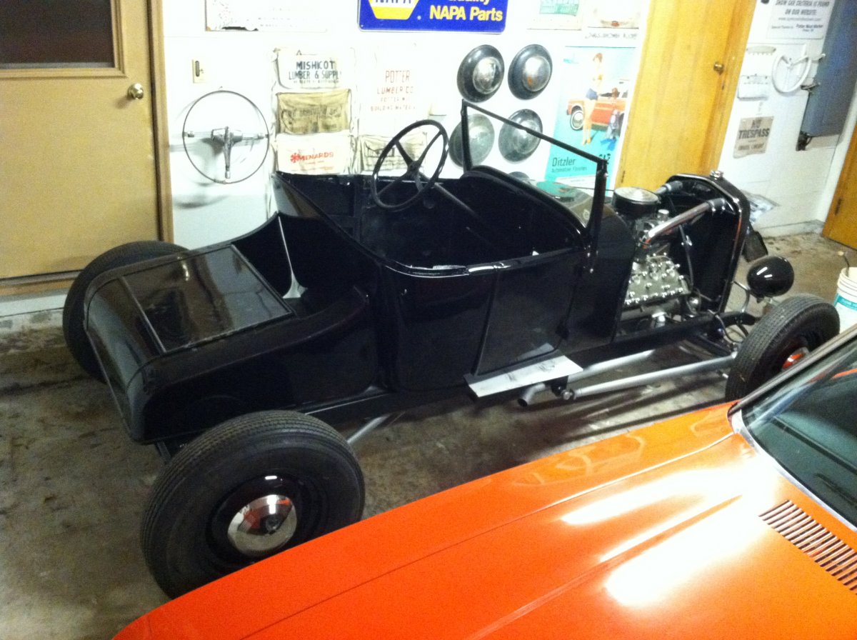

    It took awhile, but I finally got my doors and deck back today, and stuck them on to see how they'd look. I haven't been pushing this project too hard since I don't seem to have much time for it but hopefully I'll be re***embling things now. Granted, it's a terrible picture in my cramped house garage but here's the best view I can get of it today with the deck and doors on.
    I was thinking I was going to have to make some bolt-on subrails for the turtledeck to make it sit higher but now that I see it together I feel like it's just right. We'll see once the gas tank is back in it's hole.

    really like your T...but where's the shocks?
    ...and what is the wheelbase?

    Thanks Larry. Shocks are in a box yet, Delco Lovejoy knee-action shocks, they just bolt on, but will require some drilling and possibly small tabs welded on. My steering box mount also needs to be reworked, so there will be some touchups on the frame for sure once it's all together. The frame and suspension is just Rustoleum products so shouldn't be a big deal. I might have to add a leaf in the rear for height yet, once it's dialed in I'll do the shocks. It will have them for sure.
    As for wheelbase, the frame has stock length from crossmember to crossmember, but it has a spring-behind '40 axle. I'm not sure what the exact measurement is, but that setup must push the rearend foreward a good 5 inches, so I'd say it's right around 98 inches, give or take.

    You've got a good eye, my man! The earlier, modified turtle deck works really well. Makes it kind of a "1925 and a half". The silver grey against the black is really slick too. Subtle and cool.

    That commercial grille looks killer! How many leaves are you running in the front spring?

    I like your car, looks like a period piece. Is it the photos or is the steering wheel high and really far back to the seat?
    Looking at pics from days gone by many of the rods had the steering wheel in what looks like an awkward position.

    It's not the picture, it's really high and far back, on purpose. When the version in the first pictures was built, it had a shortened column with the wheel close to the dash, which looked right but I couldn't fit in the car, couldn't work the pedals or close the door. When I got it, Crazy Joe (the previous owner) put in a stock length column for me. I fit in it a lot better that way, but it does make for an awkward steering wheel position.
    For space reasons, I can't afford to cut the column down much, if at all, but I might cut up the steering wheel and basically reverse the dish on it, so it's dished toward the dash instead of toward the driver. Could gain a couple inches of chest room that way.
    It's one of those things that is a compromise of looks to make it actually driveable. It does look somewhat less odd with the column tube and dash in place.
