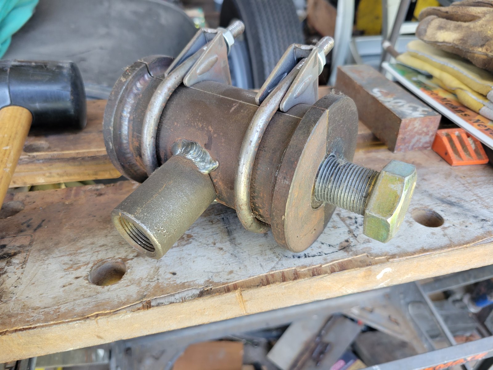

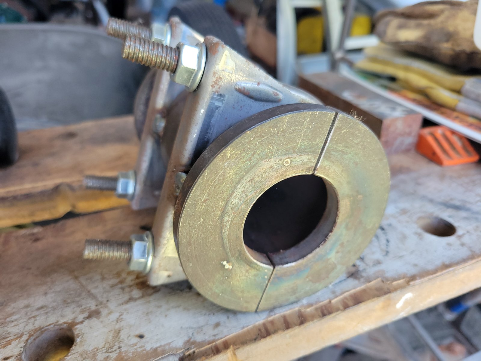

    Here's the axle puller I built. I didn't have it handy but there is a piece of steel that's tapped to screw on the end of the axle. The big bolt pushes against that so the axle threads are protected. 20230703_104650.jpg 20230703_104657.jpg
    I also have an old original one with the dog bone deal you hammer on. I think I prefer that one.

    That custom made puller looks BEEFY. Well engineered. Mine came in but I haven't even taken it out of the box yet, got some other things that have to be done before I can play with the T again, but I'll report back on how it works.
