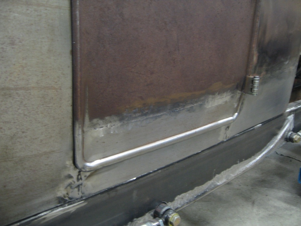

    Went out for a few hours and used the bead roller and shrinker stretcher.
    Formed a small lip for the inside of the bodies new top lip.
    Some welding and then smoothing with the sanding disc.
    It will get a flange under it to hold the interior panel behind the seats.
    One more step along the road :)

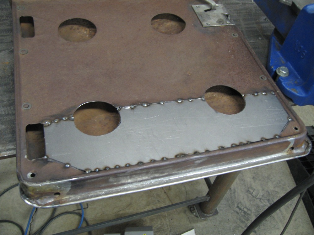

    I wanted to m***age the weld seam in the p***enger door to metal work the patch panel weld seam which had sunk in and was depressed.
    So with no access beyond 2 holes I decided to cut part of the inner door out.
    Hammer and dolly weld seam and then weld in new metal. Then install new Wescott hinges (which had to be welded up and the holes relocated to match the body and doors) the old hinges were sloppy and worn loose.
    After that weld in a piece of 1/2" thick steel into the thinner square tubing, threaded for the new door latch striker plate.
    The door now swings nice, is solid and fits and closes nicely. Next the drivers door :)
    The devil is in the details so they say :D Larry.
    Door 002 (2).jpg Door 001 (2).jpg Door 004 (2).jpg Door 003 (2).jpg Door 007 (2).jpg Door 009 (2).jpg

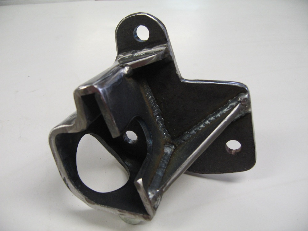

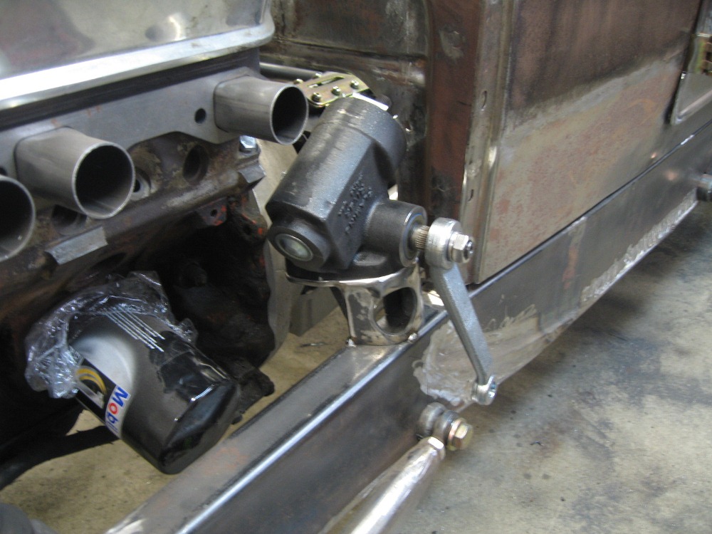

    Built the steering box mount and put it in place, then carved a hole in the firewall for the borgeson u-joint to poke through.
    Also started making seat belt anchors for the belts that are on the way.
    steering box mount 001 (2).jpg steering box mount 002 (2).jpg steering box mount 003 (2).jpg steering box mount 004 (2).jpg steering box mount 005 (2).jpg steering box mount 007 (2).jpg steering box mount 006 (2).jpg

    Nice looking mount. What's the story on the shape of it?
  17. Blue One
    Joined: Feb 6, 2010
    Posts: 11,512
    Blue One
    from Alberta
    Thanks.

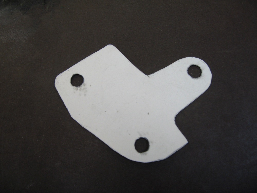

    The story on the shape. It just kind of evolved that way. :) I started with a posterboard template of the base of the Flaming River reversed Corvair box.
    I built the whole mount with poster board and masking tape as a mockup before cutting metal.
    The curved portion follows the base plate and has the large hole which follows a theme of holes on my build and also provides access to a mounting bolt for the box.
    The bottom part that sits on top of the 2 " wide frame rail has the slotted section so it won't fill up with dirt or water.
    It is then gusseted for support of the box as you can see.
    It sits the box up where I need it about 2 1/2" above the frame rail, and should be strong too.

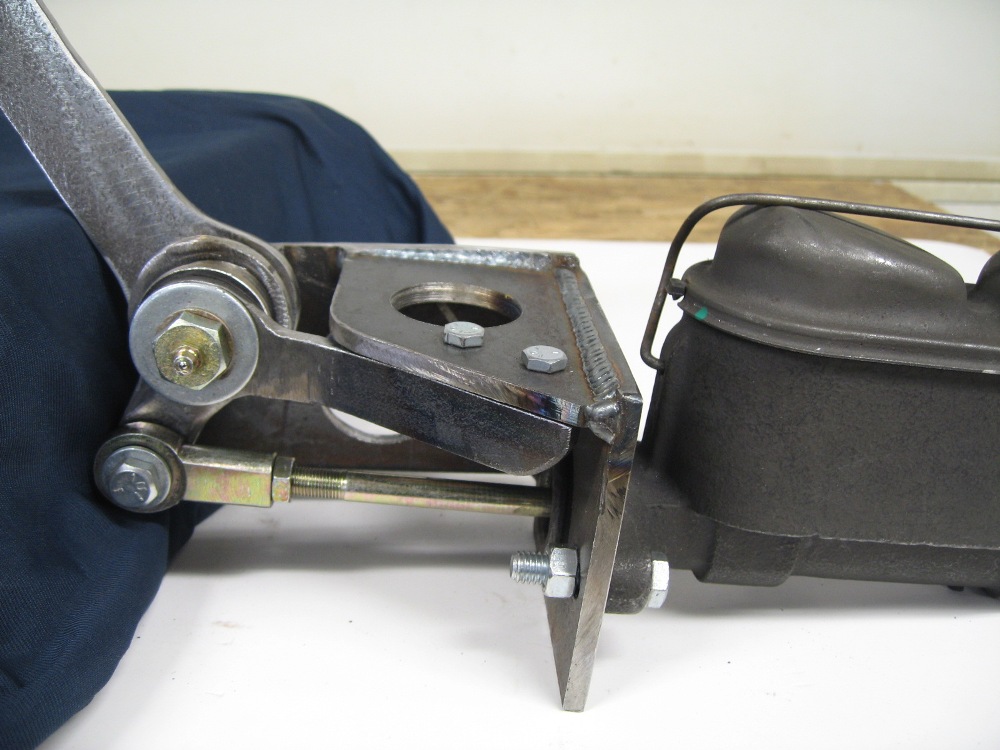

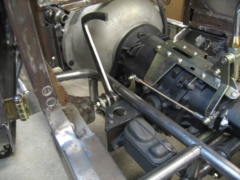

    Update time :) The brakes have been figured out more or less :)
    Spent a couple days in the garage, first was a lot of head scratching and measuring, then came a scale drawing on poster board.
    Next I cut all the pieces and started fabricating the master cylinder mount and brake pedal.
    I wanted to have the pedal behind the toe board, rather than coming up straight through the floor like on a lot of Ts.
    Not an easy task as there isn't a lot of room.
    I think the way I have it will allow a little more foot room.
    The M/C mounts to the tube framework I built previously and is solid.
    Pictures below. :)

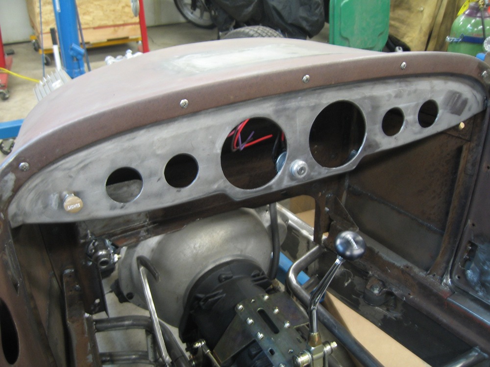

    I was going to continue on with the brakes and the floors but decided I had better wait for Speedy Bill to deliver the Lokar e-brake components I ordered.
    So I put the brakes on that part of the project ;) and shifted focus to the dash. :)

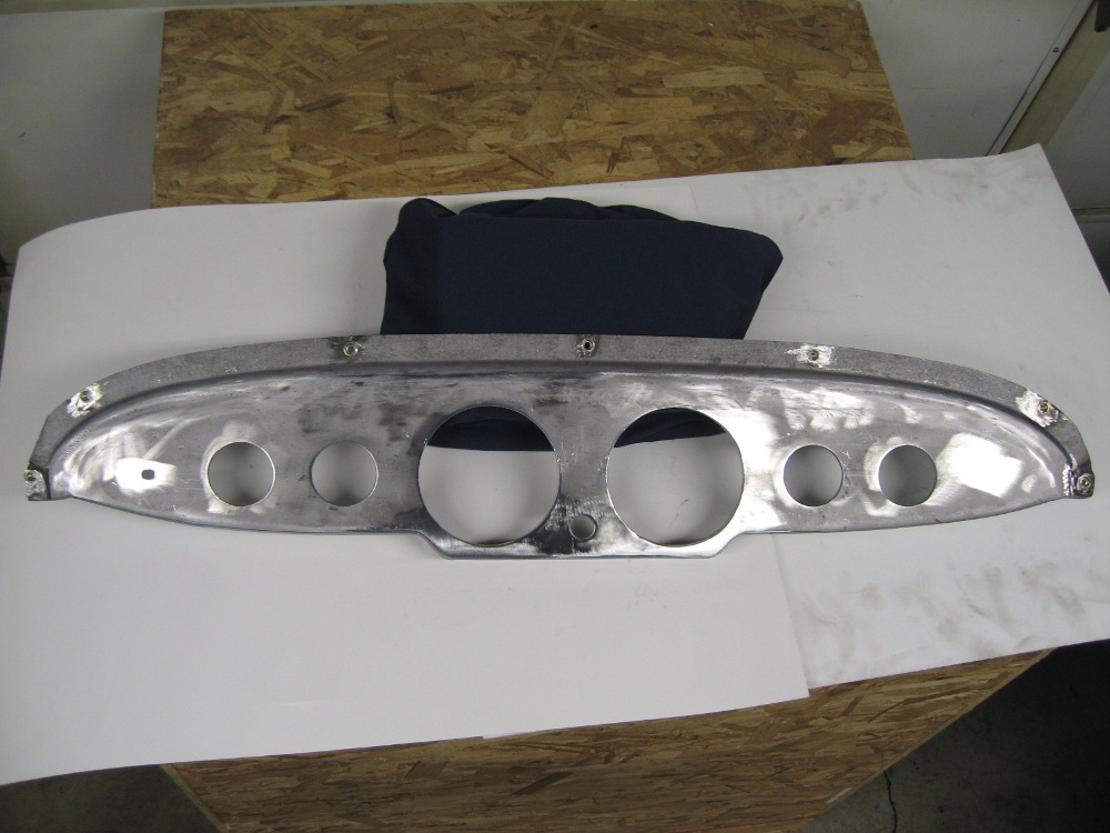

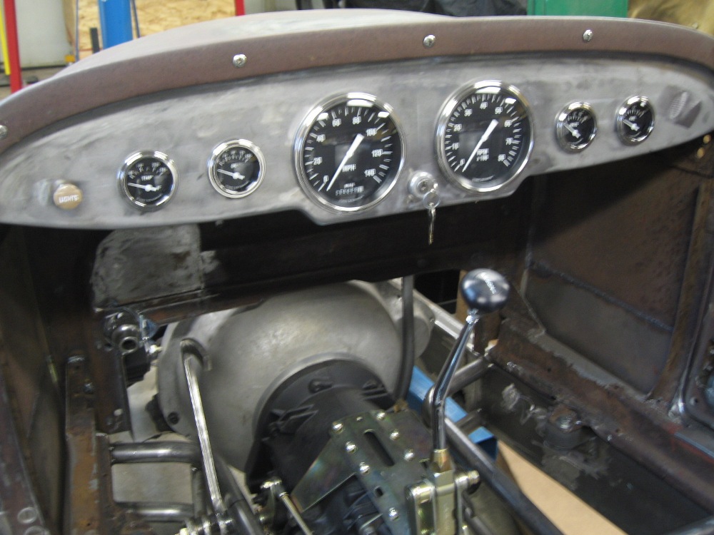

    I modified the middle of the dash I had built previously to better fit the 5" gauges.
    I installed 1/4" rivnuts in the mounting holes, much easier than reaching behind the dash with nuts when installing.
    Then a 4 1/2" hole saw and a 2" hole saw allowed me to sneak up on the final hole sizes of 4 5/8" and 2 1/16".
    Sorry for the slight blurriness of the final picture with the Cl***ic Instruments Hot Rod series gauges plugged into the holes.
    Larry
