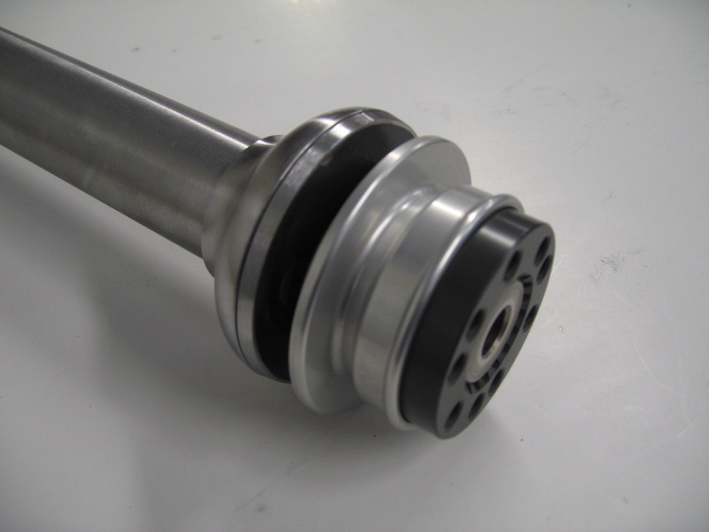

    Started on the steering column, an Ididit "Old School" column.
    Cut it down to about 12" total length and with the column drop I connected it to the steering box with a pair of Borgeson u joints.
    No pictures of it yet but I also started fabbing a tube to contain the u joints and shaft and form the bottom of the column.
    I built a adapter for the quick release steering wheel hub. It makes getting in and out almost easy. :)

    Is that column mount enough to support everything? Looks like if you pushed down on the steering wheel the U-joints (if loose) would come right apart. The hinge thing surely ones not help matters.

    Yes, you have it, I have a plan. :)
    There is a set screw in the bottom of the column drop to hold the column, however once I complete the lower tube to contain the shaft and U Joints the whole thing will bolt to the floor with a flange and will be super strong.
    The column drop and the column ***embly will be plenty strong.

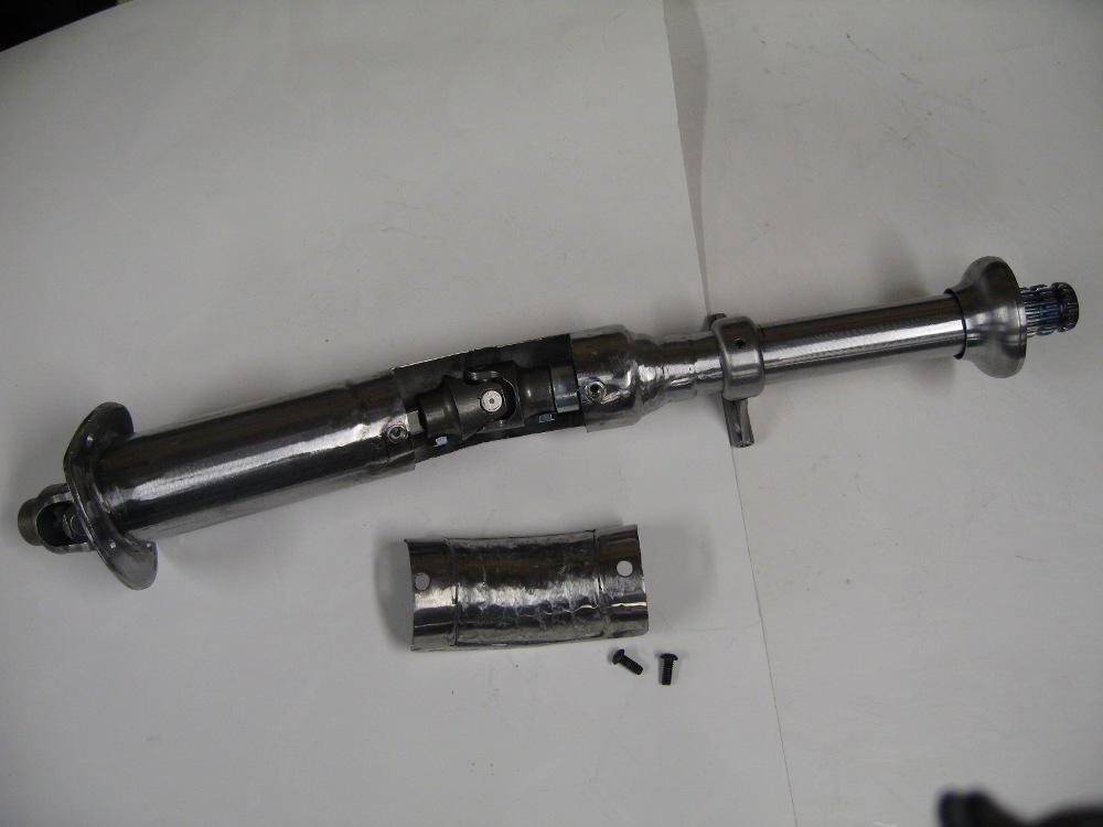

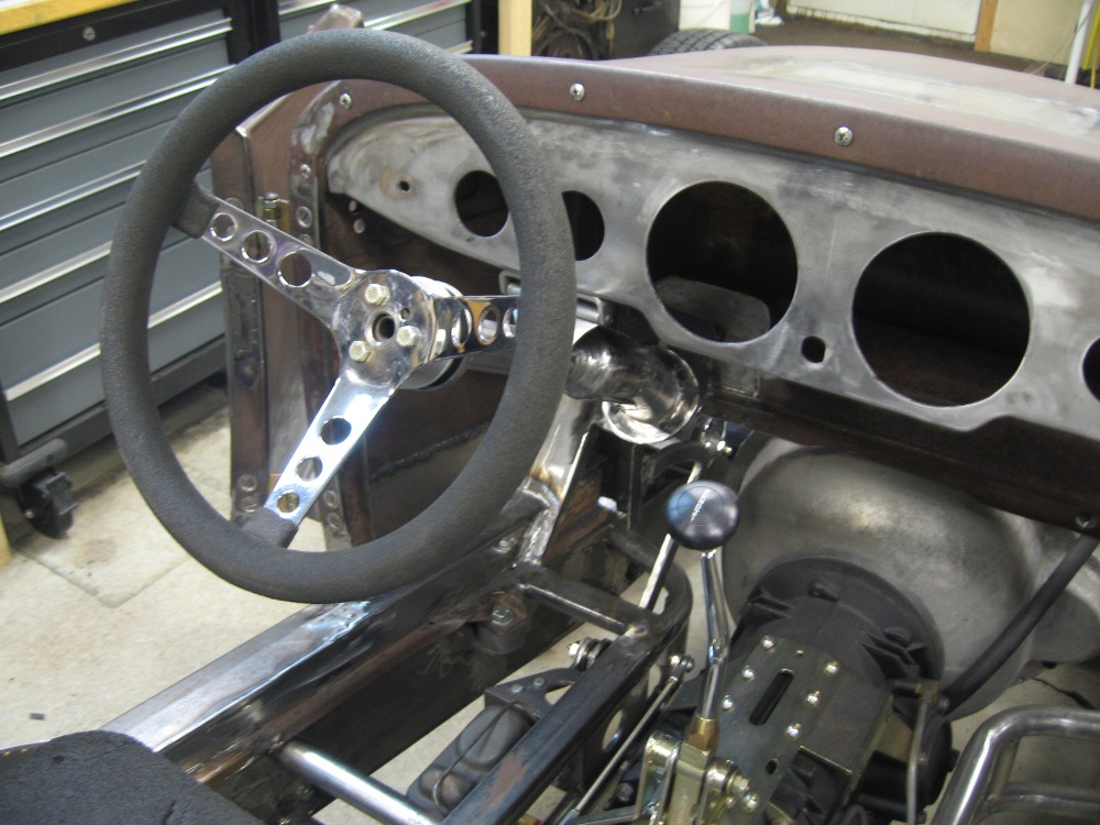

    Spent the day wrapping up the fabrication of the steering column.
    I used an ***ortment of exhaust adapters ( using just very short sections of them) to achieve the switch from the 1 1/2" tubing of the Ididit Old School column to get up to the 3" tubing I used to contain the U joints and steering shaft down to the box.
    I left an opening in the column to access the upper U joint.
    As you can see I built a cover for it as well.
    Drilled the DD shaft for the set screws and ***embled it all.
    It bolts to the floor and is nice and solid. The steering shaft and U joints turn freely in the column and it's all nice and smooth.

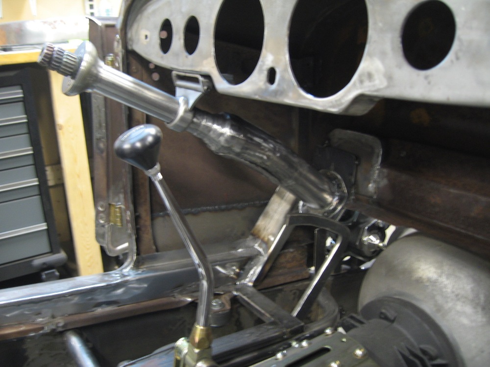

    A little more fabrication, used my bead roller after making a poster board pattern of the toe board.
    I decided to weld the toe board and first few inches of the transmission tunnel in place to add structural strength to the body.
    The toe board is moved forward on the bottom compared to stock for a better foot angle and more foot room as well.
    The remainder of the transmission tunnel and the floor boards will be removable to allow service if necessary to the brakes, shifter and anything else that becomes buried under there and inaccessible without removing the body.
    I also made a removable panel around the brake pedal that will make lifting the body on and off easier when trying to maneuver around the brake pedal which has to be in place on the ch***is before the body goes on (or comes off.)
    Things are so tight on this little car it's like a big puzzle. One more piece in place. :)
