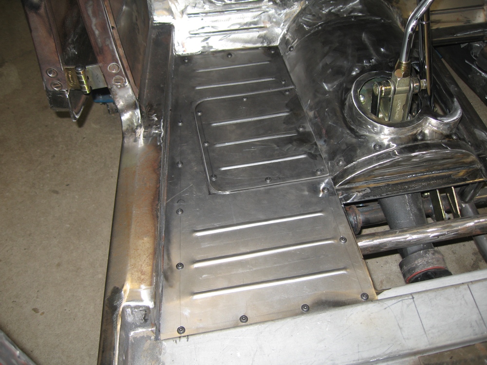

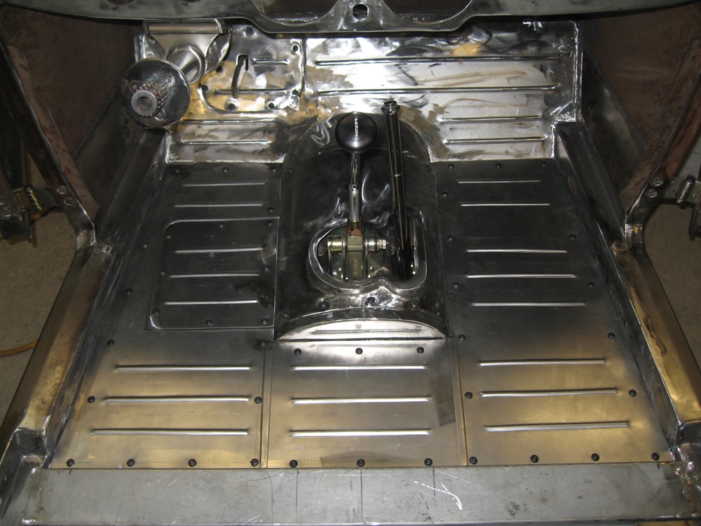

    Wow, :) Finally time for a small update. I started in on the RPU again last weekend after some time spent previously getting my shop back in order.
    I only spend about 3-4 hours at a time on it at this point but it's great.
    This is the first time I have touched it since my ordeal in the hospital.
    I worked on finishing the removable trans tunnel and fabricating the removable floor board for the driver side.
    The small panel is to access the master cylinder.
    I used my bead roller and it all comes out with the bolts you see into steel nutserts.
    Having the floor removable may be a bonus at some point in the future. :)

    I was able to get the floor basically finished today. It's all removable for future service needs.
    Now I can work on the rest of the floor under the seats and then move along to something else. floor 001 (2).jpg floor 002 (2).jpg

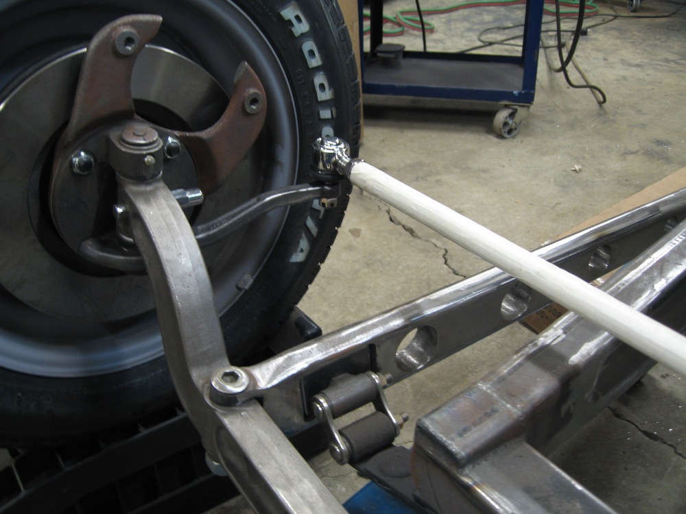

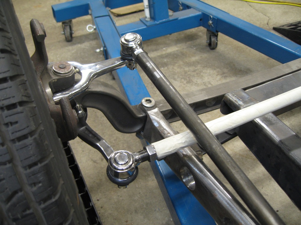

    I was having a few issues with my steering. I'm happy to say that it is figured out.
    I had to order a pair of extra long Superbell steering arms from Pete and Jakes.
    I received the steering arms, just what the doctor ordered. :)
    I put it all together and I will end up applying some heat to them where they bend slightly down to bring the tie rod up about another 1/2".
    This is going to be needed to clear my lower rad hose.
    I tried the steering lock to lock and it looks very good.
    There will be a little tweaking, and the compromise will probably mean needing an electric fan.
    Seems that everything on this car is that way.

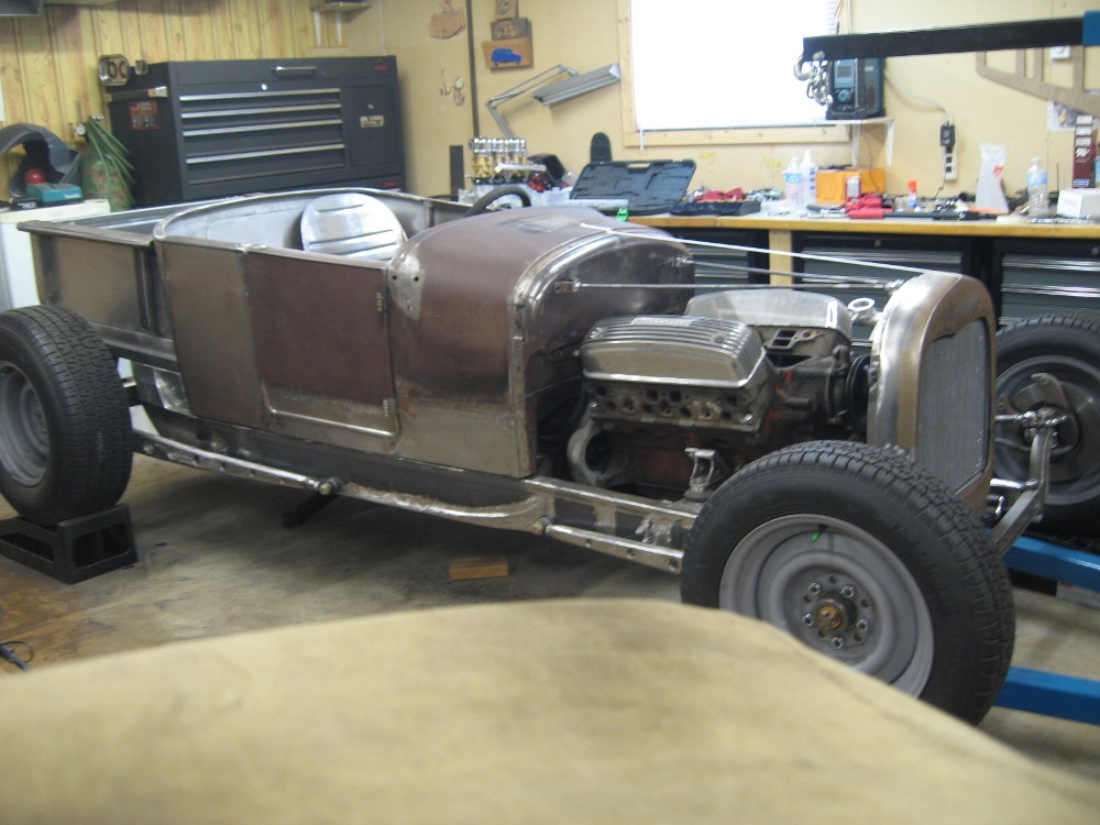

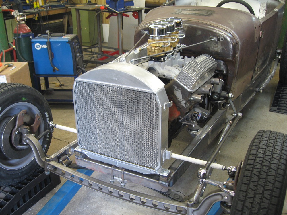

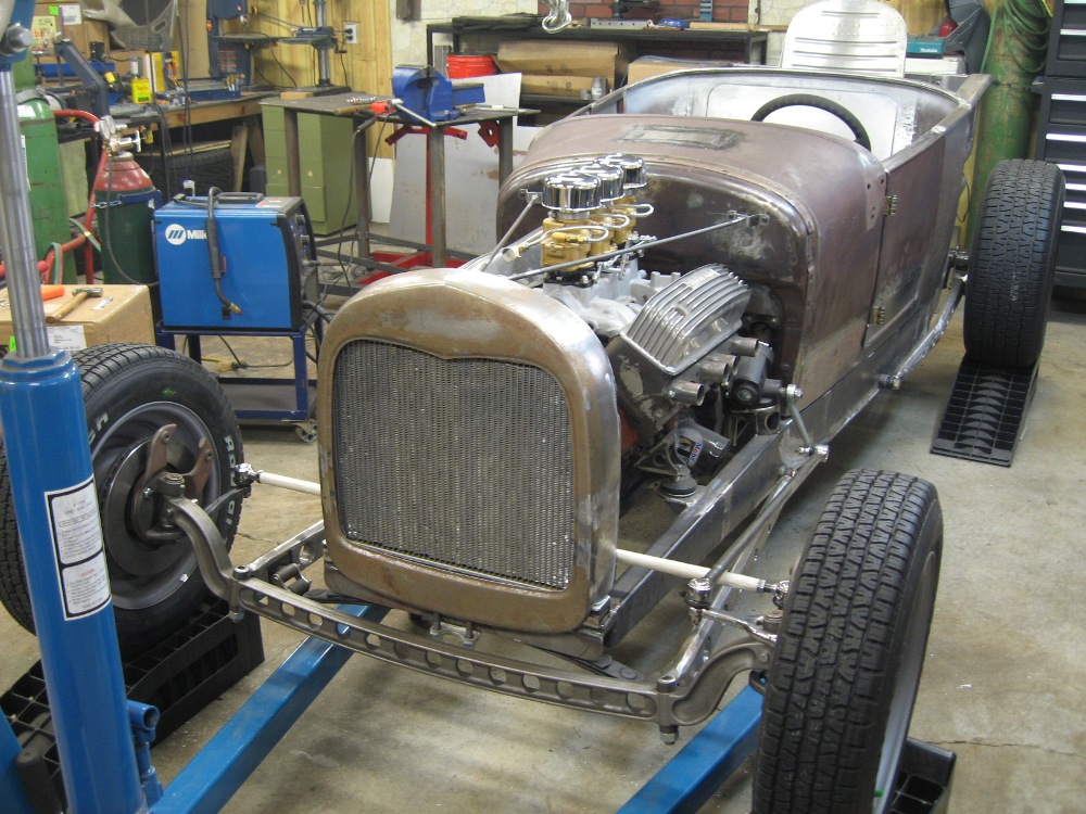

    Time for another update. I have mounted the radiator and finalized the modifications to make the grille shell fit and it's mounted.
    (Some guys on here don't like A shells on a T, I think its fine :))
    The rad is sitting on 3/8" thick medium density rubber pads that will take the weight of the rad and cushion it but not collapse.
    The mounts are solid and I used a 3/8" ID x 5/8" OD sleeve that goes through the rubber and radiator mounting tab so that when it's bolted down with a large washer the rad is sitting on the rubber but not crushing it.
    Next comes the shock and headlight mounts. :)
    Rad and grille shell 001.JPG Rad and grille shell 002 (2).jpg Rad and grille shell 003 (2).jpg Rad and grille shell 004 (2).jpg Rad and grille shell 005 (2).jpg Rad and grille shell 006 (2).jpg Rad and grille shell 007 (2).jpg Rad and grille shell 008 (2).jpg
