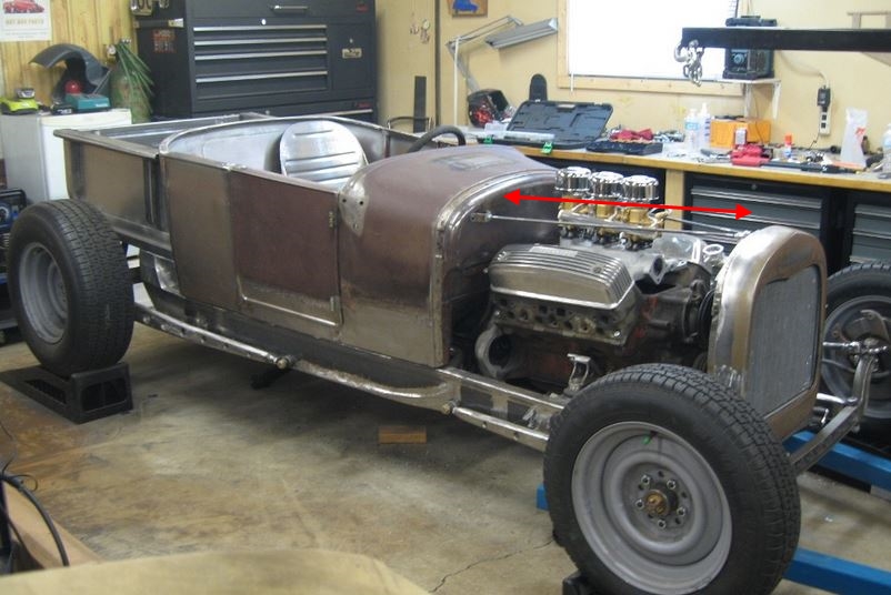

    Love this build. I've been lurking on it for months now.
    One comment, I ***ume that you aren't running a hood based on those carbs.
    Just throwing around my opinion here which you are free to ignore, but I think that this angle could be improved. It slants down from grill to cowl which is counter to most cowl to grill layouts, and makes the car feel folded up.
    Not sure if you can move the brackets up on the cowl, or find a way to get the grille down further, but I think it would improve the look of the T.
    Keep up the amazing fabrication.

    I was looking at that and will probably cut and modify the front support rod bracket on the rad. That bracket was installed by Griffin and if I slice it and weld in an inch wide strip of aluminum lowering it that much is all it needs.
    I was more interested at first in the line from the cowl to the grille shell as shown by the tape in the picture without the carbs.
    I think that shows the grille shell is pretty much bang on for height.
    Thanks, I'm doing great these days. Feeling better as time p***es. :)

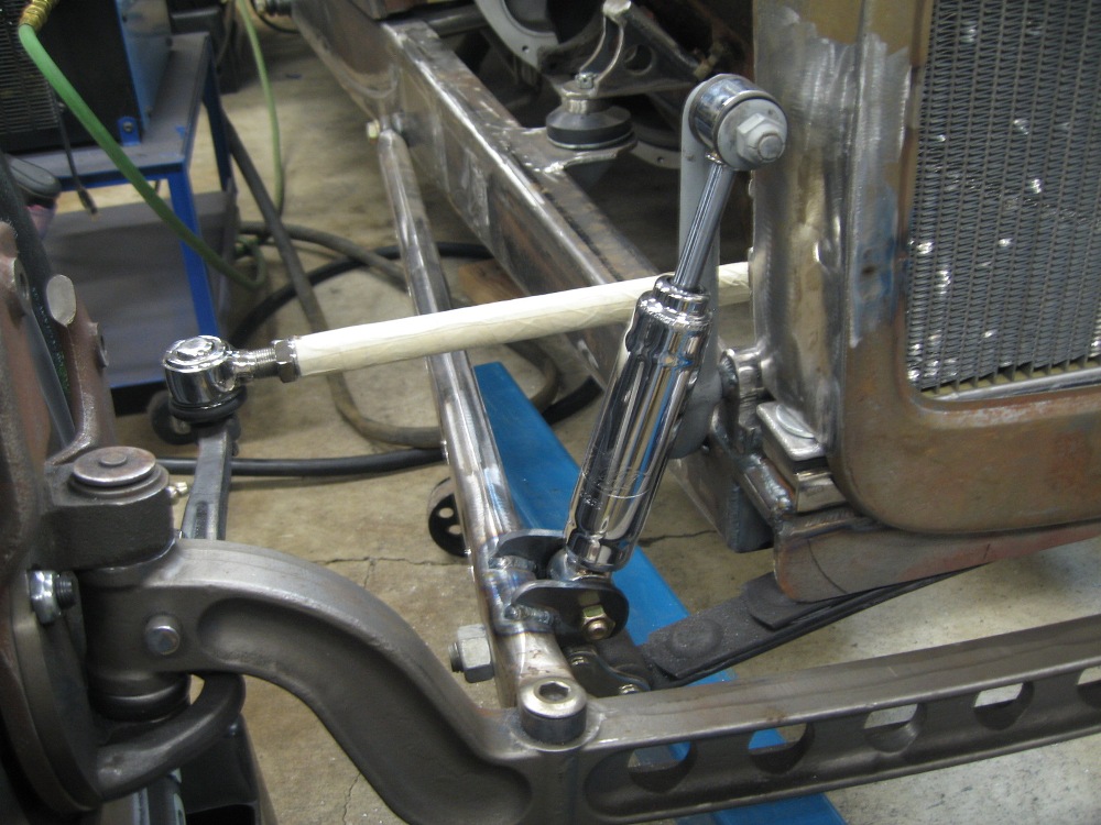

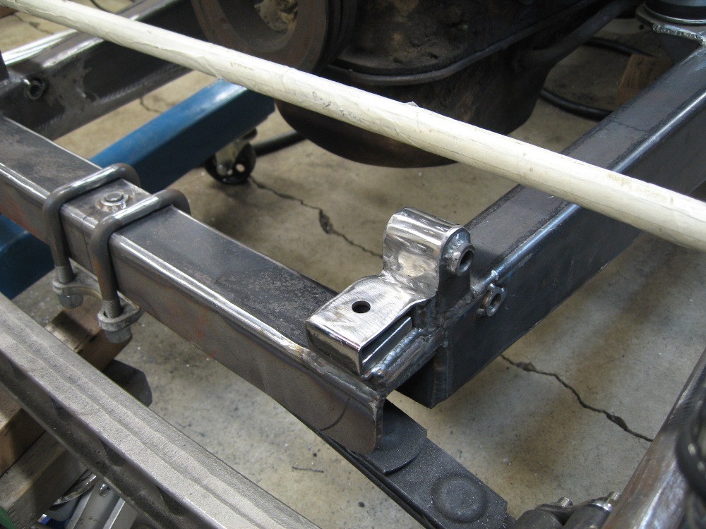

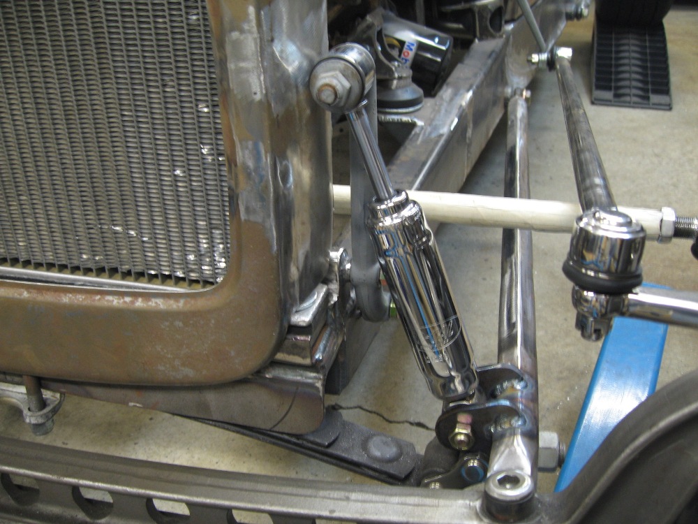

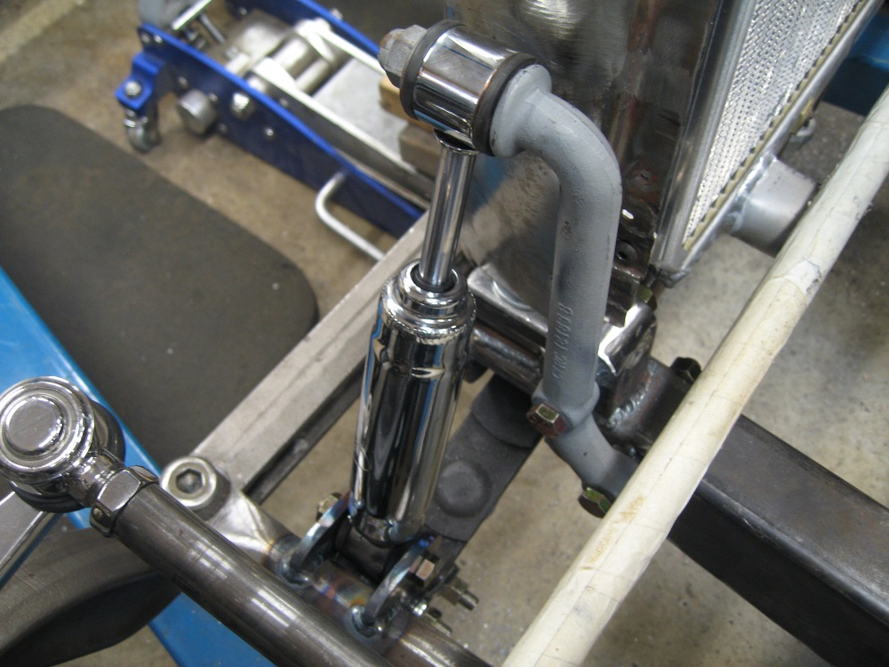

    Spent some time the past few days and installed some F1 front shock mounts with shorty tube shocks from So-Cal.
    I'll probably be mounting the headlights from them as well. :)

    Cheers Larry. Just wondering how close the tie rod gets to the shock mounts on lock side to side. JW
    daddio211 likes this.
  10. Blue One
    Joined: Feb 6, 2010
    Posts: 11,512
    Blue One
    from Alberta
    The tie rod clears the rad by about 1/4" on each side lock to lock and the clearance to the shock mounts is about 3/16" on each side.
    Close but enough that when the steering reaches the stops on the spindles nothing touches. :)

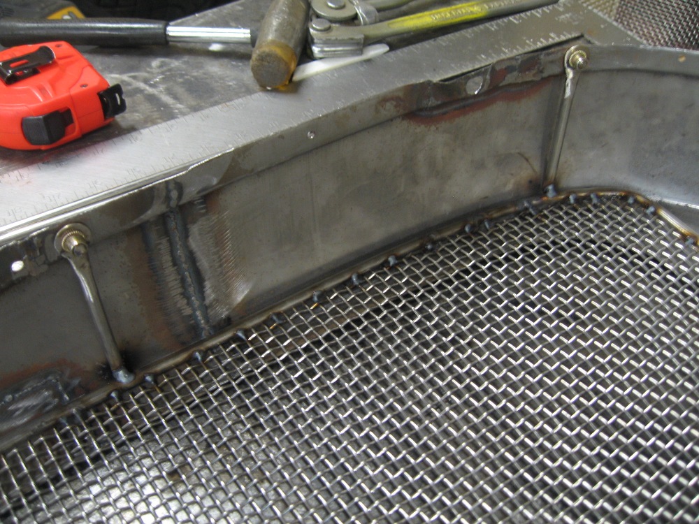

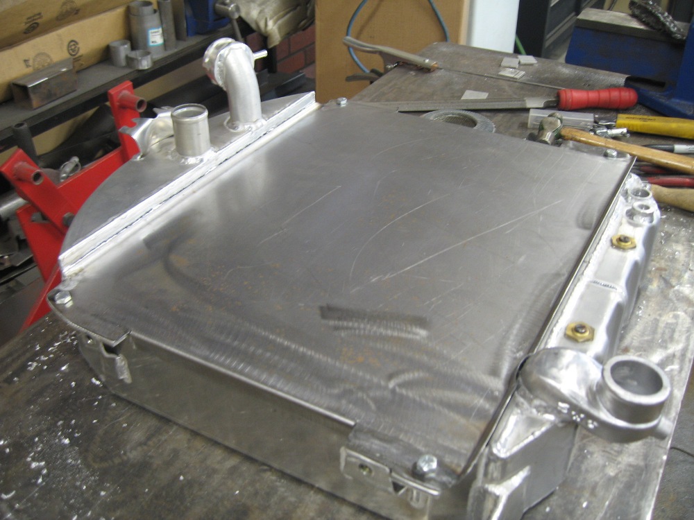

    Spent some time and solved my radiator bottom outlet problem and also the issue of an electric fan which was a necessity due to the steering tie rod p***ing behind the rad.
    I beefed up the Superbell steering arms with a little additional metal along one side to strengthen them and eliminate any possible flex due to their long design.
    The lower rad outlet proved to stick out too far even after adding the drop fitting, so I flattened it out from the front so it clears the steering at full lock and then opened up the bottom and back for a free flow of coolant with a little creative aluminum fabrication.
    Sure love my little Miller Diversion Tig that makes welding aluminum easy :)
    For the fan, I started with a Flexalite 111, which is a puller fan that pulls a lot of CFM.
    It's also the thinnest fan I could find
    It comes in a plastic box like shroud that while it looks neat was never going to find it's way onto my build ;)
    I started out with a sheet metal "shroud" I built and went from there.
    Ideally a shroud should be spaced back a little from the rad to allow flow from the whole core.
    It wasn't possible in this case so I opened up the area around the fan to allow some airflow and better cooling rather than having it blocked off.
    The fan will pull air through where it counts.
    Some pictures of the mayhem :D

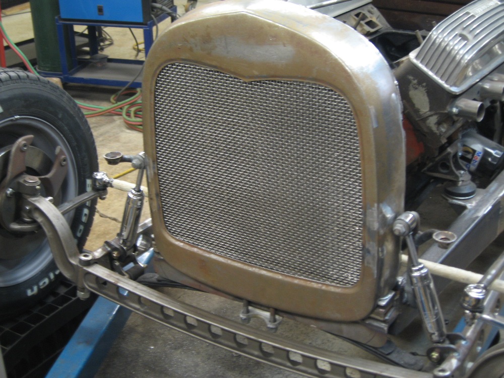

    Another update, I didn't like the "empty" "A" grille shell so I picked up a piece of #4 Stainless steel mesh.
    I made a framework of small stainless tubing to fit inside the shell and a few legs to attach it to the shell so it all clears the rad.
    I like the end results and I think the stainless mesh looks nice and will protect the rad well.
    Larry. grille screen 001 (2).jpg grille screen 002 (2).jpg grille screen 003 (2).jpg
    loudbang, 26 T Ford RPU and daddio211 like this.

  28. Blue One
    Joined: Feb 6, 2010
    Posts: 11,512
    Blue One
    from Alberta
    In case anyone wanted to know, the Stainless is 304 and the mesh size is #4 :)
