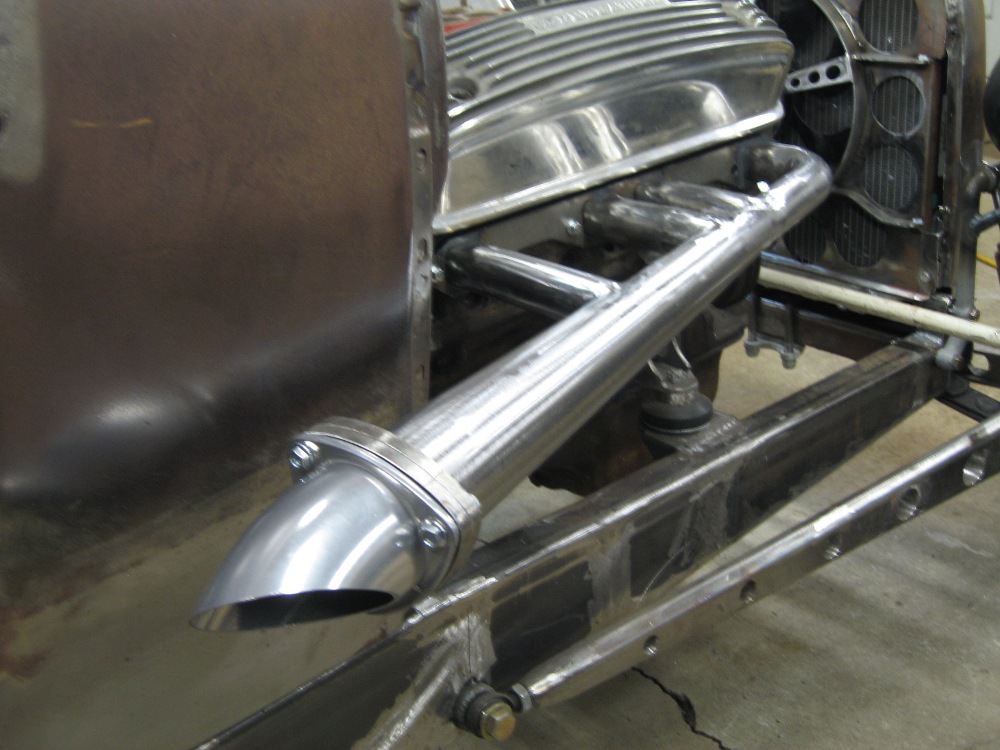

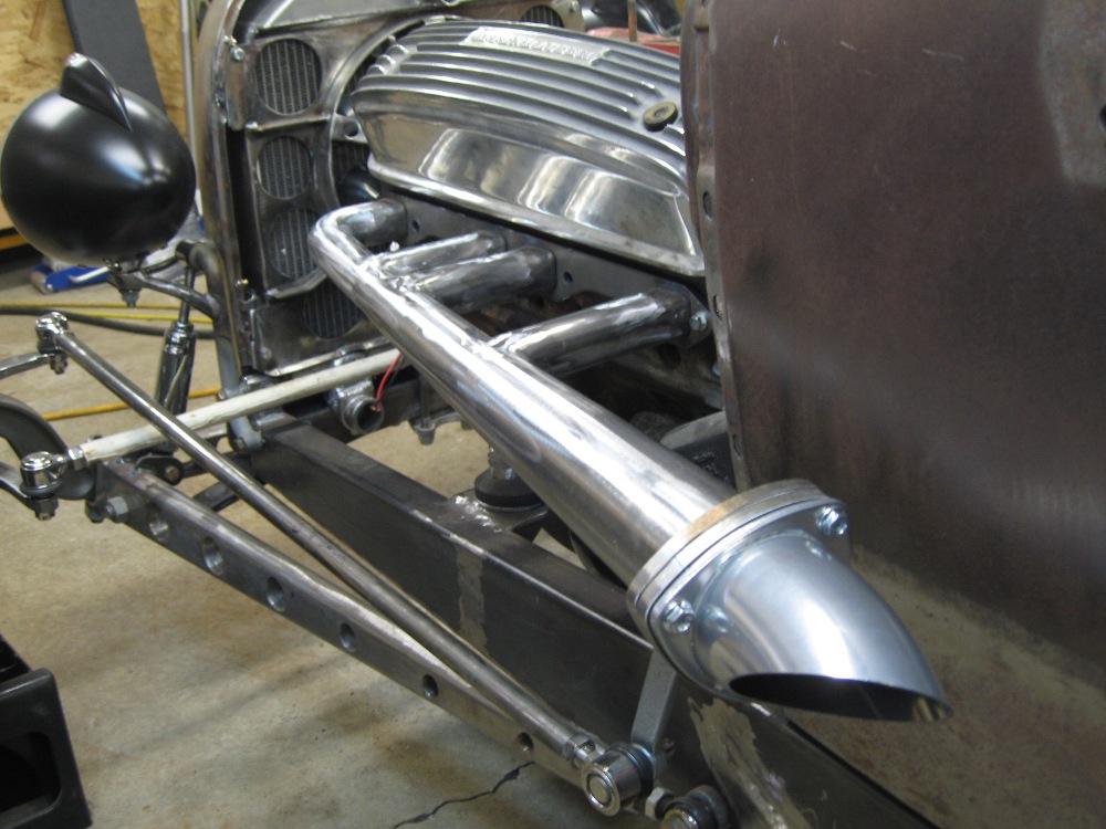

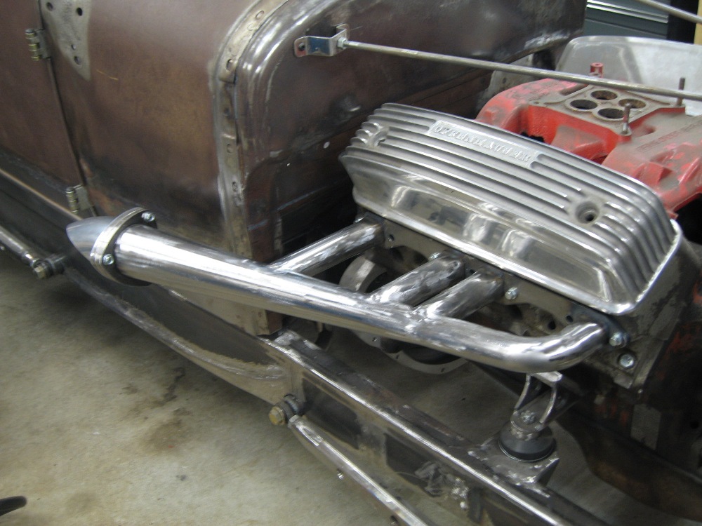

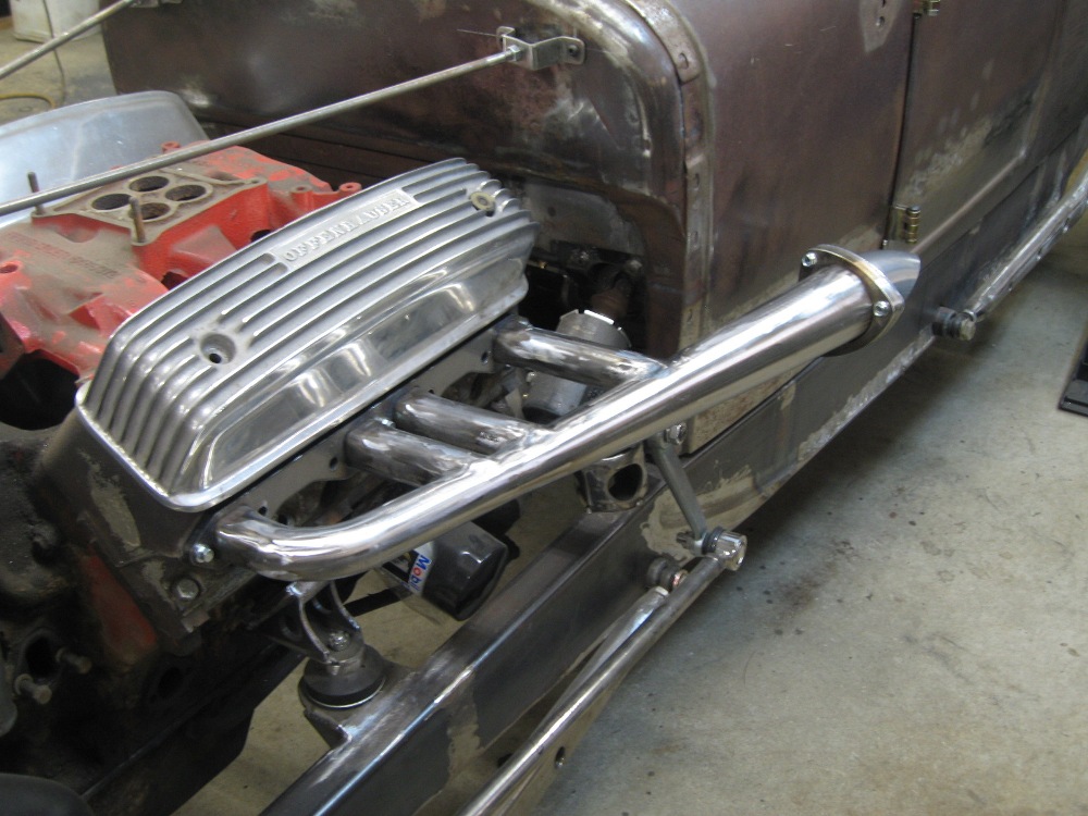

    This weekend was devoted to building my lake headers. Next will come the undercar exhaust system to connect them to. :)

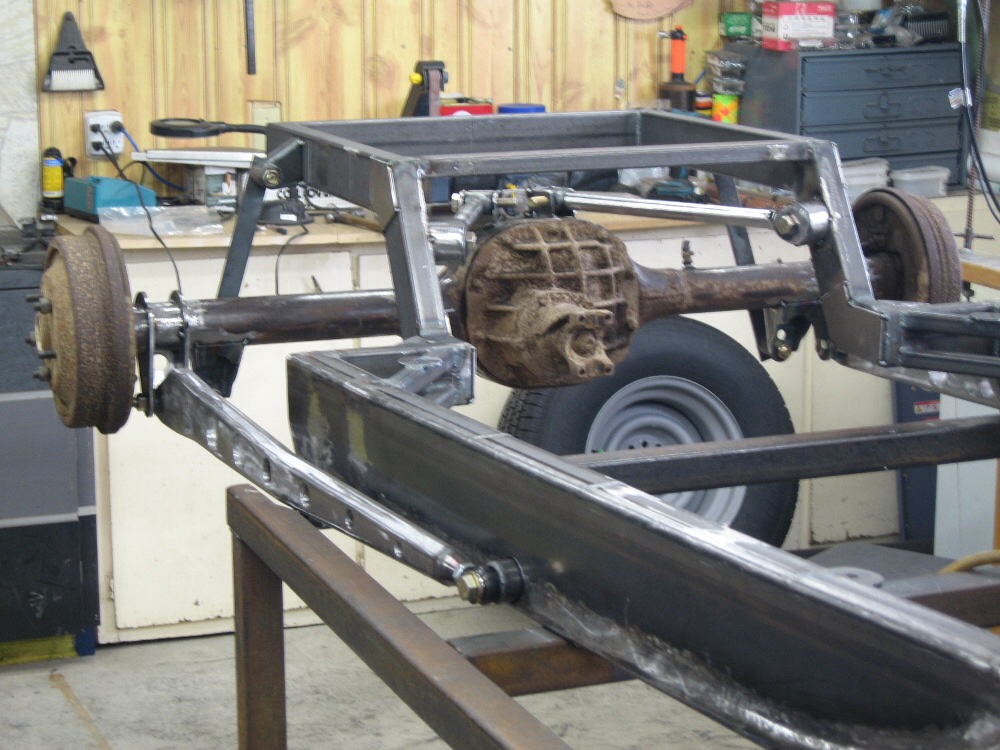

    Larry, I was just studying a photo in post #106 of the rear end and the main issue I can see is that the radius rods are double mounted to the axle and will cause the housing to move in a different arch to the top control arms. As for the top arms hitting the housing, if you moved the rear mount forward that should solve that. As for the arch difference, you could change the radius rods to a single mounting point on the axle to stop bind. OR have I missed something else? As for having to change the radius rods if you fit a buggy spring because they are outside the frame, i take it is because of the solid sway bar effect, they will act the same way with your current setup. JW:)
  27. That is version 1.0-
    Version 2.0 is post 123 ish.
    If the bars will contact the housing, think about -
    1. shortening these bars
    2. making the mount wider
    3 moving the mount forward
    That 3 step solution should correct the symptom. At least keep the fix all in one spot.
    How much suspension travel will you really actually have, really enough to bind the bars on the housing?
    I think that you are pretty far along to be switching from coil overs to transverse springs now, but it's only metal and subject to change.

    Post #106 was version 1.0 of the rear suspension and as you could see the "sway bar effect" was why it wouldn't have worked well.
    If you look at post #123 you can see the changes which eliminate the "sway bar effect and is how the rear suspension now sits.
    The problem I see is in looking at the upper bars (where they attach above the rear end housing) from the rear of the car looking forward is that the drivers side upper bar has very little clearance and looks like it will hit the top of the pumpkin when the suspension moves the rear end upwards.
    I still like the way I designed it in the modified triangulated 4 bar fashion, I just need to see if there is a solution to the issue. :confused: :D
    I'll get there :)
    Larry

    You are absolutely right, and you posted what you did while I was looking and typing my response. :)
    I like your way of thinking, I believe what I have built will work well and I like option 3 actually.
    I am not opposed to switching direction if absolutely necessary however if I don't have to I won't.
    I'm going to look at the suspension travel first and go from there, thanks for the ideas.
