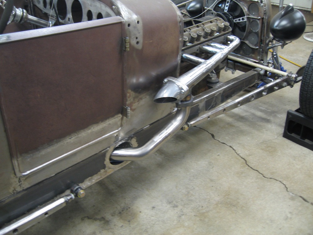

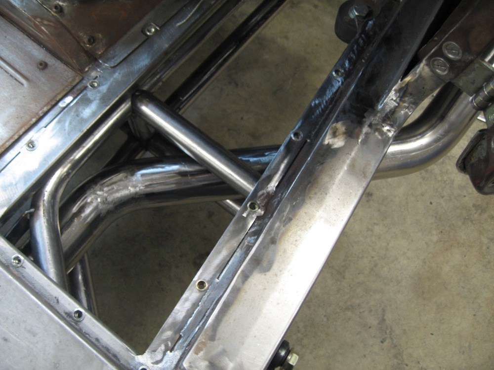

    Back on the exhaust, I got the drops off the headers built and the pipes come off and sweep and drop back through the 45° holes in the frame.
    The way they run is to allow the reveal I put into the frame to still be seen and I think they look nice.
    There is 3/4" of clearance all around each pipe so they will never hit the frame.
    Next will come the undercar system with those nice blue Porters. :cool:

    That looks very nice ! When I did bends on my exhausts I made cardboard templates of the U-bends and trimmed them till they fitted, then transferred to the bend. JW :)

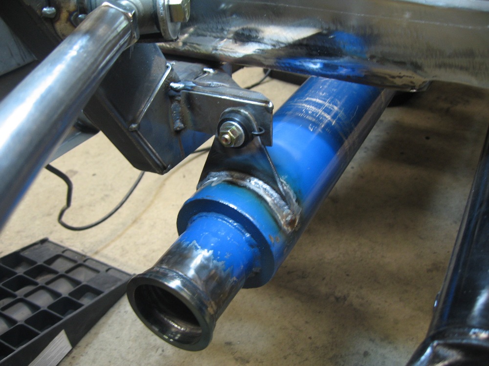

    Back onto the undercar exhaust.
    First I built a cradle for my floor jack to hold the mufflers in place.
    Things are so tight under there that the hangers were a challenge to say the least.
    I ended up putting hangers on the front and rear of the Porters and using a V Band clamp on each end of them.
    The pretty blue paint they put on the Porters is ****, basically a token spray job.
    I'll likely end up having them ceramic coated along with the entire system headers and everything front to back.
    Next I'll re-install the bed and figure out the pipes up over the rear end and out the back.

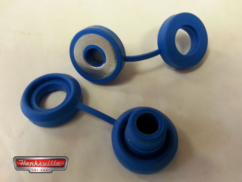

    A tiny but rather important update.
    I started looking at the exhaust mounting grommets I had bought and am using, the black ones you see in the photos.
    I realized that they are made of polyurethane and due to the way I am using them in close proximity to the heat (especially on the front hanger) that they would likely end up melting. :eek:
    So I sourced and ordered up some replacements made of blue high temp silicone.
    A very high heat resistance temp range so there will be no melting :cool:
    Details ;)
    Larry

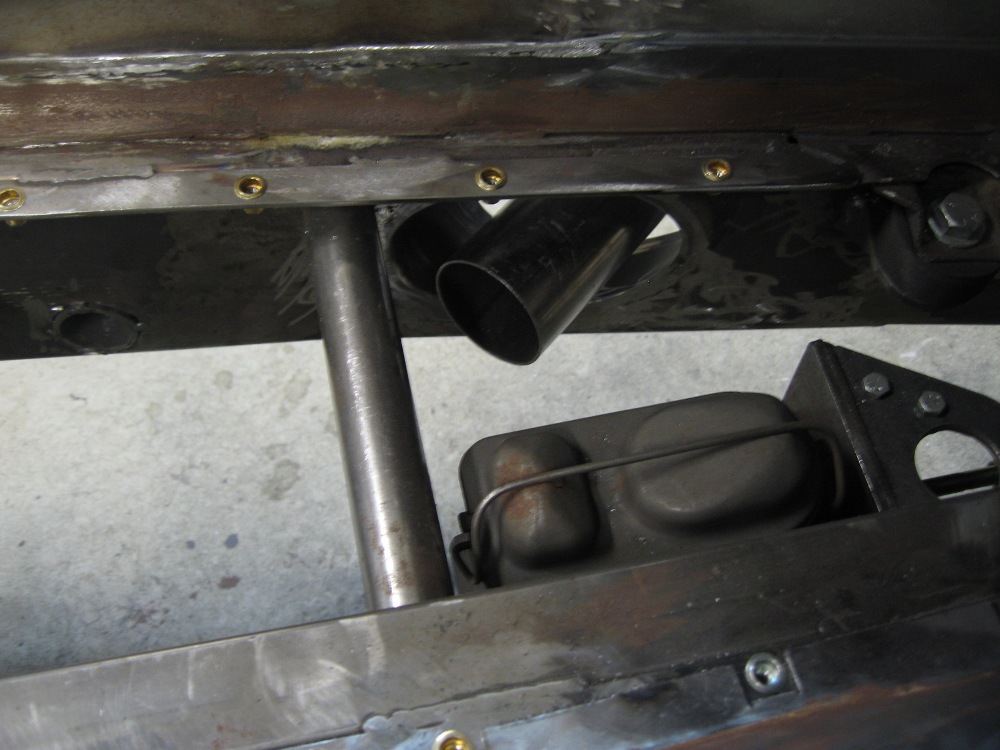

    Ok so I stretched the truth a wee bit. I have to remove the tailpipes and finish weld them and then re-install. :)
    I will also likely cut a small bit off of the ends so that they end even with the back of my bed.
    I left them a bit long.
    They clear everything and are tucked up above the bottom of the soon to be installed bump stops.
    Larry :cool:
