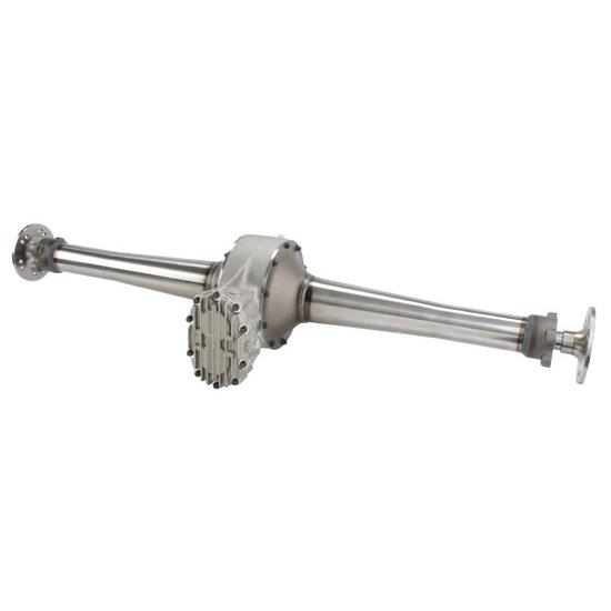

    So, here's where my thought process has been going.
    1) Buy the new Winters quick change as pictured above with a brand new drum brake kit to go with it, and have it built so that it centers the diff housing between the wheels.
    2) Since I have proven my rear suspension design works, build a bolt on ***embly to accommodate the upper control arms presently mounted on The Maverick rear end.
    I really like the look of the lower control arms I have mounted outside the frame as I feel they kind of balance the look of the front wishbones.
    That would allow me to keep my suspension design as is and run the new Quick Change.
    What do you think of that ? :) I think it would be :cool:
    loudbang and 26 T Ford RPU like this.

    I'm probably not going to be much help making your decision because I like your present setup except that the diff. isn't centered. That Winters would give your roadster some more WOW factor. You could also make some bolt on plates for the lower control arms too. I did that after I found out the original split wishbones weren't strong enough with an open drive banjo when they cracked. I bolted the new radious rod brackets to the front two backing plate bolts that I had replaced with longer grade 8s. You could make brackets that bolt to all four backing plate bolts if you feel the need.
    I've been told that my rear setup can't work but then I've been told that about my front hairpins with a tube axle and I've driven the roadster that way for almost 30 years now with no trouble. In all fairness though neither my front or rear suspension moves very far. I'm sure that whatever you do it will be as *****in as all the rest of your build.
    Gary
  12. Tim_with_a_T
    Joined: Apr 30, 2011
    Posts: 1,748
    Tim_with_a_T
    Larry,
    I would do it. The reason I say that is because I've contemplated the same thing, but I already spent $$ to have my 9" housing narrowed, new 31 spline axles made, found a good 3rd member with new gears, bearings, and posi, went out to the wrecking yards in the snow to hunt down the right backing plates, completely rebuilt the brakes, bought fancy brackets for my rear suspension and made ladder bars to fit. I feel like I'm kinda married to that setup, but not a day goes by that I don't think.....quickchange. Do it. You won't regret it. And post lost of pictures so I might be inspired to do the same thing when I'm not so poor!!!

    Are you still debating this in your head? You will never be satisfied with that Maverick unit. I would probably opt for the center kit and use early Ford trumpets. The Wedge Lok would be nice but really drives the price up. Get the lowest numerical ring and pinion that they offer. This allows you to more finely tune the final gear ratio and gets yu more use from the gears you have.
    Just Do It!
  24. Blue One
    Joined: Feb 6, 2010
    Posts: 11,512
    Blue One
    from Alberta
    I think the debate is over, I'm waiting for the shipping info from Speedway.
    I like the service they offer and I like Speedway in spite of what anyone else has said about them, they have always been very good to me.
    This is their description of the rear end:
    Finally an all new V8 quick change that has steel side bells and tubes that accept modern axles. They are available in either plain finish or a polished center section that includes stainless steel fasteners. These rear ends are 56" from hub to hub and have both 5 on 4 1/2" and 5 on 4 3/4" bolt patterns. They accept the new style big Ford brakes with a 2 1/2" offset and the standard ****er 1310 Chevy 3-1/4" u-joint. The 3.78 ring and pinion is mounted on a wedge lock differential and accepts common 6 spline quick change gears.
    I'll get the plain finish as pictured.
    I have picked out 3 different gear sets that will give me a pretty good range to play with and if that's not enough I can always order another set, in the scheme of things they aren't that expensive. :)
    I also called Winters for tech ***istance and they told me that the Nostalgia V8 QC center section is indeed centered in the total width of the rear end and that there is a slight offset inside the housing, the normal ring gear offset, but that the housing and pinion are centered and the axle tubes are the same length on each side.
    I also got some tips from them on gear set selection based on my drivetrain and tire size.
    With the brakes installed we are bang on the width of my 56.5" Maverick rear so that is awesome.
    I will be redesigning the top control arms of my suspension a little , it looks like I will be moving them down a small bit on the frame mount end and will design a bolt on bracket to fit the front top of the QC.
    I anticipate that they will be slightly less visible than they are now sitting on top of the Maverick rear.
    The suspension will still work as designed and be a whole lot cooler :cool:
    So yes Six Ball it looks like I am very close to too far gone :D
    Larry
