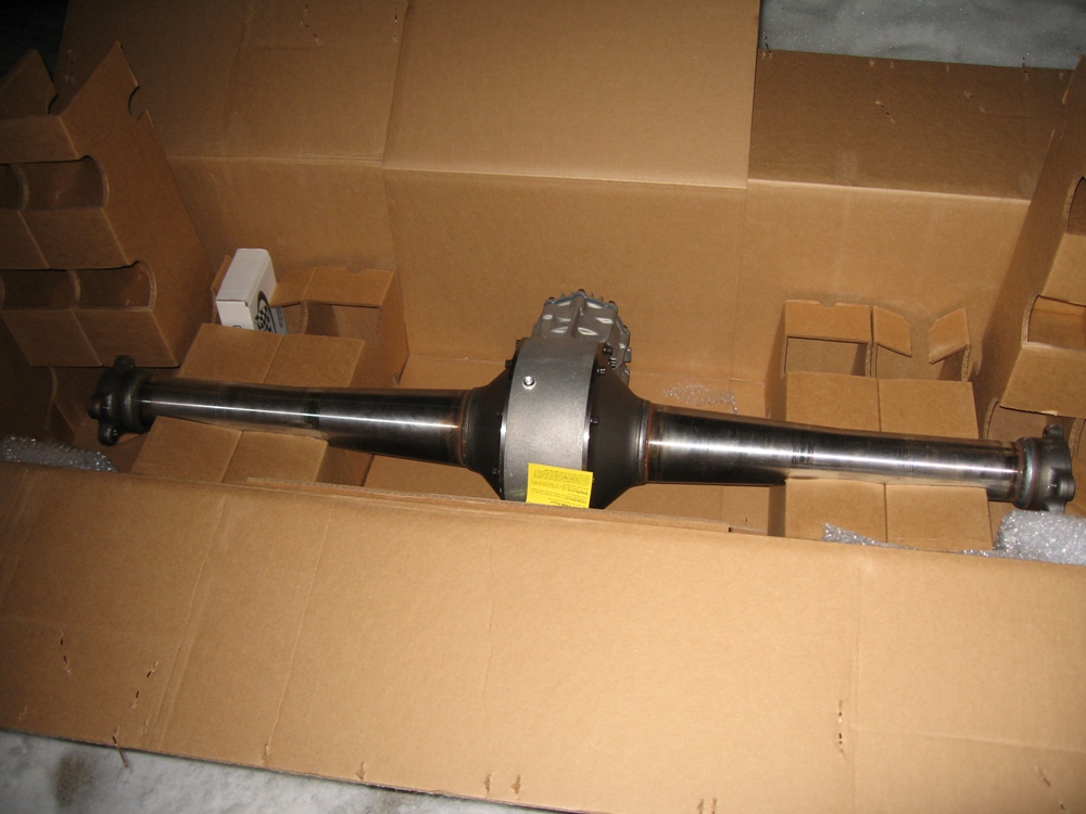

  6. The engine is very stable on those blocks. I made the "VAROOM" noises but let my niece drive. ha ha ;) Note that her right foot is down all the way. 1510978_10205563966165520_8963915574759902758_n.jpg

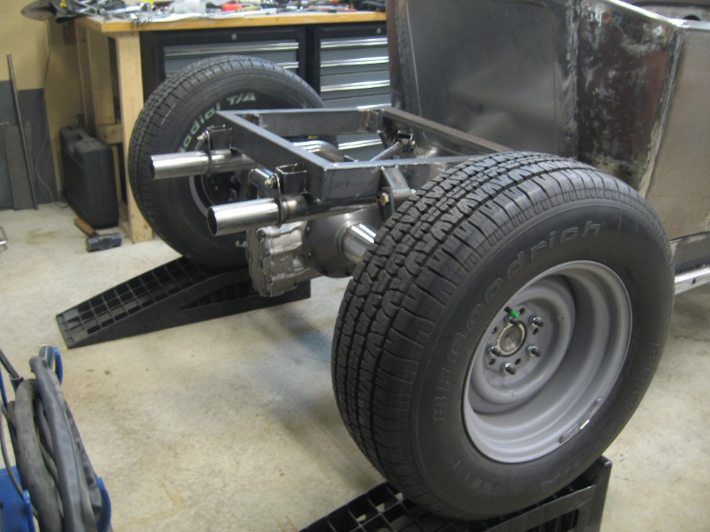

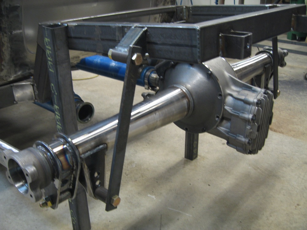

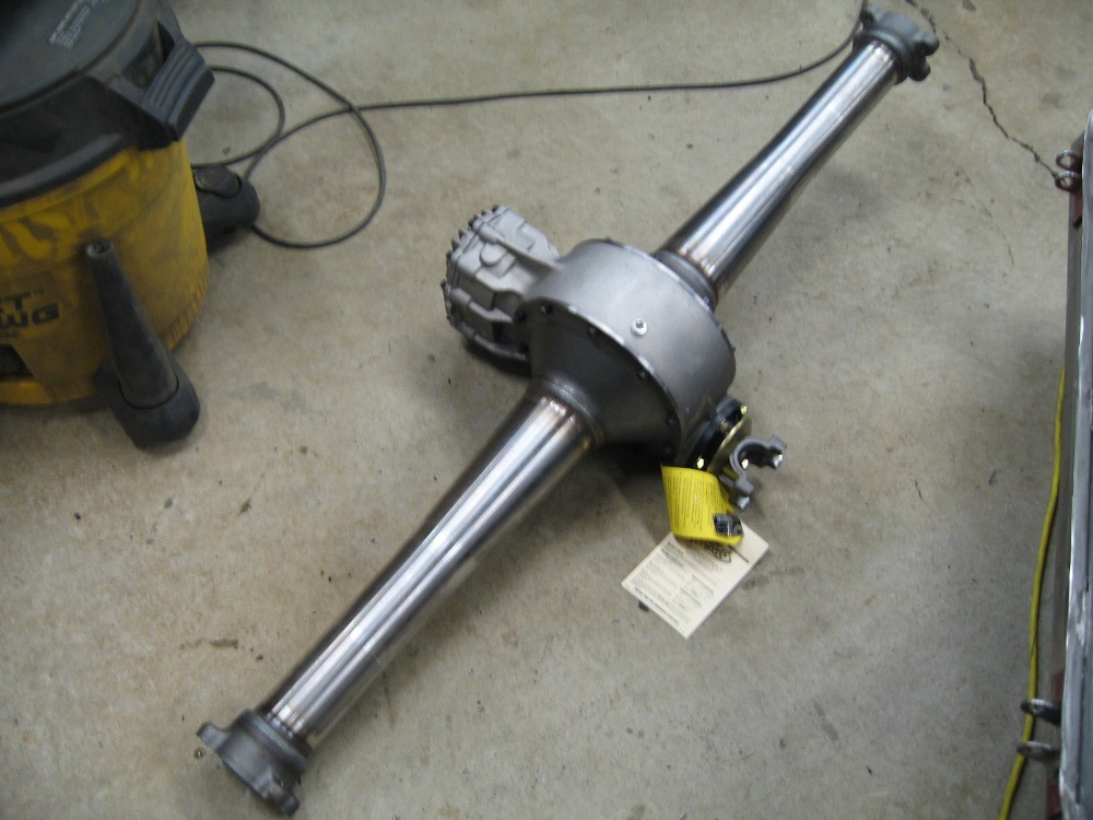

    Well, today I took the rear end apart to remove the differential and knock out the axle end seals to keep them away from the welding heat.
    Probably wasn't required ( taking it all apart) but I felt better doing so.
    I have to say that this quick change is a thing of beauty. The differential is amazing.
    I set it up and started installing my coil over brackets and the brackets for the lower wishbone mounts.
    A bit more welding and I can put it all together. :cool:
    Larry

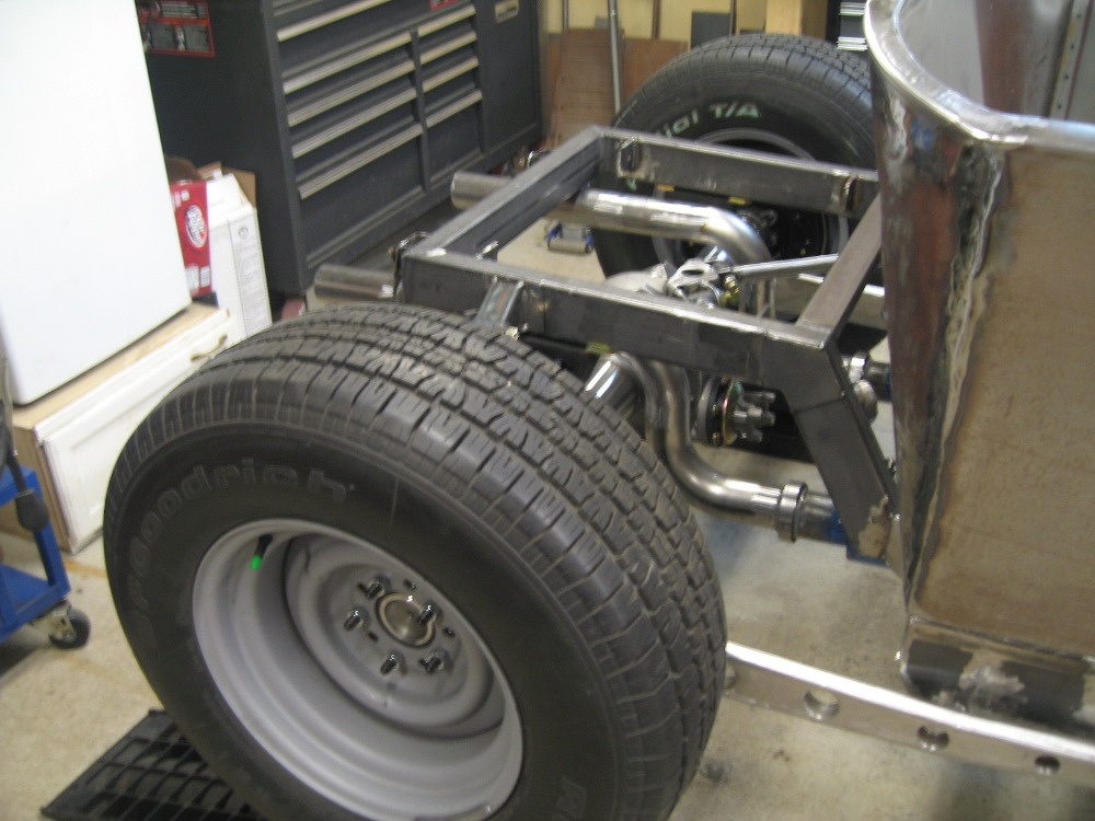

    Well the move to awesomeness takes one more step ahead :D ;)
    I have to figure out my top control arms and finish up the ***embly :)

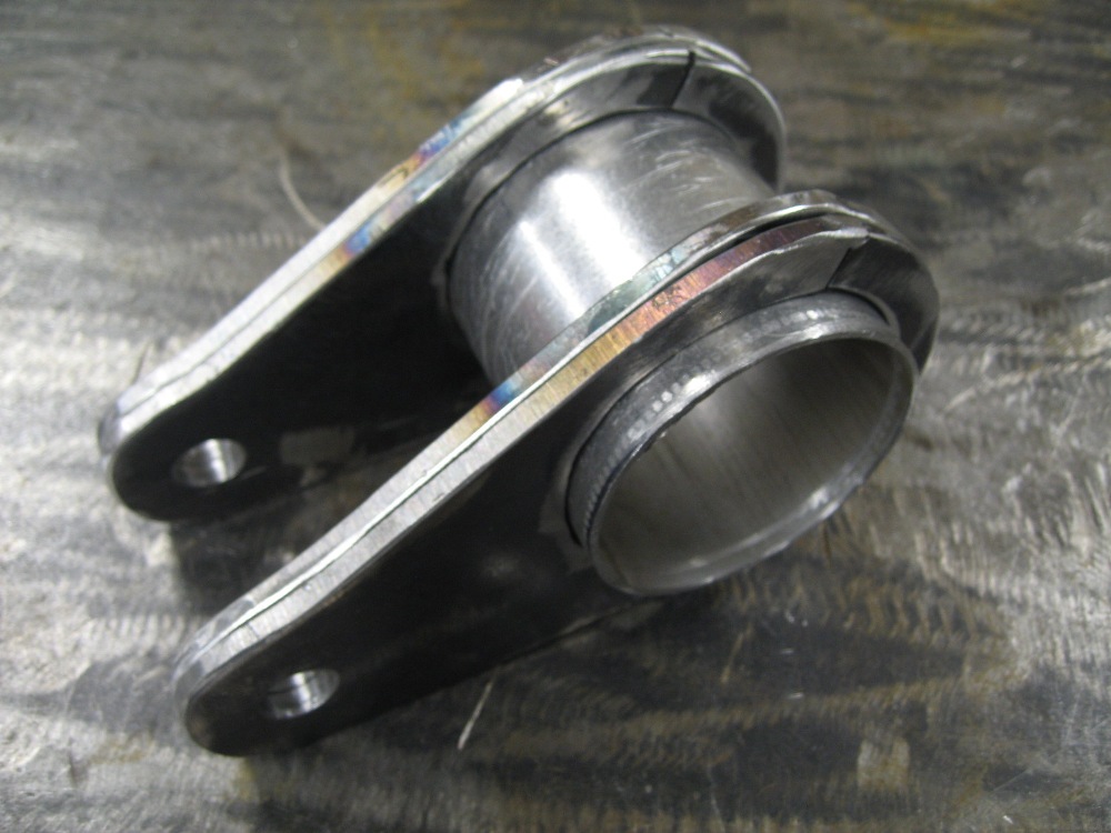

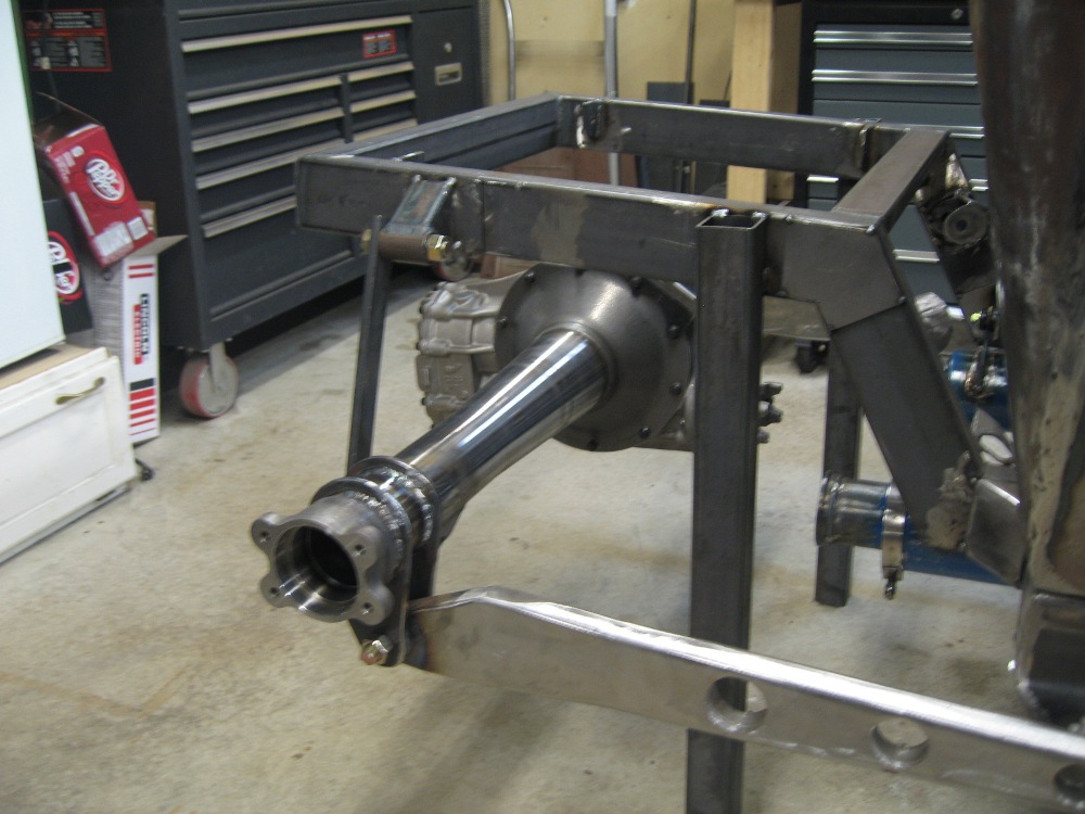

    Today I wrapped up the quick change install. Put the differential back in and plugged in the axles, and mounted the new brakes.
    The Winters did not allow for the usual T Bolts which come in from the back side of the axle ends, but instead has 4 threaded 3'8" holes for bolts.
    I liked the idea of studs better to simplify the brakes ***embly so I relief ground some grooves to allow allen headed bolts to be installed and act as solidly mounted studs to hang the brakes. Worked beautifully. :)
    I then installed the top control arm arrangement that I had fabbed up and also the new bump stops.
    The day ended with everything together and sitting back on the tires.

    Nice work, Larry. Particularly like the upper link mount and the way you contoured the bearing cups for the Allen bolts.
