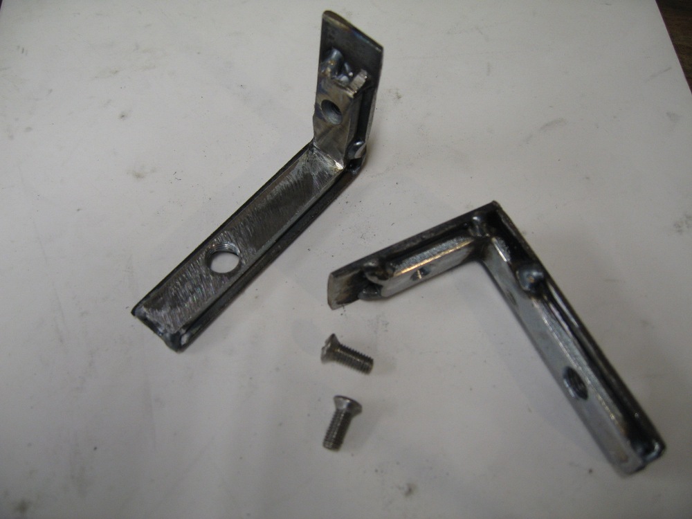

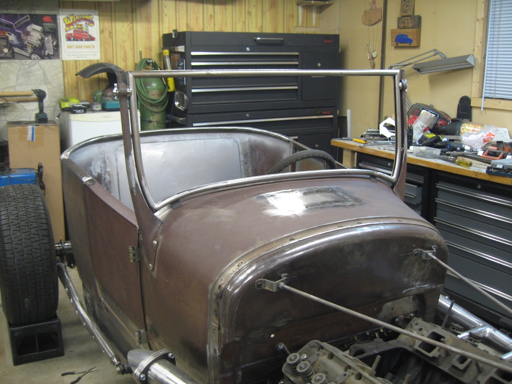

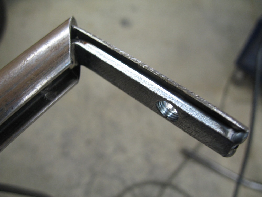

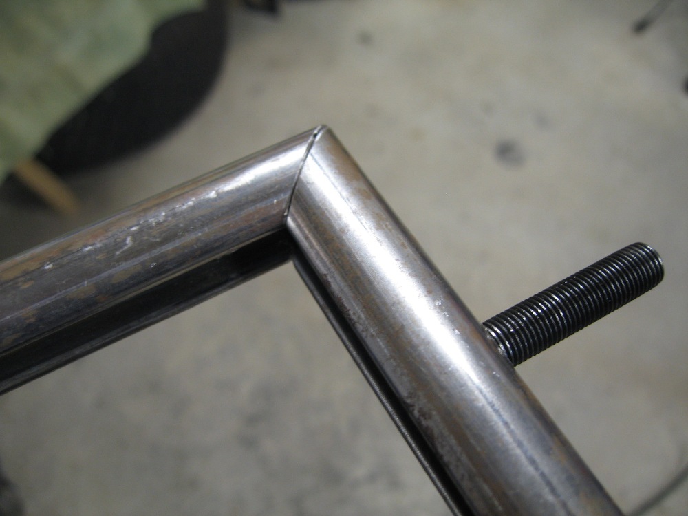

    Decided that I would get after the windshield today after I mounted the new driveshaft.
    I modified the corner support brackets that hold the top bar in on the new Mr. Roadster windshield frame.
    The brackets they supply are pretty useless as they come because they flop around inside the frame and make it very difficult to have the corners of the windshield frame fit nicely.
    So, I added some 1/8" x 3/4" flat bar and they now fit perfectly. :)
    The windshield frame is 4" lower than stock so I cut down the pair of nice original posts I had.
    I like the results, sitting in the car it will serve the purpose of blocking the wind and bugs etc. :cool:
    Plus, it is the right height to allow a nice top, which I will build soon :)
    Larry

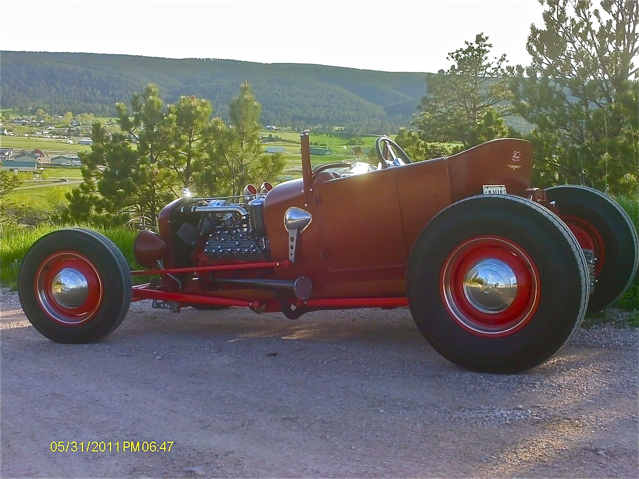

    IMAG0123.JPG This is mine and yes you get bugs in your face but I dont give a ****! I think sometimes its form over function.

    Im just Kidding about the windshield. You are right about not being able to run a top on my modified. Actually I wish mine was a bit taller, I went the easy route and just used the stock height lower section. Great build so far.

    So Ive been debating on sharing my thoughts about your windshield stiffeners. But here goes. As I read that post last weekend I couldn't help but wonder if the installed gl*** keeps the corner from being floppy, and now that the corners are 1/4" smaller than the rest what's your gl*** cutter/setter going to do to handle that?
  20. Blue One
    Joined: Feb 6, 2010
    Posts: 11,511
    Blue One
    from Alberta
    Not much new right now :)
    Working some extra time teaching a night course to pay for that fancy quickchange. :) ;)
    So, with late nights 3 times a week this ol' guy gets tired :D
    If I were to show you a close up end view of the windshield frame tube ( a cross section) you would see that the frame actually has a formed channel for the gl*** inside the round tube that makes up the frame.
    The whole corner bracket along with the extra metal I added just slides into the 1/2 round portion of the tube under the gl*** channel and serves to align the frame corners and hold the top tube in place once the gl*** is in.
    So, it has no effect on the gl*** channel or gl*** size. :)
    Larry

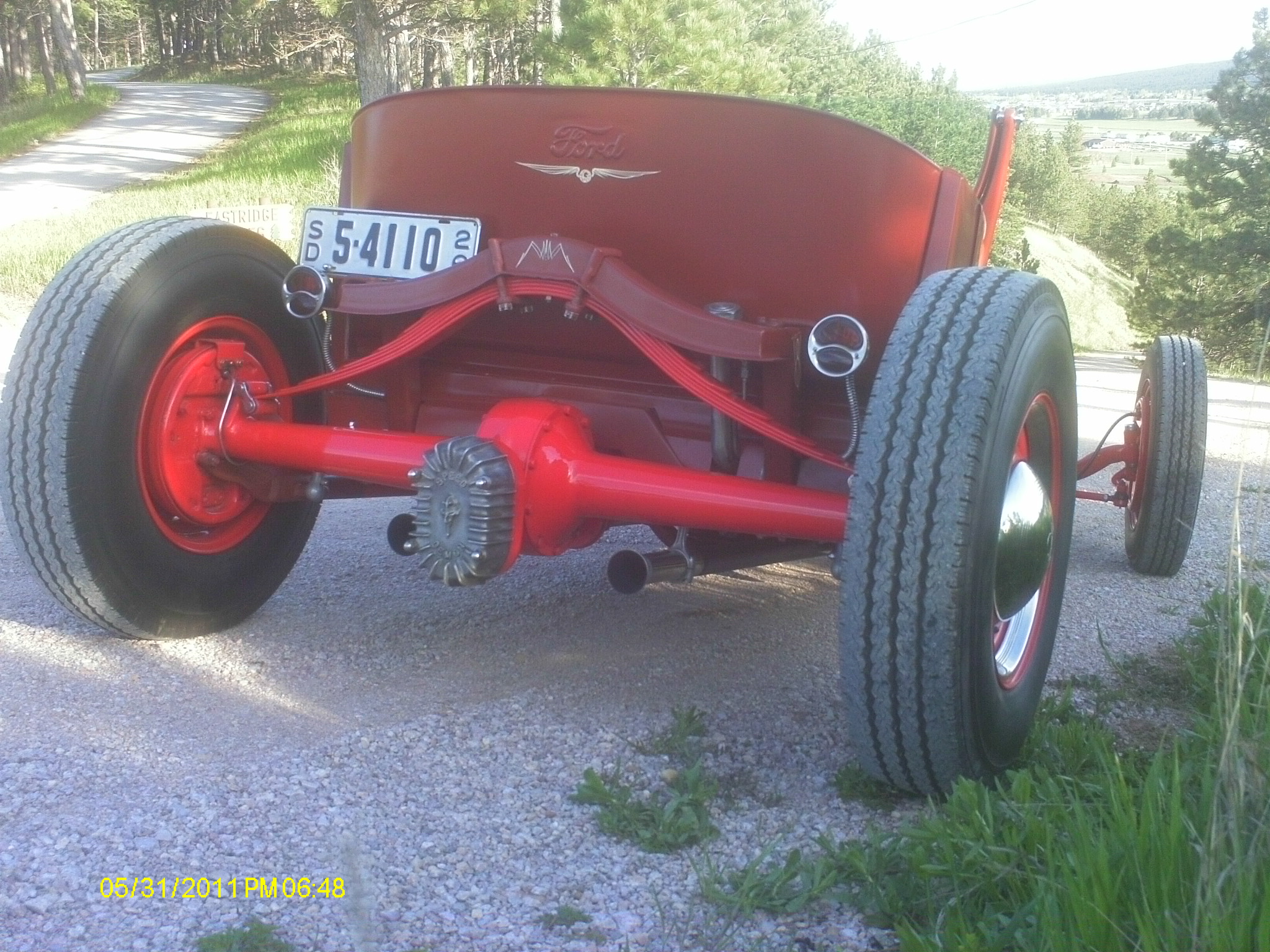

  26. rusty rocket
    Joined: Oct 30, 2011
    Posts: 5,254
    rusty rocket
    IMAG0126.JPG I had to vent mine also. When I got it running for the first time it really pushed lube out, If you look close you can see a small silver bump on the axle tube below the license plate. I dont even remember where I found my vent.
    damnesia and loudbang like this.

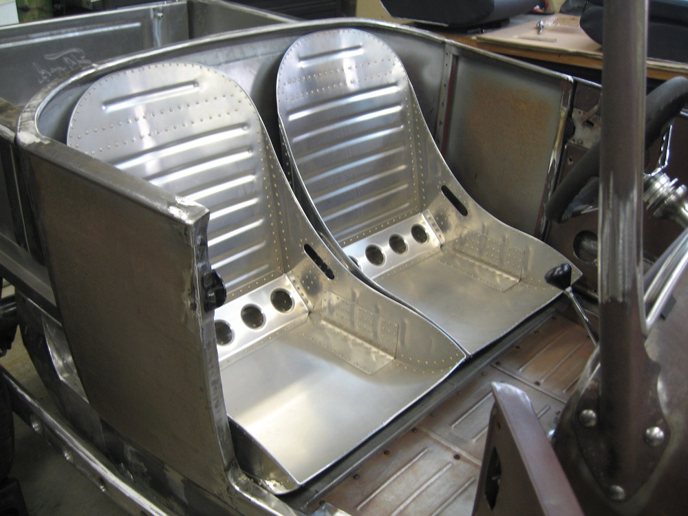

    Mocked up a gas tank today out of cardboard.
    It's about 17 gallons and leaves me with a bit more than 1/2 of the space in the bed. So a little bonus.
    I'll build it out of aluminum.
    Also put the Frank Wallic bomber seats in place and spent some time looking and pondering, some time sitting in them.
    I'm on the fence about using them, I have considered selling them and going with a built in bench, however the bombers are starting to grow on me....
    With the pads they are fairly comfortable and I like the look...I think :)
    Opinions welcome as always :D

  28. Dick Stevens
    Joined: Aug 7, 2012
    Posts: 4,123
    Dick Stevens
    Larry, they do fit in there pretty well, but I have to say I'm not a big fan of bomber seats, FWIW, I think a bench is the better look.
  29. nitrobrother
    Joined: Dec 24, 2004
    Posts: 4,379
    nitrobrother
    Those seats -- and pads -- look really good in there.
    redzula likes this.
