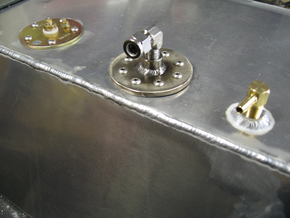

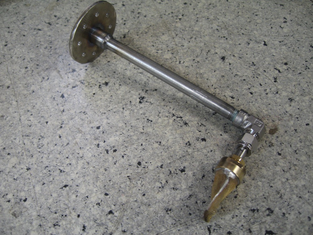

    Got the fuel pickup tube made today with the fuel pickup screen ( a Jaguar part ) that I ordered online.
    Installed the fuel pickup tube and the rollover valve-vent along with the gauge sending unit.
    Gas cap also, for all these I installed 10-32 rivnuts and used stainless steel ****on head hardware. :cool:
