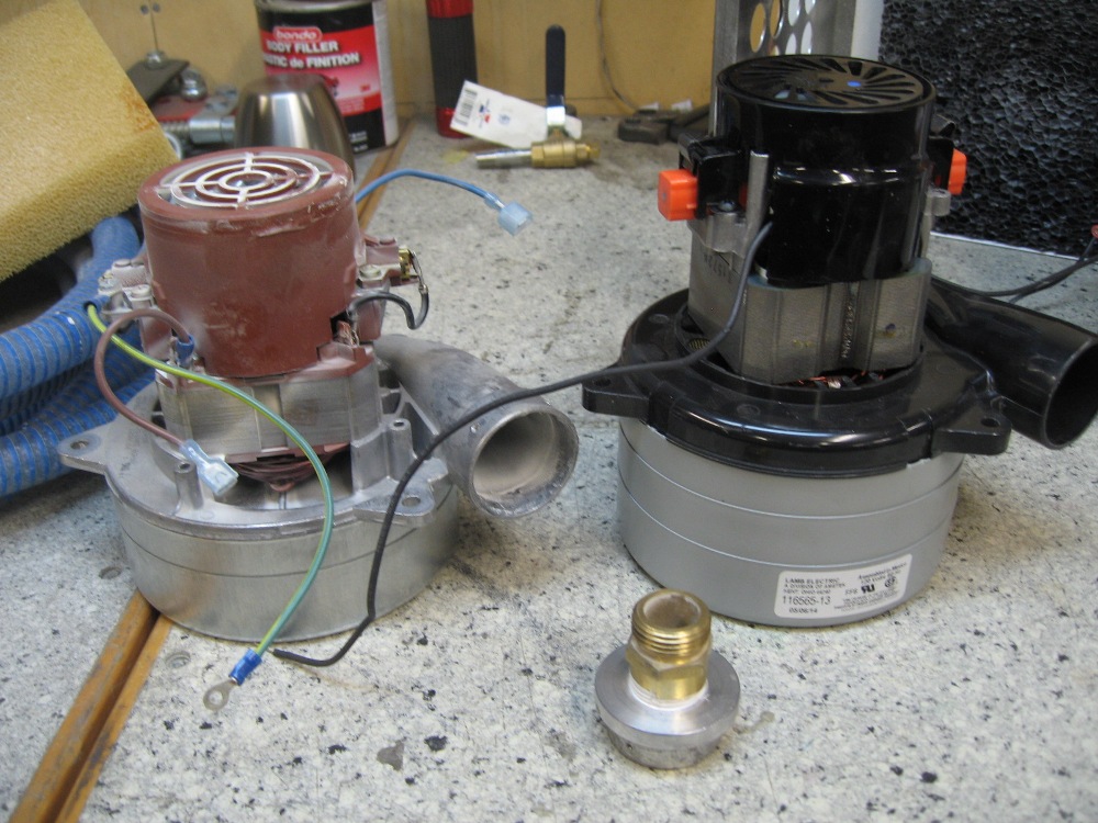

    And, like any self respecting hot rodder I had to hop up the turbine sprayer :D The unit is a 2 stage turbine, and I happened to have a new Ametek 3 stage turbine in my cupboard :)
    So, out with the 2 stage and in with the 3 stage. Better paint atomization and better spraying ;)
    More Power :D ( In my best Tim Allen grunt) :D:D
    Larry

    New turbine installed and ready to run. Should be good. :)

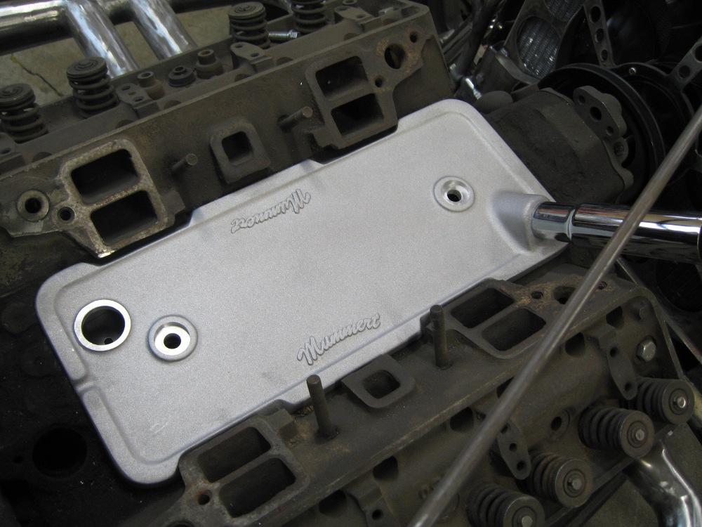

    I love getting parts in the mail :)
    Todays arrival from John Mummert. Thanks John. :cool:

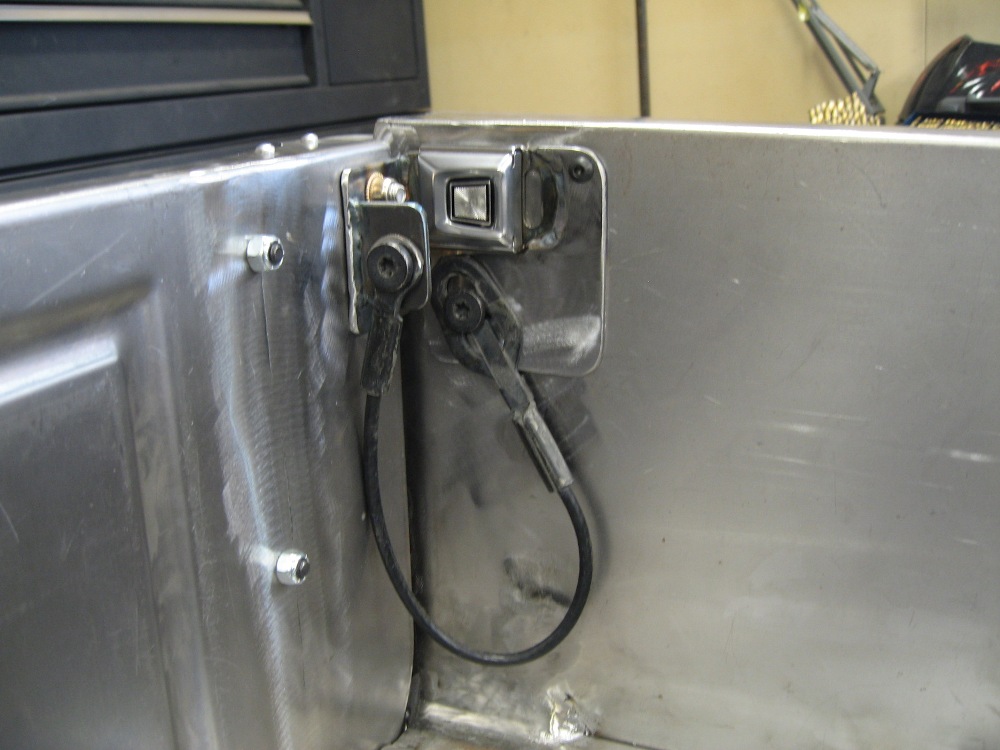

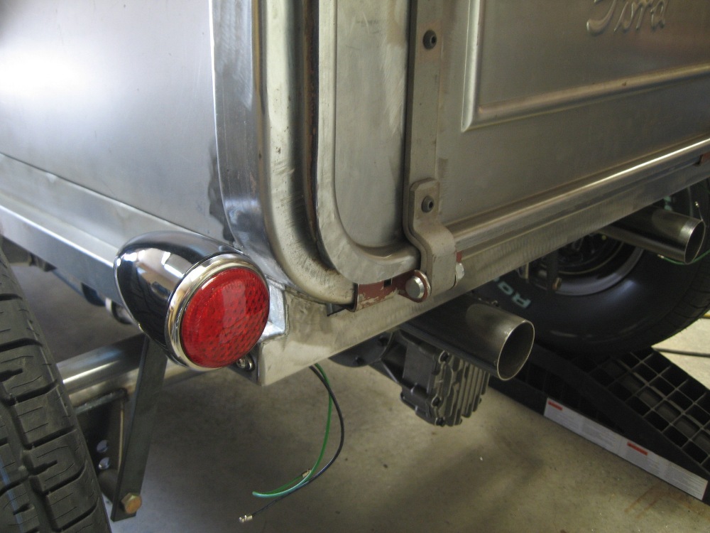

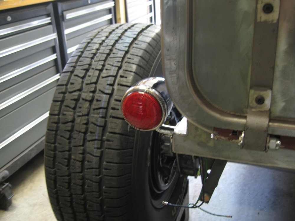

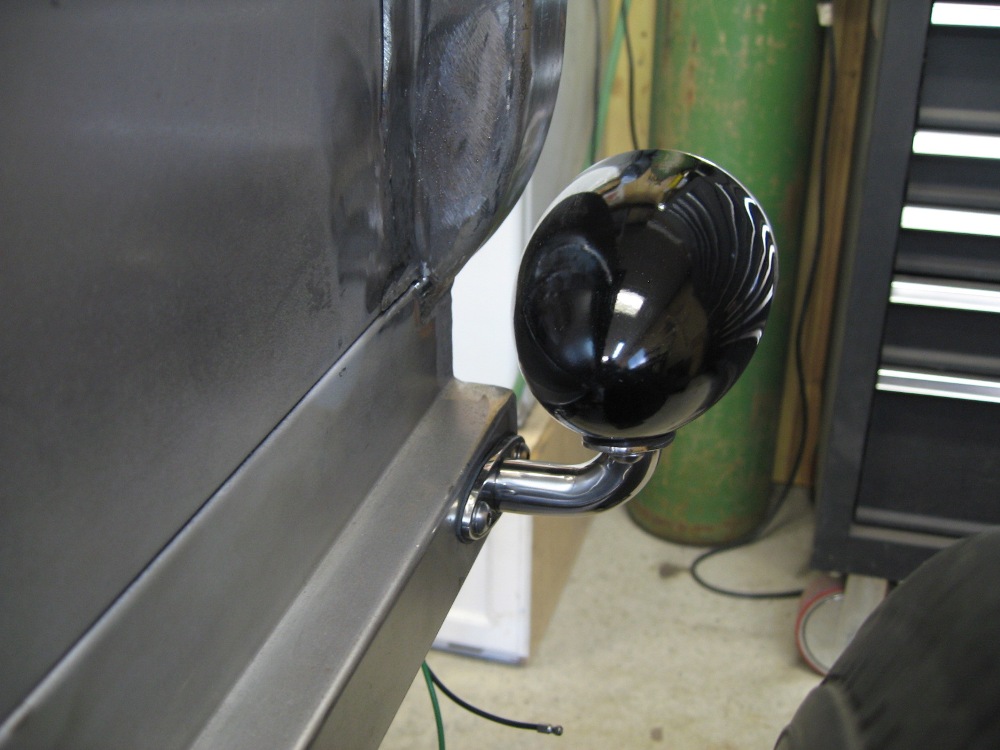

    I did a few small things today, mounted the 37 Ford tail lights on a pair of mounts I ordered from So-Cal.
    They mount to the bottom corners of the pickup bed.
    Then I used a pair of old seat belt latches as tailgate latches and added a couple of rubber coated tailgate cables I scored at the wrecking yard off of a Dakota pickup.
    I like it, I didn't want the old chain system for the tailgate.
    Larry

  18. Wow, what an amazing idea for the gate catches, man I am impressed. Those are Chevie '37 tail lights and not Teardrop ones I believe.
  19. brad2v
    Joined: Jun 29, 2009
    Posts: 1,659
    brad2v
    The gate catches are brilliant Larry, very slick. Those are Ford lights Whip
  20. Yes, my mistake, they are 1937 Ford Tail lights but not what I believe are the teardrop lights as on the '39 Ford. Heck, I'm so confused now.[​IMG]
  21. 26 T Ford RPU
    Joined: Jun 9, 2012
    Posts: 12,601
    26 T Ford RPU
    Sorry Marc, they are 38-39 tail lights. JW:)
  22. Which ones are what now Jeremy ? Larry's are 1937 Ford and ones above are, I believe, '39 Ford and then in 1940, Deluxe models had the "Sergeant" stripes and the Standard model had one only "teardrop". But, hey, I haven't had a drink today so that maybe causing the confusion.
    26 T Ford RPU likes this.
  23. Blue One
    Joined: Feb 6, 2010
    Posts: 11,512
    Blue One
    from Alberta
    :oops: Oops :D My mistake. They are 37 Ford tailights but they are not called teardrops.
    Glad you like the tailgate idea.
    Larry.
  24. 26 T Ford RPU
    Joined: Jun 9, 2012
    Posts: 12,601
    26 T Ford RPU
    Marc, the 37s are sometimes referred to as teardrops due to their overall shape, not just the lens, the ones you know as teardrops are 38-39 and the sergeant stipe's are on the 40, 1 for std and 2 for dlxe.
    Larry, looking soooooooooooooo good:cool::cool::D JW
  25. loudbang
    Posts: 40,346
    Great thinking using those seatbelt parts for latches.
