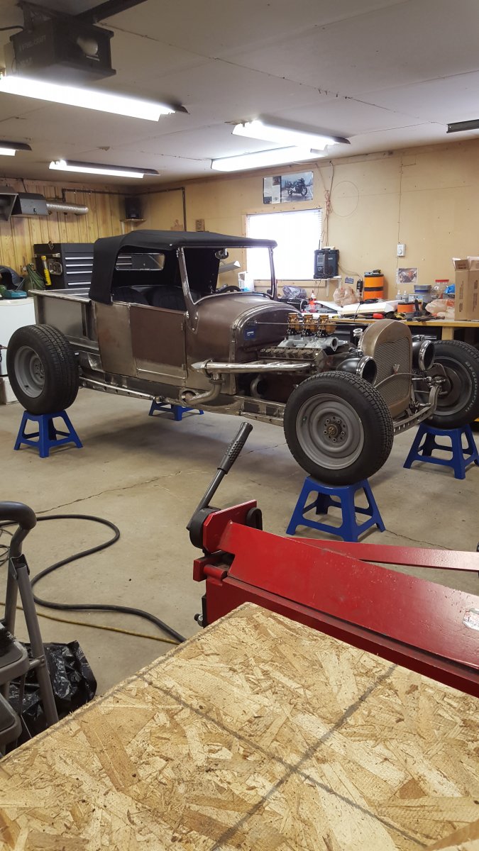

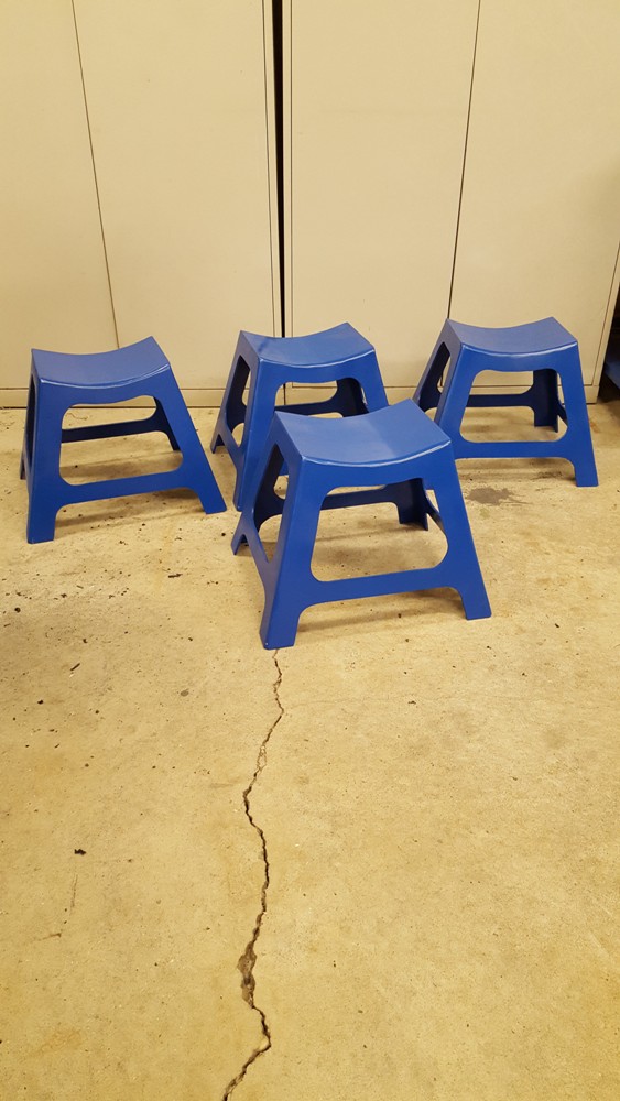

    Built some stands to put the RPU up at a better height for working, 12" high.
    Also got word that I should have my MT Products Lincoln front drum brakes in about a week. :cool:

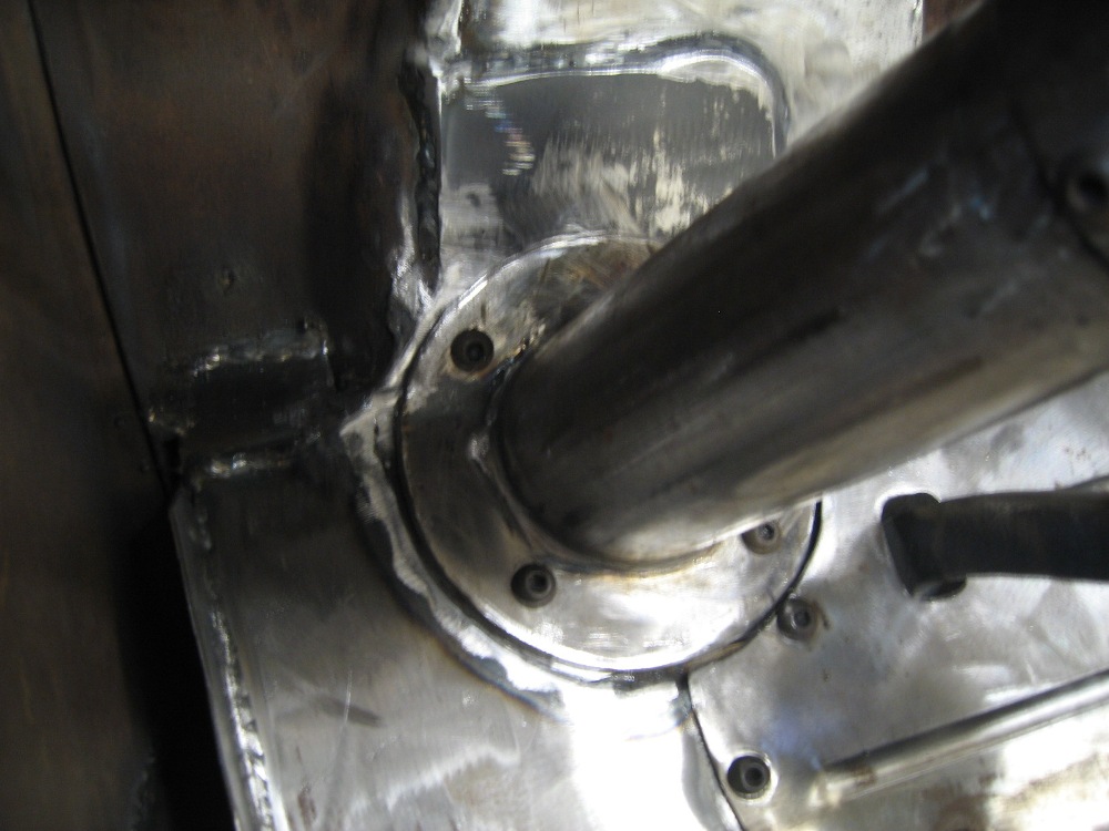

    When I built my steering column I used 2.5" exhaust tubing for the bottom section and had it terminate at the floor where a u- joint p***es through the firewall to connect to the steering box.
    This left the u -joint exposed and the bottom of the column open to wind and water.
    So, to enclose the u-joint and close off the column I fabricated a stub with an end plate and a hole for the steering box spline.
    It had to have an access hole to get to the u-joint set screw.
    So I added that and made a cover for it. ( There is also a drain hole in the bottom so if any water gets in it will drain out.)
    I removed the steering column and welded the stub in place. When the steering column is bolted back in place it is now sealed and finished.

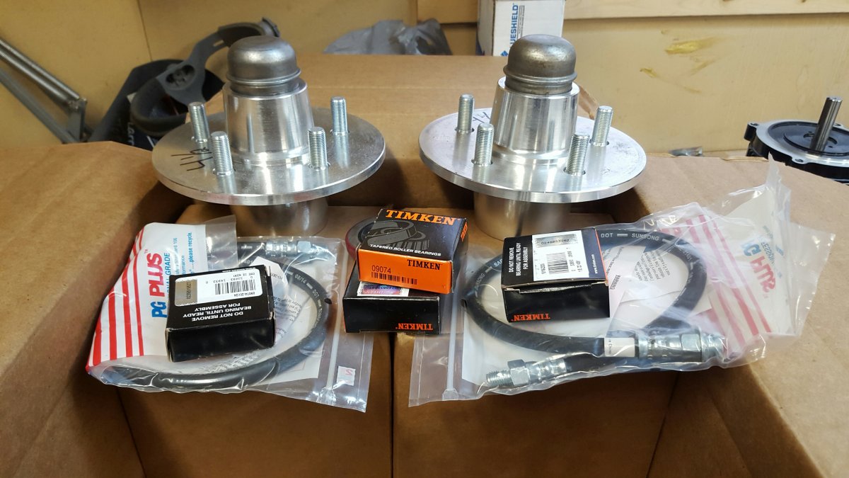

    These brakes are things of beauty. Wow. :cool:

    My Dad and I are dealers for MT. They are very good products but there's a few things you need to be aware of because they aren't totally ready to use out of the box.
    1) The hubs and drums need to be bolted together with nuts and flat washers on all 5 studs, torqued evenly then lightly machined on a brake lathe to true the shoe surfaces to the centerline of the hubs. I find that it typically takes a .010" cut to accomplish this which will result in the drums being .020" oversize. Once you have done this and BEFORE the hubs and drums are taken back apart you need to mark them Left and Right then make indexing marks so that the drums are always mounted to the same hub and in the same position. Every pair of hubs and drums that are sold through our shop get true'd and indexed. I have never found a pair that don't require this.
    2) The brake shoes will need to be arch-ground to exactly match the diameter of the shoe surface on the drum. Even as the drums come out of the box before truing the shoes are rarely a perfect fit. Arch grinding is essential as it ensures that the full length of the shoes are contacting the drums.
