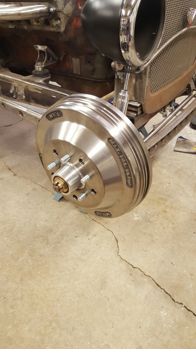

    Time to say goodbye to the disc brakes :)
    Had to make some thick washers to make up for the backing plates being thinner than the disc brake plates, that allows the bolts to be tightened into the steering arms without bottoming out.
    I have one more task, the wheel studs aren't quite long enough due to the drums thickness, I'll have to source some longer ones. :cool:

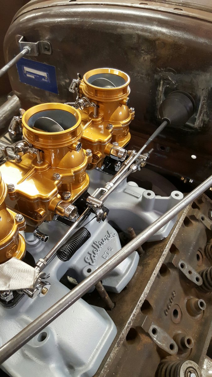

    I didn't like the way the old boot from the MC worked for the throttle rod so I ordered a Stude-Avanti boot from that auction site.
    Once it came I made the appropriate 2" hole in the firewall.
    The boot has a 1/4" hole in it and my throttle rod is 3/16" Stainless rod.
    So, I slid a piece of plastic tubing over the rod and sanded down the diameter of it a small bit, then held it in place with a length of shrink tube.
    It now works and seals very nicely.

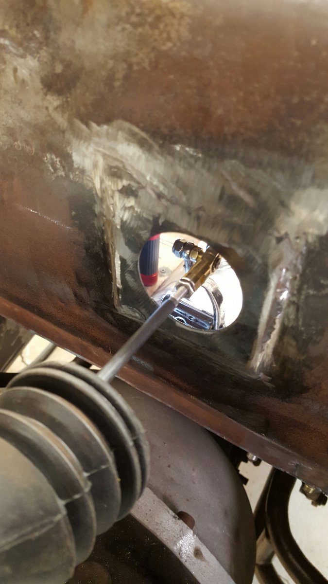

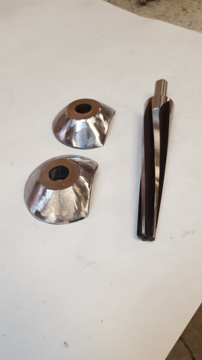

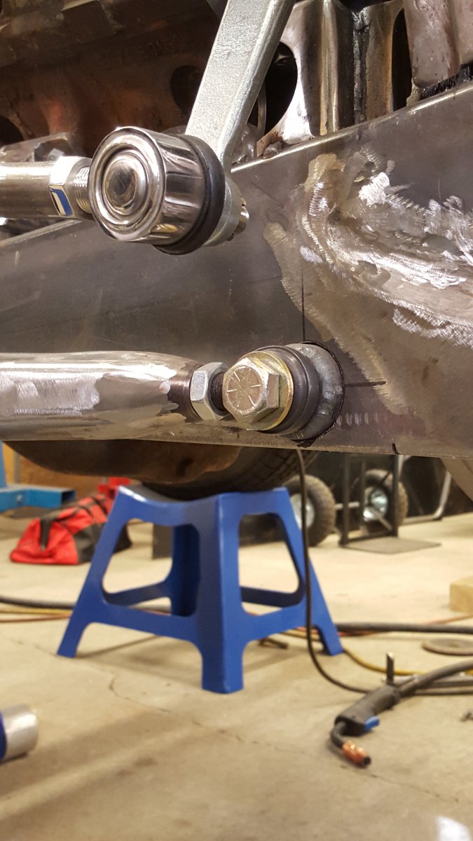

    I decided to change the way I did the wishbone ends front and rear as I had mounted them to the frame with 5/8" heim ends.
    I bought 4 polished SS 5/8" tie rod ends from So-Cal and a tie rod reamer (1.5"-foot = 7 degrees ) from Speedway motors so that I could fabricate a mount pocketed into the frame.
    The mount plates are 1/2" steel with the tapered tie rod hole.
    One down, 3 to go :D
    Larry

  11. 26 T Ford RPU
    Joined: Jun 9, 2012
    Posts: 12,585
    26 T Ford RPU
    They will now match the drag link, looks good. JW

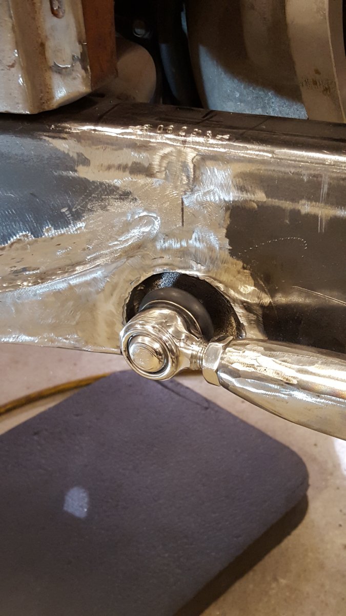

    Another front mount ready to weld into the frame.
    Welded in and the fronts are done. I left the weld cleanup on the inside for when I take it apart for finishing.
    A good day in the shop :)

    The rear wishbone frame mounts required a different approach.
    Because of the contour of the frame the mounts had to be raised off of the frame rather than pocketed in.
    After a little thought I started out by pressing a 4 inch square piece of 9/64"
    cold rolled plate into a 3" pipe using an impact socket to form a cone.
    volvobrynk, loudbang and AndersF like this.
  16. Blue One
    Joined: Feb 6, 2010
    Posts: 11,511
    Blue One
    from Alberta
    After that it was time to sleeve the frame, make the tapered bungs and weld them into the cones.
    Cut the cones down to fit the sleeves and fit and weld it all in.
    Whew! :D :cool:
    Larry
    20160319_105813.jpg 20160319_105342.jpg 20160319_111748.jpg 20160319_120806.jpg 20160319_121558.jpg

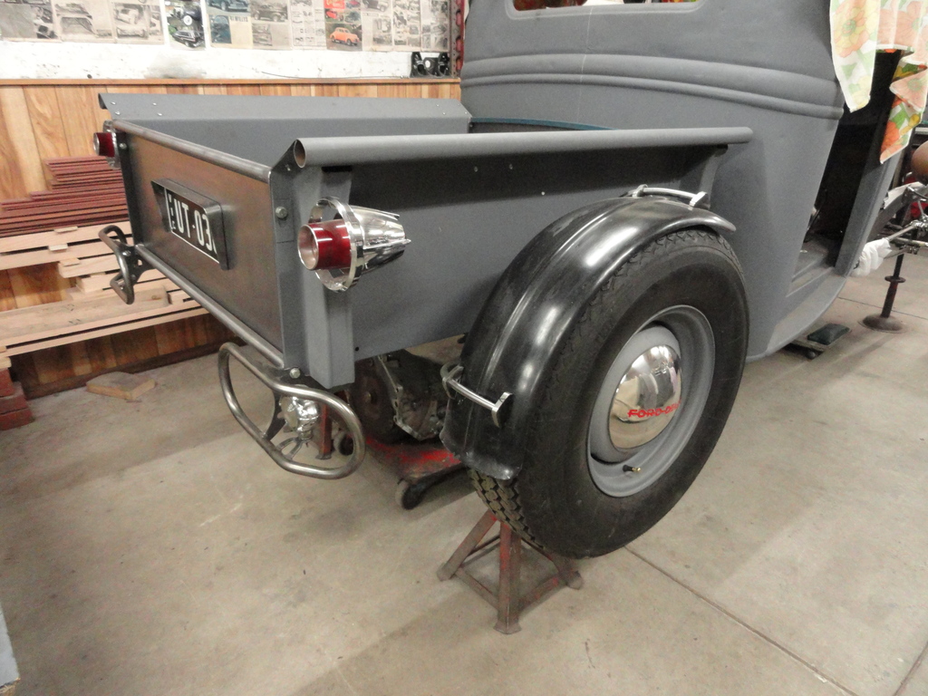

    Well, I got a set of fibergl*** cycle fenders similar to the ones in this photo from a fellow in the UK, Mark Bull.
    They were not quite the right width for my tires so with a little work I widened them to fit.
    I'm going to be sending a pile of parts to Ogden Chrome in Ogden Utah for plating very soon. :cool:
    I wanted to have the cycle fenders for the option of running them if I want to even though most of the time I'll be running fenderless.
    And, I want them to look good instead of looking like an afterthought, or modified trailer fenders :rolleyes:
    It will make inspections and registration a lot easier as well ;)
    The cycle fenders look better when they are mounted close to the tire so for mounting brackets I think I like this idea.
    The external brackets and supports allow for closer to the tire mounting.
    I will probably fab up something similar.
    Larry.

    Tucking them in close to the tires does make them blend in and not stand out like a sore thumb.
