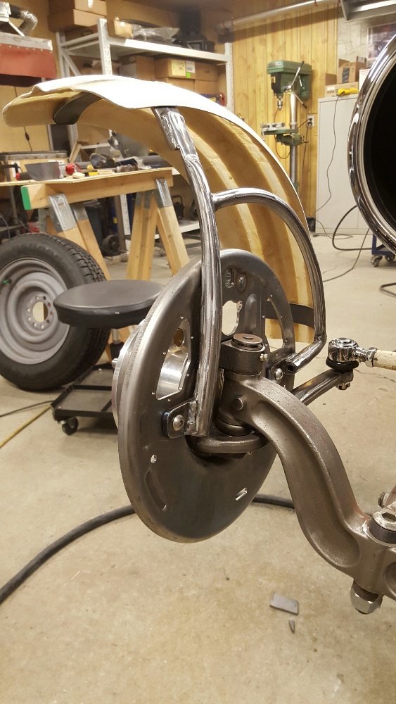

    In preparation for dis***embly and finishing (chroming etc.) I am trying to get every possible thing I can think of fabricated.
    One of the things on the endless list is a set of cycle fenders.
    I want to be able to have them for inspections and registration, however they will fall off afterwards ;)
    I wanted them to be lightweight and look good too so that if I decided to run them at times, then I could.
    I ordered up a set of fenders in fibergl*** from Mark Bull in the UK and then proceeded to widen them to suit my tire size.
    I went to a local bicycle repair shop and picked up a half dozen bicycle forks to build mounts from.
    The shouldered ****on head screws are shortened fairing plastic bolts from a Honda ST1300 motorcycle.
    I ordered 16 of them at the Honda shop. :)
    2 days of work led to one front fender mounted.
    Larry 20160318_112636 (2).jpg 20160523_130104_resized (2).jpg 20160523_130126_resized (2).jpg 20160523_145427_resized (2).jpg 20160523_145453_resized (2).jpg 20160523_145555_resized (2).jpg 20160523_150120_resized (2).jpg 20160523_150139_resized (2).jpg

  10. brad2v
    Joined: Jun 29, 2009
    Posts: 1,659
    brad2v
    Love the cycle fenders Larry, nice job on the brackets. Consider the idea stolen :D

    Super cool and tidy, Larry. With some threaded bosses welded inside the backing plates that would make fitting and removal easy.....but I bet you have already thought of that. JW

    An update. I finished the front fenders.
    Moved them away from the tire a small amount for better clearance.

  22. Blue One
    Joined: Feb 6, 2010
    Posts: 11,512
    Blue One
    from Alberta
    Thanks fellas.
    I had originally used 3/8" thick plywood spacers to space the brackets out from the tires and they were really close.
    I moved them out using 5/8 " plywood for spacers and the difference is much better clearance but still looking good.
    Larry.
