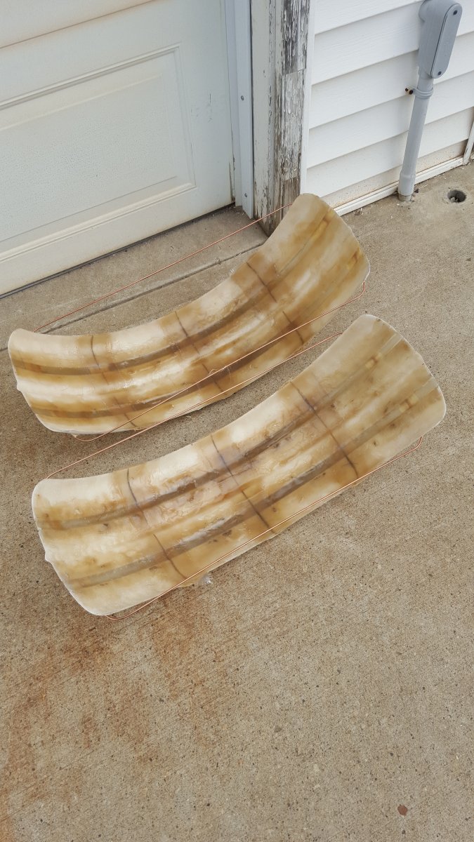

    Gl***ed up and curing. 3 layers of fibergl*** cloth and resin.
    Shouldbe fully cured in an hour or so and then I can peel off the plastic and tape from the outside. :cool: 20160628_163552.jpg

    :D Actually there has been no itching involved yet at all.
    I wore long sleeves and a dust mask and stood in front of a large fan aimed out of the shop doors to do the cutting.
    After that the resin and cloth doesn't generate any itchy dust.
    The resin curing is smelly but that isn't hard to deal with.
    All in all the fibergl*** work isn't that difficult.

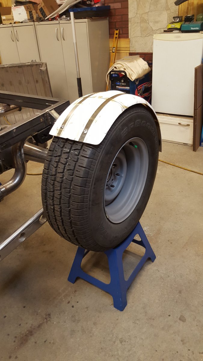

    One completed fully removable rear fender mount.
    Ready to mount the fender.
    The bicycle forks sure make nice fender mount material.

    I have a problem to overcome, not sure how I will solve it but I am pondering.
    The rear fenders are just large enough that they are not going to be well enough supported by the 2 supports.
    With the fender mounted there is far too much vibration generated by a sound thump or two on the fender.
    Bouncing harmonics from running down the road would quickly become a real problem I think.
    I have to rethink the situation and come up with a solution.
    The front fenders being much smaller do not share the same issue.
    If not then fenderless will rule and the fenders will be strictly to bolt on for possible inspections and then live on the shelf the rest of the time. :D
    I am going to try to solve this dilemma however because I'd like to be able to run them if I want.
    Larry

    Would adding a steel flat bar across the tire, tying the two brackets together work? By joining them, independent movement would be eliminated, and the fender would flex less bonded around the radius vs just on the two horizontal mounts. Longer trips with rain potential sure would benefit from these fenders.

    Would a third support to the curved brace or all the way across the inner fender help or just add more stuff to vibrate? You have done a very clean job with these but I like the run 'em when you need 'em program. Quality work like the rest of the build.

    I am considering that as a possibility.
    Also wondering if making the mounting metal strips over the tire out of thicker metal would help.
    They are 3 /16" now.
    Works great for the front, the rear may need thicker straps.

    I'm not sure on that. I thought of the extra brace and may try that as it would be easy to try and remove if it didn't work.
    There is a point where too much extra weight will just add to the problem.

    We have a winner. :)
    I decided to give that idea a try, as I said it had been something that I thought about.
    Adding the 3rd support and a couple of extra bolts holding the fender is going to work.
    Like all cycle fenders they are bound to shake around but it will be ok.
    No more crazy out of control stuff.
    I should be able to run them or not as I choose :cool:

    Fender mounted and bolted down.
    It's much better and I'm feeling better about it now.
    I'm going to be trying fender less and fendered when I finish the car and see what I like best.
    Maybe it will be like changing your shoes lol.
    Of course they will look even better with the PU bed back on I think.
