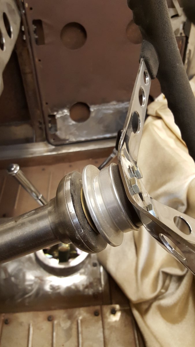

    Heres a small one to prove that I have been doing something :D
    The dilemma was a way to cover the removable steering wheel hub.
    If you cover it then you can't get at the collar to remove the steering wheel :confused:
    The solution I came up with is a cut down cup from a Stanley thermos.
    It ends up being a tiny bit larger than the Ididit steering column but still fits the hub and looks good.
    A ring welded to the bottom edge of the cut down cup and a couple of finger holes added to release the wheel.
    A skin of filler and a bunch of sanding for paint. :D

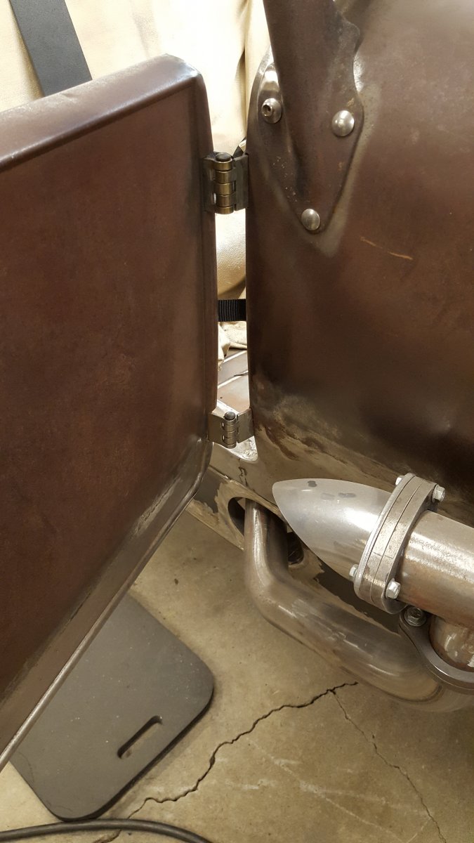

    Spent some time today fabricating a rather complicated little device. :D
    There will be 2 of them and they will mount behind the kick panels down by my feet.
    Can you tell me what they will be? :D

    Poor guesses so far. :D Think keeping the doors from hitting the lakes headers :D

    Door checks strap type of thingie. JW

    Right you are, and they will be self retractable too. :)

    Well, back at it. I finished the p***enger side door check strap.
    A small modification to the spring retractor ***embly I had built was needed.
    I had allowed for 3" of travel and had to reduce it to 2".
    I got some nice smooth and strong thick weight 1" nylon webbing from the outdoor supply.
    The retractor mounts to the framework I built to hold the ABS kick panel.
    It works well. Nice and clean and the door will not hit the header now.
    That will help once it's painted.
    Another thing that pleased me was the way the door functions.
    I wasn't sure how the strength of the springs I used would work out.
    As it turned out, they work nice and smoothly, the strength of the spring is enough to retract the strap properly but not enough to actually pull the door away from any position from partially to fully open.
    Having a flat strap barely visible when the interior panels are in place will be nice.
    Now for the drivers side :)
