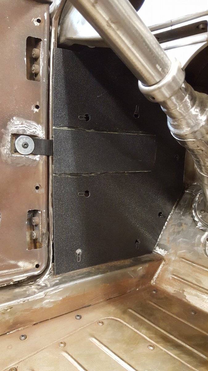

    After much head scratching on what to do with the side panels and the curved body I made a plan and went ahead.
    The rear panel was a problem as I just wanted to line the body behind the seats and have absolutely no room for clips of any kind.
    So after much fabrication and welding in of the support structure for the side panels I got out the heat gun.
    I heated and bent the ABS side panels to the shape of the body and the rear panel is held in place by the side panels which overlap the rear panel a small amount.
    Next I'll put the seats back in and figure out small arm - elbow rests to go beside the seats.
    So now I have all of the interior panels made and ready for upholstery later on. :cool: Larry 20160902_120543.jpg 20160902_120611.jpg 20160902_154943.jpg 20160902_154954.jpg 20160902_155058.jpg

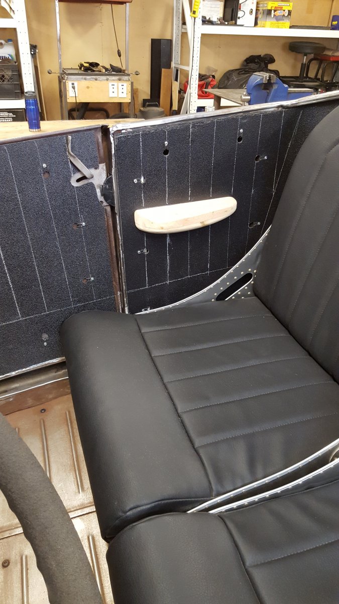

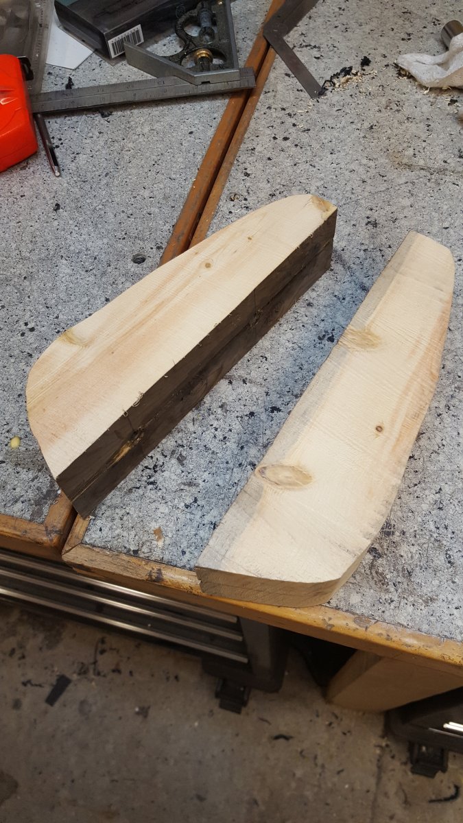

    Arm rests. There isn't much room for them however there is enough.
    So, how do you make a pair of armrests?
    A paper pattern of the basic shape and then a couple of pieces of ratty old 2x4 lumber.
    1/4" coupling nuts with retainer washers tacked to them to mount them on the side panels and then glue the 2 pieces together.
    Cut out with the band saw and shaped on the belt sander, there you have it, a pair of armrests.
    They will be covered with upholstery vinyl later.
    I'll post a picture once I mount them.
    Larry

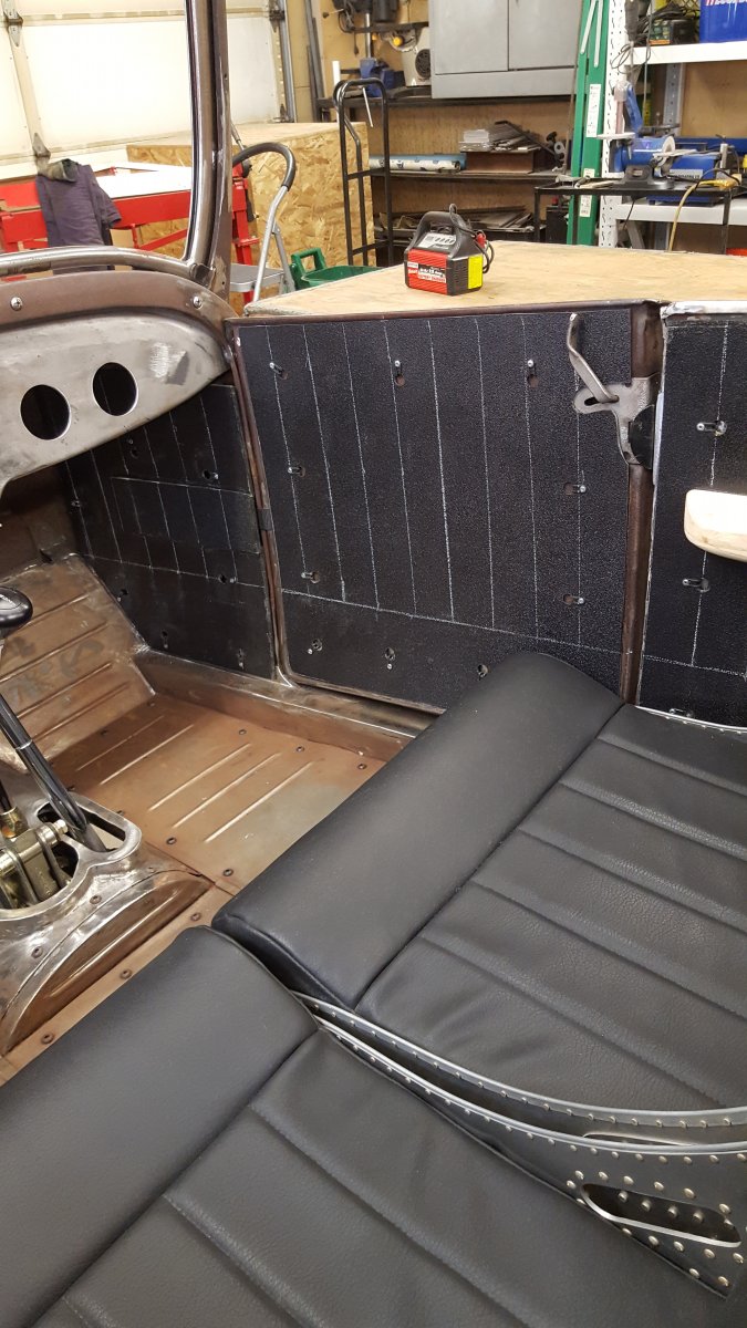

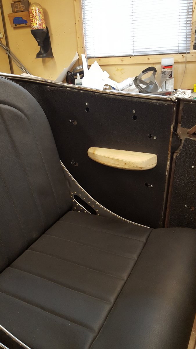

    Arm rests are done and installed on the side panels.
    I glued a second layer of ABS plastic to the back of the panels so that where the armrests attach is now 1/4" thick.
    Mounted them with fender washers and the 1/4" machine screws.
    They are going to work great,a comfortable place to rest my arm :cool:
    Larry.
