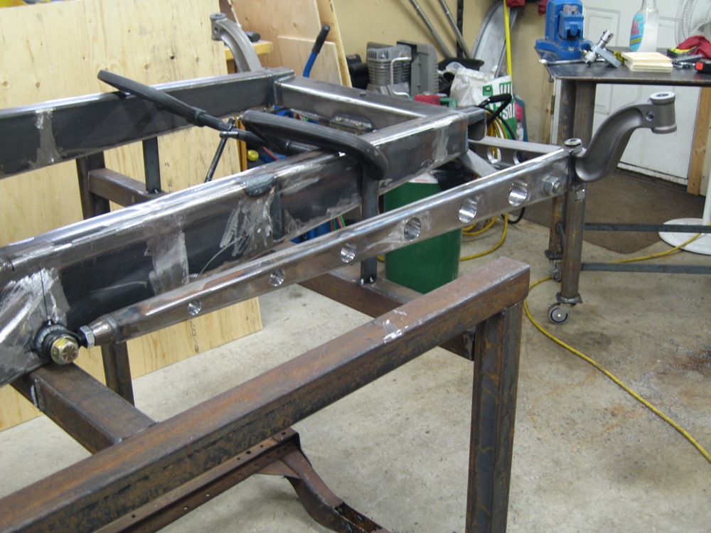

    Another update. I spent a pile more hours and got the bones fabbed to the point where they are pretty much done.
    In mocking up the front axle and spring I found that my spring perches were 31 1/2" apart, and what I really need for a 46 " axle is 32 1/4".
    I also decided to switch to a mono leaf after talking to the fellows down at the shop.
    It will be easier to set where the spring sits for ride height as you can move it up and down.
    Funny how when you search you can't find that kind of info (measurements for location of spring perches etc. ), I went down to the local rod shop and took a tape to an ***embled front end.
    To get the shackles right you need the spring perches to be the right width ,go figure :D
    So I needed to get the perches out to the proper width. The solution was to mill a 2" X 3" X 3/8" deep pocket into the inside of the bones for the perch. If you recall pictures above you will remember I have solid steel in there so no problem.
    I then used an ***ortment of exhaust tubing and conduit for the tubes and bored holes through the bones and welded in the tubing for a lightening hole look.
    It is unbelievable how many hours I have in these things,you are looking at somewhere around 50 hours of work (FUN) so far.
    So it goes when you fab from an idea in your head and totally from scratch :)

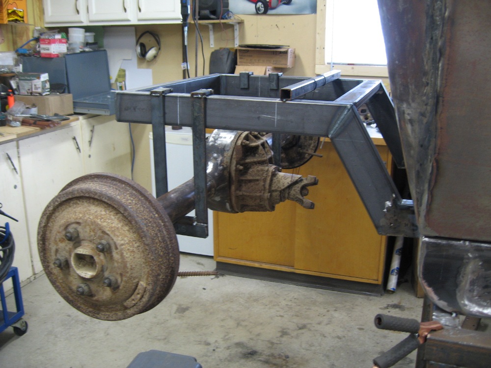

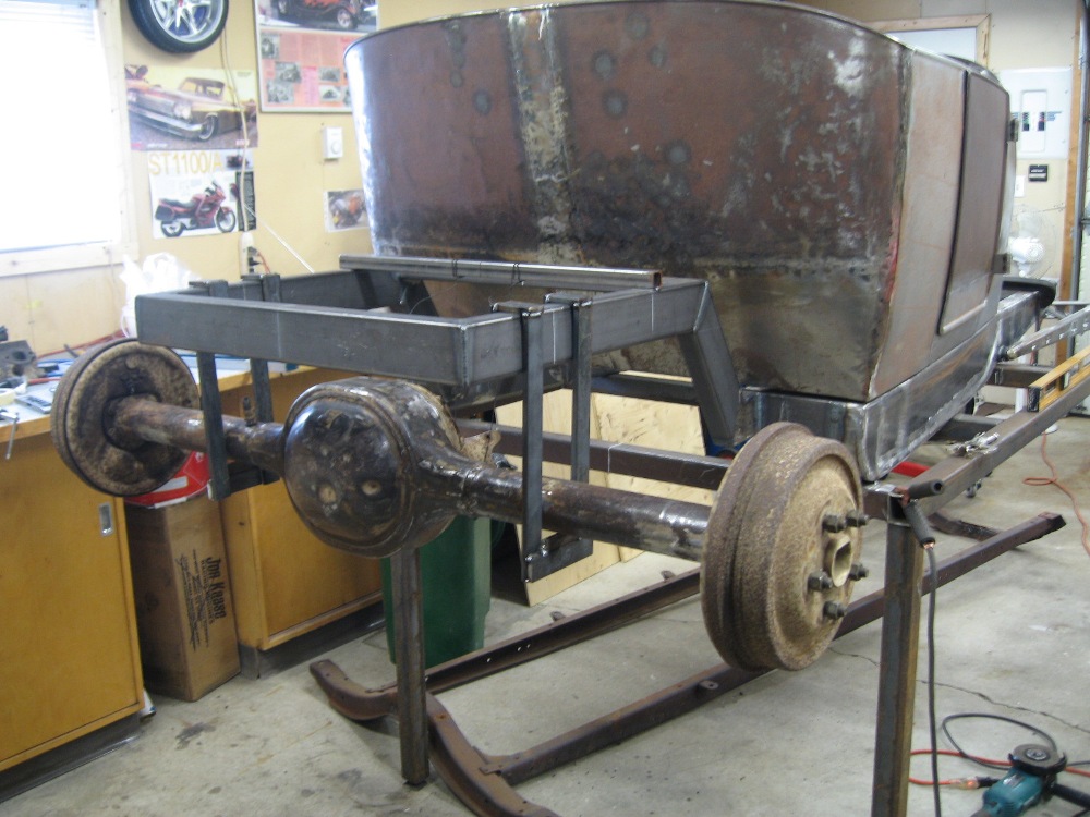

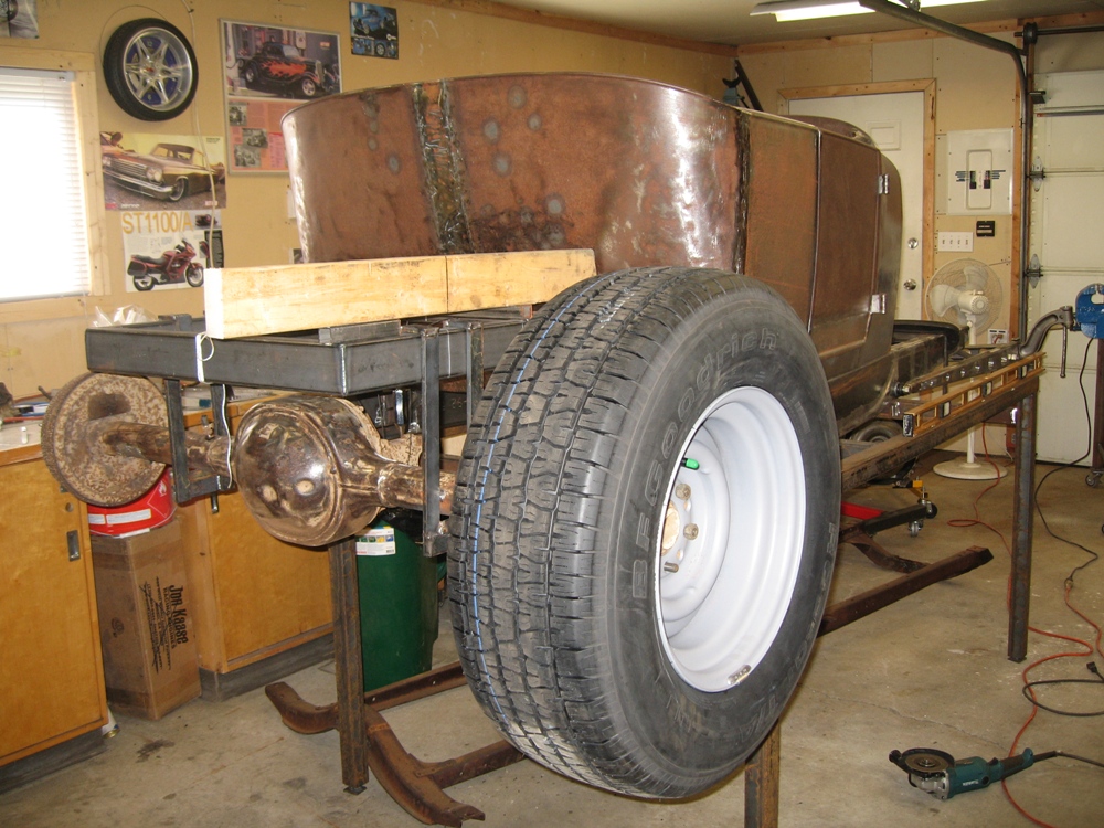

    Started setting up my rear end, going to fab wishbones similar to the front.
    I'm gonna fab everything, decided to go with TCI all american coil overs in favor of a decent ride.
    Will build a panhard bar and brackets and post pics as I go.
    A couple shots here of the initial setup, I built a coupe of "hangers" to locate the axle while I build everything else.
    Hank56 and volvobrynk like this.

    Couple more pics, threw a tire on, kinda hard to get any perspective shot in my small space but the 2x4 represents the length the pickup bed is going to be and the wheel will be centered in the length of the bed.
    Larry

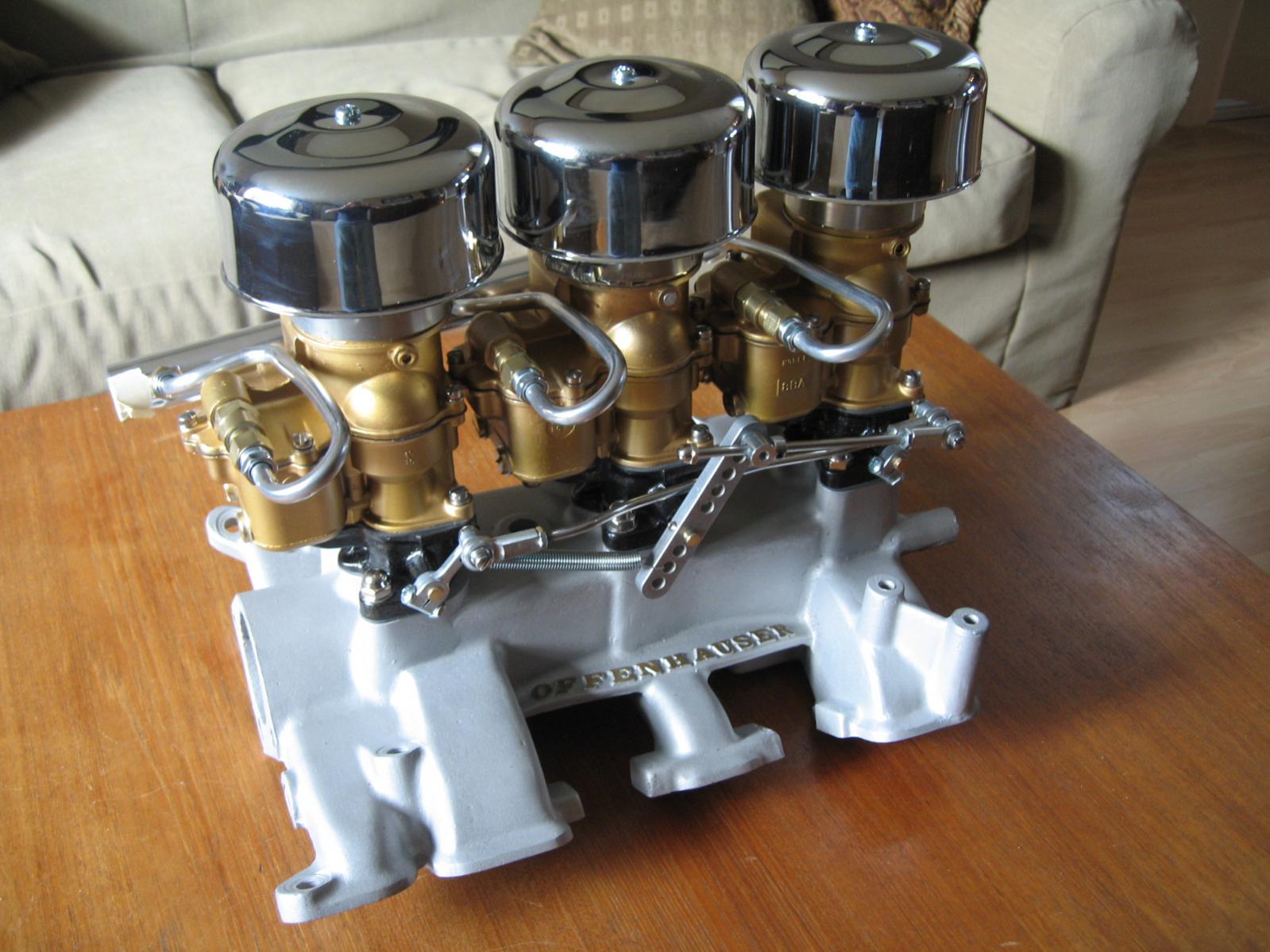

    And my Tri power for the 312 Y block fresh back from ****ster27 :)

    keep going, I like what I see.. might sit kinda high in the rear if the tires remain in the position shown. or does it slide up in your jig...

    I think the picture may be a little decieving. I am going by a fellow I know who has a similar roadster (Similar, not the same :))
    He has an 8" kick up as do I and he has 6" from the top of the axle to the bottom of the kick up which is what I have in my mockup.
    Gonna get it all together and sitting on the tires and then I may have to adjust from there.
    volvobrynk likes this.

    Went out to the garage and took another look at it. As far as I can see by measuring I'll have about a 3 1/2" rubber rake front to rear.

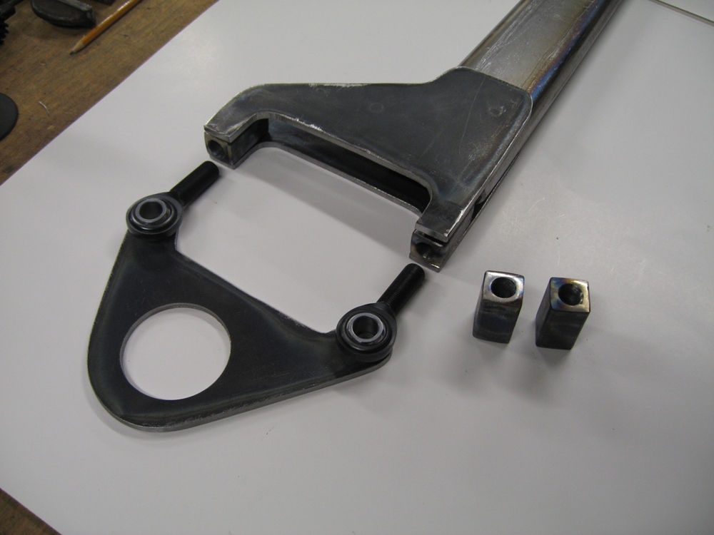

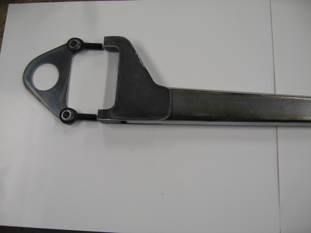

    Layed out the pieces for my rear wishbones and shot a few pics.
    Welded the shells of the bones together today and smoothed the welds with a belt sander (stationary sander with a 3 1/2" belt)
    The rear bones will be drilled with holes and have tubes welded through them to match the front bones.
    For the heim threaded bungs I cut DOM tubing pieces threaded them for the 5/8" heims and then squeezed them into short pieces of 1" X .063 thinwall tube.
    Welded the ends up and smoothed them out so they look like a chunk of square stock threaded.
    Thought they would look cleaner when welded into the wishbones plates.
    Heres some pics.

    the rear bones look great, what thickness plate did you use for the axle mount and the two rear sections that sandwich the threaded bungs of the bones

    I used 1/4" plate for both the axle mounts and the side plates of the bones.
    Flame cut them and then drilled the holes. Once that was done I bolted the axle mount plates together in a stack and clamped the side plates of the bones together into a stack as well.
    I finished the edges on the big 3 1/2" wide belt sander (we have a big industrial size belt sander at the college) while they were stacked together which made them all 100% identical and also makes them look laser cut.
    The bones themselves are made of shells of the same material and bent the same way as I did the fronts. The rear end of the bones where the side plates attach are capped with an end plate as well.
    As usual everything will be TIG welded.
    I'll post more pics as I progress along, the rear bones are also going to be drilled like the fronts.
