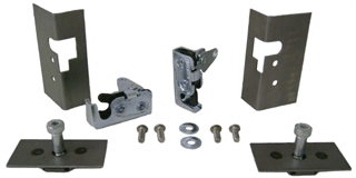

    Speaking of finding more things to do. :D
    I've been unhappy with trying to make the stock T style door latches work smoothly and efficiently.
    I have fought with and worked on them long enough.
    They are on their way out.
    I ordered this kit today.
    http://rockyhinge.com/store/product58.html
    A mini bear claw latch kit, looks like a nice kit.
    daddio211 and loudbang like this.

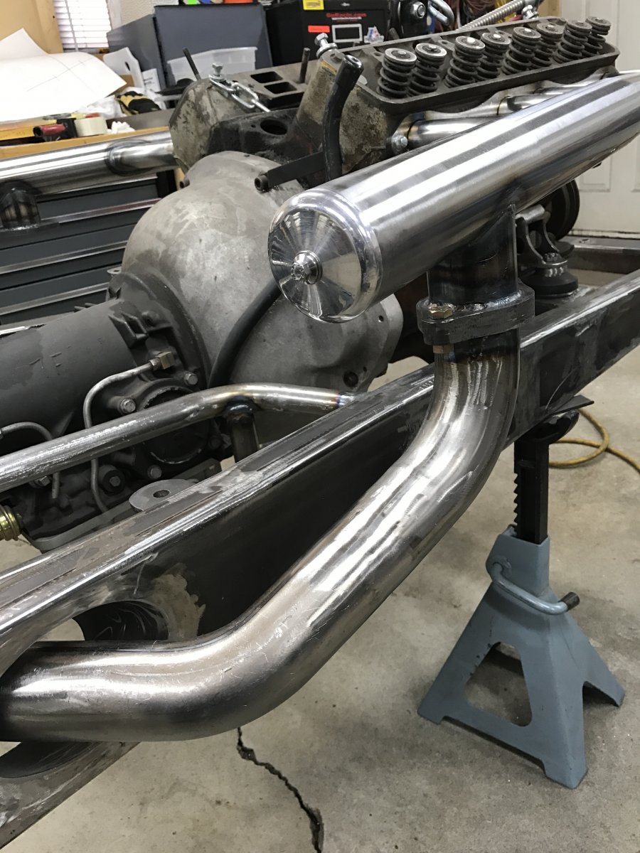

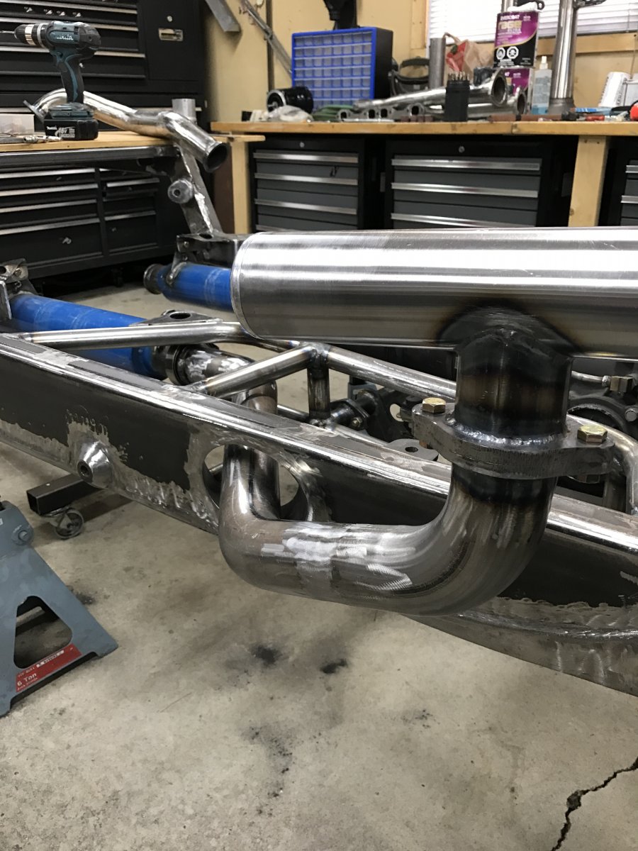

    I'm interested in your header caps. I am capping my pipes and like what you did. Did you weld a nut with 'wings' in the end of the pipe? Is the cap stepped to fit in the pipe and then clamped with the center bolt?
    Some construction pictures would be nice.
    Thanx,
    Bruce
  19. Blue One
    Joined: Feb 6, 2010
    Posts: 11,512
    Blue One
    from Alberta
    Hey Bruce here's a few shots.
    I'm going to have to polish the caps a little more but you can see how they're made.
    There is a step to fit into the pipe snugly.
    I cut out a piece of 3/8" plate to weld into the end of the pipe with a thin outer band just thick enough to weld.
    As you can see there is a 3/8" threaded hole in the middle.
    I picked up some nice ARP stainless bolts to hold the caps.
    Larry

    Those are nice. I really like the form of the caps. Didn't think of using a thick plate for the tapped hole. Thanks for the pictures.
    I really don't like the bolt on caps with the outside flange , especially with turn outs. Looks like an afterthought.

    Just a thought, Model T door openings aren't very wide (19 1/2'). Bear Claw latch pins stick out ready to grab your belt loops, pockets, etc.
