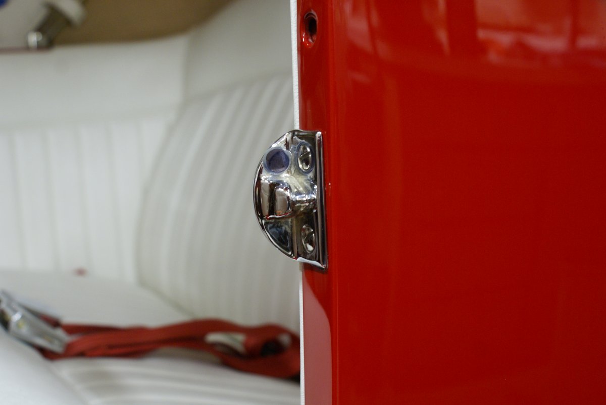

    I thought of that, but with the stock hook type latch also sticks out a little.
    Climbing into the small door isn't easy at the best of times.
    I'm going to look at just how much the bear claw pins will stick out when the latches come.
    I think that with the latches being quite small the pins will not be as big an issue , but we will see.
    I don't know why I have had such a hard time with the stock style latches, they are in great condition and work smoothly, getting them to line up and latch smoothly and consistently without slamming the **** out of them or pushing excessively hard on the door has been driving me nuts.
    The door is either too loose and when latched will rattle excessively even with pads or so tight that they won't stay closed or can't be closed without a real hard push.
    As you can tell I'm frustrated with them :(
    Maybe I would be better advised to order brand new T open car latches and door latch strikers from Macs :confused:
    Do you know what kind of quality they are made to ?
    I got new door hinges from them and they were nice.
    Larry

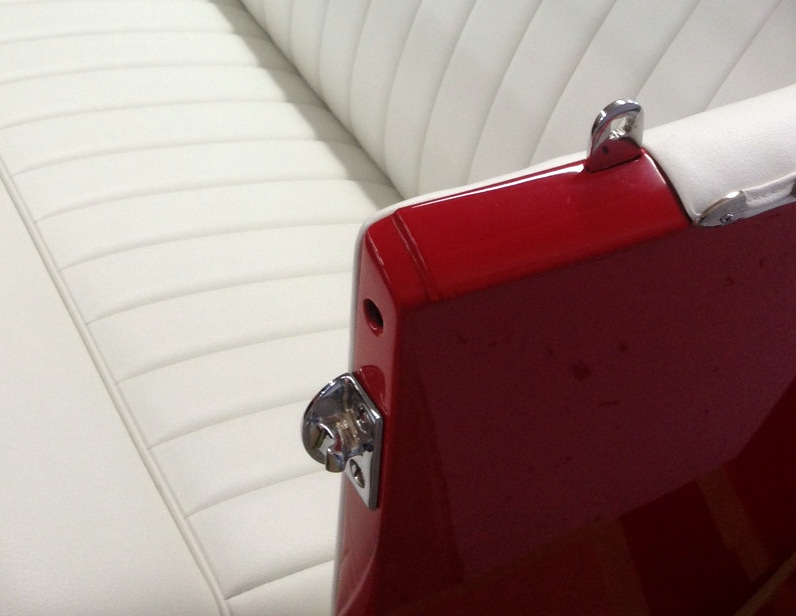

    DSC09633.JPG I use a hardware store bumper on my striker plate. I haven't found a quality rubber bumper yet. I have to replace these every month or so but they compress and keep the door from rattling. They're peel and stick so all I do is clean with alcohol and stick a new one on. I carry a card of them under my seat.
    They work well to keep the door gap good without touching the body.
    They're clear but to get a good pic I colored them with ink.

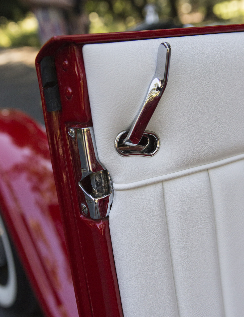

    I found a couple of old pics. The latches and strikers are original. I soaked them in kerosene and "worked" and oiled them over and over.
    After chrome I almost had to start over but got them to work pretty well. 10 (2).JPG Sid-005 (2).JPG

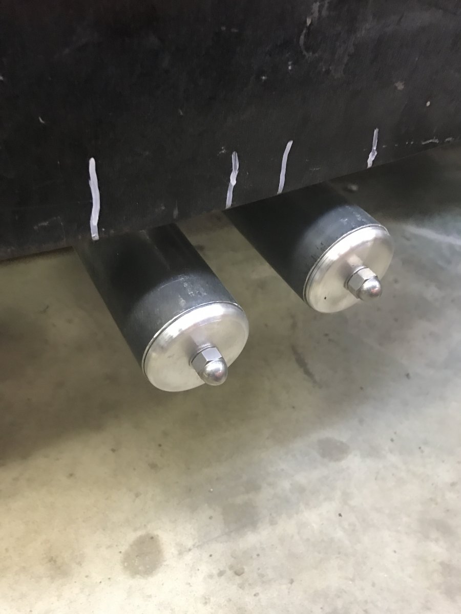

    Here is my first attempt at the lakes plugs. I had two discs of aluminum that were just a little under size on the O.D. I decided to shape them up a little and see how they looked. I have a couple of other slugs that I can make a little more shapely, but wanted to see the general look, first.
  16. Blue One
    Joined: Feb 6, 2010
    Posts: 11,512
    Blue One
    from Alberta
    They look good to me.
    I'm not sure on the acorn nuts though, for my tastes I like the stainless ARP bolts look better.
    I liked the idea and stole (borrowed) it from NathanxStewart in his Y block powered model A build.

    Since these are only 2 1/4" pipes the 9/16" acorn nuts seem a little out of scale to me. Traditionally, maybe wing nuts? But that is so far down my list of things to do, they may may never get changed.
    I'm thinking that the silver ceramic might be the way to go for me also.

    Aluminum will work better as exhaust plug/caps because it ( aluminum ) has a higher coefficient of thermal expansion than stainless steel.
    That means that when hot the aluminum caps will expand and seal tightly for no leaks.
    The stainless would not expand and seal as snugly and you could be left with a leak(s).

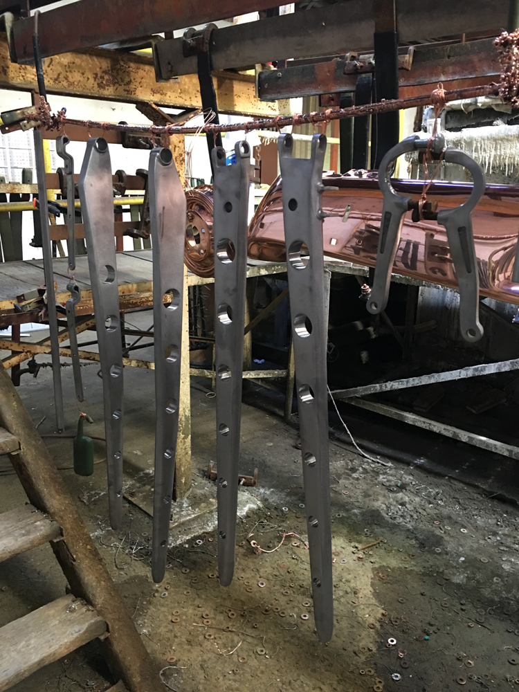

    Jose at Ogden Chrome sent me some pictures of some of my parts that are on their way to the copper tank for their first copper bath.
    Exciting stuff.
    They did a very nice job on preparing the parts for this first step in the show chrome process.
    This is going to be great.
    As a side note, there are also some parts on the rack next to mine for Kindig-it-design.
    Stand by for some more news as available :cool:
    Larry

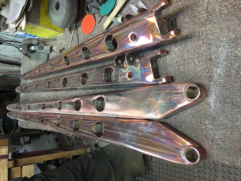

    Another little update. A couple more pictures of some of my parts from Jose at Ogden Chrome.
    He sent me a bunch more pictures, the updates are great.
    The first trip into the copper tank and then some fixes of defects around welds or other locations using lead and then more smoothing and blending and more copper....
    They are doing a great job and my parts are looking very nice.
    These guys really know what they are doing.
    When they are done they will be beautiful :cool:
    I also received my new door latches and strikers from Snyder's, very nice parts that will fix my door issues.
    Larry :cool:
