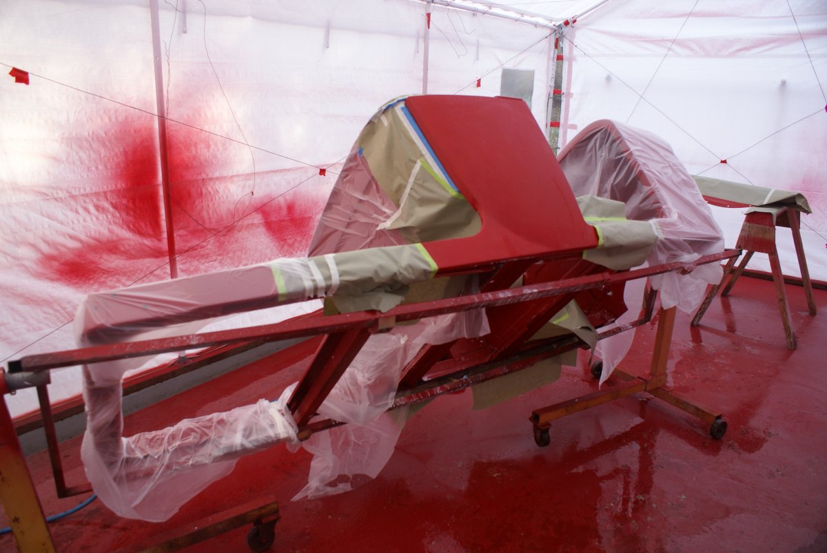

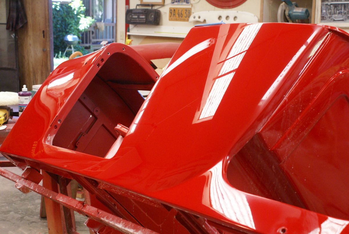

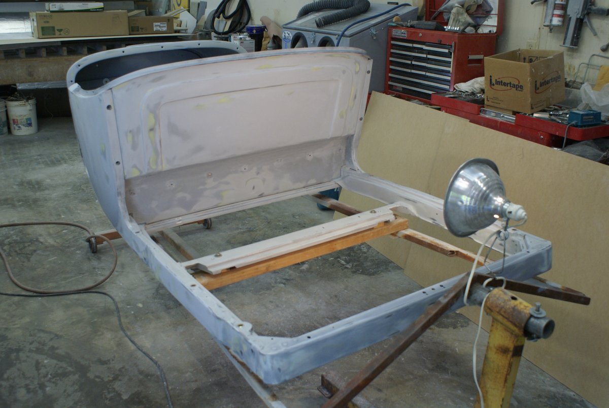

    I noticed you built a rotisserie for your frame. I recommend you build one for your body.
    It will make every step of your body and paint work so much easier.
    I used 1" square tubing under the original body bolt holes. By making a cradle shape I could rotate the body in a full circle, getting access to every inch, top to bottom. It measures about 10" from the pivot point to the top of the rails. DSC01520.JPG DSC06017.JPG DSC06070.JPG

    Thanks , I will be doing so. I had actually considered it after seeing how much easier it made working on the frame.
    I'll mock it up with multiple mounting points so I can use it first for the body and then the bed.
    It will also help with painting to be able to rotate it for visibility etc.
