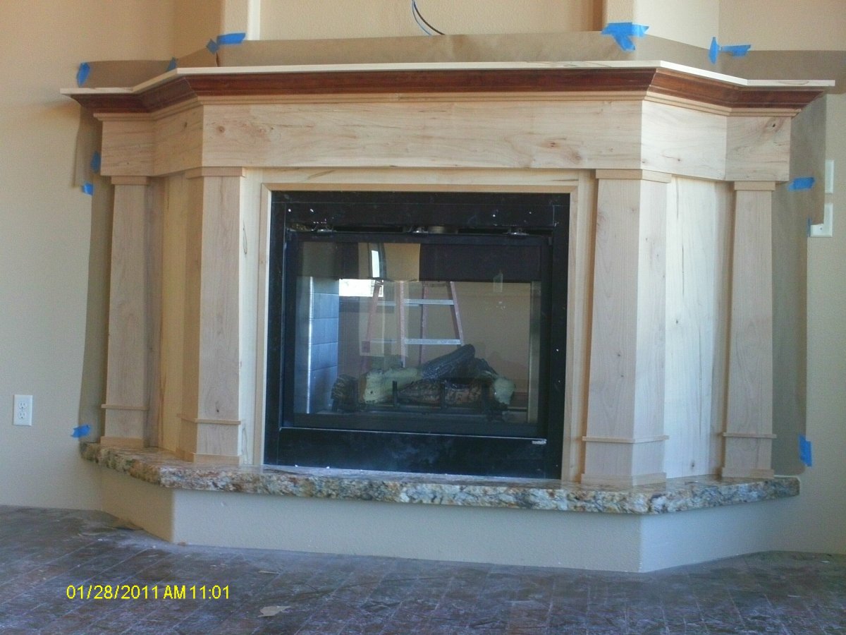

    Oh thats not finish carpentry thats rough framing. IMAG0031.JPG This is finish carpentry!

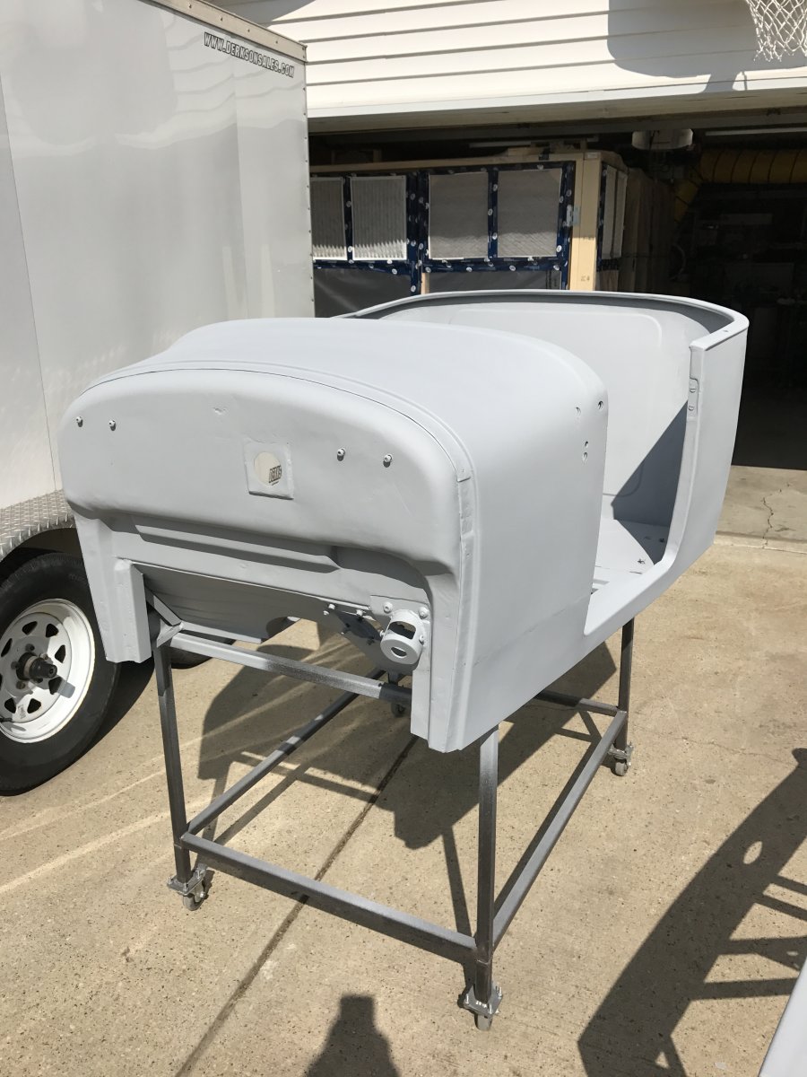

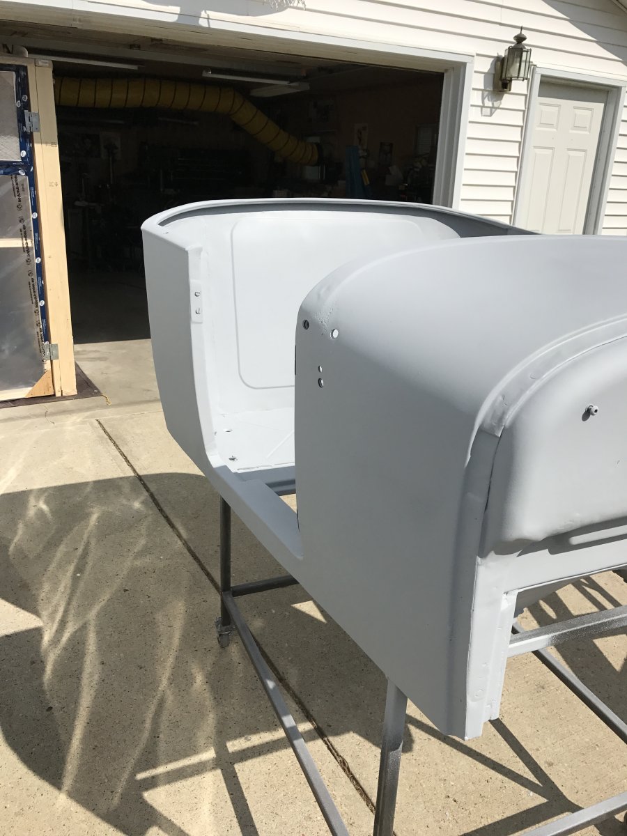

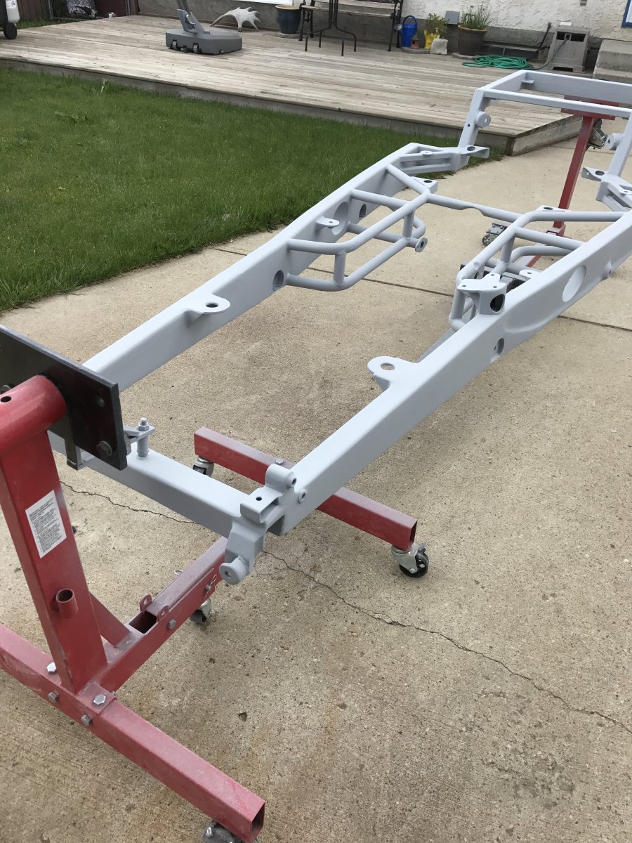

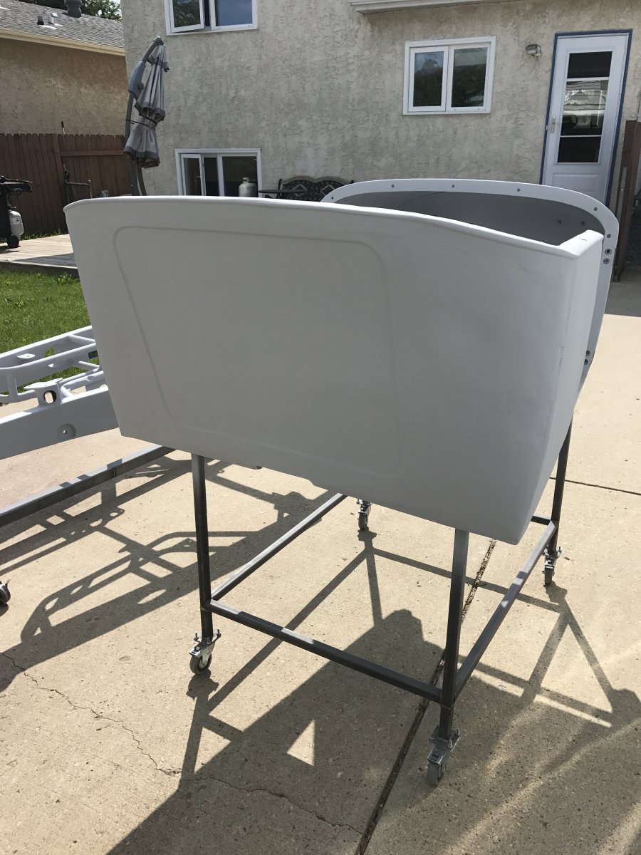

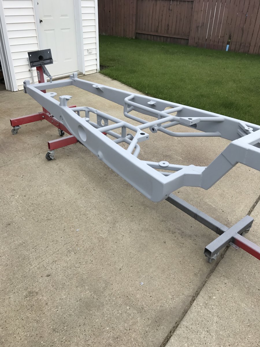

    Well we have some epoxy primer shot :cool:
    Got the frame and body done today and I'm going to try getting the pickup bed and all the other ***orted parts primed day by day as long as it takes now. (Having the whole summer for vacation sure helps ;))
    Have to drop by the body shop supply for a few things tomorrow.
    The paint booth works really well :cool:
    IMG_0939.JPG IMG_0940.JPG IMG_0941.JPG IMG_0942.JPG IMG_0943.JPG IMG_0938.JPG
    brad2v, AndersF, t-rod and 5 others like this.

    Thanks once I get everything primed there will be a bunch of filling and blocking to do on the body. Then probably more primer before paint.
    The frame will probably just get a light sanding before color.
