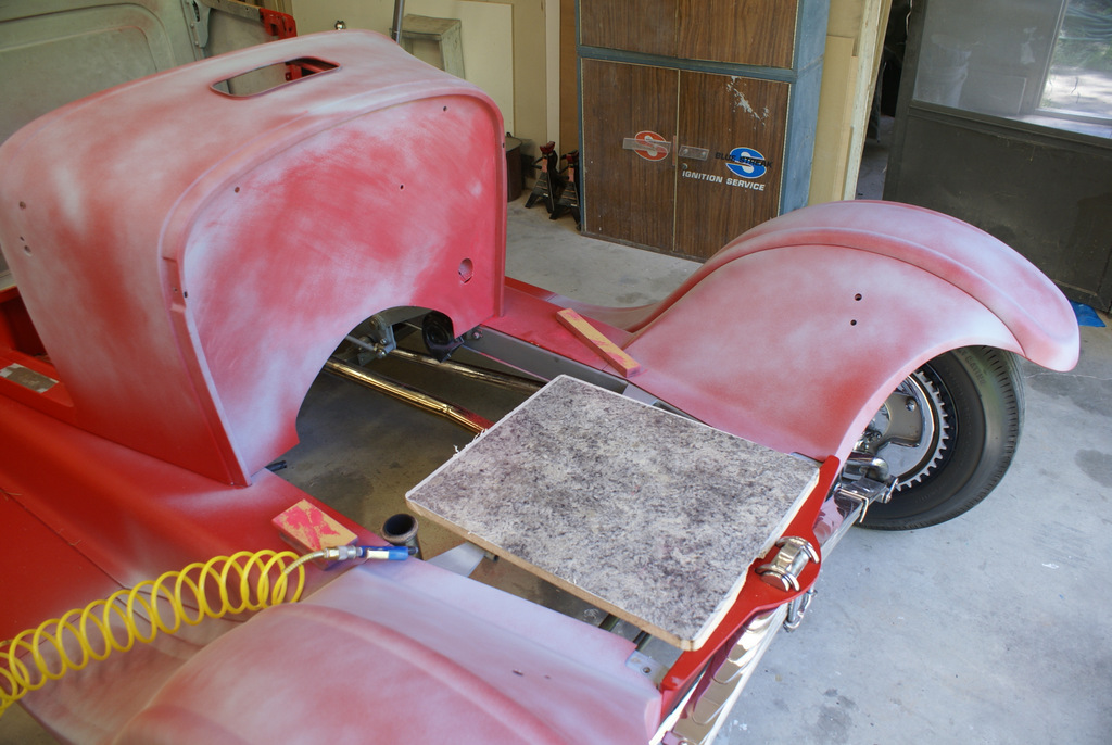

  23. Blue One
    Joined: Feb 6, 2010
    Posts: 11,512
    Blue One
    from Alberta
    I'm doing so believe me one is coming over early this week to bring me some high build primer /filler that will help.
    I dusted one side of the body today with black laquer as a guide coat and blocked it smooth and flat.
    I have to say it's encouraging as it seems to be getting very nice. :cool:
    Lots of sweat :D
    brad2v, loudbang and whiplash1923T like this.

    Well, a big thanks to K13 :cool:
    He came over to take a look and brought me some high build primer/surfacer.
    I finished blocking the body and doors so they are ready for a couple coats of high build and then a final blocking :cool:
    Color will come when we get a few cooler days in fact the high build primer may have to wait for that too :D
    In the meantime I can work on the minimal prep that the pickup bed needs.
    Always something to do :D
    Larry
