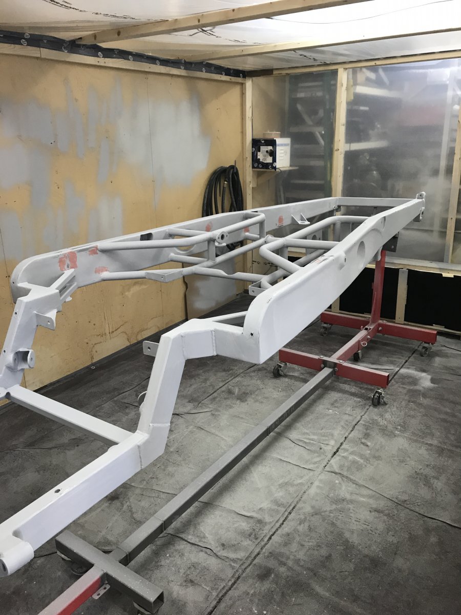

    In the booth cleaned up and waiting for color...........:cool:
  4. Blake 27
    Joined: Apr 10, 2016
    Posts: 1,553
    Blake 27
    Blue, Your frame is looking really good!
    In your photo it appears you applied filler or glaze on the inside of the frame rail.
    You should re prime before color to prevent bleed through.

  5. paul55
    Joined: Dec 1, 2010
    Posts: 3,491
    paul55
    from michigan
    definitely spot prime those areas!
    loudbang and Blue One like this.

    Done, so now a tiny bit more sanding to smooth it out and I'm ready for color ;):cool:

    During a break in the rain I was able to roll the ch***is out and sand it.
    Cleaned it again and back in the booth.
    We are now waiting for a little warmer and drier-less humid day.....:D

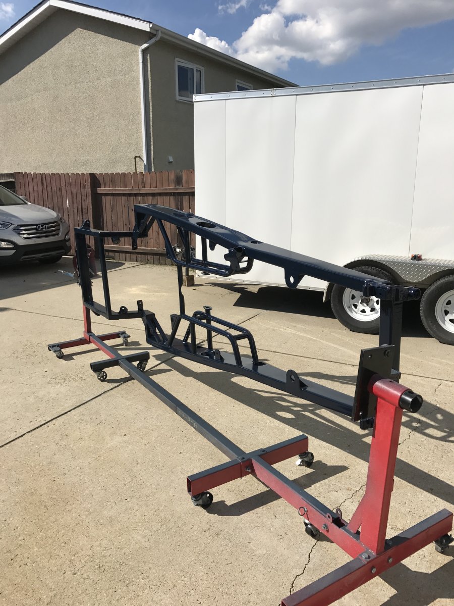

    We have color :cool:
    Washington blue basking in the sun :)

    Looks...... black?:confused: Or is that a VERY dark blue?
    t-rod and loudbang like this.

    Washington blue can do that.
    Yes it's a dark blue but definitely blue.
    The blue may show better here.
    Standing in front of it you can see the true color, a nice deep blue.

    There we go. And now.........the happy dance.

    Thanks I'm pleased with it.
    The Uno sprayed nice. I put 3 coats on it.
    It has a nice shine as sprayed.
    If I want to later on I can wet sand and polish it.
