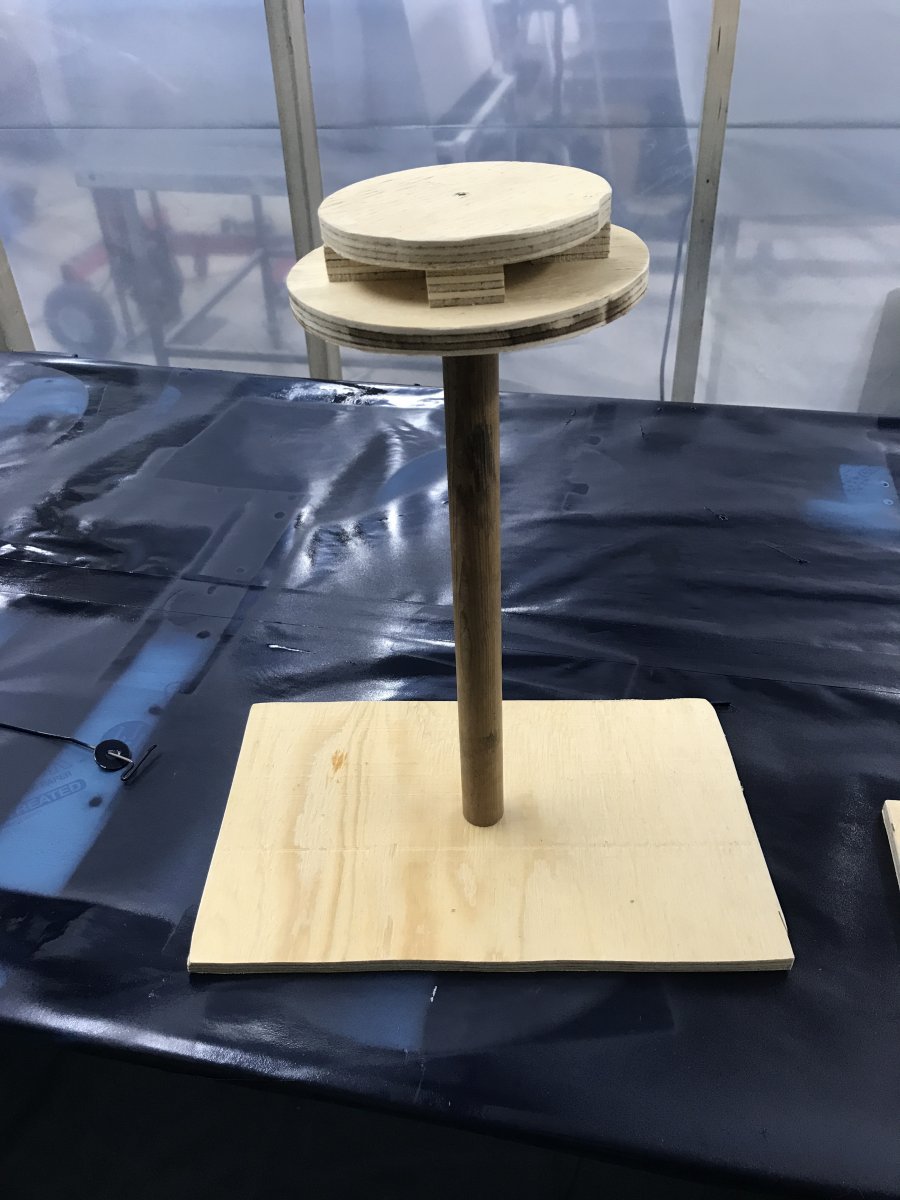

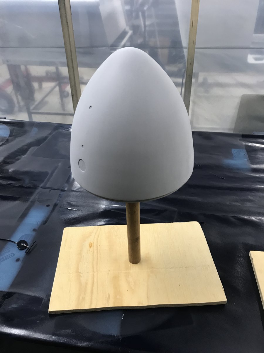

    Made a couple of stands to paint the headlight buckets :cool:
    Have to do the same thing for the tailights.
    brEad, brad2v, whiplash1923T and 5 others like this.

  15. Cones are hard to paint.
    The tip gets more paint per square inch than the rest. Sanding sags out is good practice.

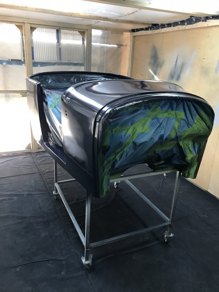

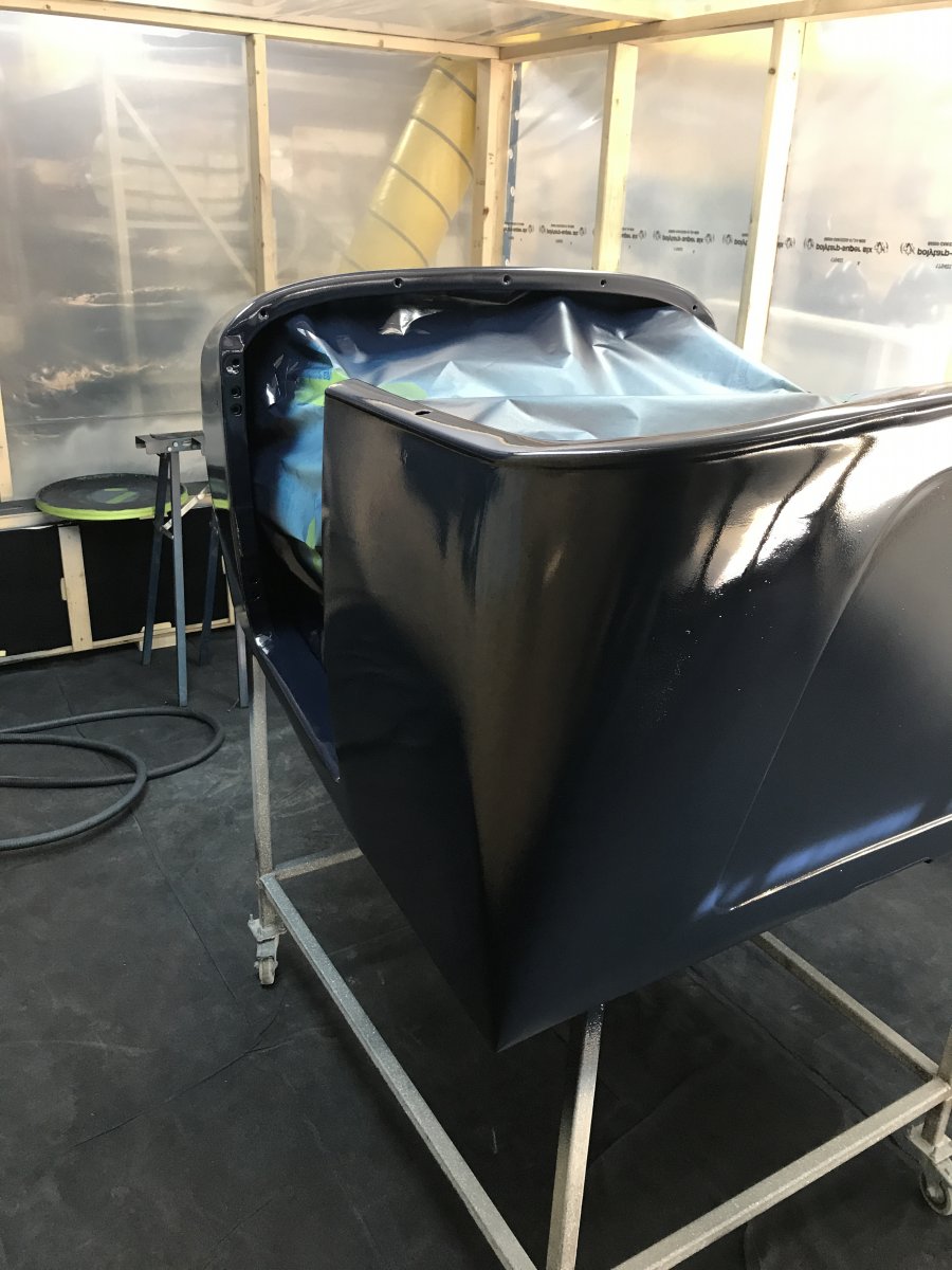

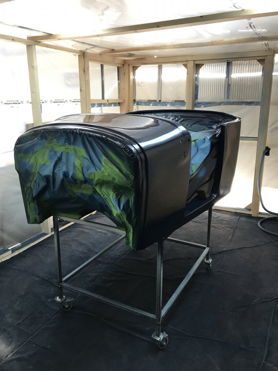

    Well, I painted the outside of the body.
    Turned out pretty nice although there are a few spots ( dust nibs) that I will have to address with color sanding and buffing (if I'm brave enough to tackle it :D)
    I'll be afraid of breaking through the paint :eek:
    Despite my booth cleaning and cleaning everything before spraying I still have a few dust nibs etc. :eek:
    Damb I thought, where do I have to spray :confused:
    In a surgical suite at the hospital :D ?
    All in all I'm pretty happy with it.
    It's really straight so all those tedious hours sanding etc have paid off :D
    I'm thinking it's going to look real nice once it cures and I can roll it out and unmask the firewall and everything :cool:
    Next comes the PU bed.
    Larry
    eddie1, OFT, brad2v and 6 others like this.

    Don't be afraid of the sanding and polishing, it's not as bad as it sounds, however looks killer even if you decide to leave it as is!
    loudbang, whiplash1923T and Blue One like this.

  30. Did you clean you?
    Most dust comes from the subject or the painter.
    You could sand the whole thing flat with 600 and do a flow coat. It will lay out like gl***. It's a whole lot less work than cut and buff too.
