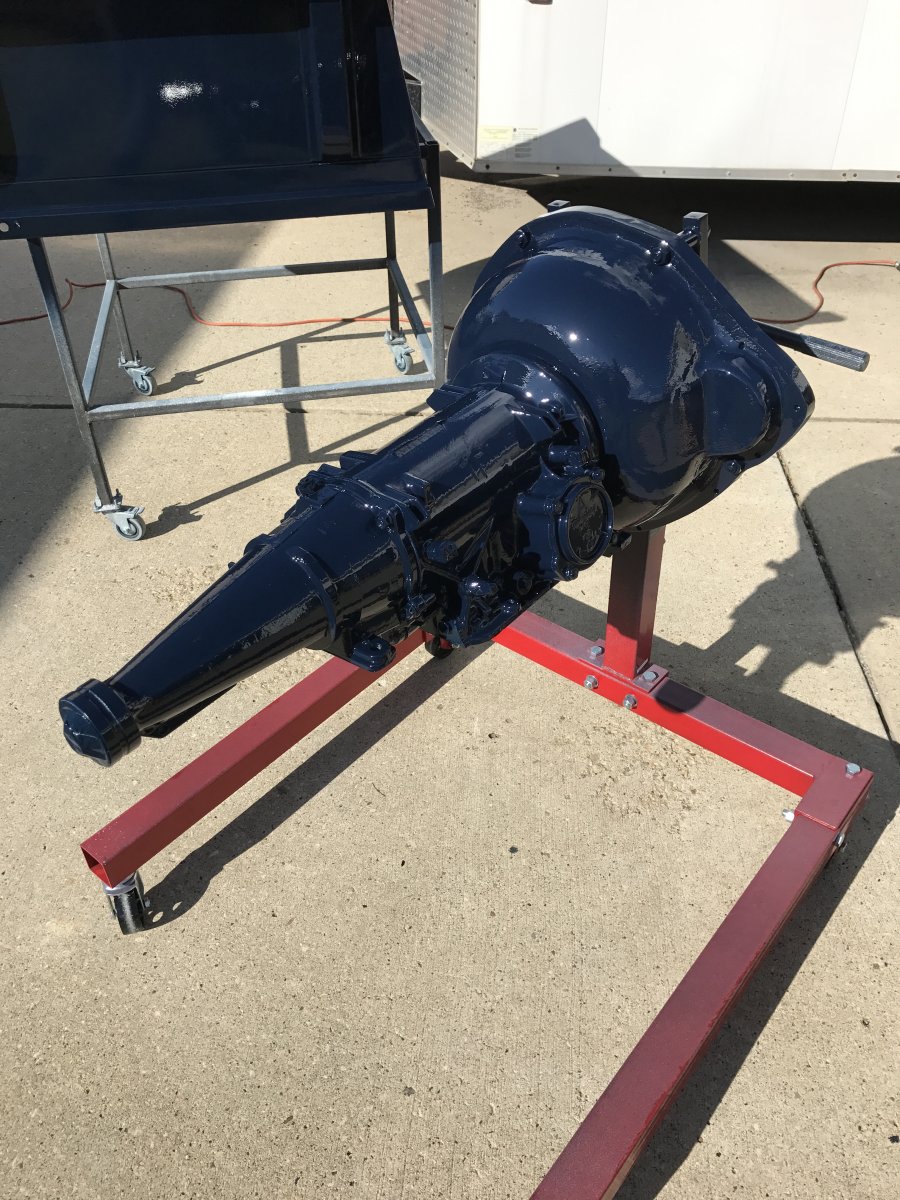

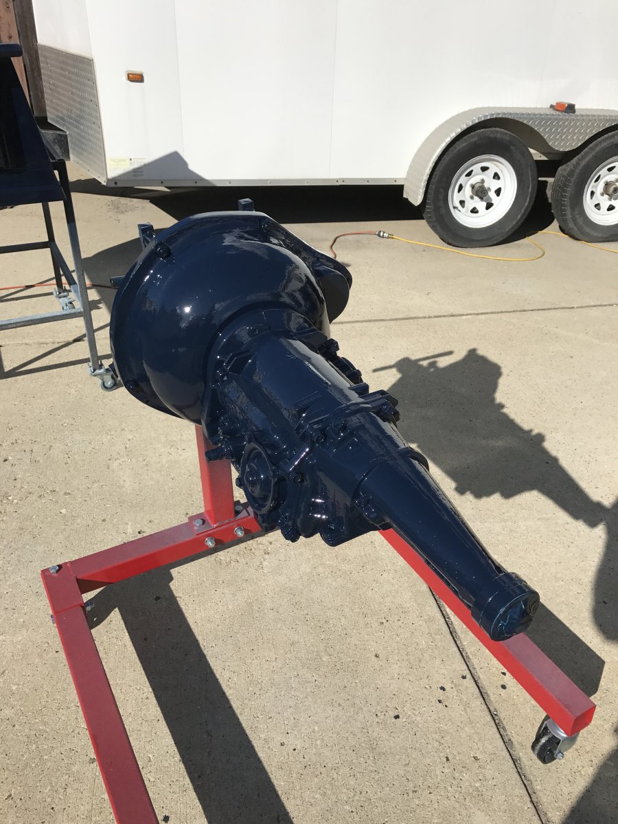

    The transmission has it's paint so now I'm prepping the engine for it's painting.
    We're coming to an end with the painting, a few more parts left over will visit the powder coating shop.

    That is a one long transmission and the blue is laying down real nice Blue...;) that near guarantees a shortened driveshaft...Good job your doing there.
  4. Blue One
    Joined: Feb 6, 2010
    Posts: 11,512
    Blue One
    from Alberta
    It's a C4 from a 73 Maverick. I'm not sure if they made a shorter C4.
    The bell housing is from Flat O to fit the Y Block.
    The driveshaft is short but not extremely short.
    I'm really liking the Uno acrylic urethane.
    It's nice paint.

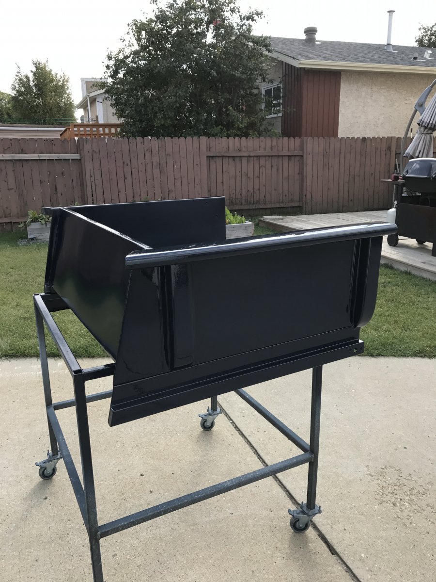

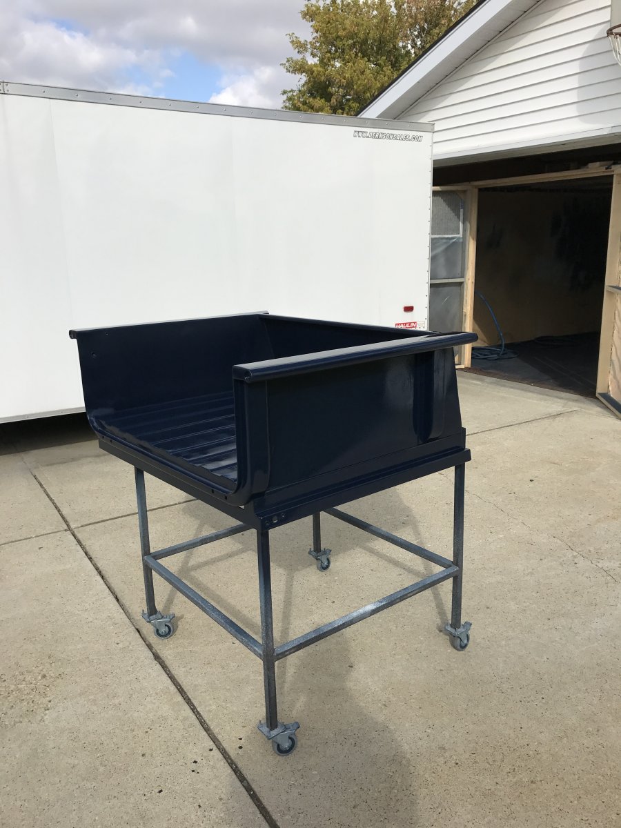

    I was looking everything over and deciding if I was happy with it all before I dismantle the paint booth.
    I had a few things with the pickup bed that I felt I should probably fix so I sanded them out and scuffed the rest.
    Cleaned it all and in the booth for a couple of coats.
    I'm happy with the results so I'll probably take the paint booth apart tomorrow.
    I've got a bunch of ***orted small parts to take to the powder coating shop.

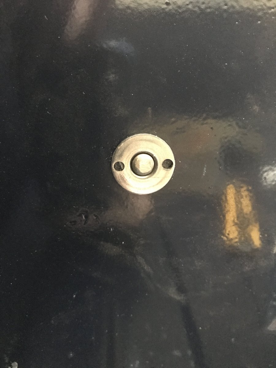

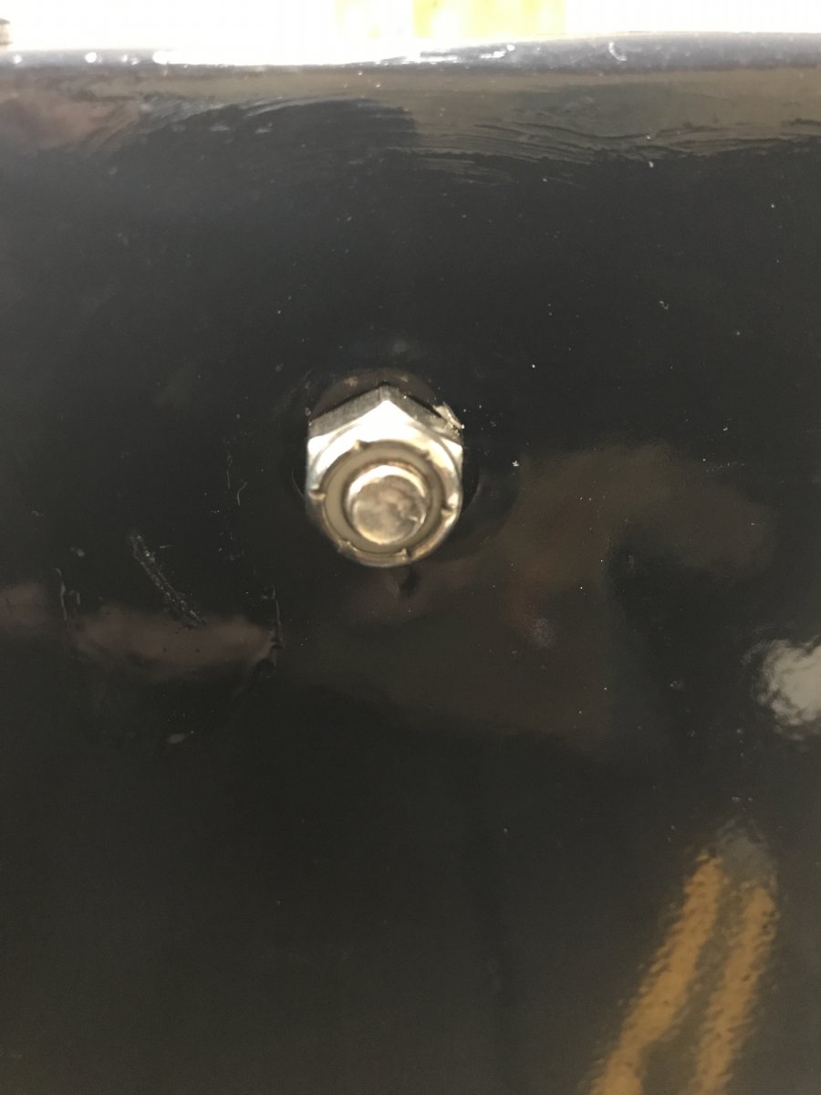

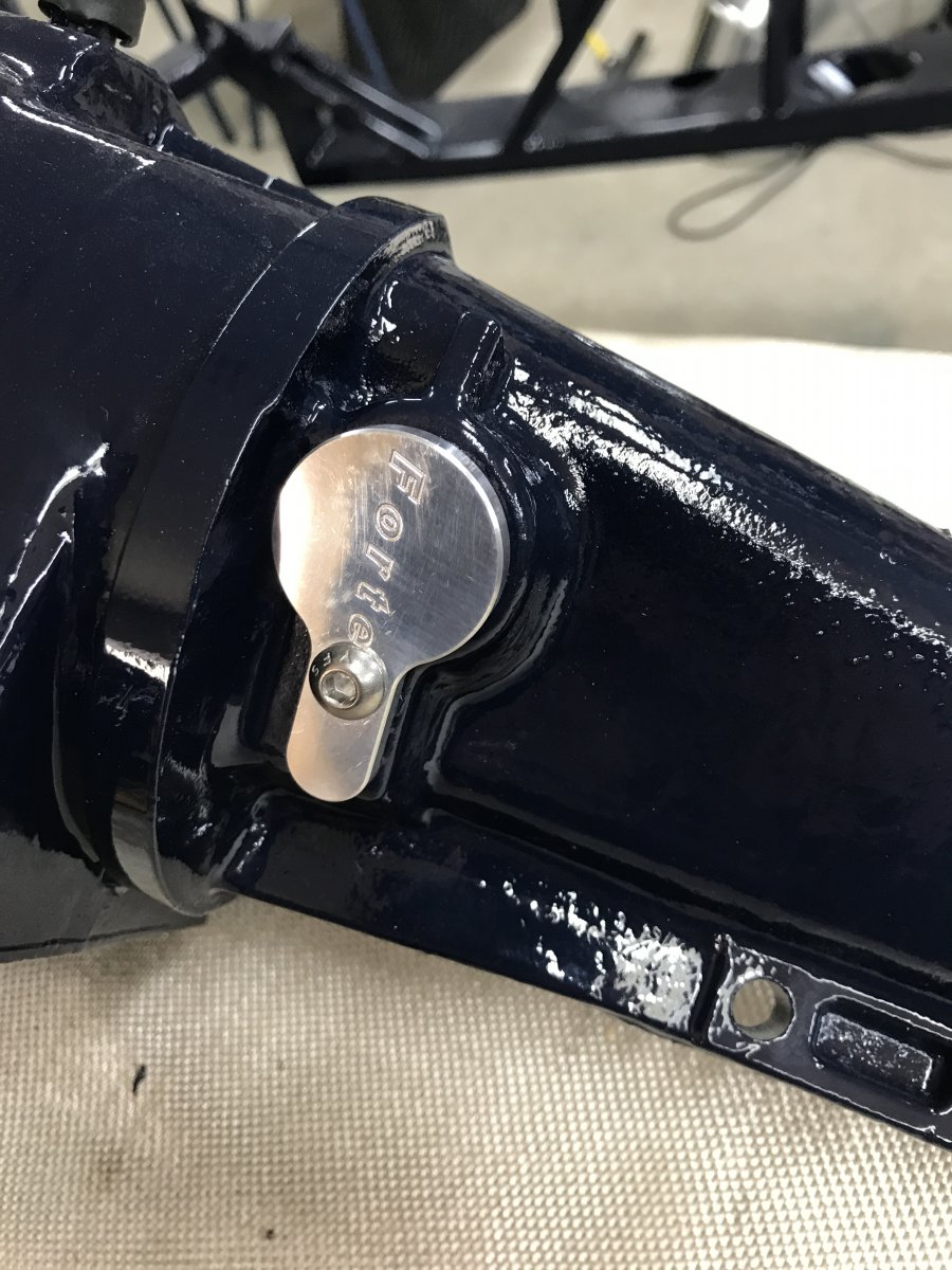

    My pickup bed tailgate was held on with bolts through the single layer that's forms the tailgate and the nuts protruding on the inside were really getting to me.
    So I did a little searching and came up with the solution.
    Stainless steel T nuts - 5/16" x 18 x 3/8" .
    They do the job very nicely as their profile is flat and less than 1/8" thick.
    I actually made a homemade wrench with a couple of studs similar to a grinder disc wrench
    To hold them for tightening.
    Then I remembered that since I'm not using the speedometer drive hole in the transmission that I should probably put the plug in :cool:

    That's ATD. Attention To Detail.;) Your solution for that nut is very clever. And that plug looks nice!
