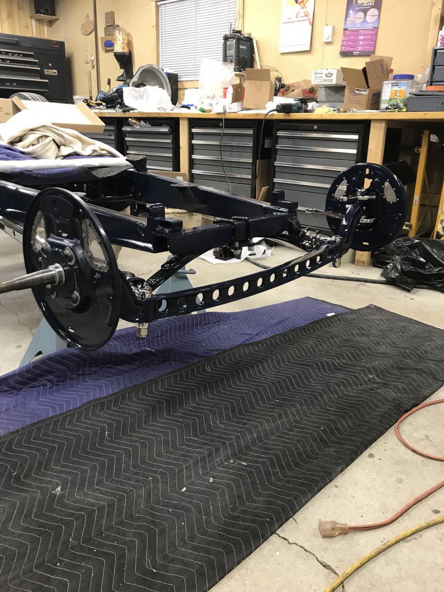

    Spent a little time ***embling the Lincoln brakes.
    Getting closer to having it sitting on all 4 wheels again :cool:

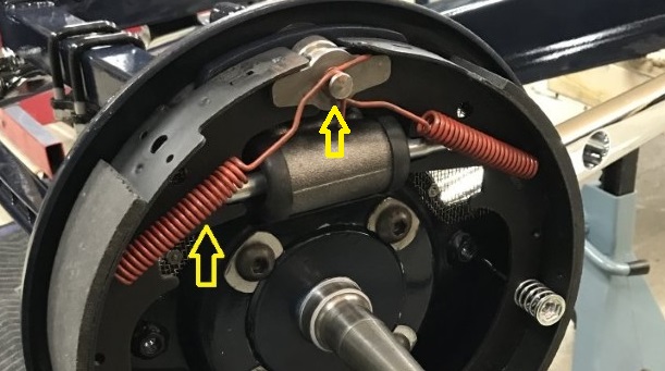

  10. RICH B
    Joined: Feb 7, 2007
    Posts: 5,965
    RICH B
    The primary spring is supposed to go on first...just sayin;)
    I bet it sure feels good each step taking you closer toward getting your roadster on the road. Probably hard to quit for the day; I always wanted to do just one thing, sure worked late some times on final ***embly.

  11. Blue One
    Joined: Feb 6, 2010
    Posts: 11,512
    Blue One
    from Alberta
    :D Does it really make a big difference which spring is where?
    If so I can easily change them :)
    It certainly does feel good to be putting it together. :cool:

  13. atch
    Joined: Sep 3, 2002
    Posts: 6,412
    atch
    Interesting. I had never heard that either. Could you please shed some light as to the reasoning behind that?
    note: I will never remember which spring goes on first, but if I knew the logic of the sequence I might remember.

  14. RICH B
    Joined: Feb 7, 2007
    Posts: 5,965
    RICH B
    Blue, I was just pullin' your chain a little.:) Don't know if there is any good reason to change them. I would if they were mine; just because I would always know they were out of order.
    I don't know if I have ever heard the reason behind the spring order either. Around 50 years ago, the mechanic down at the station was schooling me on brake jobs and told me: on Bendix brakes the primary spring goes first according to the manual. I have also found the same information in the OEM car manuals from the '50's, again no mention of why. I have always installed them that way; but have found them mis-installed in many cases when I have done brake jobs or harvested brake ***emblies.
    Blue One likes this.
  15. porkshop
    Joined: Jan 22, 2004
    Posts: 1,909
    porkshop
    from Clovis Ca
    The brake spring thing comes from the brakes with automatic adjusters it provides clearance for the cable that goes from anchor around guide to the adjuster foot.

  18. Blue One
    Joined: Feb 6, 2010
    Posts: 11,512
    Blue One
    from Alberta
    I went ahead and changed the location of the primary brake springs. :D
    I’m inching along with a little bit of progress at a time.
    Sitting on the tires now :cool:
