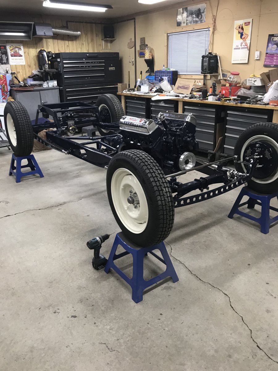

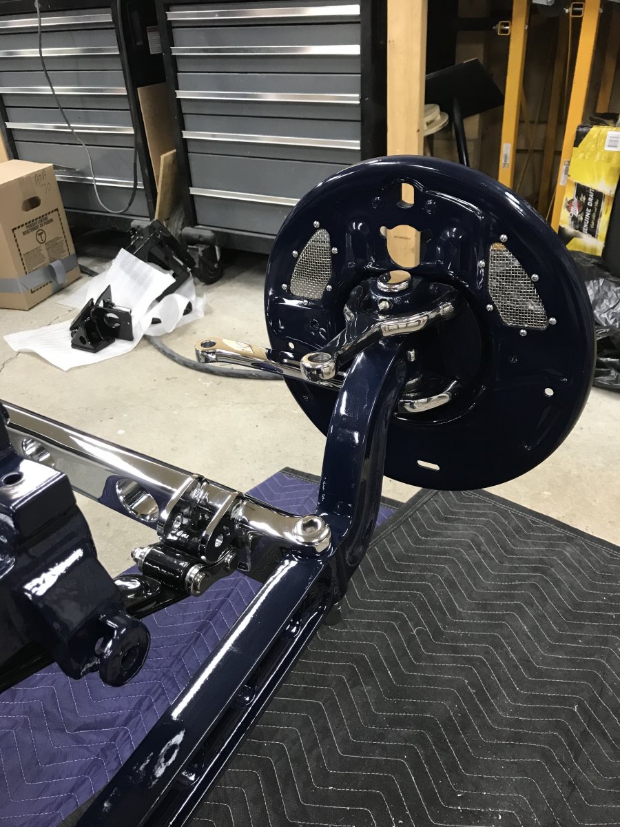

    Yeah, BUT... what kinda grip you rockin'? Mob? Jessup? Grizzly? If you're running Mob you might be shredding the treads of your nice, new tires... Sorry, I can't help myself. I doubt anyone else will understand on this forum.
    Your ch***is looks great by the way. I like the vented brakes a lot. Keep pluggin' away!

    :D You know Tim I don’t even know what it is :D I didn’t ask, I went to the skateboard shop and asked them for 4’ of grip tape and what I got looks like black. 80 - 100 grit or so sandpaper.
    (My son would probably know what it is)
    As for shredding the tires well I’m thinking that I’ll be okay there as all the grip tape helps with is keeping it on the stands when I pull on a wrench :D

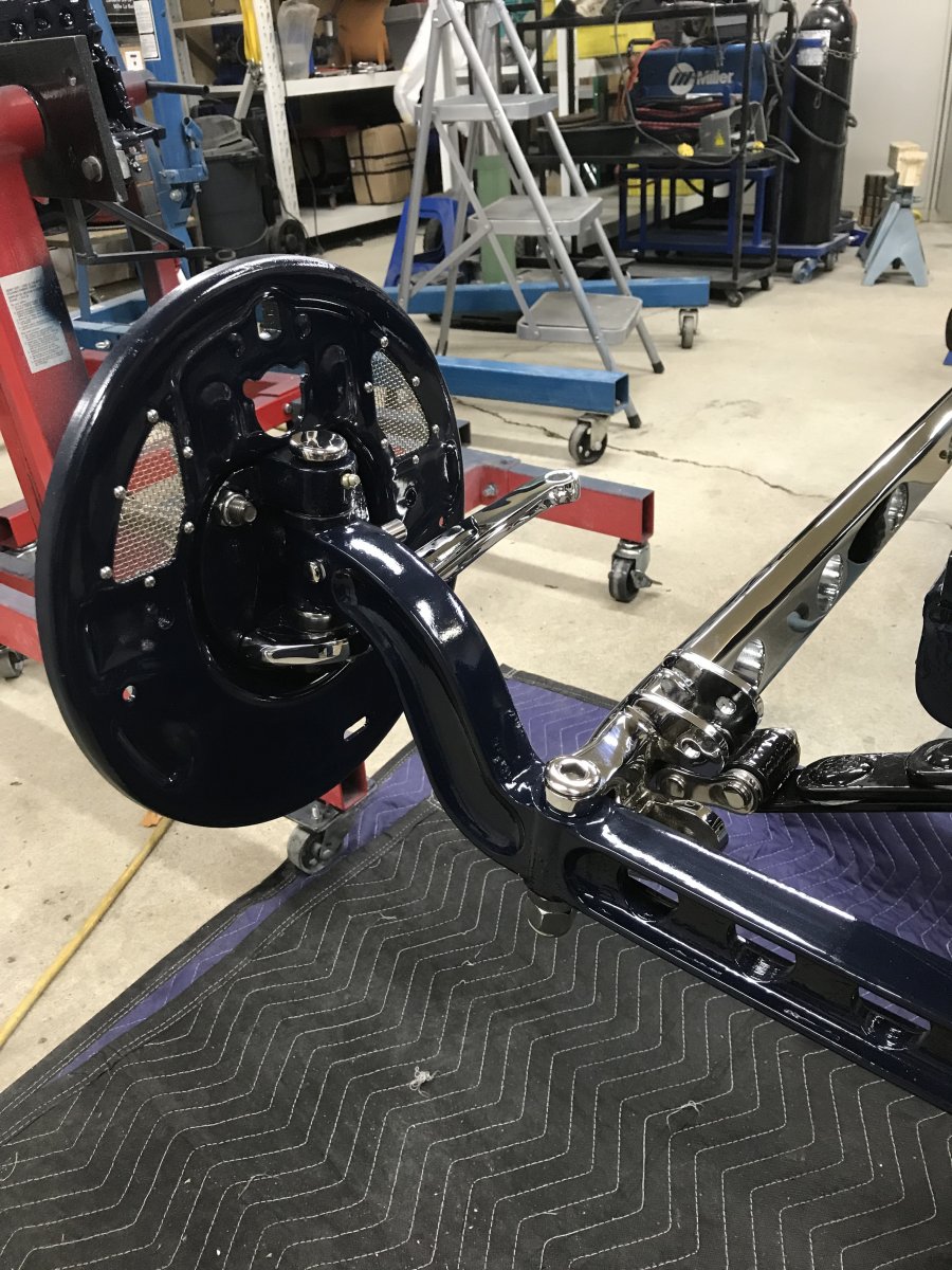

    If you’re referring to the wire mesh in the brake vents, it was supplied by MT Car Products with the vented backing plate option on the Lincoln brake kit I bought.
    They supplied the stainless mesh and it’s formed to fit the holes nicely.

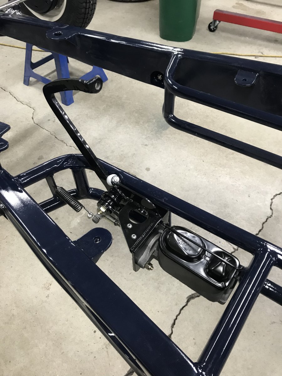

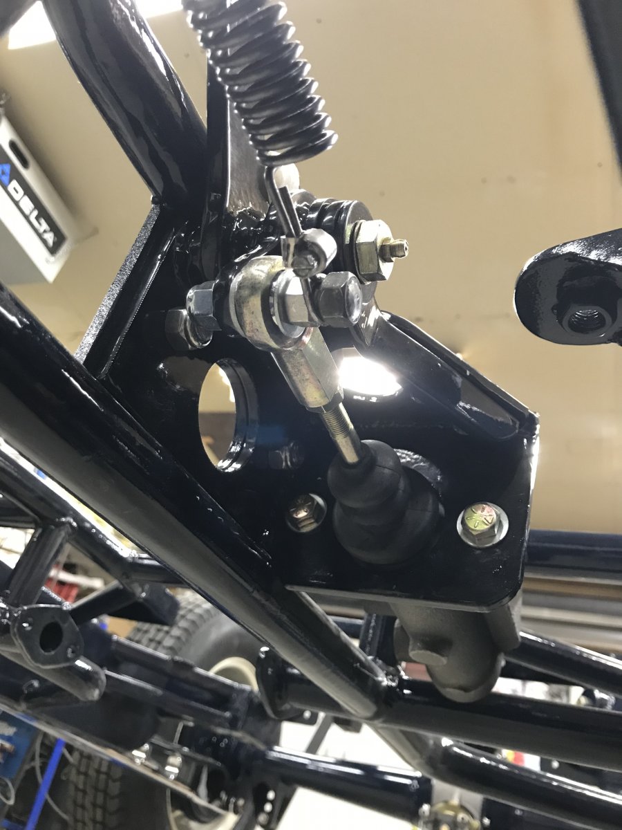

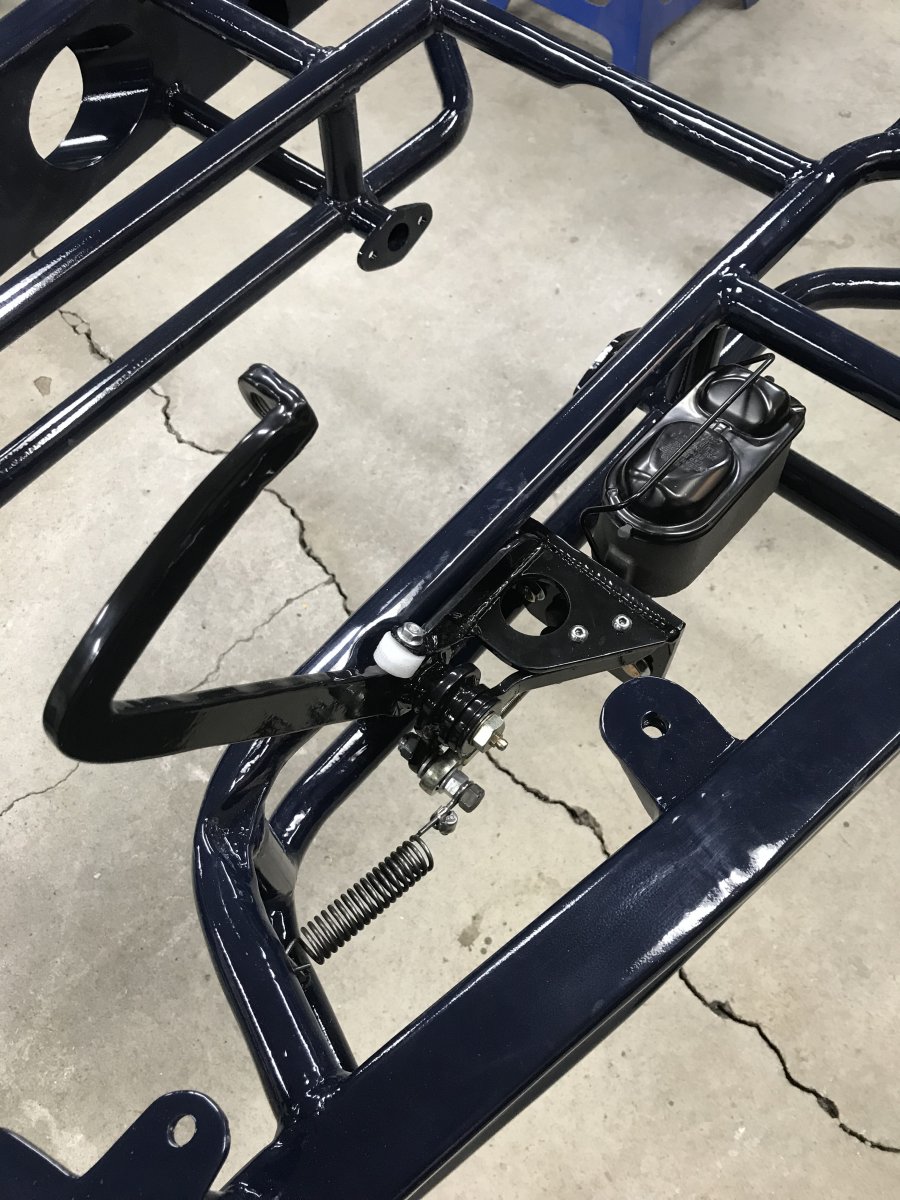

    Just to prove that things haven’t come to a full stop I ***embled and installed the start of the brake system.
    The pedal and master cylinder ***embly.
    Next will be a trip to the brake supply shop for nicopp tubing and other stuff :cool:

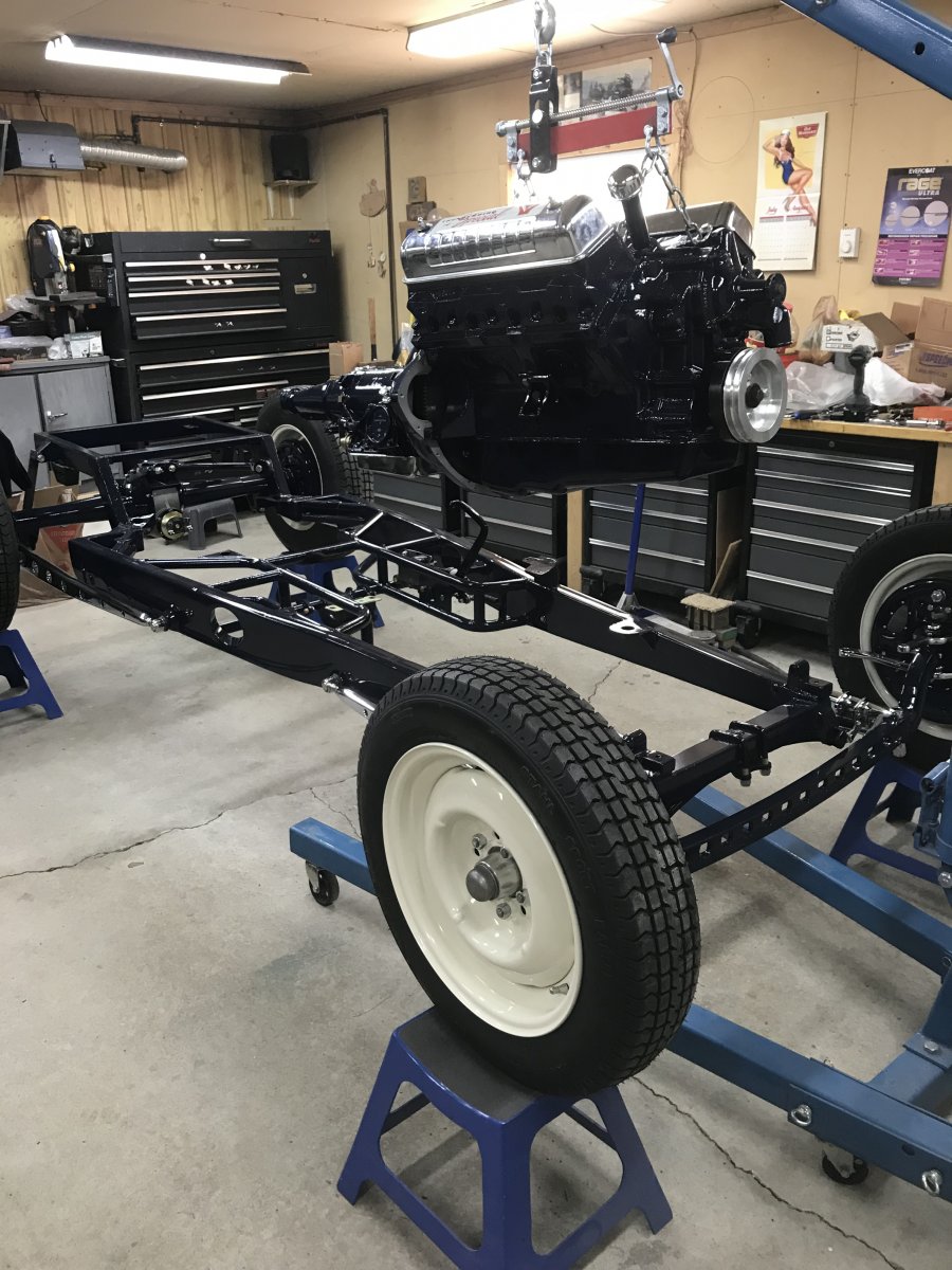

    A rather momentous thing happened today.
    I decided that since the transmission ends up so close to the brake master cylinder I would probably be better off having it in place before running brake lines.
    It will make it a little bit harder to install lines however everything will fit.
    So the momentous event was the ***embly of the engine and transmission and putting it into the frame. :cool:
