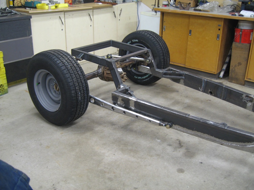

    And a bump. Went out to the garage and totally rebuilt one of the upper front 4 bar mounts as I noticed it somehow was a little off square and sat at a small angle. Bushing tabs were crooked too.
    Must have been tired when I put that one together.
    So I cut it all apart and started over.
    It was not going to be seen under the car and would have worked fine, however I knew it was there :eek:
    It's right now :). And somehow it just "feels" better. ;)

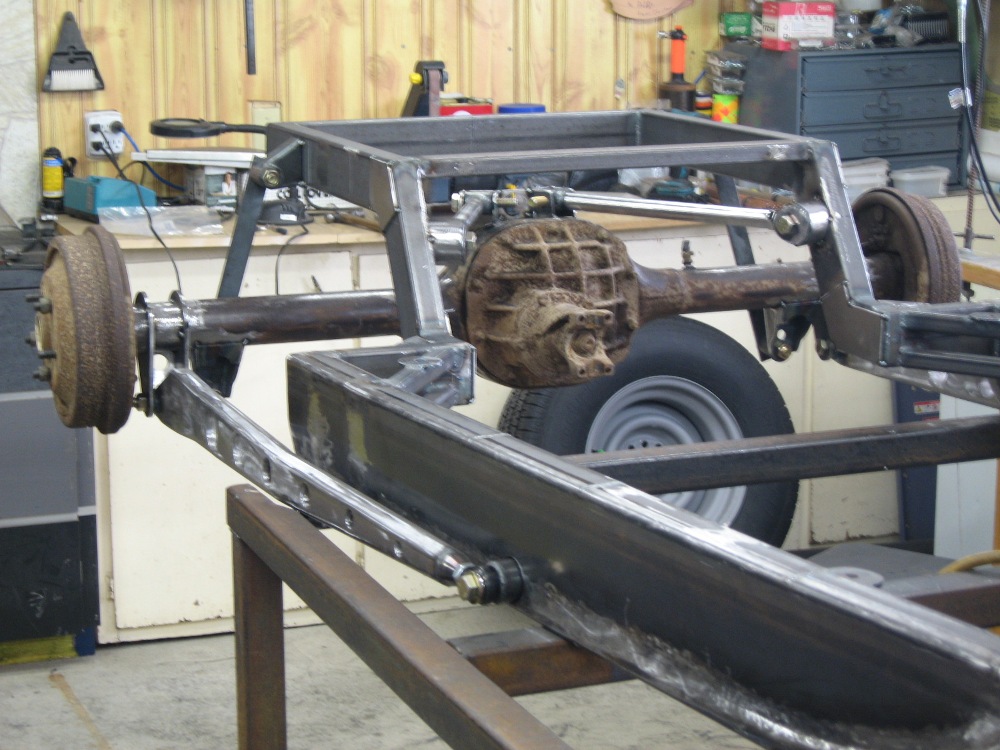

    just some small changes appears to have made a huge difference. do you think the heim joints at the axle mount location were causing some of the issues versus the new mounts.
    can you show a side view of your lower wishbone..
    this is closer to what I will have, a center upper mount (the leaf spring mounting point). it gives me hope.
  6. Blue One
    Joined: Feb 6, 2010
    Posts: 11,512
    Blue One

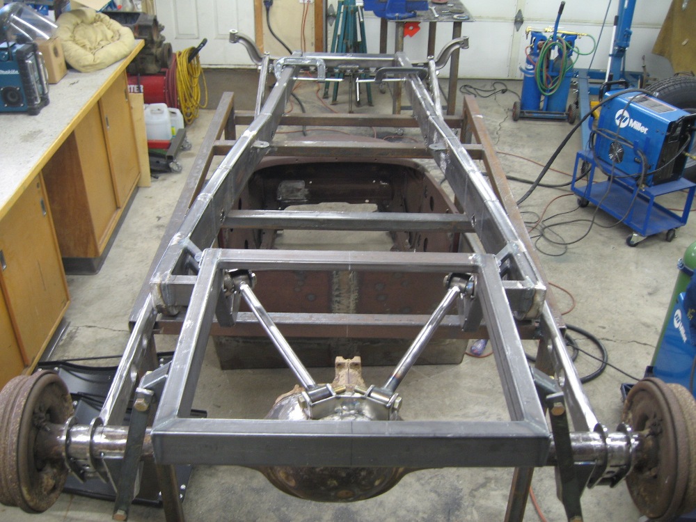

    from Alberta
    Eliminating the top heim from the wishbones and moving to the one pivot point under the rear end makes all the difference.
    The urethane bushings are standard rear 4 bar bushings that have been used on hundreds or more rods. Got them from the local rod shop, likely came from TCI.
    The rear end now moves as it should and the urethane bushings will be quieter and smoother and locate the rear end more positively.
    Here is a side shot of modified rear wishbone (which most of will be behind the rear tire of course :)) still turned out ok.
    Should be a good suspension and no panhard needed either.
    I'll still have to do a panhard for the front.
    Larry.

    And a sort of "birds eye view" of the ch***is as it is now.

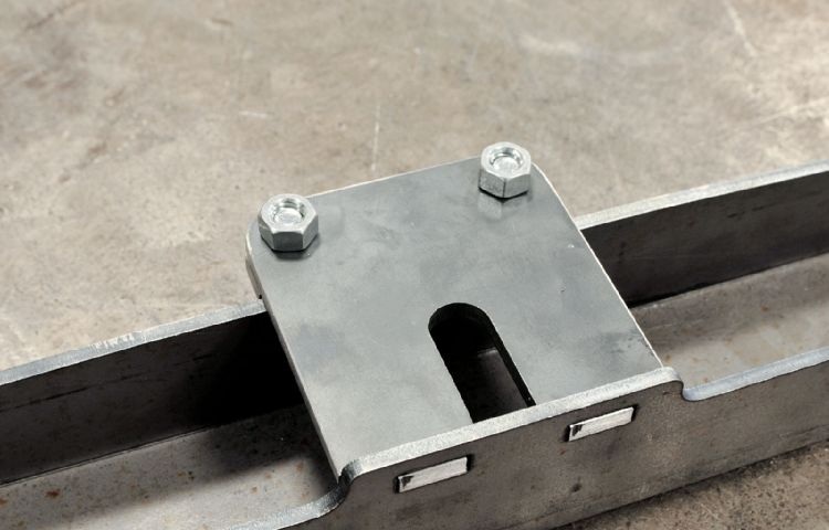

    I did the front crossmember from 3 pieces welded together, and the plate is done like the other two pictures here.
    I'm using a mono leaf spring with shim plates taking the place of the other leafs and the plate is held by the tabs and 2- 3/8" grade 8 bolts.

  12. Nice progress, and nice work. I'm a little concerned about the spring retention plate method in your picture in post #133. I don't think it would take much of an encounter with an immovable object to twist the tabs out of the slots and let the spring and axle ***embly out. U-bolts aren't as clean looking but they are considerably more secure for that job. I could be wrong - just an observation.

    I hope not Charlie, I actually copied the design from the guys at Shadow Rods. They use it on their XL 27 ch***is.
    And the plate is made from 1/4" plate ,I made my tabs wider than the Shadow rods version.
    I may end up lengthening the tabs and making up a type of a locking plate ,I have an idea that would still leave it clean in appearance and be more secure (insurance I suppose).
    And it will still be slim enough to be tucked behind the bottom of the 28 shell.
    Larry.

  14. Larry,
    I figured you had thought it out...I hadn't seen the Shadow Rods solution before. Not intending to be overly critical. I spent many years in safety inspections and some in drag racing tech and I still think along the lines of "what could possibly go wrong?".
    Keep up the good work.

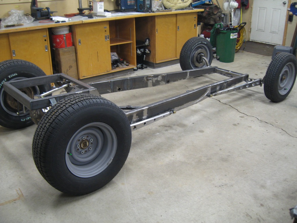

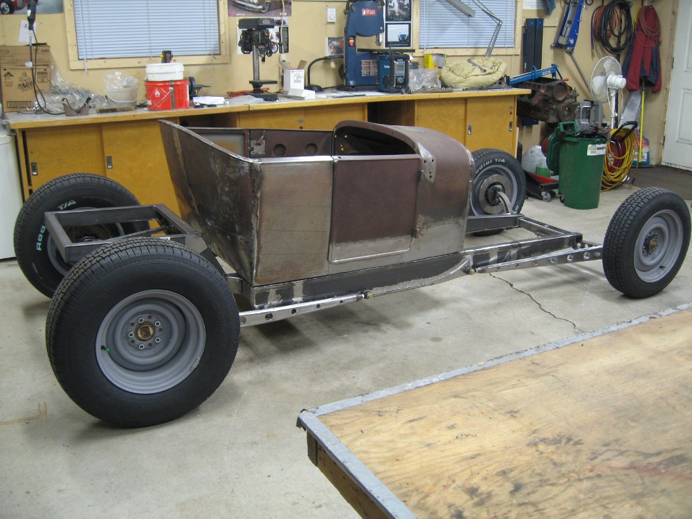

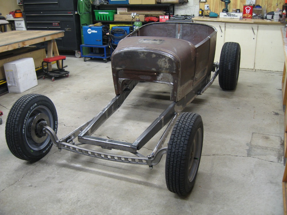

    Update time, reached a milestone more or less.
    I finally got the ch***is off the table and sitting on the tires. It's not exactly a roller yet as the steering still needs to be figured out and built-installed.
    The next step will be to remount the body and mock up the 312 and trans, build motor and trans mounts,as well as any other crossmembers then sort out the steering column, box and all the links.
    Still not sure which way to go with the steering,
    a lot will be determined once the Y block is in place.
    A few pictures, looks like a hot rod ch***is ! :)

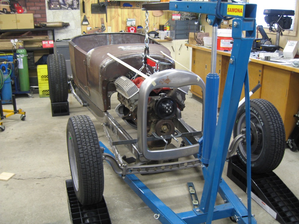

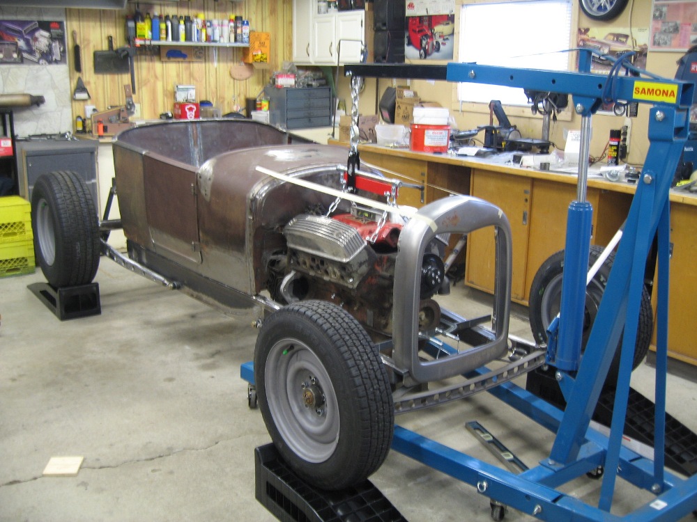

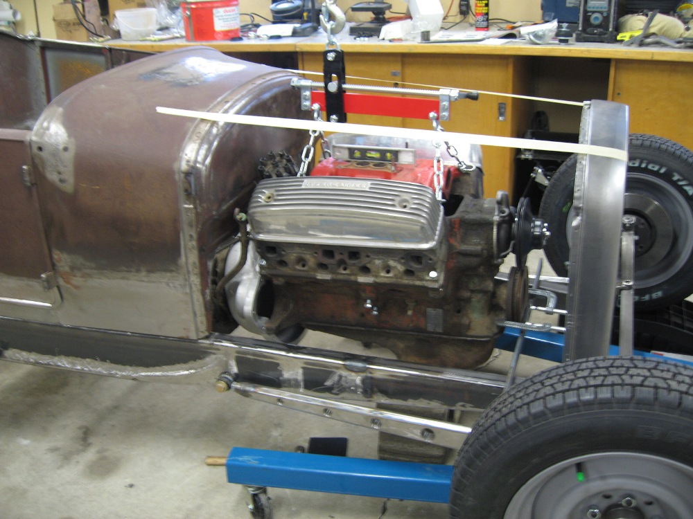

    Now the Y Block is finding it's new home. :)
    volvobrynk likes this.

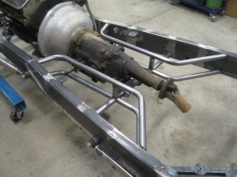

    First part of the rear trans mount and crossmember.

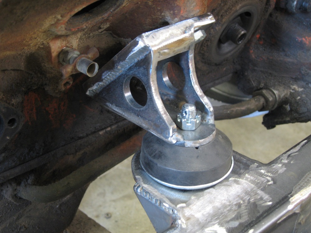

    My version of side mounts for the Y Block 312. :)

    Those motor mounts are way cool!!

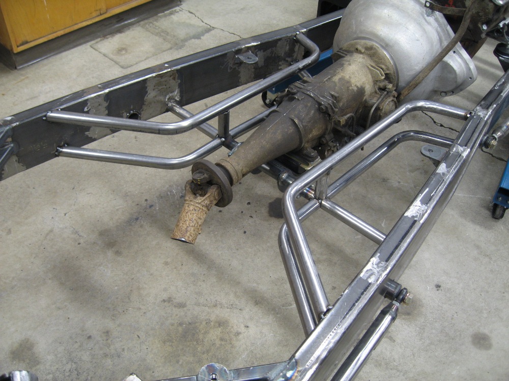

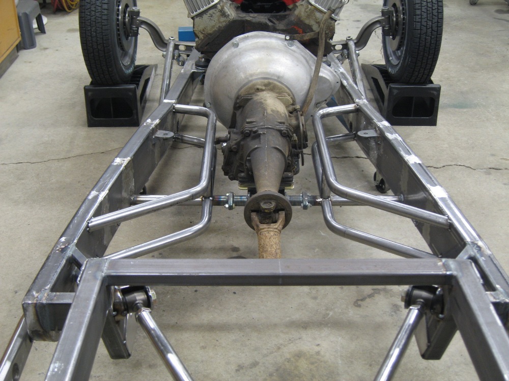

    I used the tubing I bent from my Bending Tubing thread, (1 1/4" x 1/8" wall) to build the tubular center crossmembers in my ch***is.
    They tie the transmission crossmember in and strengthen everything.
    Pictures below.

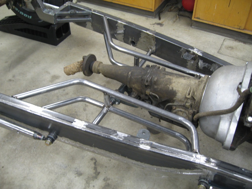

  26. Blue One
    Joined: Feb 6, 2010
    Posts: 11,512
    Blue One
    from Alberta
    Final tubes put in for strength.

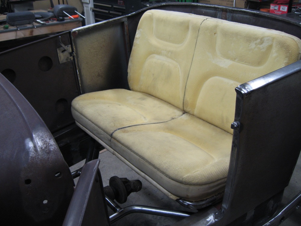

    Wanted to get a seat in place so I could sit in it holding the steering wheel and making Y-Block engine sounds :D
    Actually I need to know where I will be sitting so I can place the steering column, cowl steering box and brake pedal etc.
    I had a Dodge minivan seat the narrowest one, picked it up earlier at the self serve yard for $30.
    I wasn't sure if I would use it, but thought it would be nice to have an actual seat with a metal frame and a spring suspension bed, rather than the sometimes used slab of plywood you see in some T's.
    So naturally the damned thing was too wide !

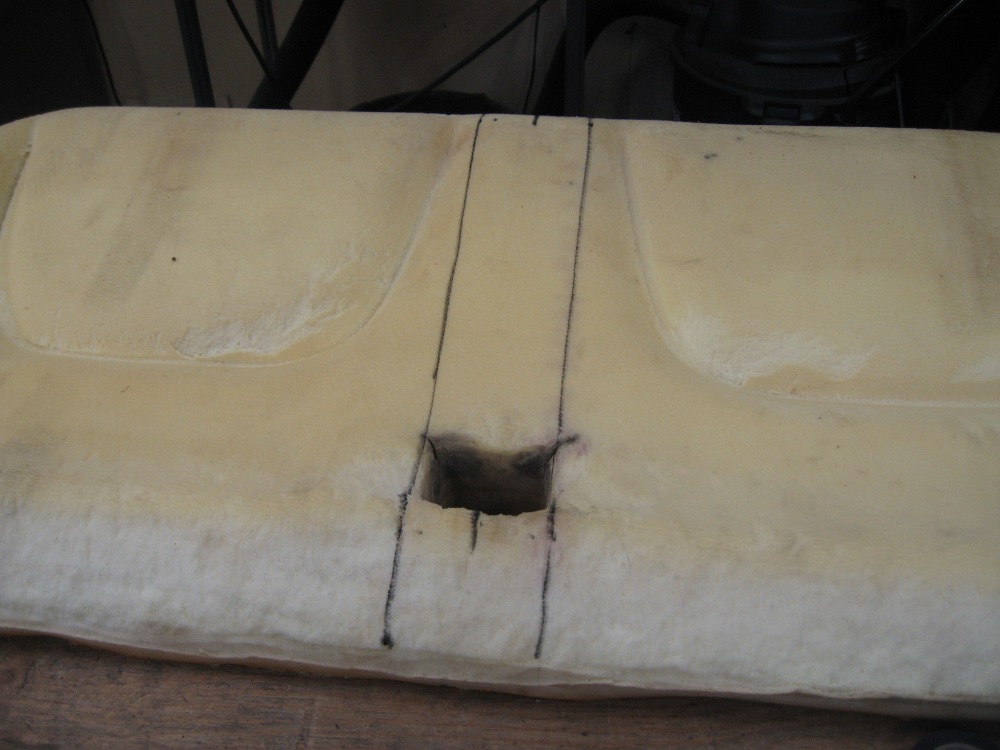

    I decided to try stripping it down and narrowing the frame and foam.
    I cut 3 1/2" out of the middle of the frame and also the foam. The foam I sliced straight and glued the pieces back together.
    I think it turned out pretty fair. It's comfortable and doesn't look too bad.
    I think I can get it about an inch lower down, right now the side of the bucket body is about 2" below my armpit sitting in the seat. So an inch lower would be nice.
    Pictures below take a look and don't be afraid to comment :)

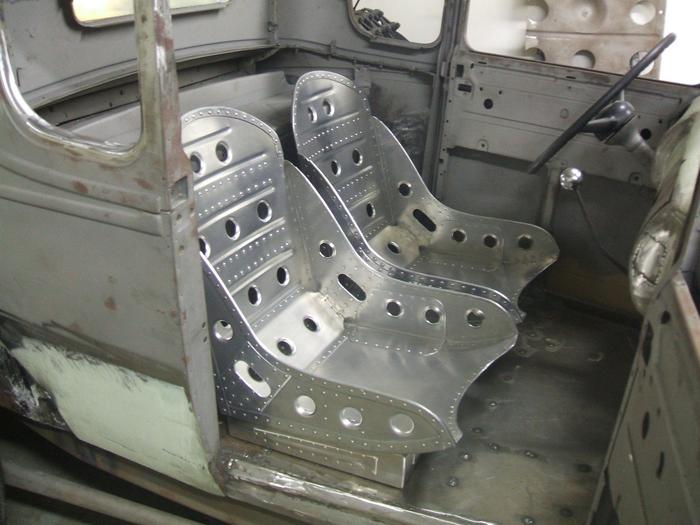

    Now I have a decision to make. Keep the bench I have fitted or go with a pair of these Bomber seats.
    I really like the bombers and they would probably be better with the theme of my build....
    And they can be comfortable too... Opinions ???
