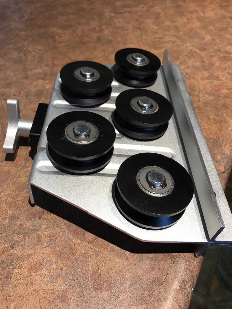

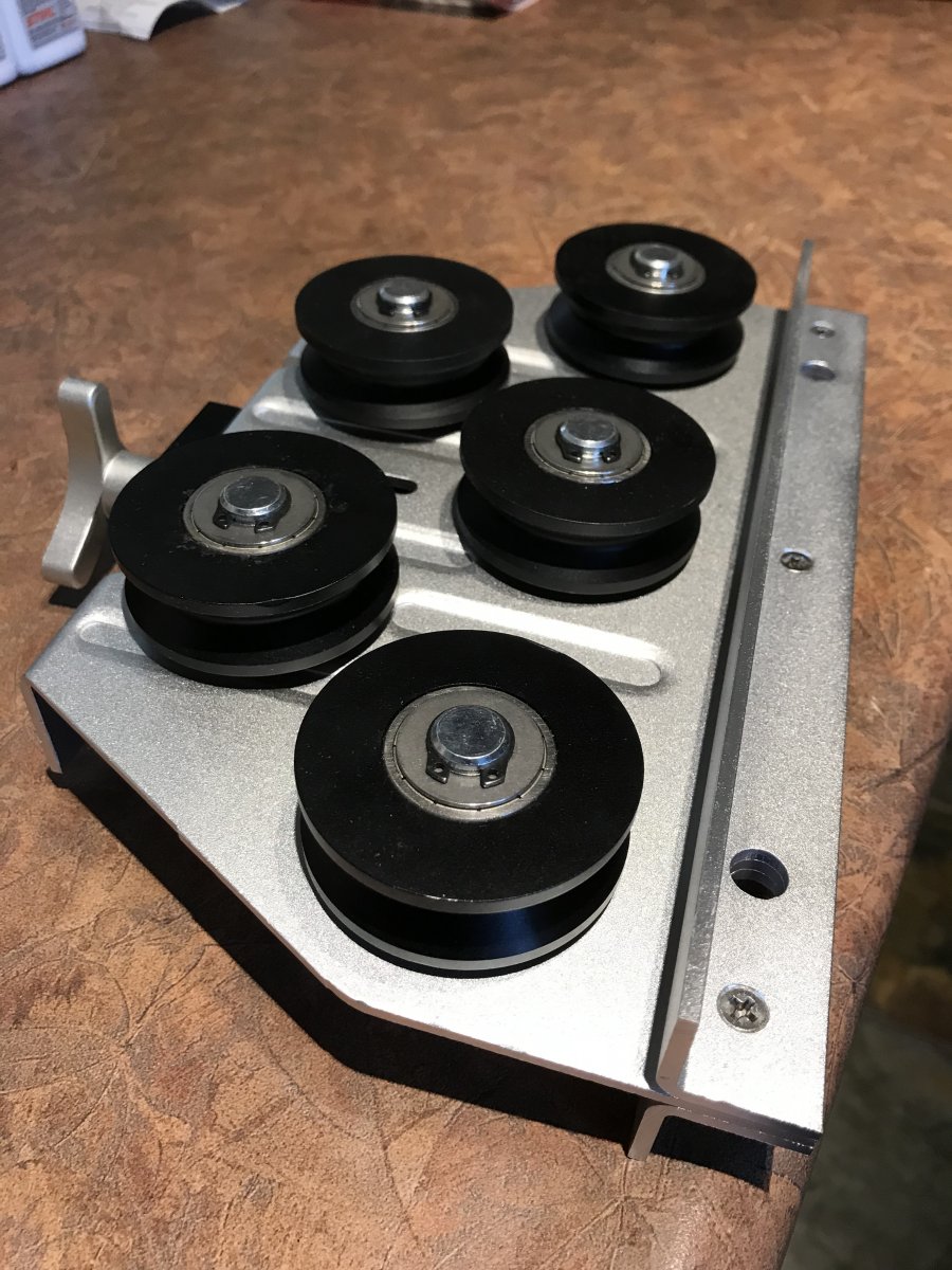

    I love getting new tools :cool:
    I got home today and got this in the mail from that auction site :D
    A tubing straightener.:cool:

  9. albertaboy
    Joined: Jul 19, 2013
    Posts: 131
    albertaboy
    Have you tested it out yet? I'm in the market for one soon.
    Sent from my SM-N910W8 using Tapatalk
  10. Blue One
    Joined: Feb 6, 2010
    Posts: 11,512
    Blue One
    from Alberta
    Not yet, I’m thinking it will work well.

  12. rjgideon
    Joined: Sep 12, 2005
    Posts: 573
    rjgideon
    I'm interested in the straightener as well.
    I did see that some other guys commented on a post about brake lines that you can do the same with a hole in a 6-8 inch chunk of wood. They said to add some grease in the hole and run the tubing through and it comes out straight. My luck I'd have grease all over the place before I was done.

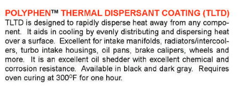

  24. The 39 guy
    Joined: Nov 5, 2010
    Posts: 3,775
    The 39 guy
    That Rad looks great! Powder coating......heat dispersion. Please elaborate.

  27. Blue One
    Joined: Feb 6, 2010
    Posts: 11,512
    Blue One
    from Alberta
    Info coming below ;)
    It's a coating called Thermal Dispersant and it's made by a company called Tech Line.
    https://techlinecoatings.com/tech-line-coatings/industrial-coatings/thermalmanagement/
    :D:D Thanks.

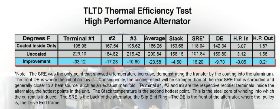

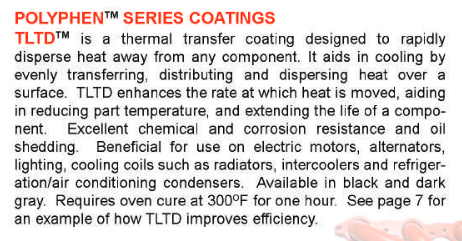

  28. The 39 guy
    Joined: Nov 5, 2010
    Posts: 3,775
    The 39 guy
    Some info from the catalog. It;s amazing some of the stuff they come up with these days. How did you find out about this stuff Larry?
