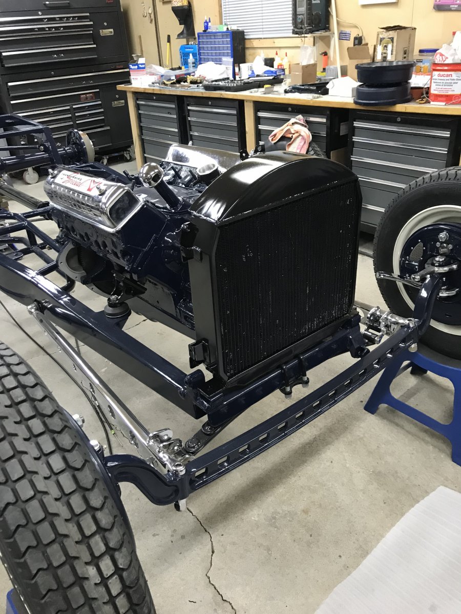

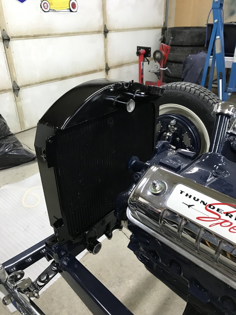

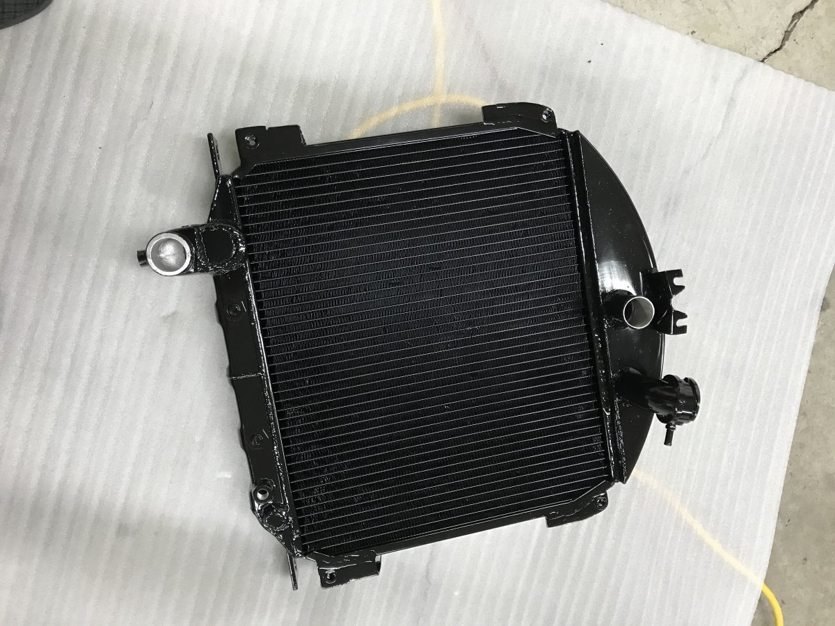

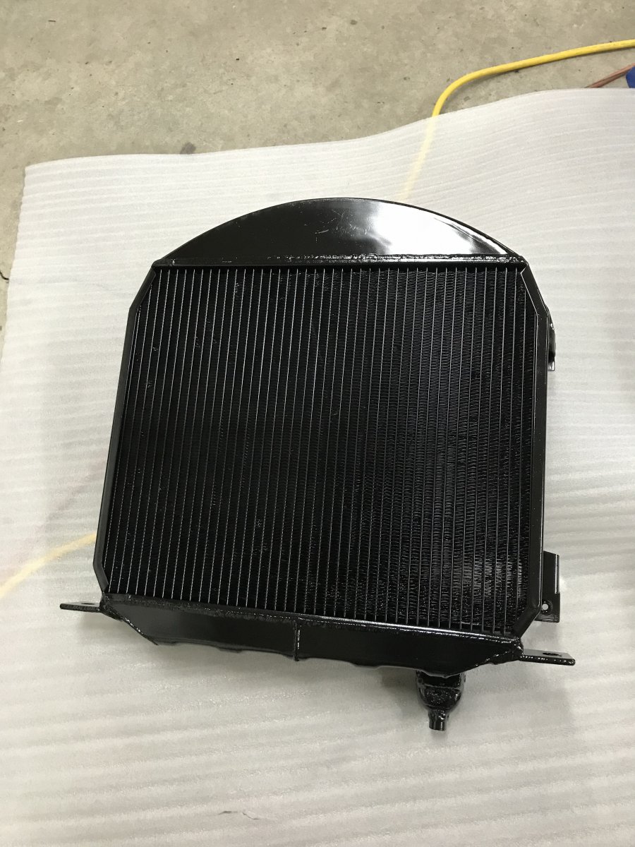

    It’s custom built to order, basically a shorter A radiator.
    Once I cut down my rad shell I ordered the rad to the size I needed .

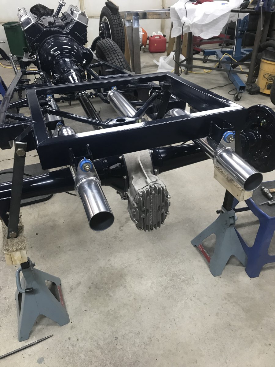

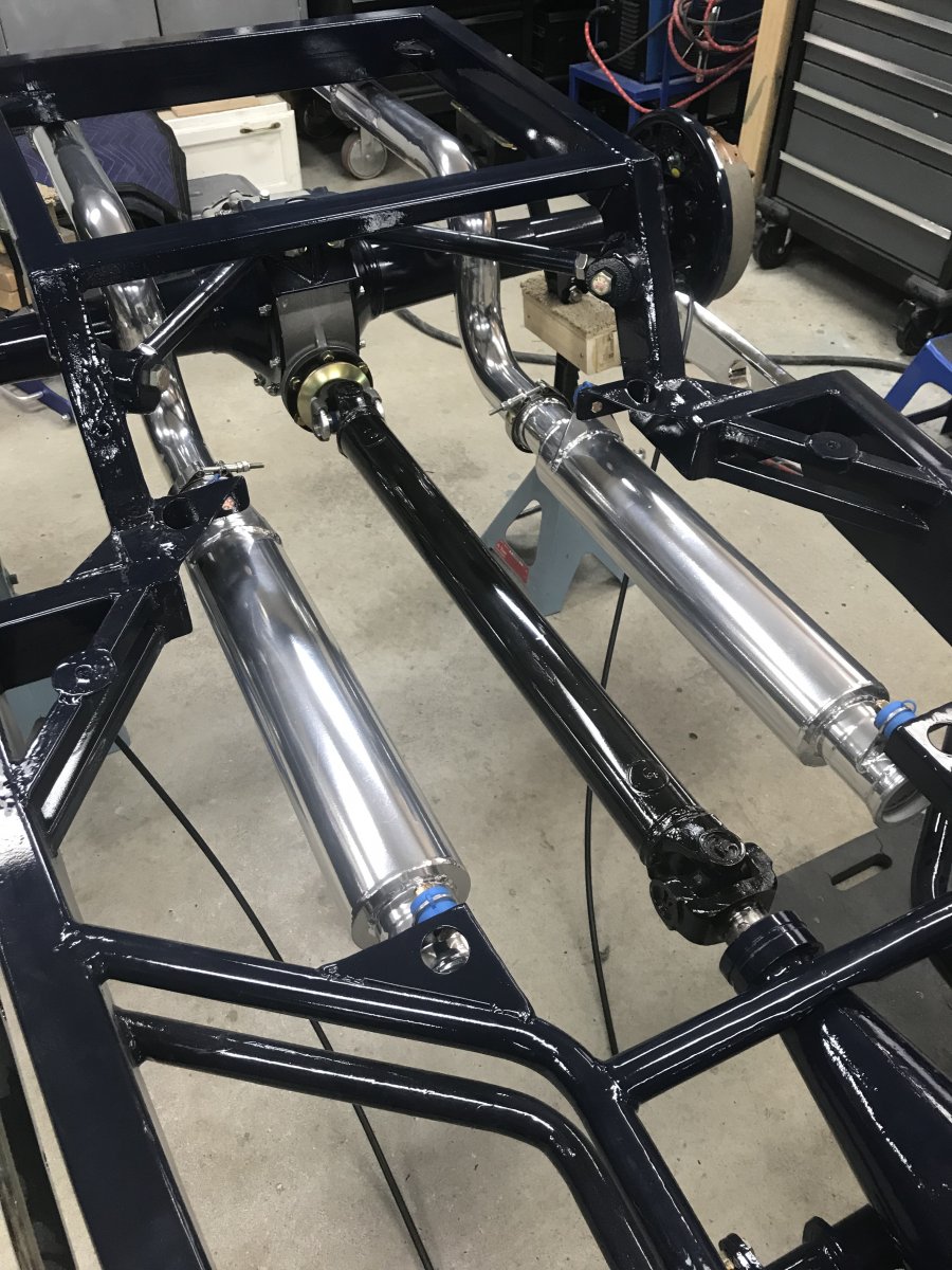

    And then, an exhausting exercise and there’s a partial exhaust system in place :D:cool:

    I'm glad you said "exhausting" before one of us did. That is beautiful!

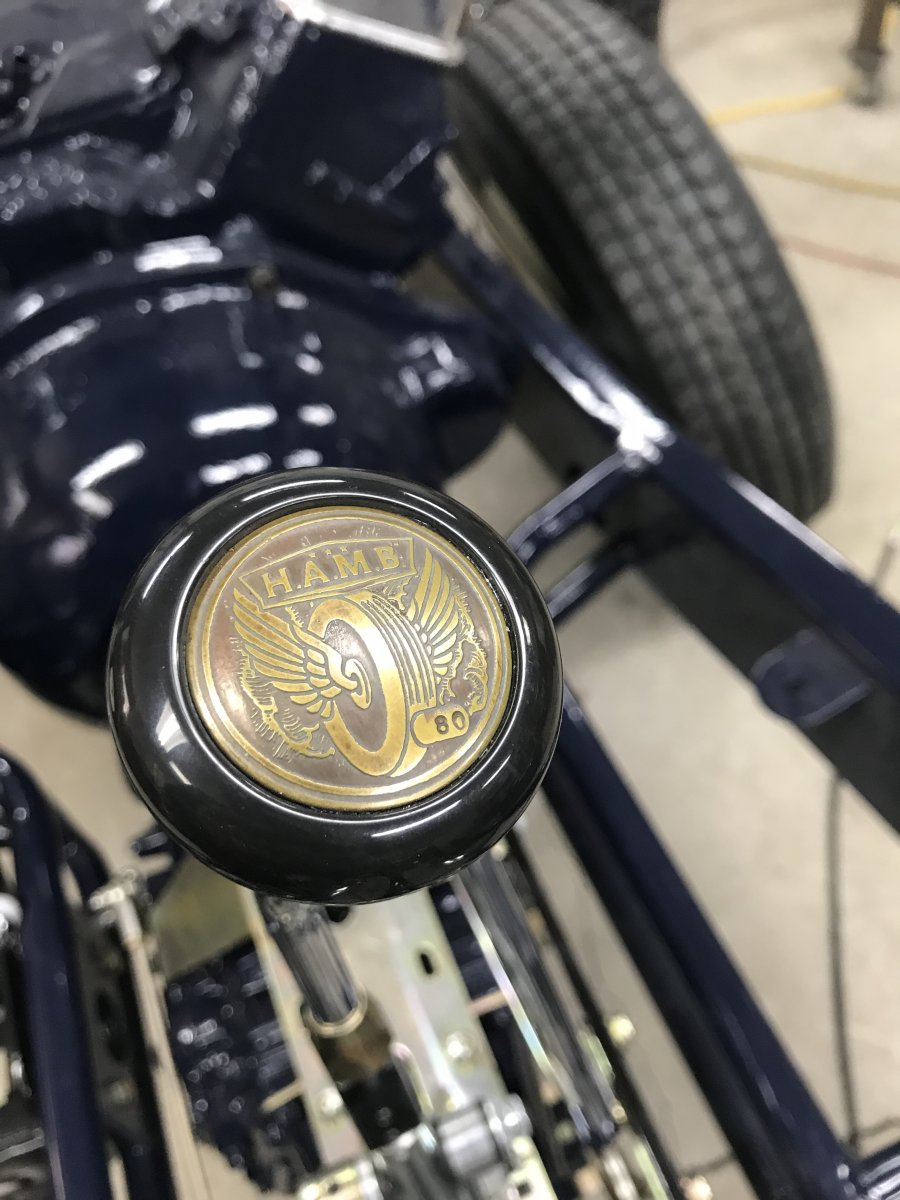

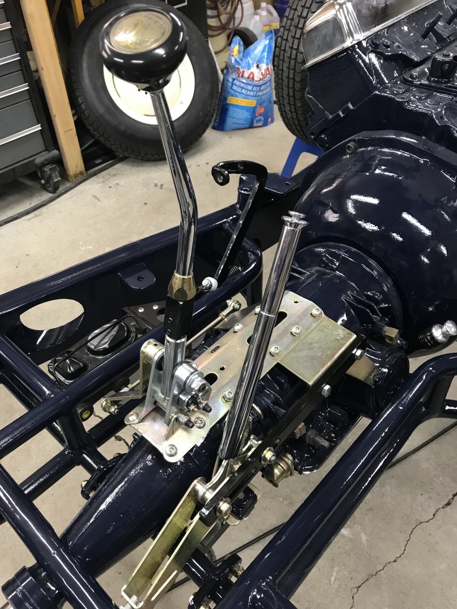

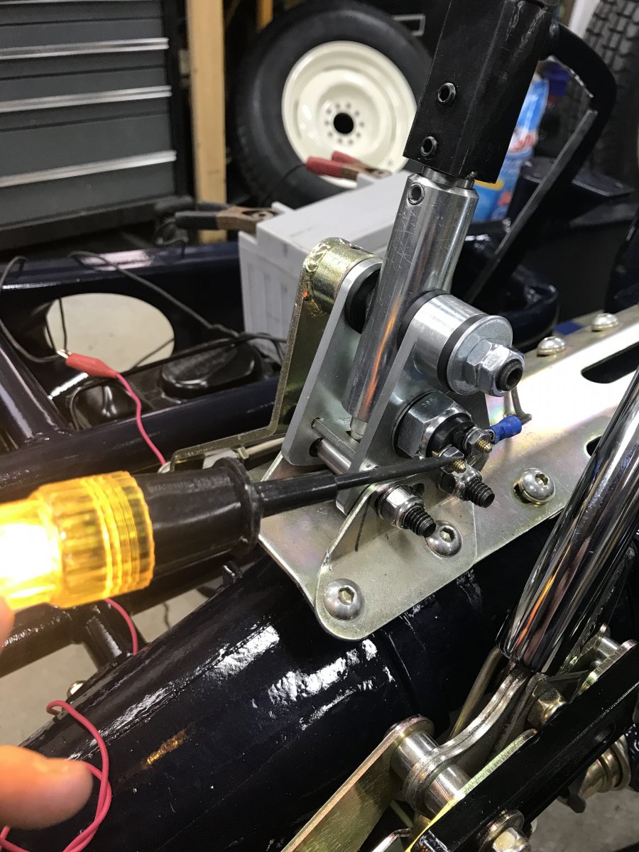

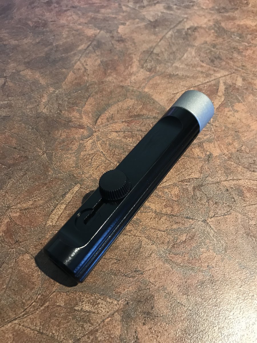

    I combined the mounting hardware from the Lokar shifter and mounted the new Gennie shifter.
    Gutted the Lokar stick and made an adapter to mount it on the Gennie shifter.
    Then I drilled out the Gennie shift knob and re threaded it to the Lokar’s 3/8-24 thread.
    While I was at it I did the same thing to a special shift knob ;)
    So now I have a gated shifter and no annoying push ****on in the knob. :cool:

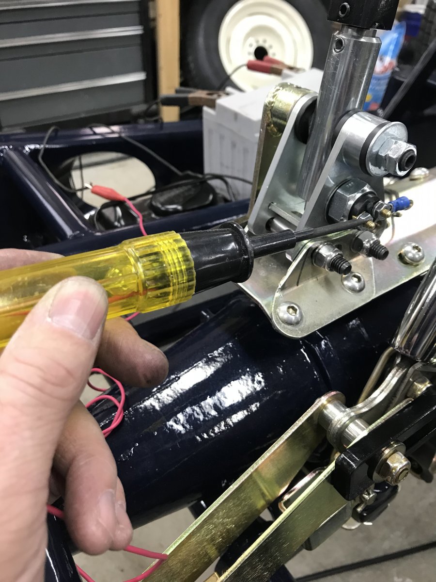

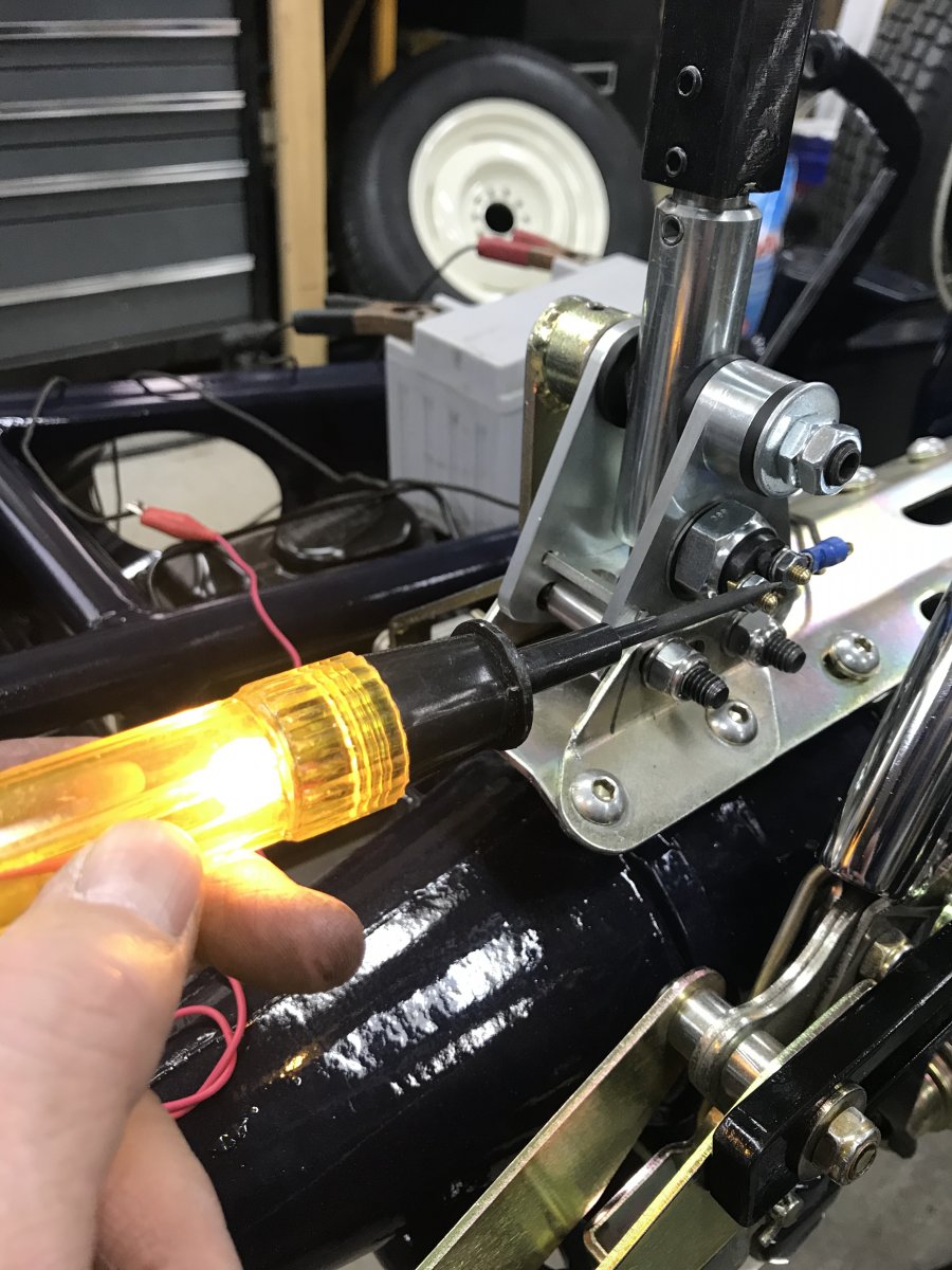

    I decided to set up the Gennies neutral safety switch and found the perfect adjustment.
    Power for starting in neutral and park only.
    Setting up the switch I found that I had to make a .049 thick shim to get the adjustment perfect.
    I’m hoping to drive this thing this coming summer but man all this stuff eats time. :D

    Looks great! Good move eliminating that push ****on feature. IMO, that's a weak point with those shifters.

    I like the gated shift pattern of the Gennie shifter much better.
    I hadn’t even driven it and the Lokar was annoying me :D

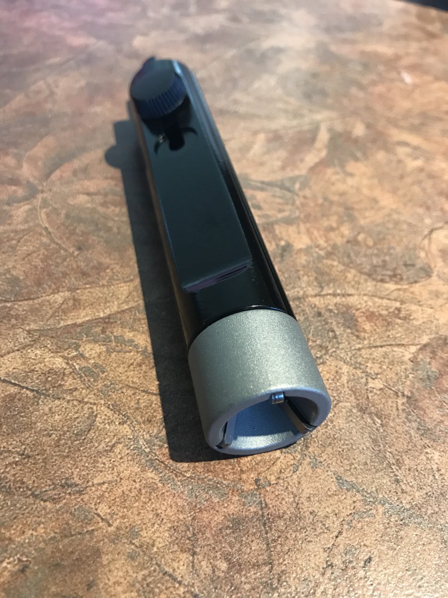

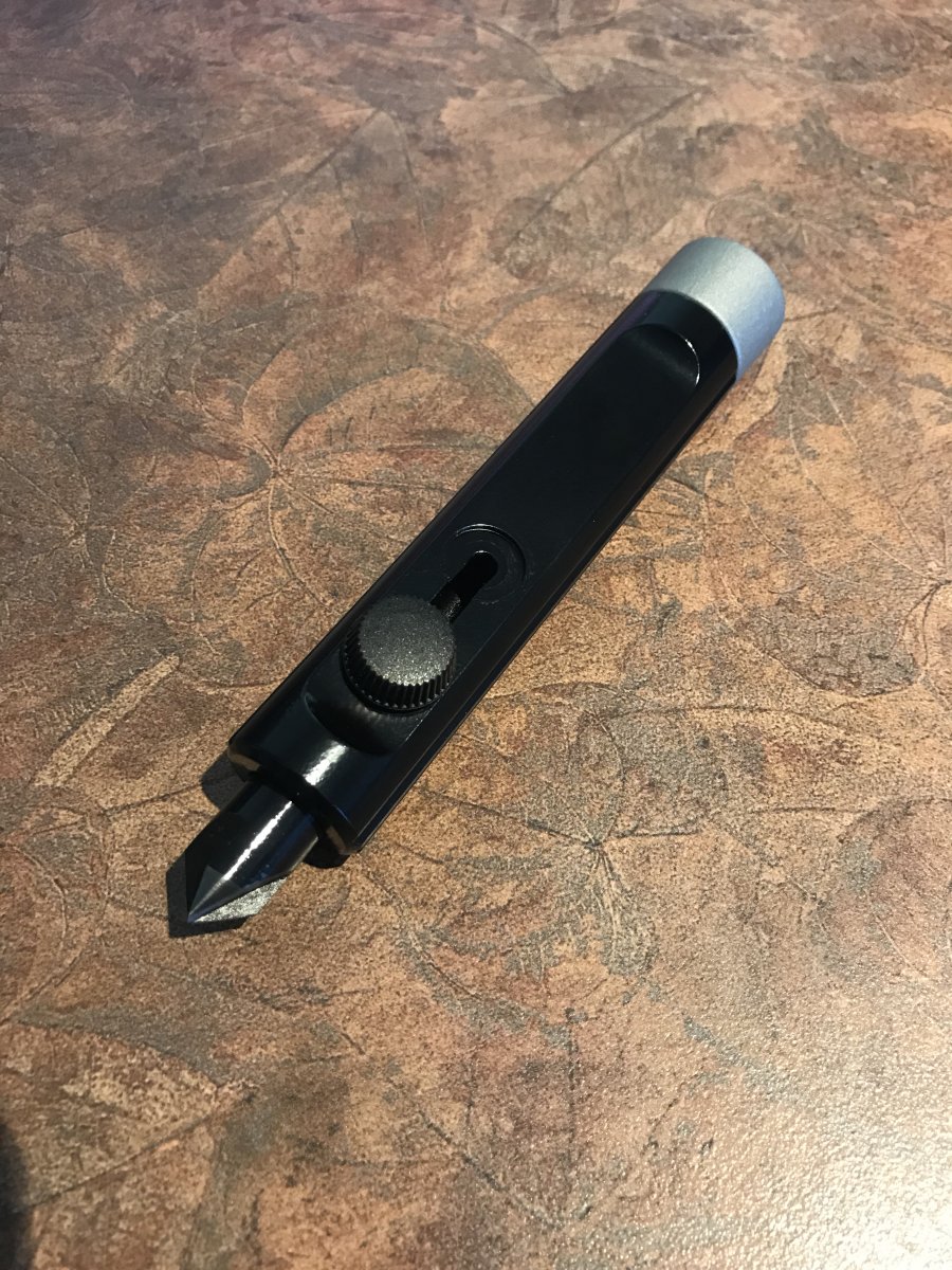

    I searched for and ordered up a neat little inside and outside tubing reamer for deburring brake and other tubing.
    Inline tube, it came today and it’s a nice little tool. :cool:

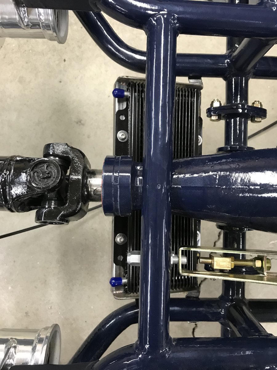

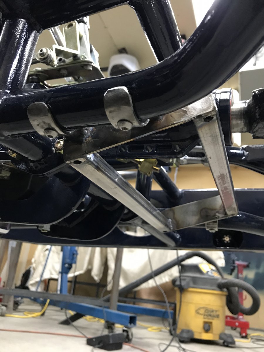

    I did actually get something done :cool:

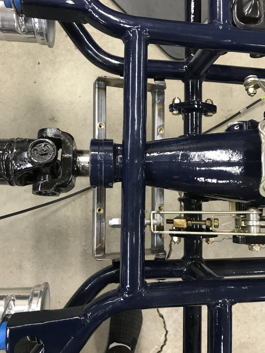

    I built a bracket to hold my Tru cool transmission cooler tucked up under the transmission tail shaft at a bit of an angle to get some air flow.
    It will also serve double duty with a support bracket coming off of it for the front ends of the emergency brake cables :cool:

    Oh, that's very nice!

    Thanks Fred once I get the e brake cable bracket done it’ll get a trip to the powder coater.
