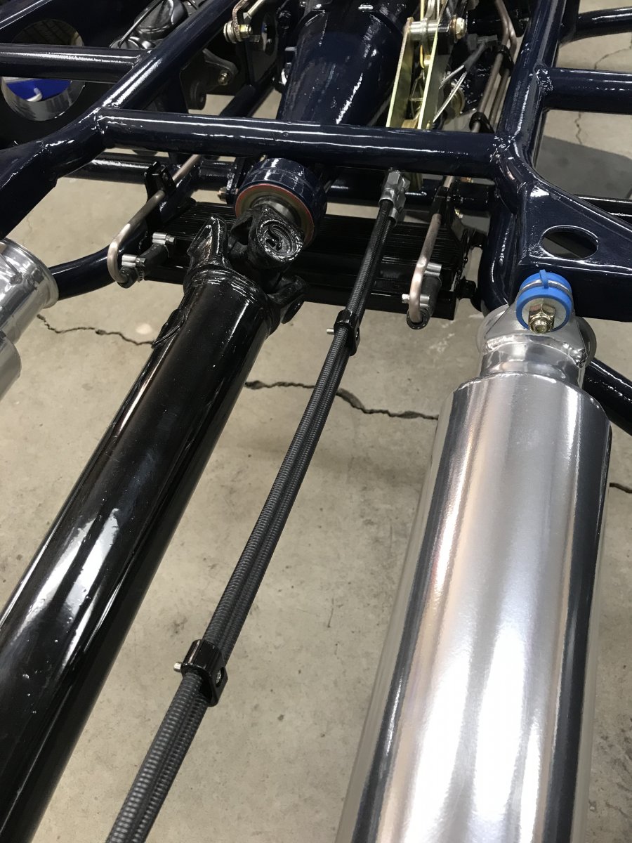

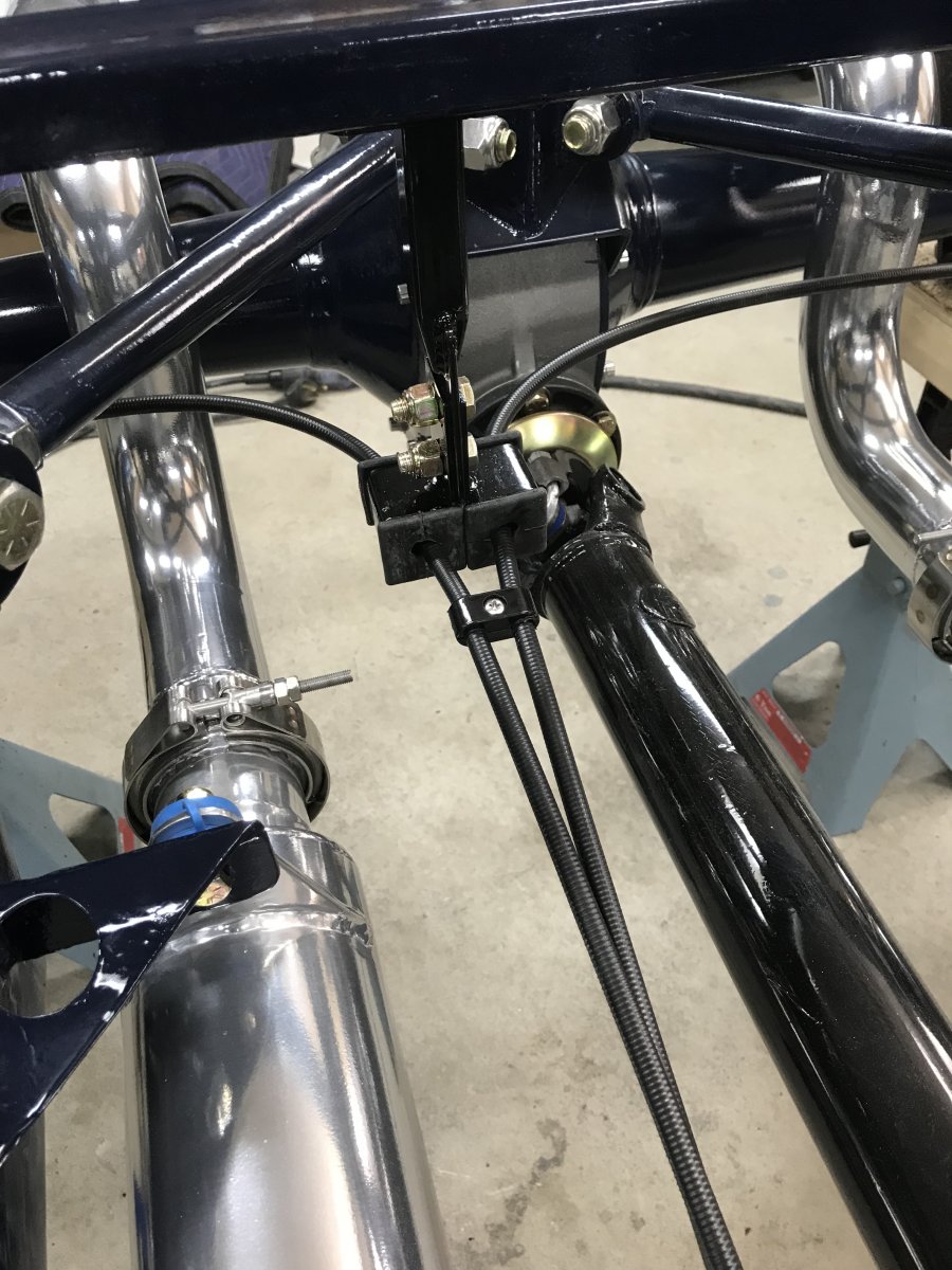

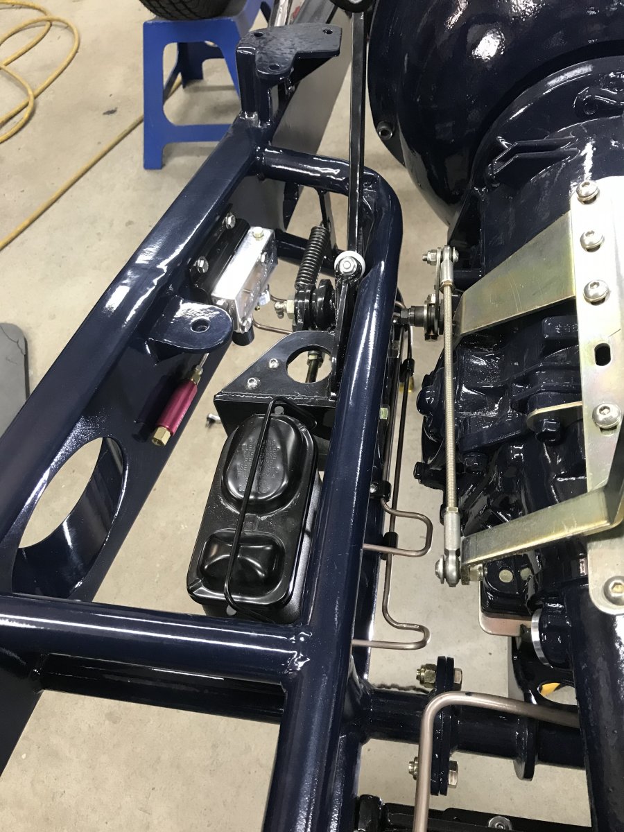

    E-brake cables cut to length and connected adjusted and secured :cool:
    Rear tires can go back on and then I’ll start with the brake plumbing.

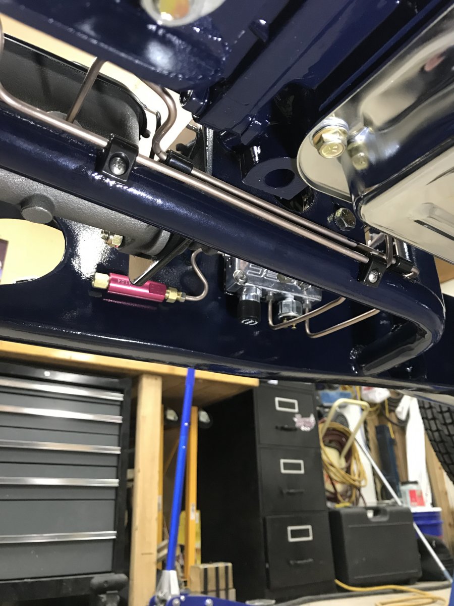

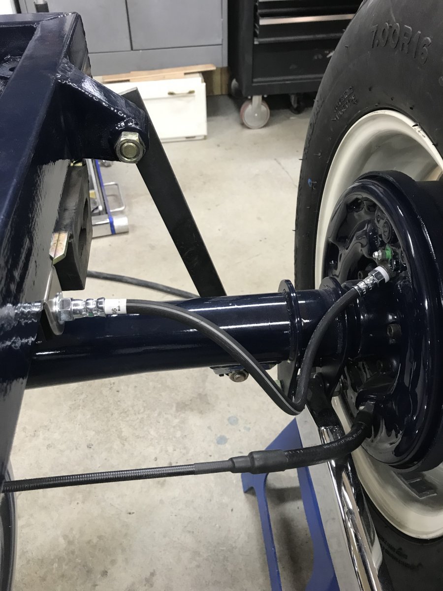

    Brake lines bent and installed from the master cylinder to the adjustable proportioning valve.
    Mounted with the small 3/16” made for you line clamps.
    It was quite a job figuring all that out :D
    Then I made frame brackets and installed the rear brake hoses.:cool:

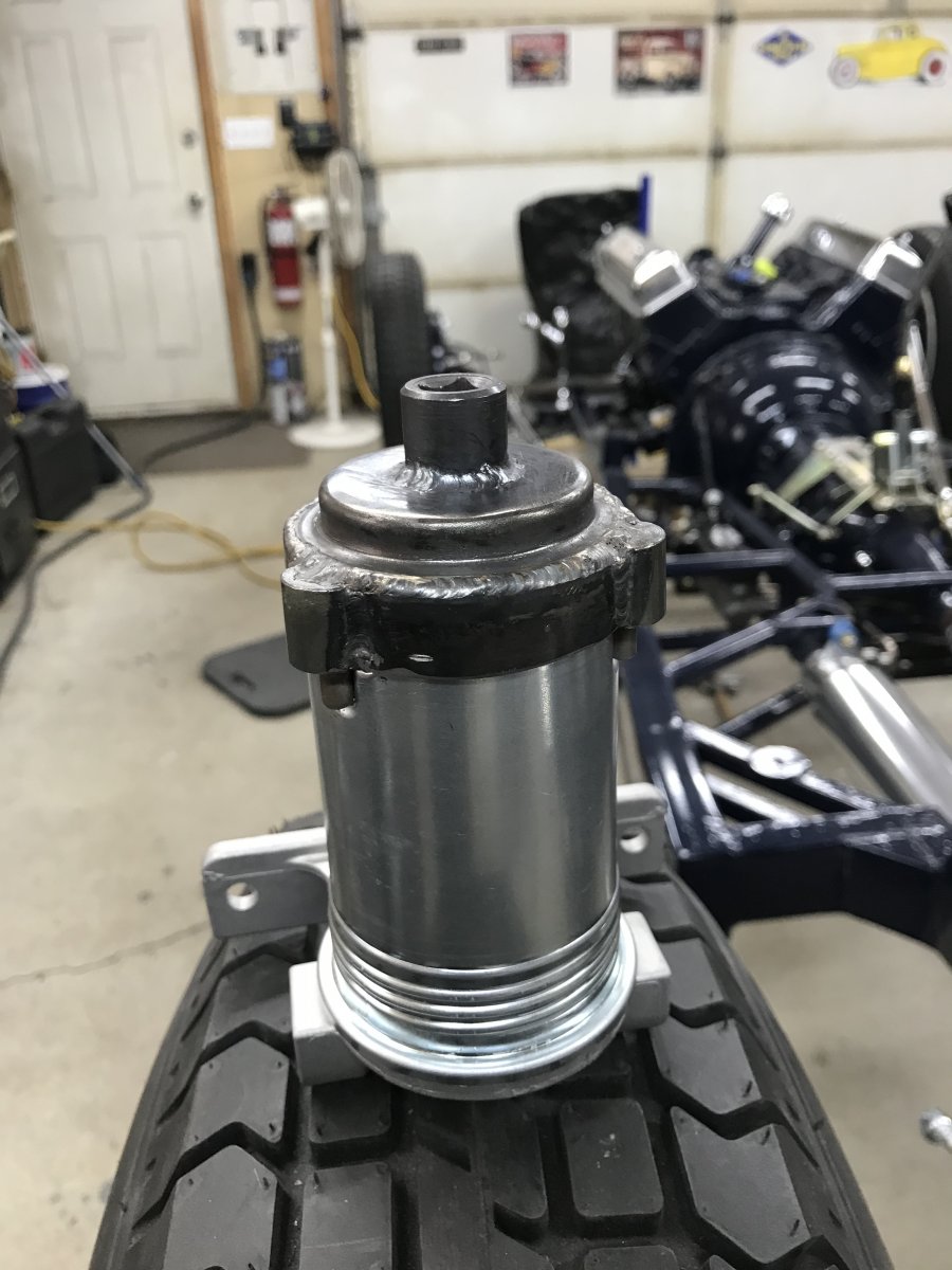

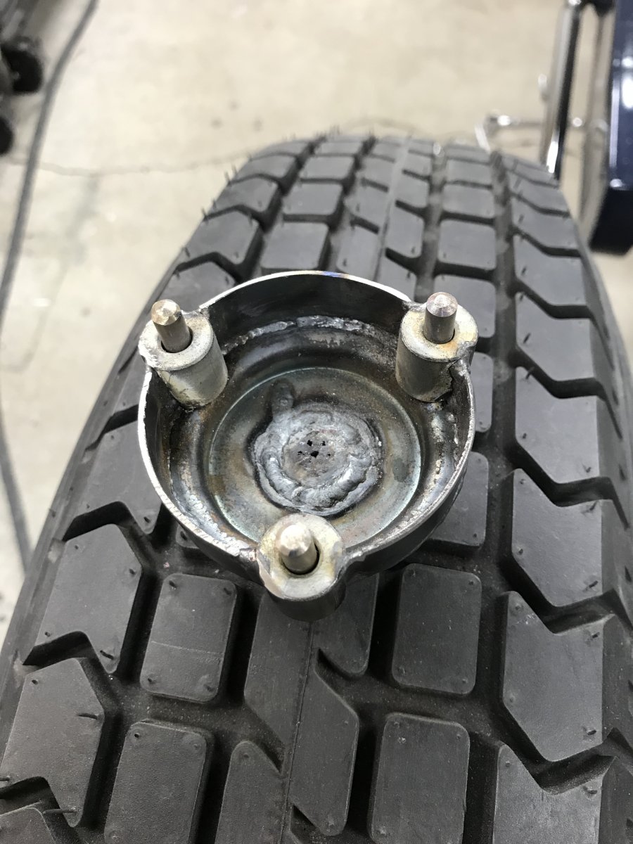

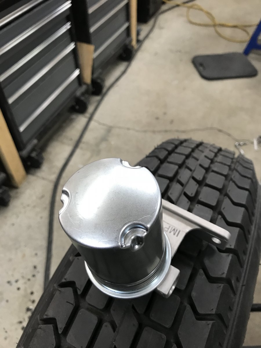

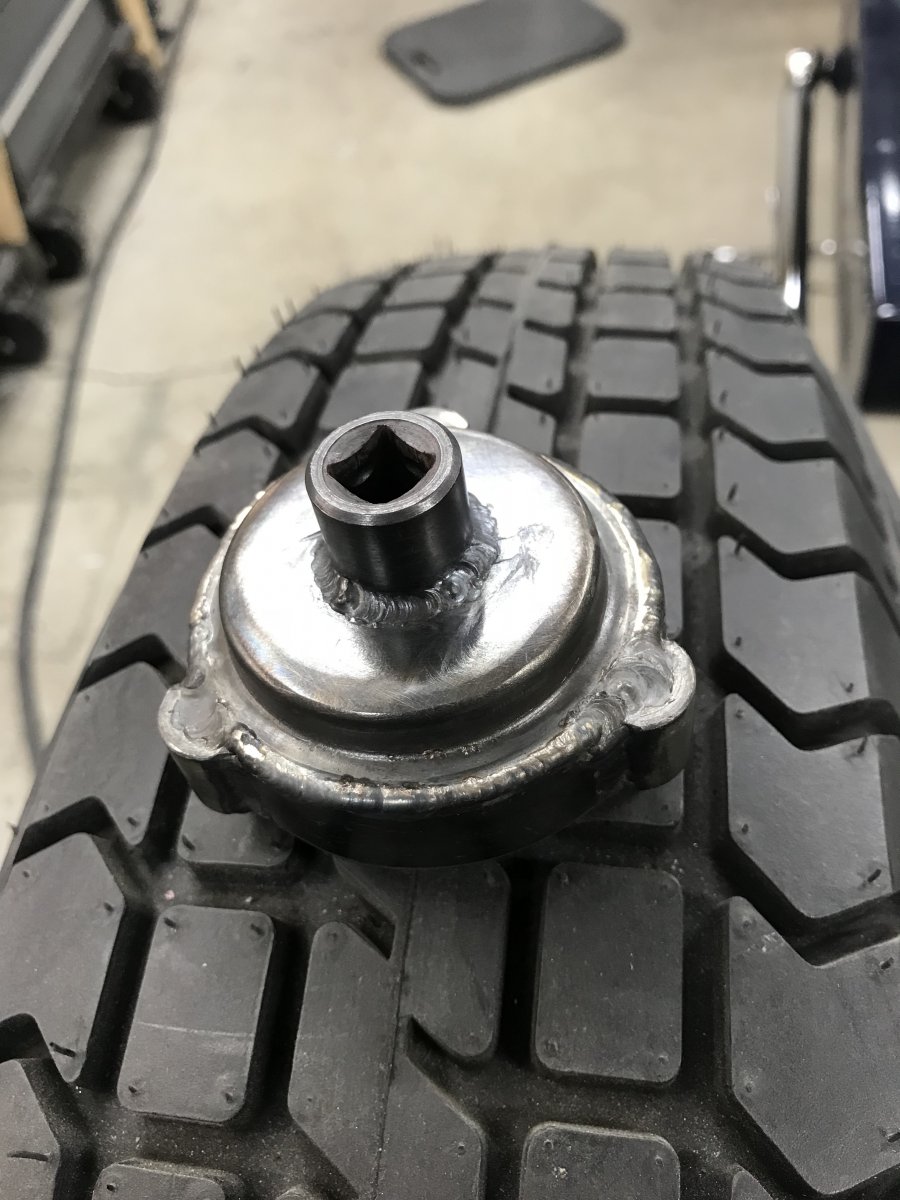

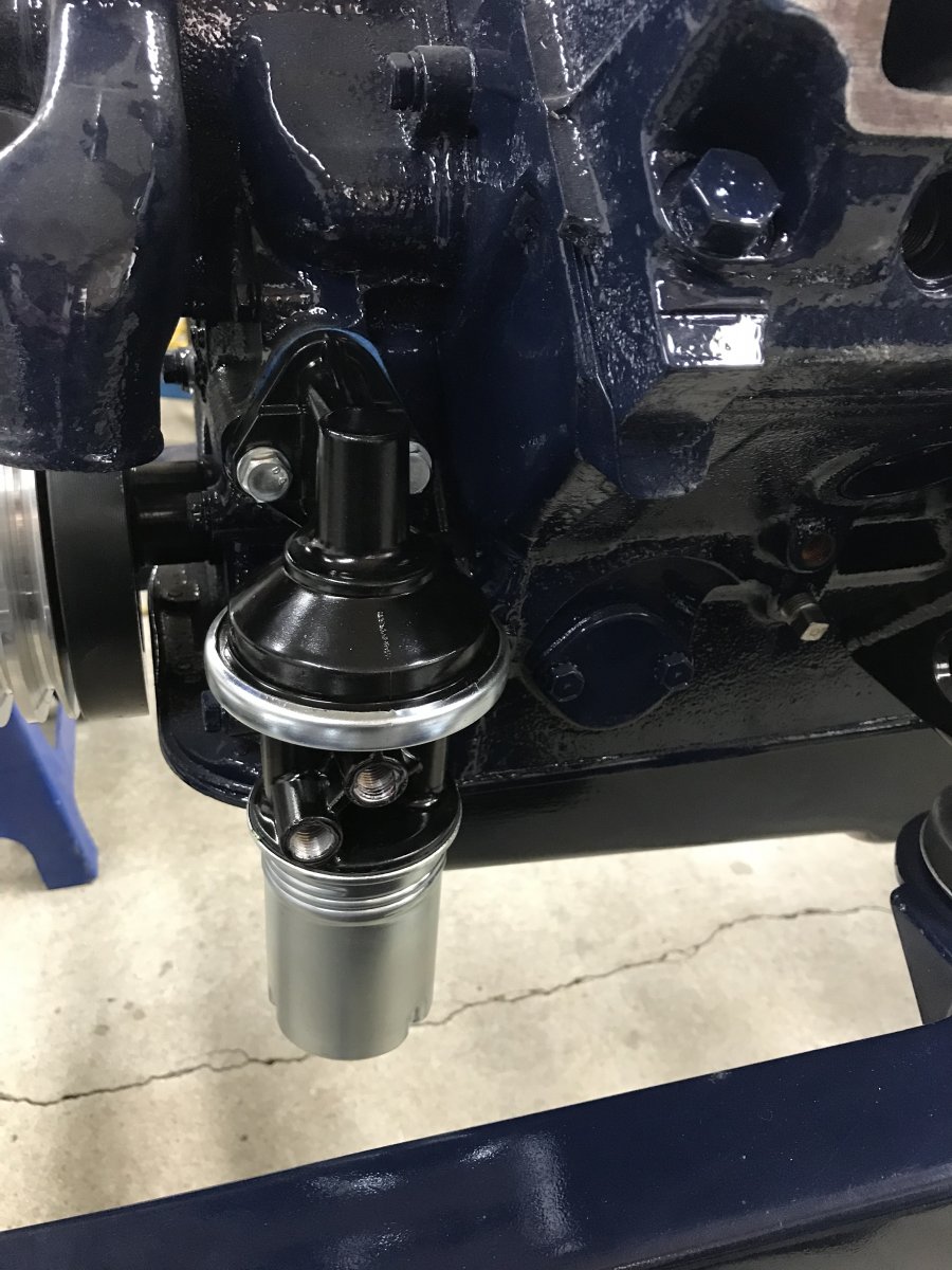

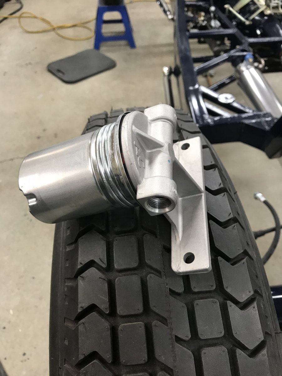

    I wanted to use a mechanical fuel pump on the Y Block so I went out and picked one up.
    Initially I had planned to mount an AC Delco fuel filter inside the frame rail underneath.
    Surprise, the fuel pump has a filter built into the bottom of it.
    Another surprise, it has the exact same threaded filter canister and uses the same filters.
    The canisters can apparently be a real ***** to remove once they have been in service, it seems that using a regular strap style filter wrench can collapse the canister, not good for something you don’t plan to replace.
    I did a little searching and since I couldn’t find the appropriate wrench I decided to make my own that fits nicely into the 3 small depressions
    in the bottom of the canister.
    Filter changes will be easy. :cool:

    Good job, looks like it will work well, just don't forget where you put it, I have a bad habit of doing that and can't find it when I need it. o_O

    Smear a bit of grease on that gasket before installing it, it will help you remove the filter later by preventing the gasket from sticking to the filter base.
    loudbang and Blue One like this.

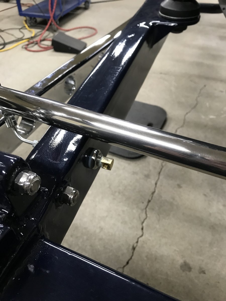

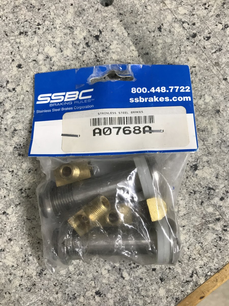

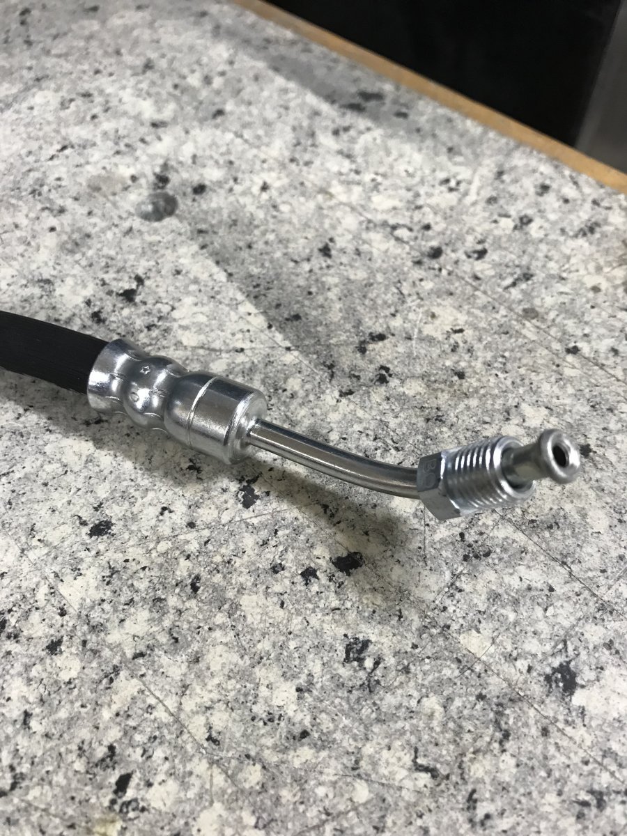

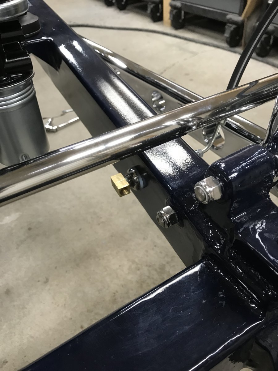

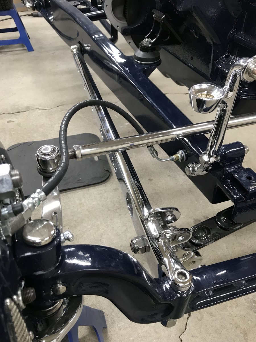

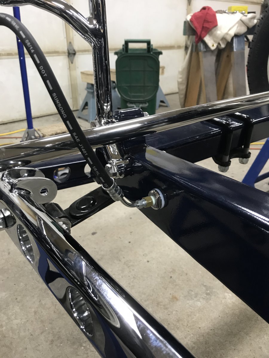

    I wanted to run my front brake lines through the frame and searched for a set of through the frame bulkhead fittings.
    Everything seemed to be equipped with #3 AN fittings on the brake hose end.
    I finally found a set from SSBC with 1/8” NPT thread on both ends so that I could use NPT to inverted flare fittings using my rubber brake hoses.
    I took my hoses to the local brake shop and had the female frame tab fittings cut off and some 3/8-24 male swivel ends crimped on.
    It all worked out nicely and now I’m ready to run the brake lines.
