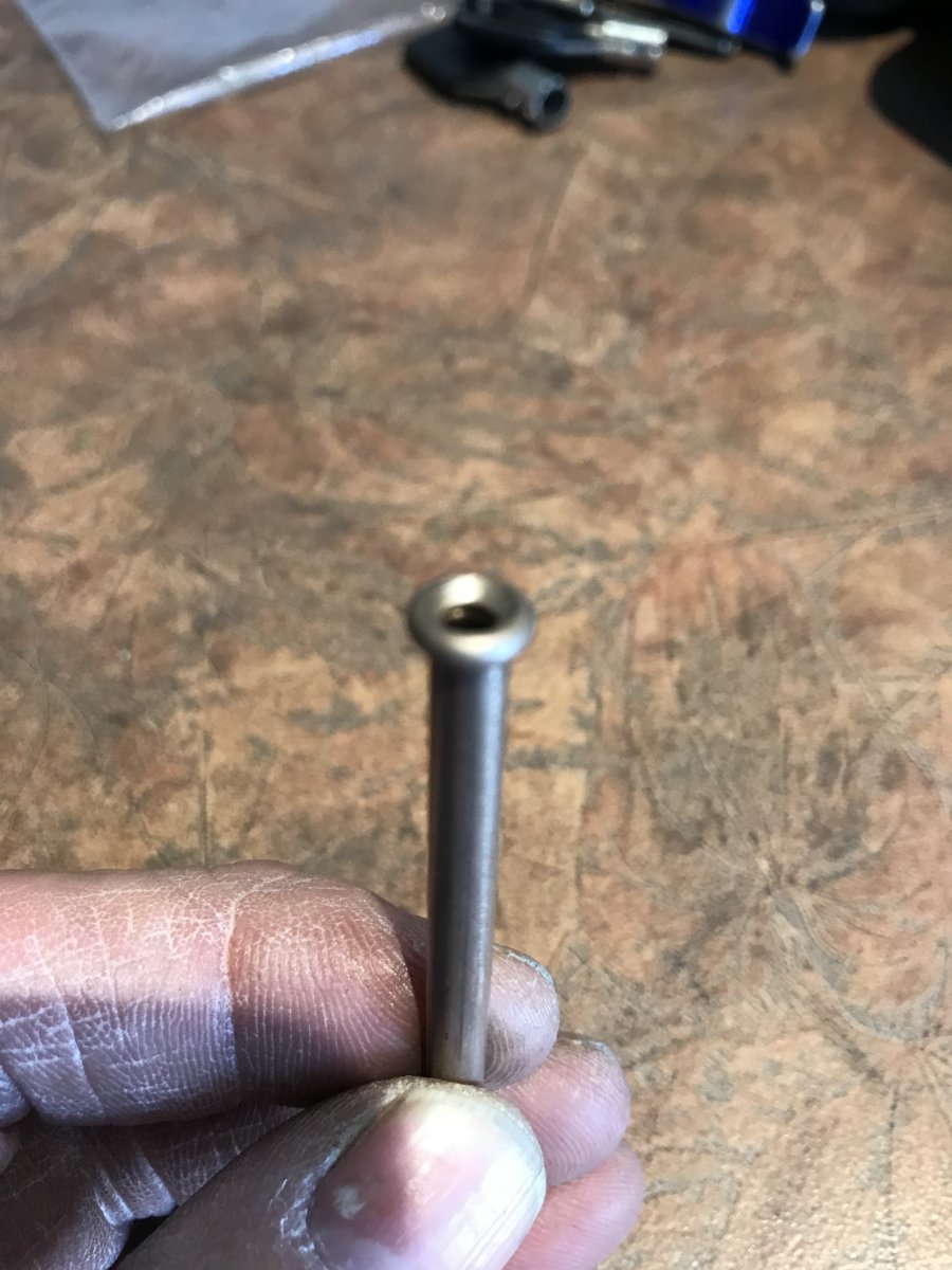

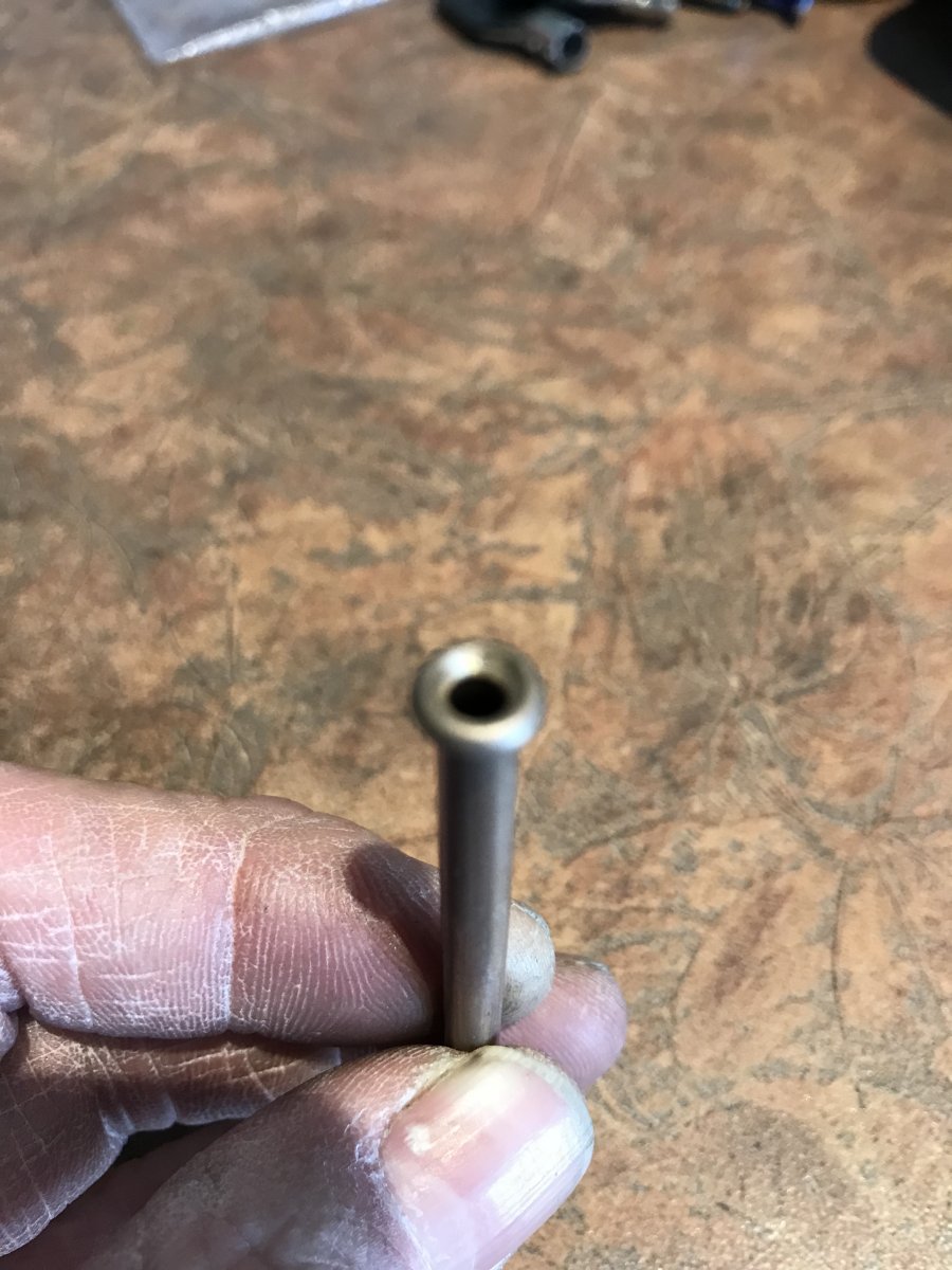

  26. Blue One
    Joined: Feb 6, 2010
    Posts: 11,512
    Blue One
    from Alberta
    Well, today I picked up my Eastwood flaring tool.
    All I can say is wow :cool:
    I unpacked it and headed to the garage to make a test flare.
    I’m amazed, I don’t think I’ve ever made as perfect a flare with any tool before this.
    And it couldn’t get any easier.
    Cut and ream the tubing inside and out
    Set the die in place and pull the handle on the zero setting to set the tube depth in the die
    Tighten down the tubing die and turn to step 1
    Pull the handle as far as it goes.
    (Not hard and no fiddling with big wing nuts or other finicky **** that comes with the usual hand flaring tools)
    Turn the selector to step 2 , pull the handle again.
    Perfect flare. :D
    This is gonna be good :) :cool:
    I can already see that it was money well spent.
    6F881F1F-748B-451B-86AD-04B51FB9047D.jpeg CD3259AC-A780-4E1B-8379-DF74ADF5B8A3.jpeg

    Glad that the new tool works so good, now get those brake lines done so you can go onto the next step and get that RPU on the road! :D
  29. atch
    Joined: Sep 3, 2002
    Posts: 6,413
    atch
    That looks great. Here's to hoping that they hold pressure as well as they look (and I'm pretty sure that they will).
