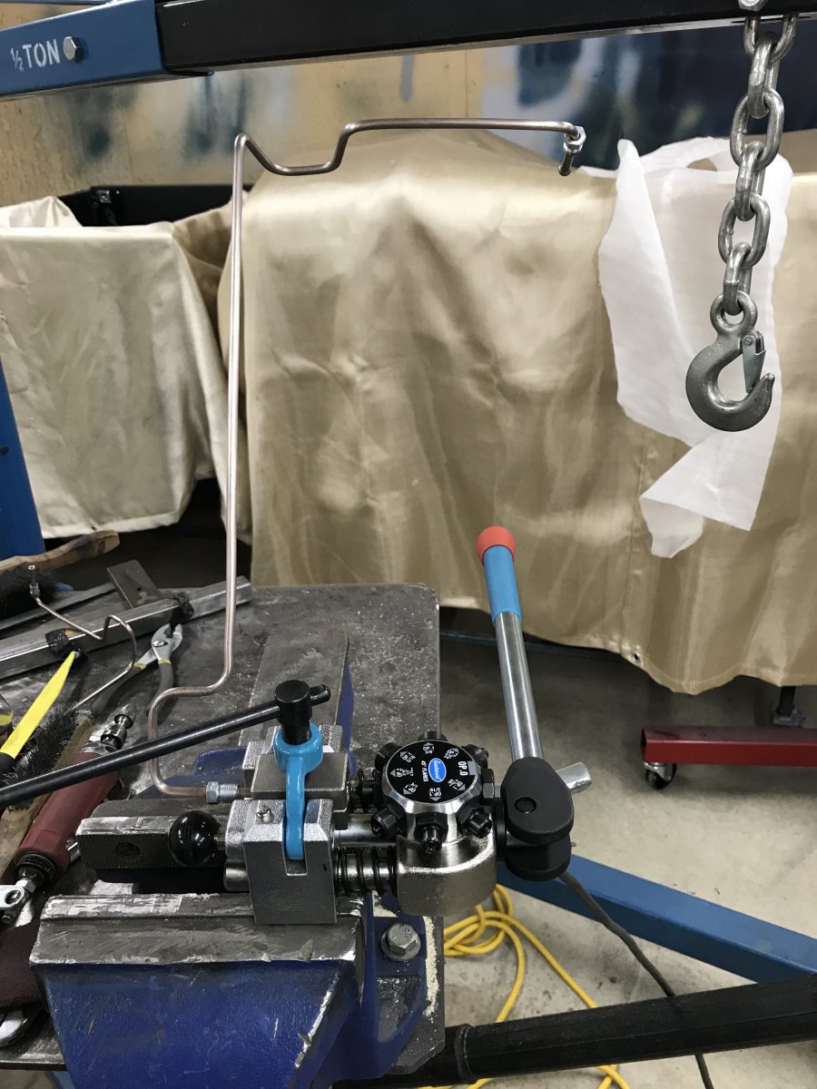

    lines are looking great. I borrowed my buddy's Eastwood flare tool when I re-did a set of Dunlop Brake calipers with the transfer tubes, lots of flaring. I liked it so much I had to get my own. The next best brake tool was the pressure bleeder I made with a bug sprayer bottle. one man show to bleed them.

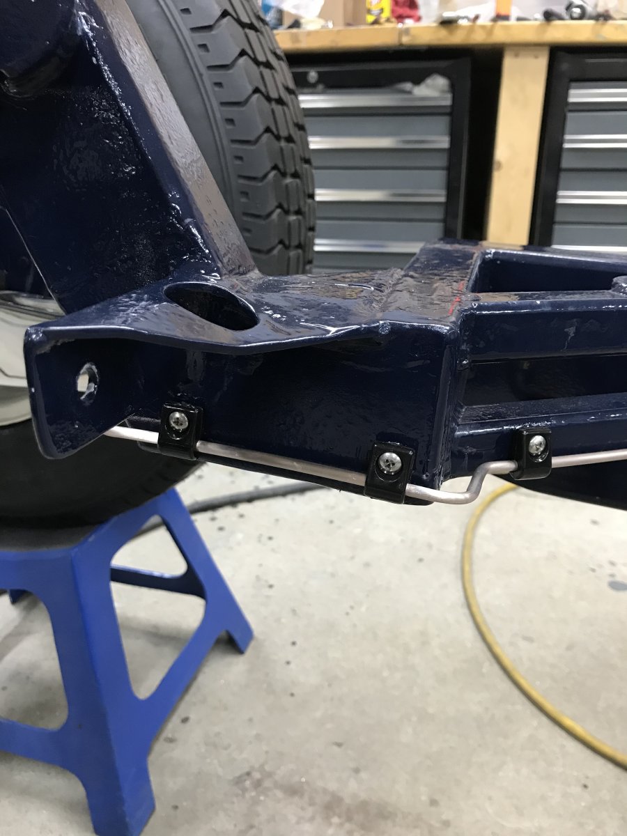

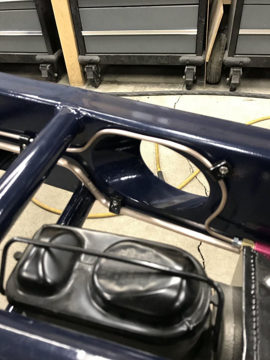

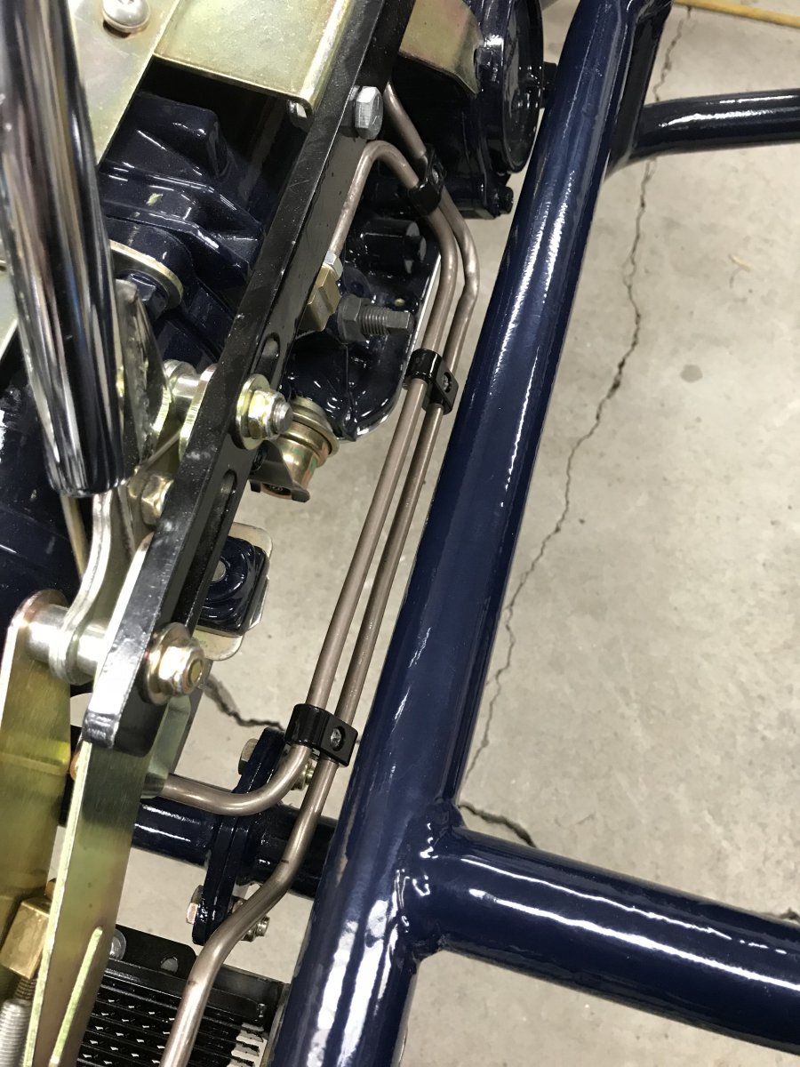

    The brake line from the drivers side frame through bulkhead fitting to the p***enger side across the rear of the front crossmember gave me fits :D
    It was tough but it turned out well.
    It is the first line I made the flares for using the Eastwood Pro Flaring Tool, everyone should have one. :cool:

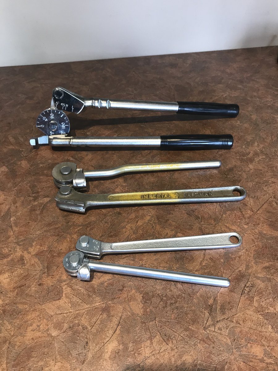

    This is the only thing that comes up when I search this thread for "bender". What tubing bender are you using? Your bends come out better than mine.
  5. Blue One
    Joined: Feb 6, 2010
    Posts: 11,512
    Blue One
    from Alberta
    I’ve got 3 Imperial lever type tubing benders.
    3/16”, 5/16”and 3/8”.
    They’re industrial quality and work great , they’re much better than the hardware store versions that bend multiple sizes of tubing.
    They usually don’t have a good tight bend radius.
    The Imperial benders are US made quality :cool:

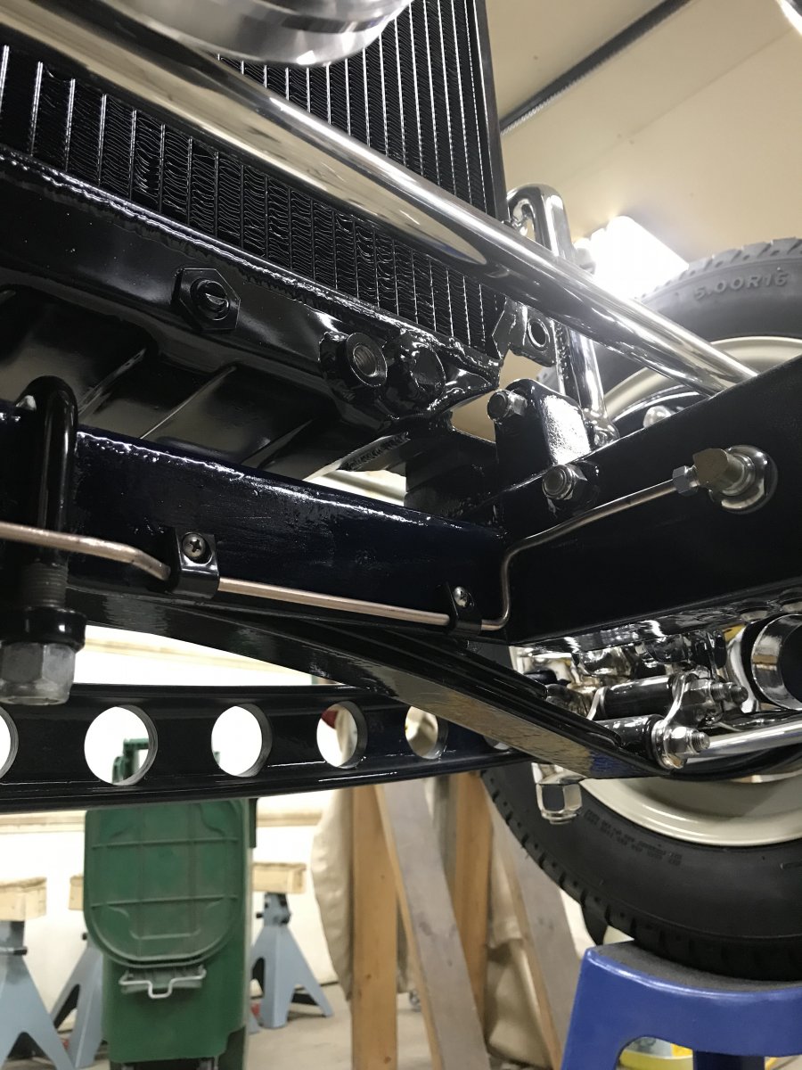

    Whew :D That was fun. The small lines I had made from the master cylinder to the proportioning valve (with the previous terrible flares) have been replaced.
    New line bent up and properly flared.
    That ni cop line sure looks nice when you give it a little scrub down lightly with Red scotchbrite. :cool:

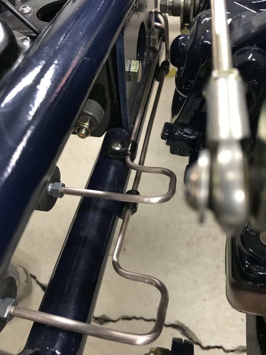

  10. Nice work. Why the extra bends?
  11. Blue One
    Joined: Feb 6, 2010
    Posts: 11,512
    Blue One
    from Alberta
    Thanks, all bends are for routing clearance to keep everything clean and neat, not touching or rubbing anything.
    It also makes future repairs such as changing a master cylinder easier.
    So, no extra or unnecessary bends.

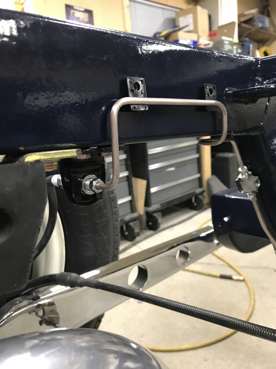

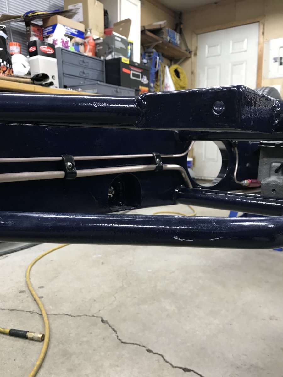

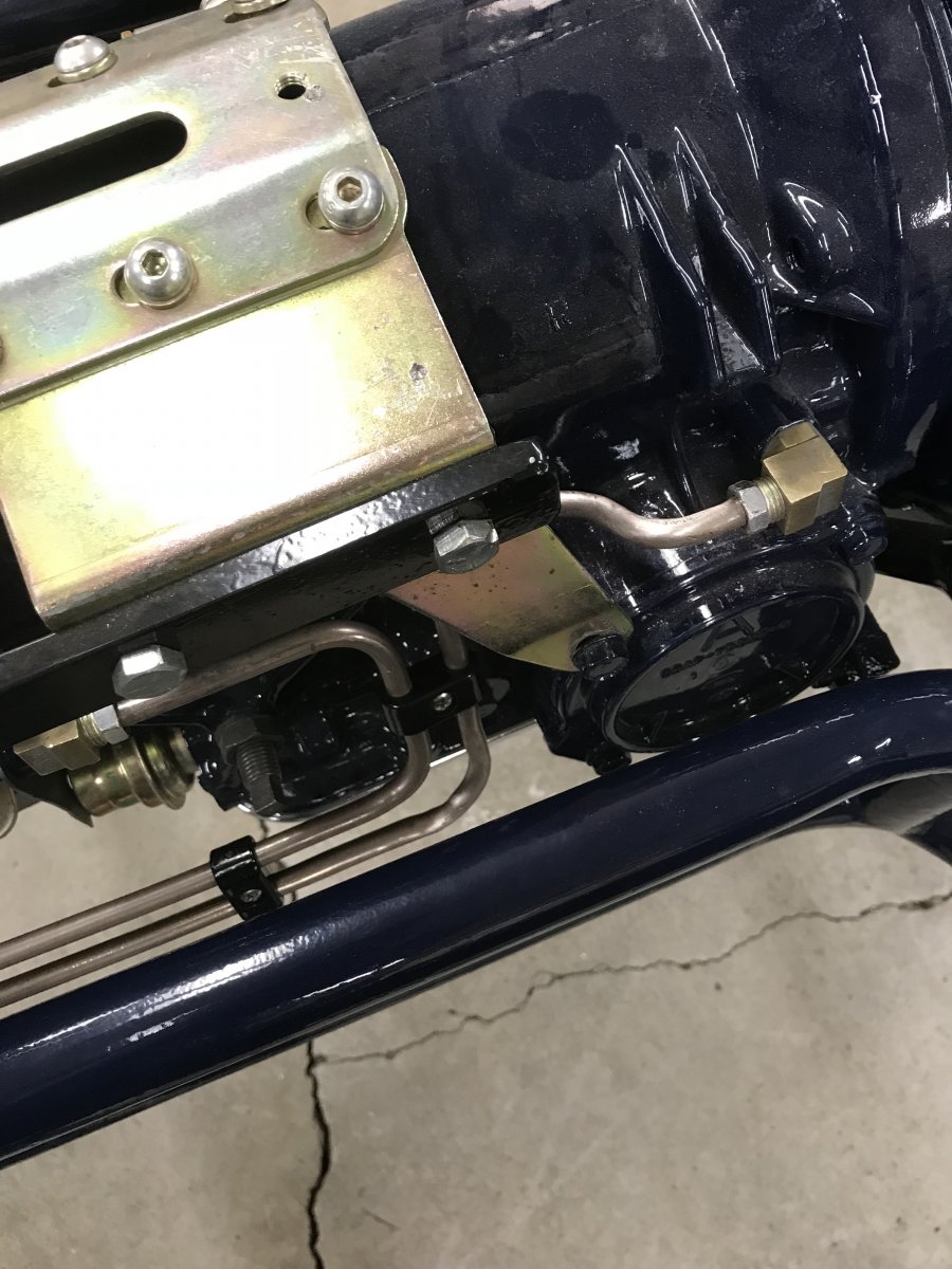

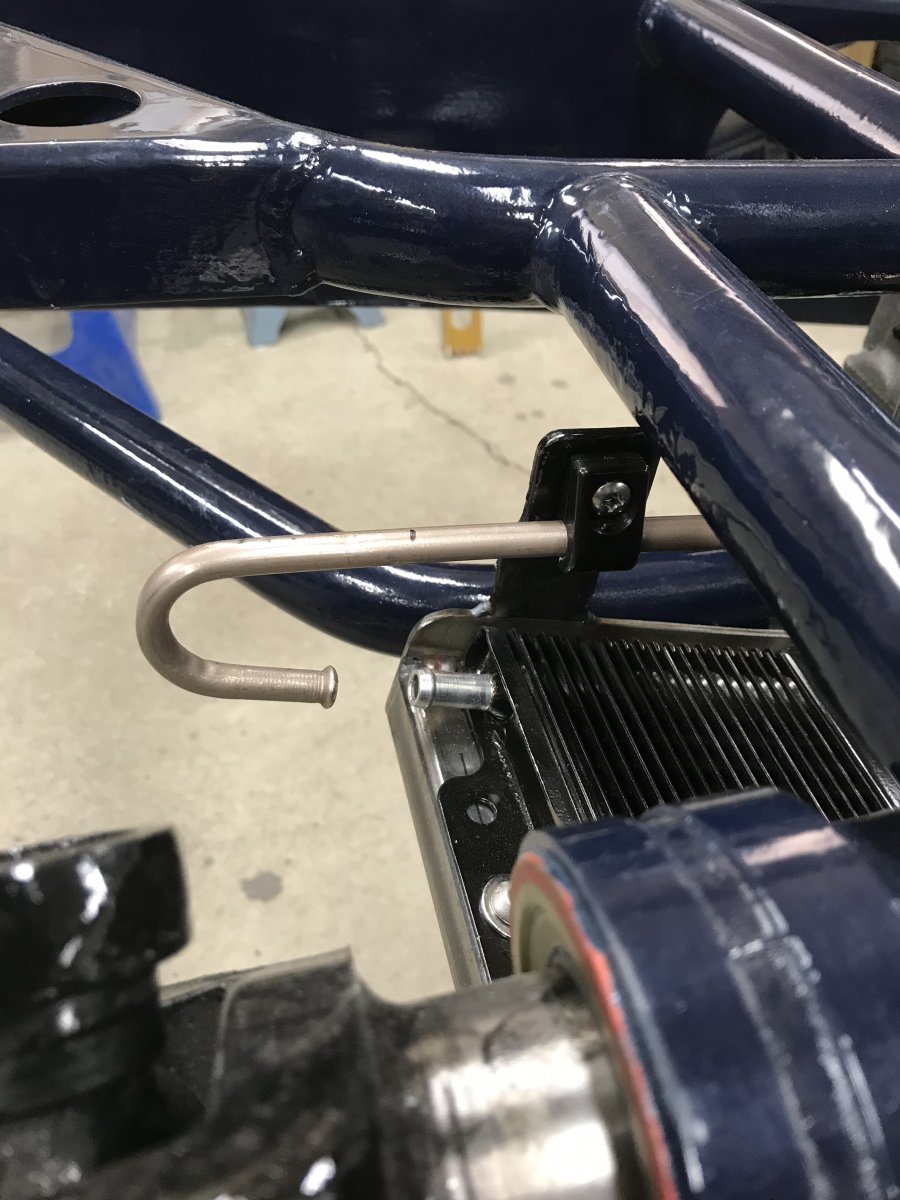

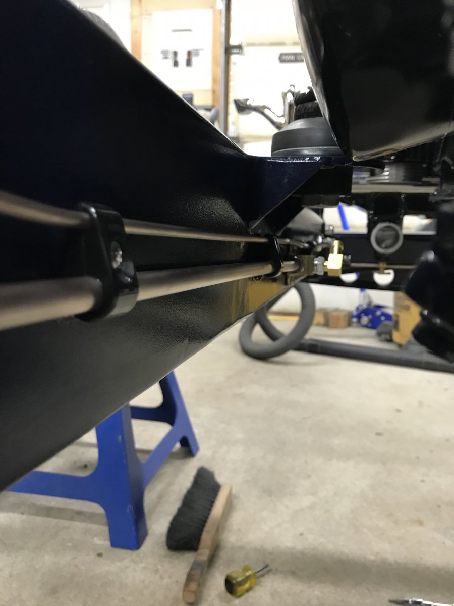

    Brake lines and fuel lines are progressing nicely.
    I had to route them around the hole in the frame for the exhaust.
    The Made for you line clamps with 3/8” on one side and 3/16” on the other side are pretty nice.
    I took a 3/8 “ Tee and silver brazed some mounting tabs to mount it to the frame.
    A section of hose and some fittings will tie it to the fuel pump. :cool:

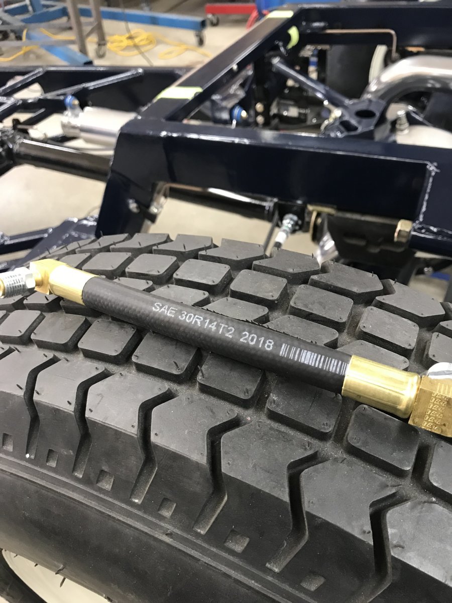

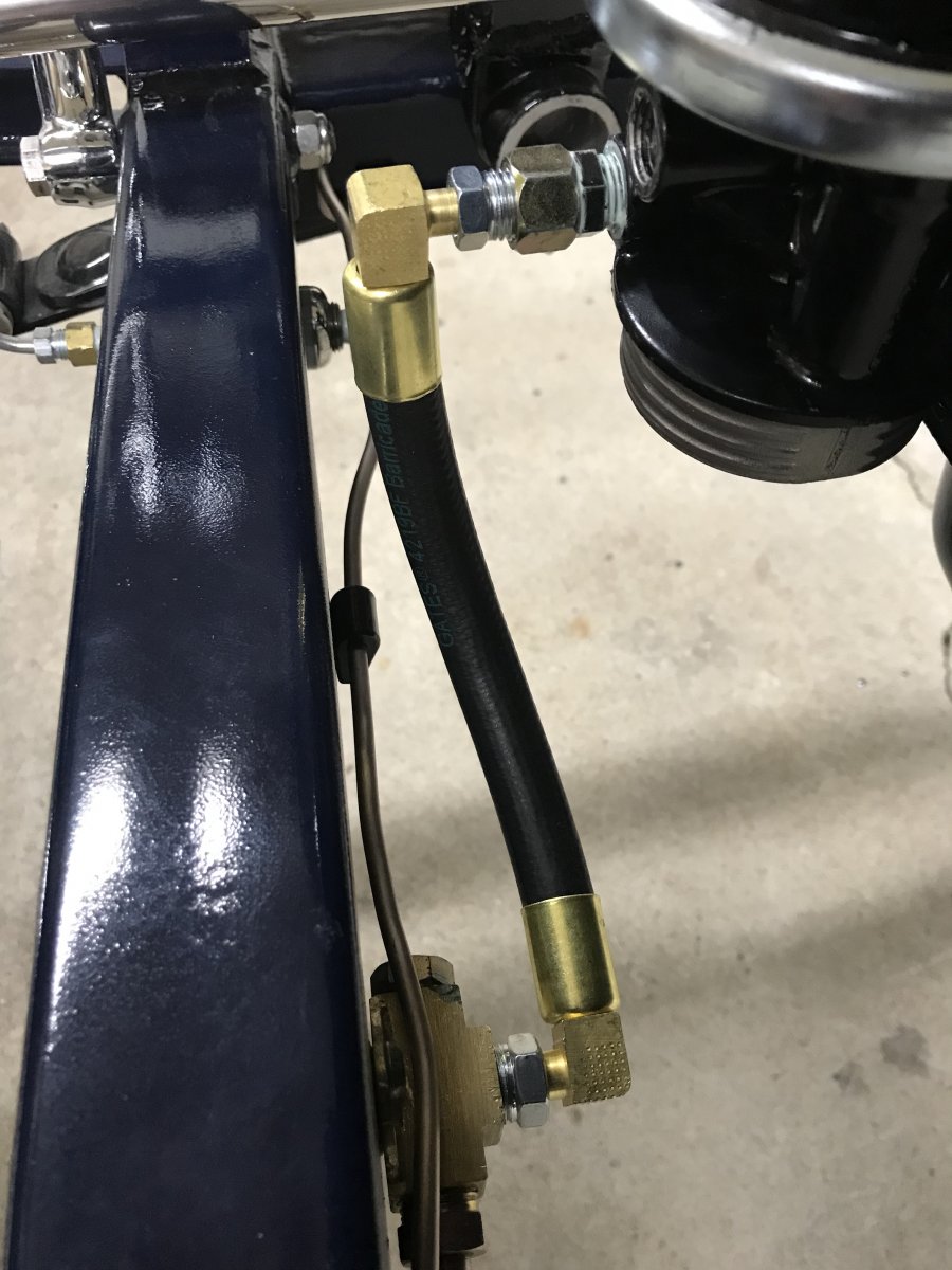

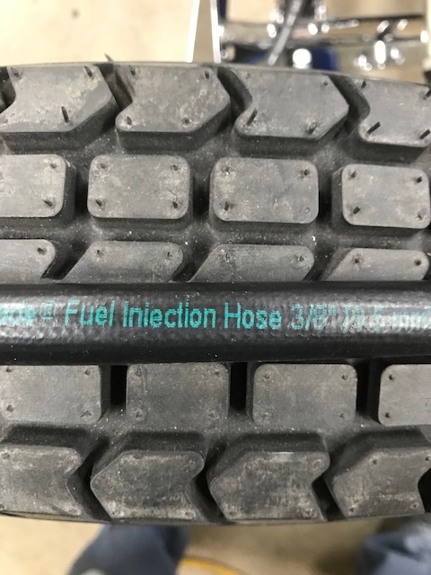

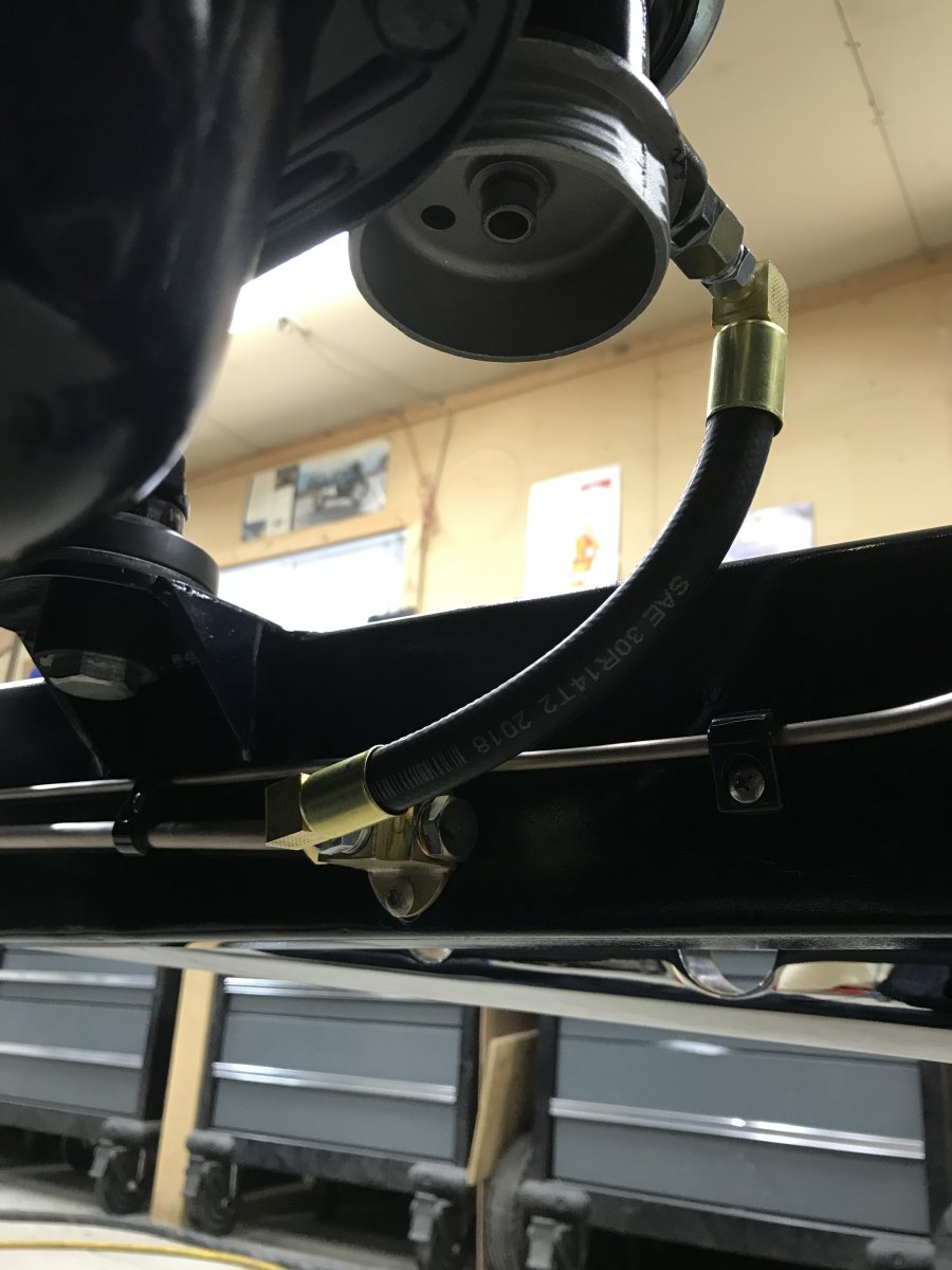

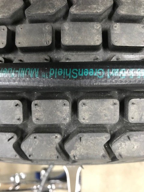

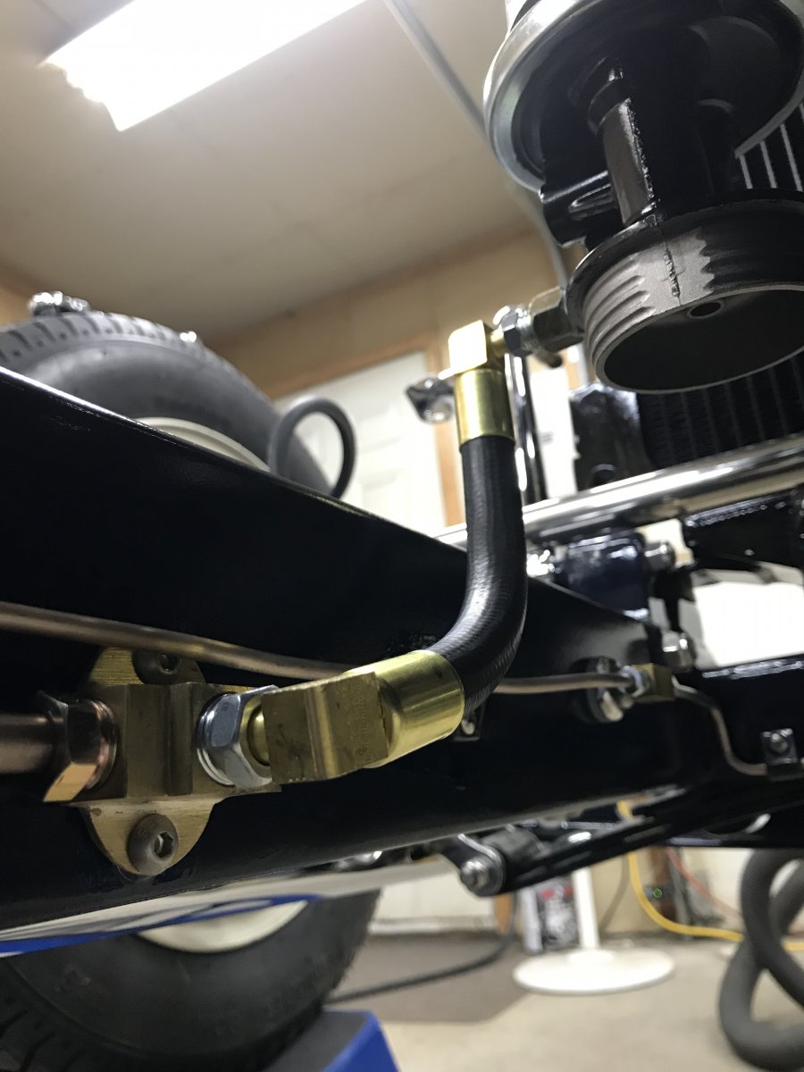

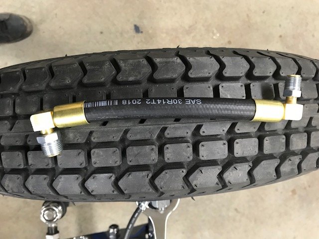

    The fuel line connection to the fuel pump inlet.
    No hose clamps, I just have to have the ferrules crimped now.
    Inverted flare fittings, the top inverted flare size for the fuel pump inlet is 5/16” x3/8” hose the bottom is 3/8”x 3/8.
    Along with super good quality hose (Gates Barricade Greenshield), nice and clean. :cool:

  19. tfeverfred
    Joined: Nov 11, 2006
    Posts: 15,788
    tfeverfred
    Blue, I've NEVER seen that done on a home built car. Your attention to safety and detail is above the bar!
    F-ONE and Blue One like this.

    Thanks Fred, it must be all the years I spent as an industrial pipe fitter / pressure welder.
    Working alongside instrument fitters you pick up a few things.
    I think it will be much better than the usual hose and clamps. :cool:

    I'm impressed with your 90 degree inverted flare fuel fittings. Do you know of a source for a similar fitting I can use on my brake lines?

  22. 57 Fargo
    Joined: Jan 22, 2012
    Posts: 6,210
    57 Fargo
    Nice work as usual, may I suggest marking the fitting to the hose in case they turn on the way to getting them crimped. Unless they are swivels that is.
    brad2v, loudbang and Blue One like this.

    I’m not sure. Do what I did and search every possible source online for fittings.
    It took a while to find what I needed.
    Good idea.
    They aren’t swivels and one is turned just slightly off square because of the taper of the frame.
    I’ll mark them before I head to the hose shop.

    The fuel line is crimped and installed.
    And Summit came through with the final line clamps I need to secure the rear brake lines :cool:
